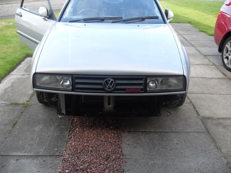

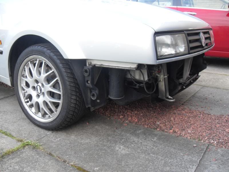

too hot 0 Posted August 17, 2011 (edited) Added some BBS goodness to the interior. Also fitted my newly refurbed Speedlines. Cleaned out under the rear arches and sent the front bumper off for paint:cool: Edited August 19, 2011 by too hot Quote Share this post Link to post Share on other sites
too hot 0 Posted August 19, 2011 (edited) Bumper off pics !!! Edited August 19, 2011 by too hot Quote Share this post Link to post Share on other sites
