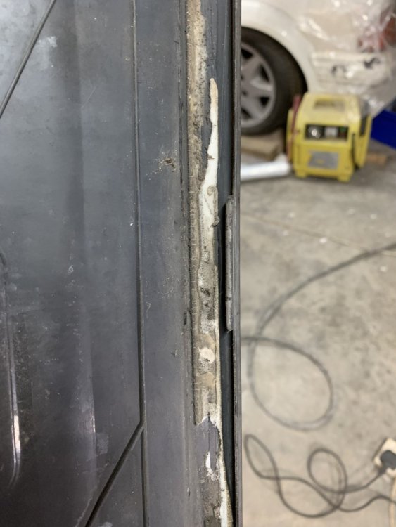

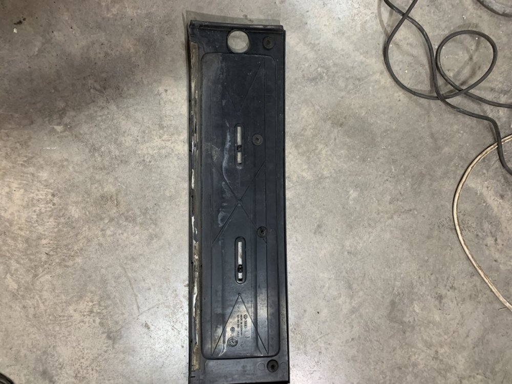

Nmdsec 10 Posted June 12, 2020 Took this off tonight,what a nightmare 😂 Double sided tape along the bottom which needed to be heated up and tentatively peeled back whilst trying to cut it from the top with a hacksaw blade 👍🏻 Quote Share this post Link to post Share on other sites

James. 9 Posted June 20, 2020 (edited) On 6/12/2020 at 9:14 PM, Nmdsec said: Took this off tonight,what a nightmare 😂 Double sided tape along the bottom which needed to be heated up and tentatively peeled back whilst trying to cut it from the top with a hacksaw blade 👍🏻 I did this last month, using a heat gun and melting a 5p size dot in the process. Looks like you did alright. All the nodes look intact as well, so kudos to you. Edited June 20, 2020 by James. Quote Share this post Link to post Share on other sites

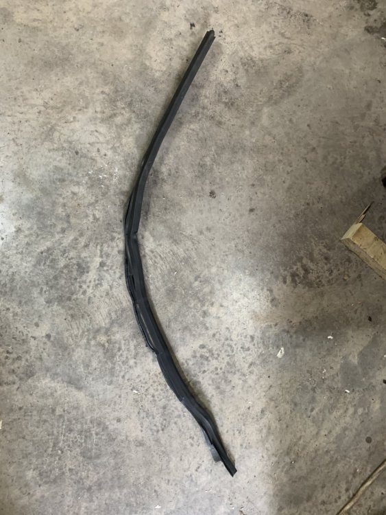

Nmdsec 10 Posted June 20, 2020 On 6/20/2020 at 9:12 AM, James. said: I did this last month, using a heat gun and melting a 5p size dot in the process. Looks like you did alright. All the nodes look intact as well, so kudos to you. Thanks,wish I could say the same for the passenger door weather strip,totally lost it,lots of expletives coming from the garage 😂 Quote Share this post Link to post Share on other sites
James. 9 Posted June 20, 2020 On 6/20/2020 at 12:29 PM, Nmdsec said: Thanks,wish I could say the same for the passenger door weather strip,totally lost it,lots of expletives coming from the garage 😂 Holy moly, you really did. Poor thing looks like it’s been run over. Think you can save it ? (not like they’re available off the shelf). Quote Share this post Link to post Share on other sites
