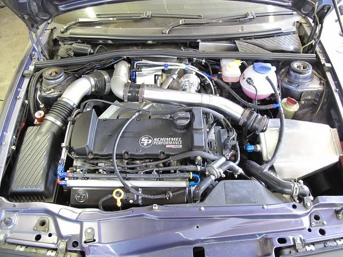

B5VWC 0 Posted July 9, 2009 This is my Shortrunner & Chargecooler setup Yeah it looks good but i know it does the job as the Rotrex was supplied with a 80mm pulley and I was told this should see around 350-360hp Always makes 18psi (430hp/345torq) and that was after an hour running on the rollers and dying pistons - not much boost loss there Be interesting to see what I could get with a 70mm pulley :D Quote Share this post Link to post Share on other sites
Kevin Bacon 5 Posted July 9, 2009 Always makes 18psi (430hp/345torq) and that was after an hour running on the rollers and dying pistons - not much boost loss there Nice numbers 8) Great power to drag that torque flat round to 7K and the torque isn't so much as to wreck the gears, good work. I saw your old and new engines when I was up there recently. Hope the new one works out. Quote Share this post Link to post Share on other sites
VR6Joni 0 Posted July 9, 2009 i would think it is, but you'd be putting a 180 degree turn right after the charger to turn it back round, not ideal really. i do like the look of that PWR inline, would it fit a V9 you think? and do we know what size that is? it looks way smaller than CrazyDave's. The rotrex outlet does rotate at 60deg intervals so could possibly come out at a nice angle for an intercooler setup which is what made me think of it. I recon the price would be very similar between a PWR charge cooler and standard manifold compared to a short runner and an intercooler, but what would have the best cooling gains between the 2 and as James said earlier would a noticeable amount of charge lag be introduced with the intercooler setup???? (with a rotrex) Answers on a postcard please. Quote Share this post Link to post Share on other sites
