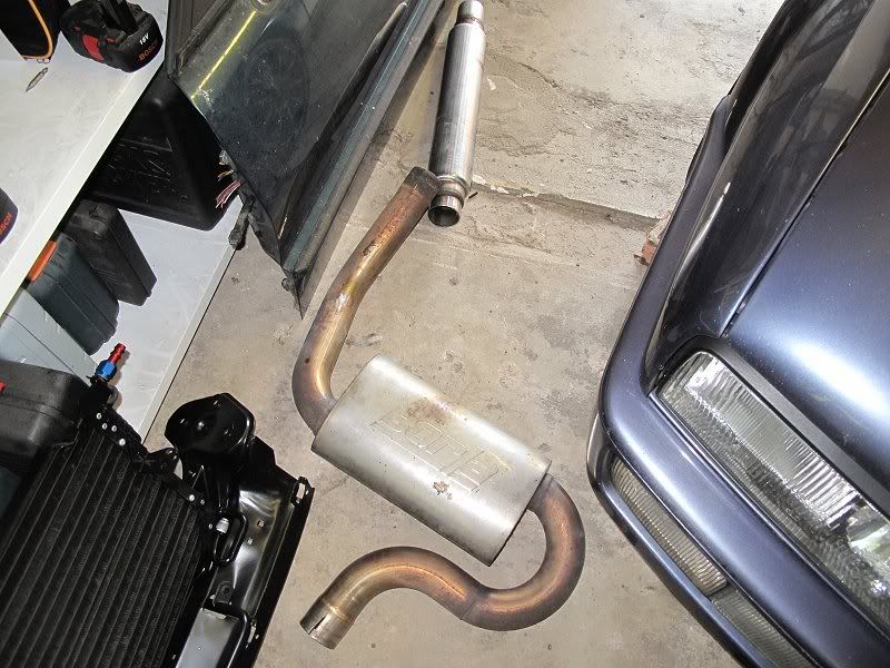

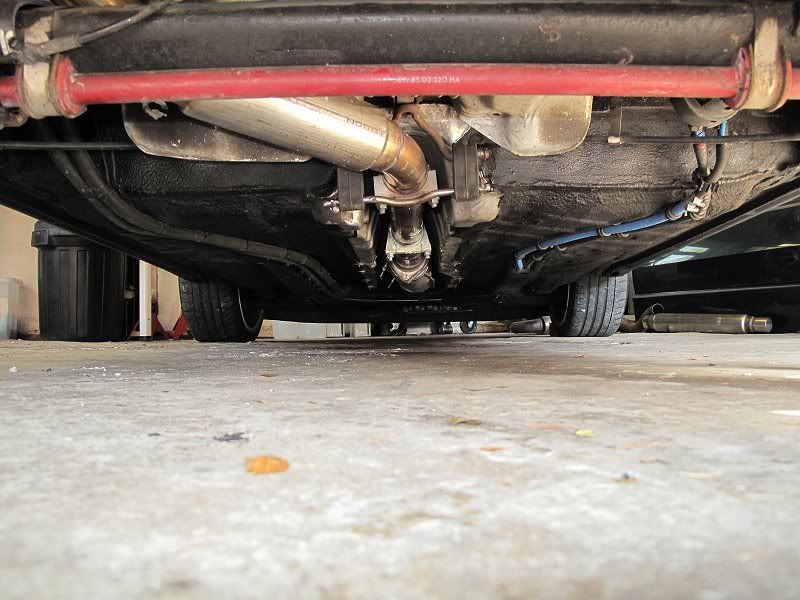

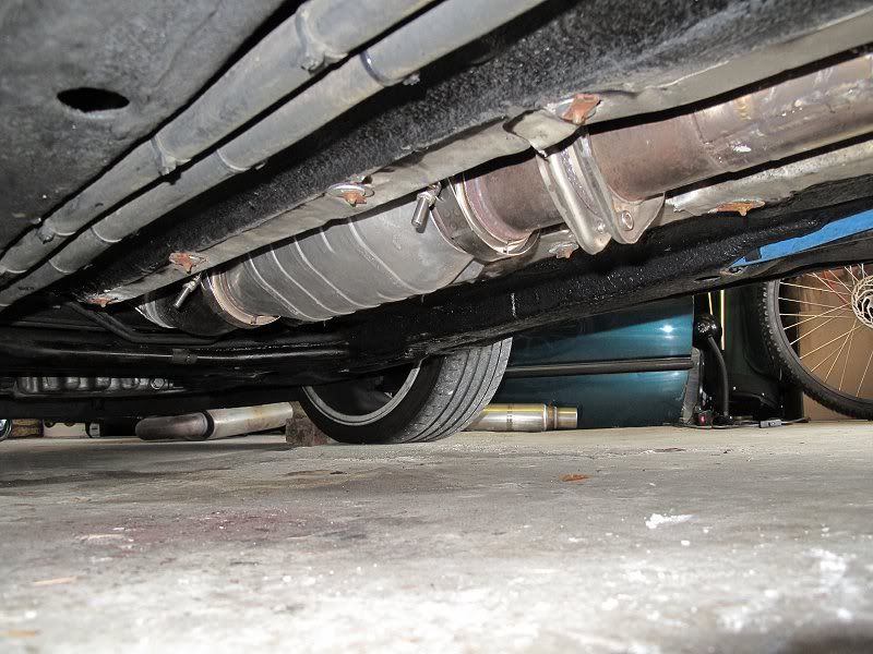

Kevin Bacon 5 Posted September 26, 2009 I've been playing about with the exhaust recently thanks to swapping some parts around with Leon :salute: This middle silencer has been removed..... ...and replaced it with a resonator.... And I also fitted an ATP 3" High flow cat converter.... As it's a road car, I like it to look like, drive like and even SMELL like a road car! :D I really hated the stench of uncatalysed warm up fuelling and my mate said my car stank like his Dad's old Cortina! The exhaust now smells like a modern car and I like that :D As cats only work at 14.7:1 AFR, I've trimmed the midrange fuelling accordingly :D Any drop in performance? Well after binning the middle silencer there was a bit of an improvement in the top end, so losing the middle box worked. And after fitting the cat? Absolutely none. It's a complete myth that cats sap power. If the cat is appropriately sized to the engine's VE and turbo flow, there should be no drop in performance. Sure at 20psi+ big turbo boost pressures, there may be a little restriction, but in every day 8 to 15psi boost, it's perfectly fine. OEs use cats on turbo engines, so if they can do it, so can we :salute: What else, erm, yeah my next mod.... Strictlydubs kindly blasted and powder coated a radiator support panel for me, and on top of that sits my US market A/C radiator, which will be my new chargecooler heat exchanger. I went with the US spec one because A) it's genuine VAG and B) because it's a bit beefier and flows more than the aftermarket Diava one the UK got :salute: I might use the schimmel heat exchanger in addition to that if I can get both to fit, but the main reason for doing it is to make use of the fans in traffic and slow speeds and to enlarge the cooling area to reduce intake temps still further. Tis all.... Quote Share this post Link to post Share on other sites
