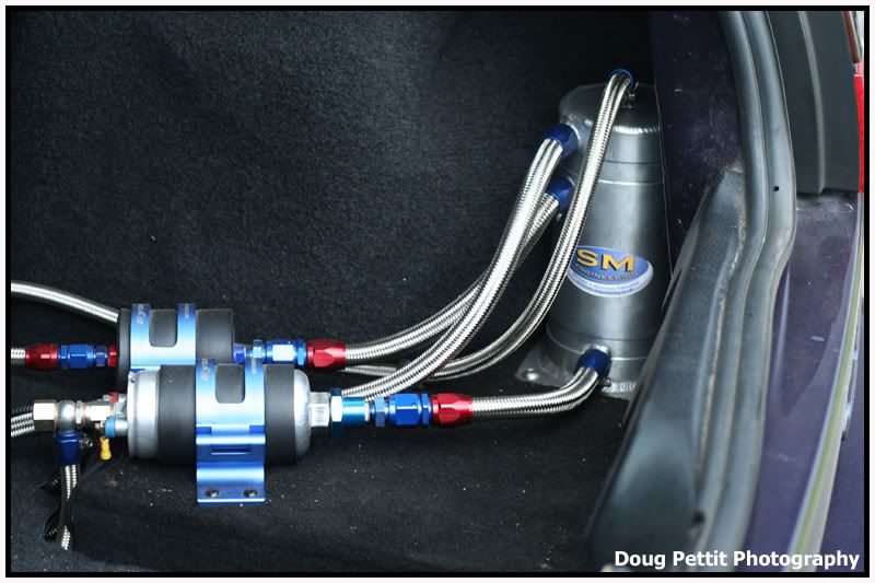

jamminvr6storm 0 Posted July 12, 2010 Nice job Kev - as ever :salute: It looks really neat and tidy, i'm sure yours will be far quieter then mine. I put mine in the boot, sounds like a swarm of angry bees following me around :cuckoo: LOL! I used a walbro 255 in tank pump feeding my 1.5ltr swirl pot, then a 044 to feed the engine from there... Not the best pic but you get the idea Quote Share this post Link to post Share on other sites
Kevin Bacon 5 Posted July 12, 2010 LOL, know what you mean about the Swarm of bees sound, good description :lol: Yours looks great though :salute: Mine also has 1.5 litre capacity, but I just found out yesterday my 044 wasn't supplied with a check valve, meaning all the unwanted fuel pressure drains back through the pump instead of the regulator (path of least resistance), which can damage it apparently. So I've ordered a check valve from good old Speedflow - http://www.speedflow.com.au/valves.html The UK shop has them too, which is a relief! Quote Share this post Link to post Share on other sites

pete_griff 0 Posted July 13, 2010 kevhaywire said: Surge tank and Bosch 044 installed. It went on easily and I'm chuffed with the build quality and low noise levels of the pump :D Normally they're noisy as hell, but submerged in fuel it's a lot quieter, just sounds like a MK1 / MK2 K jet pump that's tired. You can just hear it buzzing at idle and that's it. People with 3" exhausts might not hear it all :D 600hp capable fuelling ready to go :norty: nice work there Kev - liking the way you've kept everything as oem, subtle and out of sight as possible. seeing as you're running the pump in the swirl tank, the cooling effect from the fuel should make the pump last a bit longer as well shouldn't it?!? as well as the obvious bonus of making it a bit quieter. oh and agree with the others about your wheels - i've always been a fan of the pro-races, typically they're nice and light for you too! :lol: jamminvr6storm said: Nice job Kev - as ever :salute: It looks really neat and tidy, i'm sure yours will be far quieter then mine. I put mine in the boot, sounds like a swarm of angry bees following me around :cuckoo: LOL! I used a walbro 255 in tank pump feeding my 1.5ltr swirl pot, then a 044 to feed the engine from there... Not the best pic but you get the idea that's a very nice setup you've got there too Ben - nice to see those V3's are getting put to good use! have you got a build thread anywhere - was loving seeing all those piccies on your phone ages ago, now i've seen this i want more! didn't realise you were running figures above 500hp until recently - mental! :nuts: :luvlove: Quote Share this post Link to post Share on other sites

chazrad 0 Posted July 13, 2010 kevhaywire said: Cheers Shaun :D I'm not power hungry. It was done mainly to cure an occasional fuel splutter on corners and I'm not convinced a tiny little pump in the tank can sustain 400hp for long, so it's just there to add some reassuring muscle :D When the 02M is in I'll be upping the boost :D Kev, Ben, Tim at the Phirm did the very same thing to mine about six weeks ago. My swirl pot has a capacity of about a pint rather than Ben's one litre - not sure what yours is. I'm using the standard in tank pump with a Glencoe race pump on a neat bracket mounted next to the swirl pot and fuel filter under the car, very similar to yours. I wasn't suffering with fuel starvation but I did have what turned out to be a fuel relay problem on the Glencoe in early May, that was causing erratic running. When that was addressed - with a separate loom for the Glencoe - Tim fabricated then fitted the swirl pot at the same time. Having initially been living with a not-unpleasant but very audible whine, my pump has quietened down alot as the pressure has been turned down. I too am familar with the 'bees in the back' analogy... Mine's coming along. Its done about 3000 miles on the forged pistons and rods. The DTA has now been fully mapped at different boost settings by the guys at Track and Road Proformance at Rainham, and is really smooth. It even idles well from cold. I can't believe how rapid it is. Having said that, I'm not close to 500hp yet, nor do I think I will ever be. Its an animal as it is, and I just can't imagine needing to go faster on our roads! :shock: But well done to Ben all the same. Apart from the colour of the wheels and paint, mine now looks quite similar to yours. I love my Pro Race 1s. :salute: Quote Share this post Link to post Share on other sites

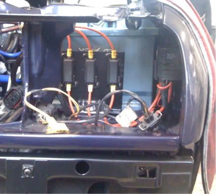

Kevin Bacon 5 Posted July 14, 2010 Mine is 1.5 Litre capacity when empty, and I think the pump body displaces about 400ml so yeah, I think it's enough for the job :D I was having starting problems because my 044 was supplied without a check valve, but I managed to find a purpose made one from Speedflow, and it's starts on the button again :D http://www.speedflow.com.au/valves.html Interesting what you say about the fuel pump relay. I was never happy with the standard wiring when it came to uprated pumps as they pull a lot of amps. I've relayed the intank pump and also the external one seperately. The factory relay merely has to provide a signal for the other two, which is good as it always ran too hot for my liking, even when standard. I'm glad you're happy with the mapping, I've heard only good things about Steve Greenauld. He's pretty much the main authority with DTA in the country :salute: What idle valve are you using? Agreed on the power and defo agreed on the ProRace 1s. Subtle, usable and reliable :D Just the 02M for me next as the last mechanical mod. The 02A is lasting well, but feeling tired, and I want that extra speed 8) Quote Share this post Link to post Share on other sites
