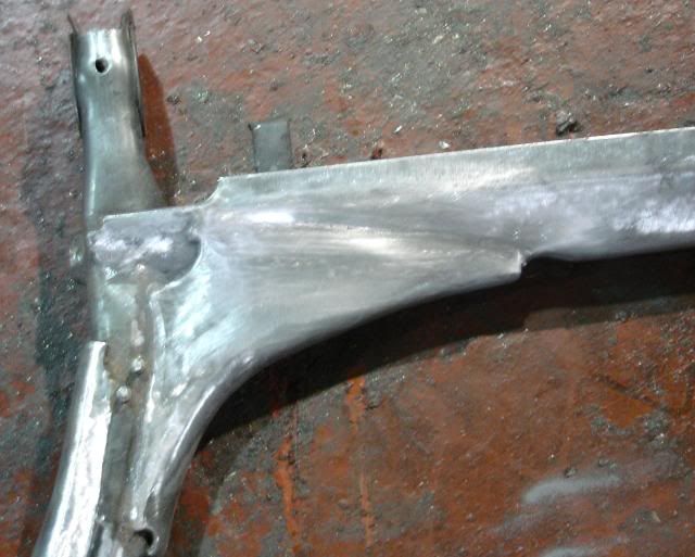

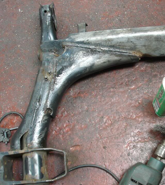

A20 LEE 0 Posted March 20, 2006 Only done one seam so far but you get the jist. Plan is to smooth and fill or grind every weld until i get a totally smooth beam. Should look really good but more importantly makes it a lot easier to chrome. Chrome struggles with chewing gum welds and tends to rust around them, so functional as pushing things on abit. before After - first smooth seam. Quote Share this post Link to post Share on other sites
