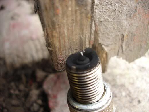

mrbeige 0 Posted April 6, 2008 What do you spark plugs look like? Also, what did the manifold gasket look like? Did it look fully compressed across all the ports? Quote Share this post Link to post Share on other sites
Riley 0 Posted April 6, 2008 Edit:Yep, gasket looked fine...Wondered about it being warped? But seems ok. Not good Stu :shock: But bare in mind ive had to run the car with the wot switch cable tied up...They are really carbon'd up, and the tips are white as though its been running hot :? yet rich :? Quote Share this post Link to post Share on other sites

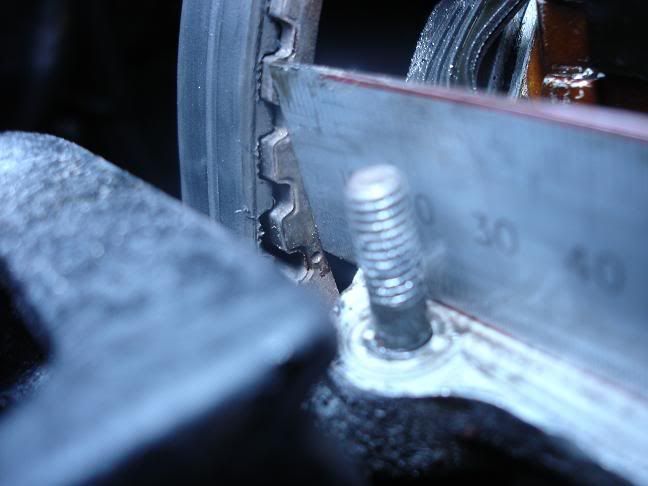

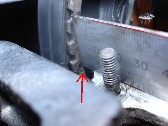

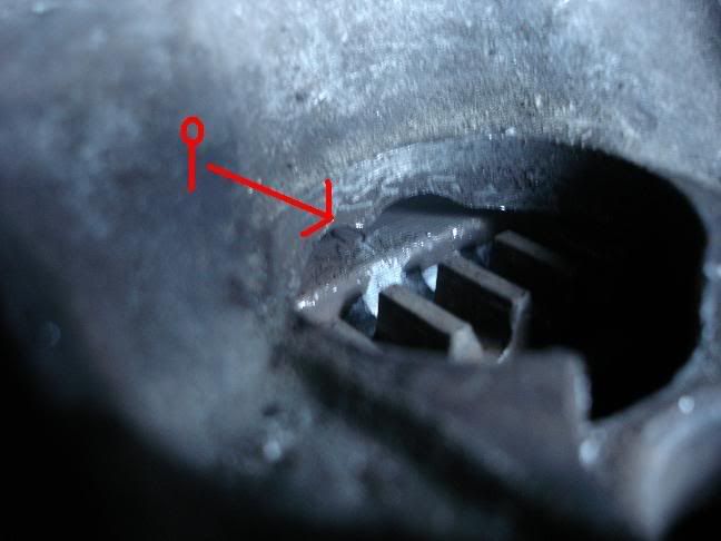

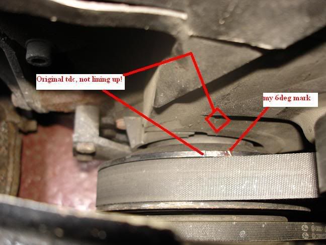

Riley 0 Posted April 7, 2008 Big red letters Ok... I think...I may have found the problem, but tbh ill be pretty p|ssed off if i have. Ive been told countless times that the two dots on cam sprocket should line up with a slash on the metal backplate And this is what ive always done... Now ive just been told that its not the correct way, and you should line the dot on the back of the cam sprocket up with the edge of the head/cam cover. :? See pics. Flywheel tdc mark lined up. But my crank pully dosn't line up (and yes the crank keyway is mint/snug fit!) And low and behold, the dot on the cam sprocket does not line up with the head/cam cover. If i turn the flywheel to the 6deg mark, it lines up like this. So what the f*ck is going on? Quote Share this post Link to post Share on other sites
dirtytorque 0 Posted April 7, 2008 bottom line .. the top dead centre line on the flywheel should coincide with the tdc line on the head sprocket being flush with the face of the head. I always use the flywheel and the head sprocket line as my references as they are the most accurate. Looks like you will have to re-do the mechanical timing imo. Whoever done it last used the wrong timing mark on the flywheel. Quote Share this post Link to post Share on other sites
Riley 0 Posted April 7, 2008 Cheers mate, its me thats done it and redone it countless times, the way ive been told to on here :sad: ! And!!! Two local garages have checked the static timing...Edit:And ant on here! :sad: By using the two dots/slash in backplate on the cam sprocket. They do line up absolutely f*king perfectly with each other and also with the tdc at flywheel. I can't believe its only just come to light that ive been doing it wrong! So is this my problem? Are valves open when they shouldn't be? And why would bts make it run right? Im still not confident this is the problem after the sh|t ive been through with it :brickwall: Quote Share this post Link to post Share on other sites
rolex 0 Posted April 7, 2008 Mate, i really feel for you. It must be hell :( But try not to give up hope, i onlly wish i could be more help but i dont know squat!! :shrug: Quote Share this post Link to post Share on other sites
coolrado 0 Posted April 7, 2008 Unfortunately (or fortunately depending on how you look at it) it looks like your timing is set correctly, the lower pulley mark should be viewed either from the side or in line with the mark, the angle your pic shows it from doesnt give a very good idea of its position. The marks will never line up absolutely perfectly and the few mm difference your pics seem to show shouldn't be a problem, even having the head skimmed will effect the relation between the pulleys, unless they are a whole tooth spacing out it should be ok, although i have driven cars that have been one tooth out and they weren't that bad, just a bit down on power or the exhaust mani was getting too hot. It just seems to me to point to an electrical issue, i know it must be really annoying as you have probably checked every wire already but i just cant see a mechanical issue causing a problem that would dissapear when the WOT switch is pressed. Quote Share this post Link to post Share on other sites
Riley 0 Posted April 7, 2008 Oh man... :sad: So who is right about the camshaft timing here? Two dots lined to slash on backplate. Or One dot on back of cam sprocket to edge of head? Quote Share this post Link to post Share on other sites
coolrado 0 Posted April 7, 2008 well they are both right its just the two marks and the cover is the less accurate method but should still get you on the right tooth, you should really be able to see if its a whole tooth out either way. Firstly though i would set it up using the flywheel mark and ignore the lower pulley, as its pretty much impossible for the flywheel to be wrong, just out of interest what crankshaft bolt did you use? Quote Share this post Link to post Share on other sites
Riley 0 Posted April 7, 2008 Hi mate, i used the mk1 dx engine bolt with the washer...but the problem was already there well before replacing it. And surely both ways of setting the cam timing can't be right? There is quite a difference between the two ways i reckon? Please look at the pics carefully. Edit:Do you mewan its slightly differnt between the two ways, but still on the same tooth then? :oops: Riley said: Flywheel tdc mark lined up. And low and behold, the dot on the cam sprocket does not line up with the head/cam cover. If i turn the flywheel to the 6deg mark, it lines up like this. Quote Share this post Link to post Share on other sites
coolrado 0 Posted April 7, 2008 I cant really tell from that pic how far out it is, if it is a tooth width difference then yes, set the timing again using the rear mark on the camshaft pulley and the flywheel. Quote Share this post Link to post Share on other sites
Riley 0 Posted April 7, 2008 Tbh, i just can't get my head around it. Have to correct myself i think...Its like half a tooth somehow, im getting headache again :mad2: Unless the flywheel isn't just lined up right? Im tired man, every spare minute im up there f*king about with it. Quote Share this post Link to post Share on other sites
coolrado 0 Posted April 7, 2008 the flywheel can only go on in one possition as the bolts that hold it on are offset, they are also a very snug fit so wont allow any play, so if the marks really dont line up at either end there is something wrong somewhere, if the keyway slot is ok on the crank are you sure the key in the back of the pulley is ok and not twisted at all. Quote Share this post Link to post Share on other sites
