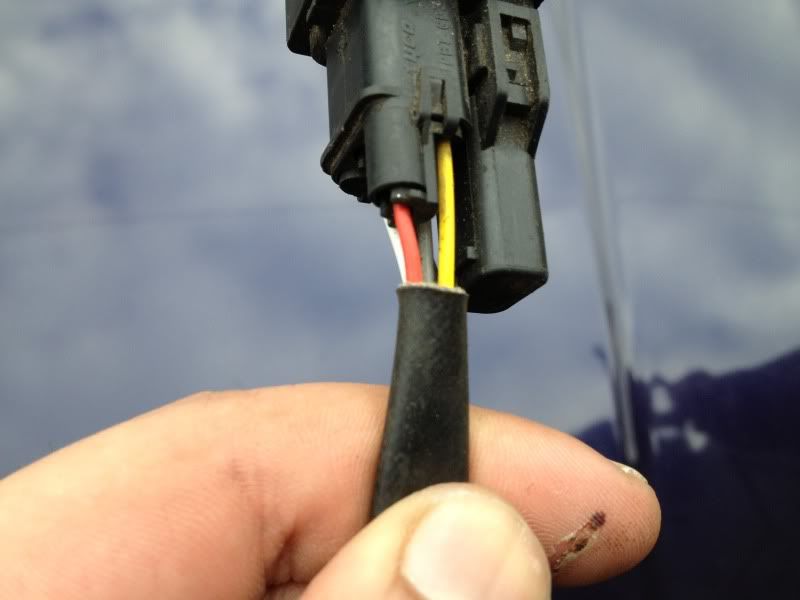

matty golf 0 Posted April 23, 2013 Anybody know what this plug is. Save me going through my diagrams Quote Share this post Link to post Share on other sites
quicky1980 0 Posted April 24, 2013 not sure what that plug is sorry. @ Dil, what makes you confident that the manifold lamdas arent required (Pete at Dubpower isnt an engine expert from what i recall, he gets the info from another source). What do you mean by link pipe? My understanding is that the lamdas in the manifold help trim the fueling for both banks of cylinders. You may be right that its not essential, but Im sure it helps with obtaining smoothness, fuel efficiency and even power. Post cat lambdas in standard setup is to check the cat's are correctly functioning iirc so it doesnt have any influence on the engine performance. But correct me if im wrong. When Kevin and I were trying to sort out an issue on my car we swapped the front lamdas around and found that it had an influence on the AFR iirc. Quote Share this post Link to post Share on other sites
