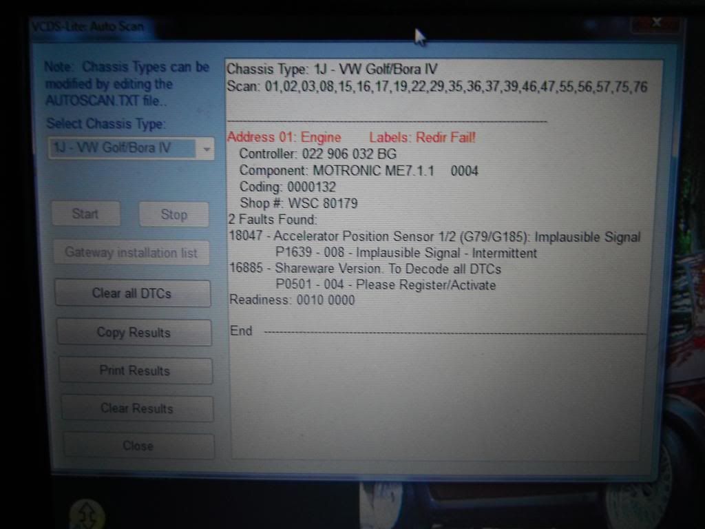

16885 -P0501 = Vehicle Speed Sensor Range/Performance.,
although when the vss was connected up and the pedal died the 2 fault codes logged then were 18047= pedal pos sensor 1+2 range/performance
16990= ecm/pcm processor
