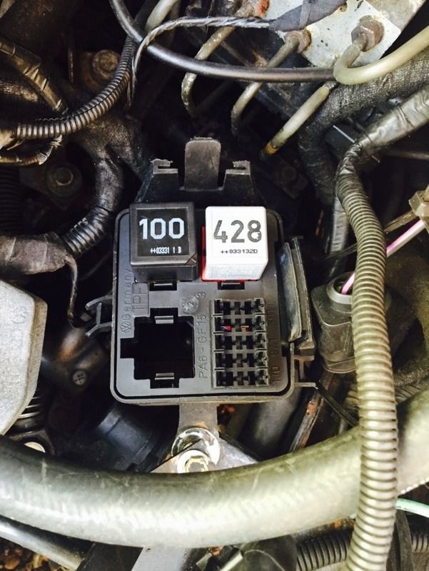

i have a box of relays in the engine bay as part of a mk4 r32 engine conversion, relay 428 is the ECU power relay
which i believe is initially powered by relay 30 (or you may have 109 ) on the main fusebox.....
problem i'm having is that relay 428 isn't getting a continuous switched power, and that relay 30 location is the culprit, does anyone know which block on the back of the fuse box is tied to this relay...cheers

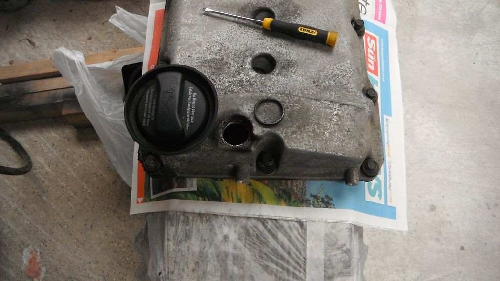

Hi guys, recently picked up a golf v6 4motion AUE {love it btw !!}, doing the thermostat housing and crack pipe along with cam cover gasket right now, just noticed on the cam cover right behind the oil fill cap theres seems to be a sensor of some sort? looks like its also leaking, My BDE doesnt have that, anyone know what its for? cheers

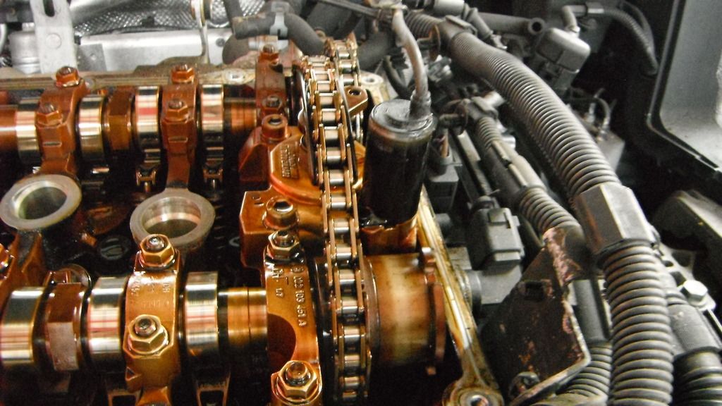

It's a sensor that reads something off the top chain. Not sure what it's purpose is but my guy feeling is that it's something to do with the timing.

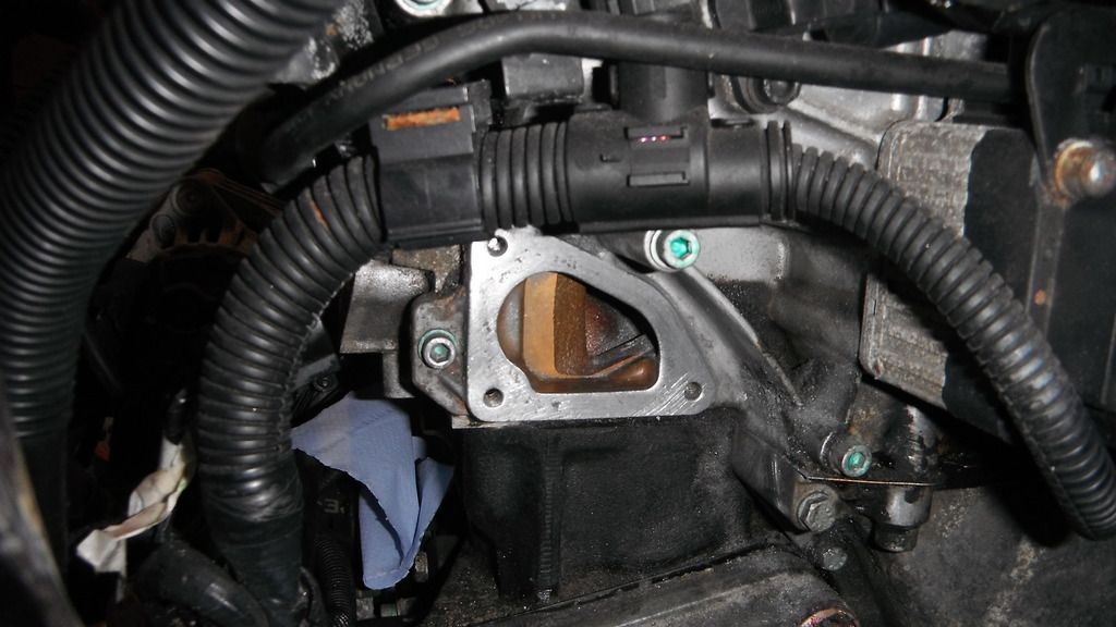

Whilst you got it off can you take some pics of the area near the solenoid and the cam sprockets please?
yep, iv already taken pics not sure if there going to be of use but give me 30 mins and ill post up the ones i got ,if not ill get some more in week.
any good?
turns out its just an o-ring,
seems like the actual leak was due to corrosion, can see the pits, cleaned it up best i can so im going to need a decent sealant , iv seen some people skim the pits with chemical metal? think its best to use a decent quality sealant to help the seal , something like loctite?
