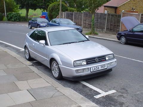

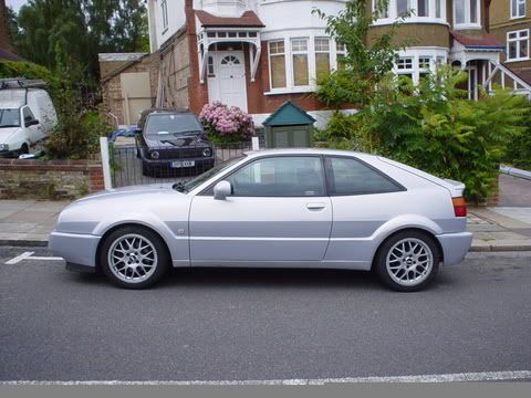

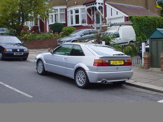

destructiv dave 0 Posted February 3, 2006 (edited) Have had the car for coming up to a year now. There were quite a few bumps and scrapes when I got it, with both door handle areas affected by break-in attempts (hence the addition of A6 handles). Have swapped out the dark grey flat (poverty) bench interior for a VR6 interior (Black with the Champagne glasses), with the addition of Audioscape door pods and Audioscape Sub enclosure for the boot. Brakes have been upgraded to 280mm and it is running a Milltek exhaust and have widetracked the front using Passat wishbones and Driveshafts (pics above were taken before this). Next job is to drop the engine and box, rebuild the engine, uprate the clutch along with any other components and turbocharge it (made that sound a lot easier than it will ever be). Will be taking photo's of my conversion and hoping to get it done this month (if it ever warms up), and will try to post as the build goes on. Edited July 11, 2011 by destructiv dave Quote Share this post Link to post Share on other sites
veeDuB_Rado 0 Posted February 3, 2006 Woah, very very clean! Door handles are perfection. Quote Share this post Link to post Share on other sites
destructiv dave 0 Posted February 3, 2006 Thanks. Have managed to 'invest' quite a bit into those handles. When fitted the painter tried to blend the area in but the rest of the paint on the sides had a slightly goldy tinge to it (apparently from the use of cheap laquers in the past that would discolour over time) so ended up getting the sides sprayed and the bonnet and the bumpers and the roof (was some laquer flaking up the top of the A-pillar so get it blown over). Bodywork is now mint, just have to concentrate on the rest of it. Picture taken at the Ring in Nov. Car coped pretty well, but need rear buches done now. Quote Share this post Link to post Share on other sites
