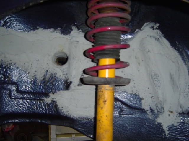

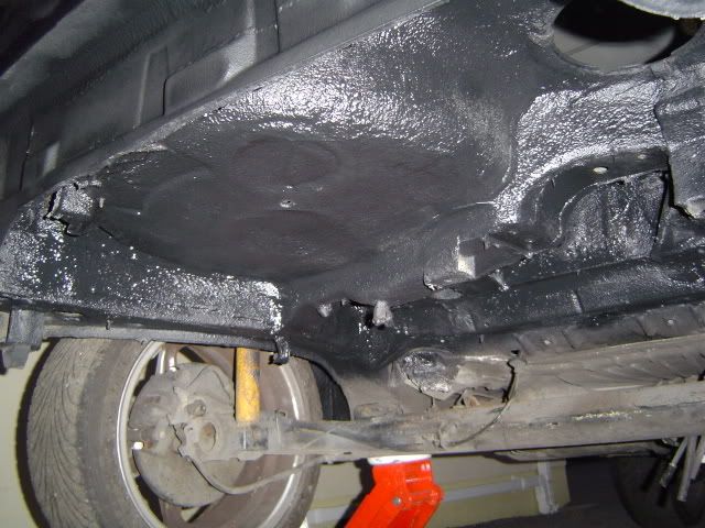

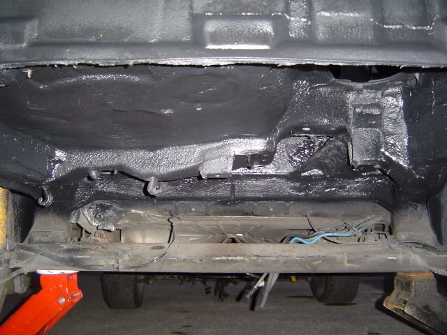

Got some more pics now, its got the bottom of the boot floor all stone guarded and the welds all covered up too

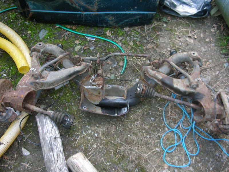

Right a bit of an update, been trying to sort out my front and rear suspension, not the shocks and springs but the hardware fo it.
I have decided to use mk4 R32 front wishbones as they are forged so no need for some seam welding on 13 year old ones, they fit into the vr fornt subframe quite easily with only the sightest modding to them.
these will mount up to mk3 vr front hubs

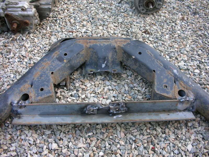

this weeekend i made the jig up to maintain the location for the diff,
i bolted a syncro diff onto the axle i am using, then made a bracket to sit onto the input shaft and bolted it to it
this plate was then welded to a bar which in turn was welded to the beam
i then cross braced it off the beam
then once this was done i could remove the syncro diff and then remove the supporting bracketry for it
the part i made up will maintain the location of the diff for trueness and it just so happens that the haldex diff will bolt to it and then i can make the bracketry up for it.

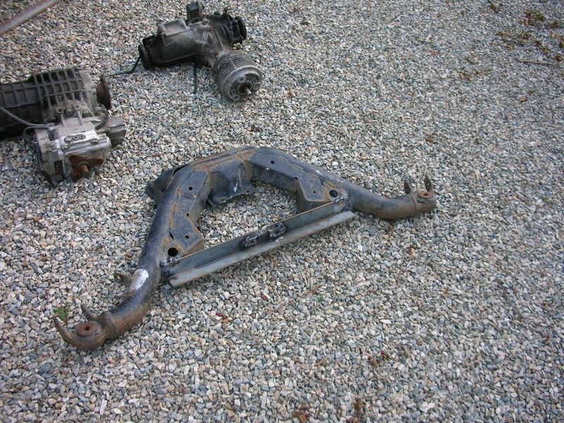

first thing i did was to get out the axle and strip it, take off the ARB and the brake lines and all that stuf and then i bolted a syncro diff to it
here is a pic of the axle with the diff removed and everything else still on it
here it is in the pic, excuse the focus i made a cock of the pic

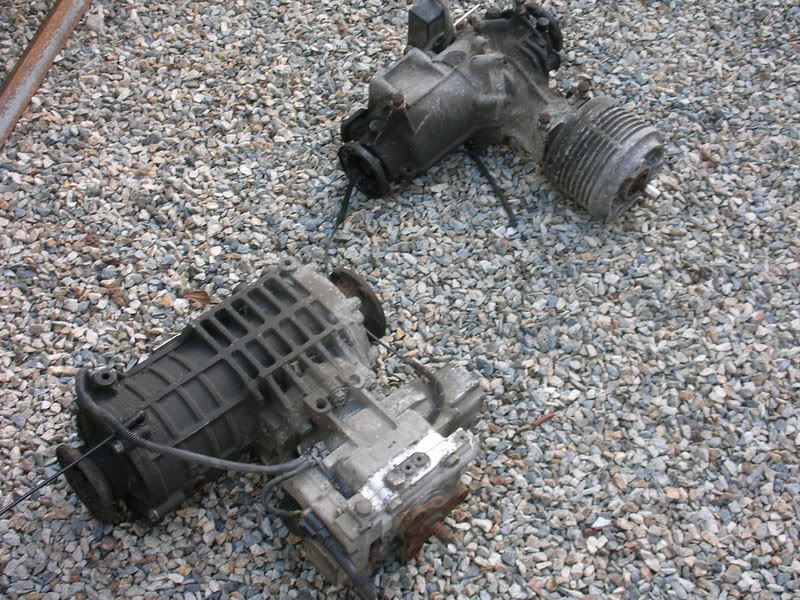

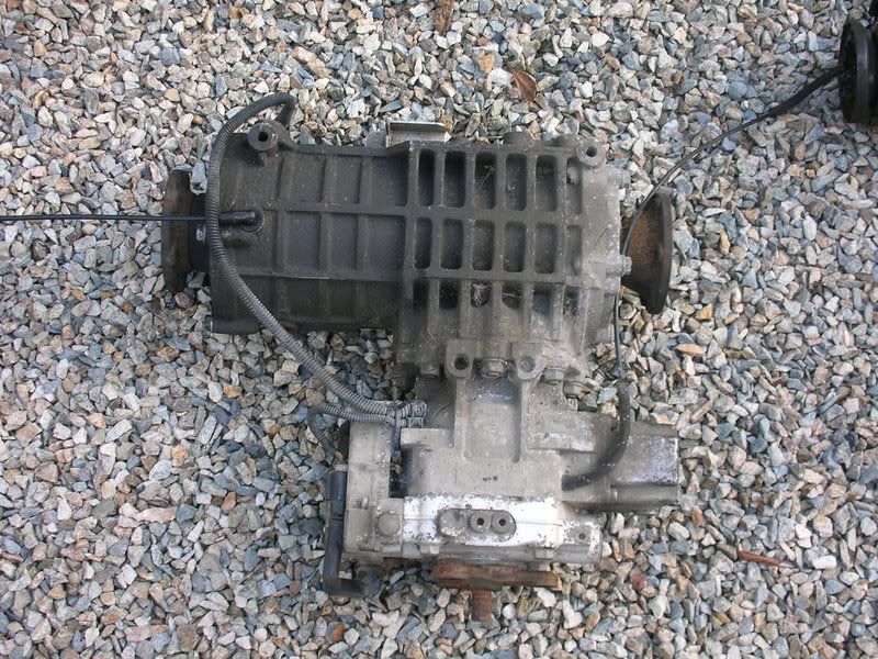

and here is a pic of the Haldex rear diff
you will notice that the bot holes are in a simular place but slightly different
the physical sizes are simular, but the bracketry will all have to be made up

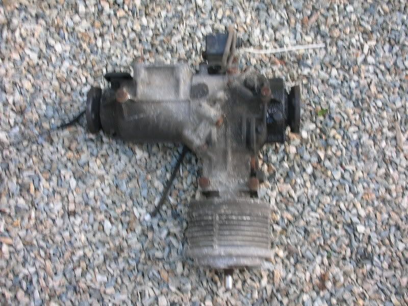

here are the 2 diffs beside eachother
so the shape of the haldex one(closest to the camera) is totally different

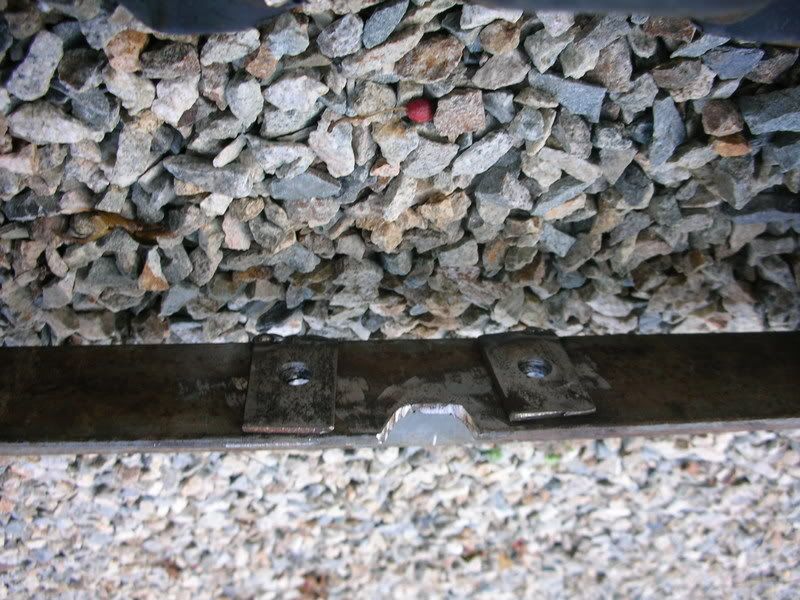

so with the Axle stripped and the diff bolted to it with its 4 bolts i made a bracket to locate it
what i did was get some heavy angle and cut it to the length between the 2 anti roll bar mounts
once cut i then lined it up and drilled two holes in itlining it up with the input shaft bolts for the diff
The haldex and syncro diffs have the exact same bolt pattern
i then built it up with specially made washers till the diff and the bracket were touchingand tightened it home
so at this stage the diff is held by the original brackets and the new bracket is bolted to it and touching the beam
i then welded it on to the beam
then removed the diff and will remove the original bracketry this week and start fabricating the new brackets
here is the bracket that we made up, it looks simple but a lot of time went into making it work 100%
and
and 1 more

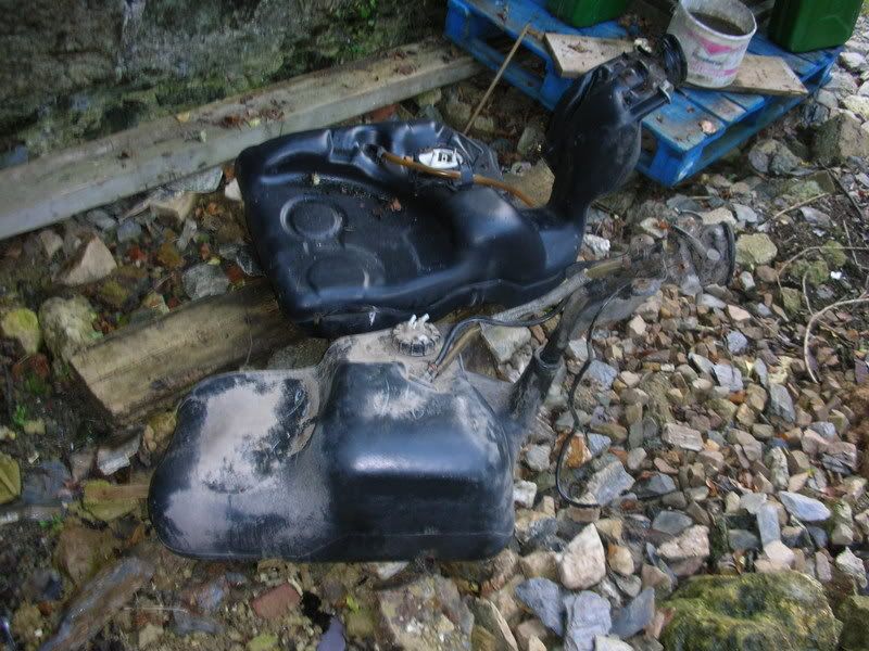

on another note for comparison purposes here is a pic of the 2 fuel tanks, the syncro one is smaller and higher and in the fron of the pic
