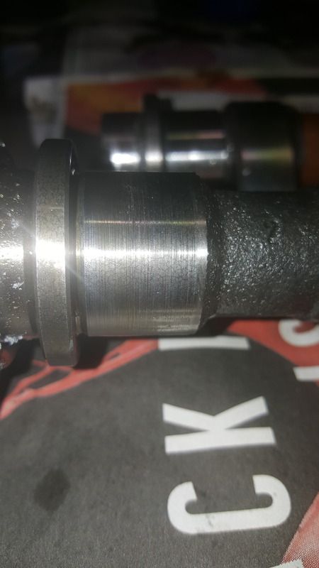

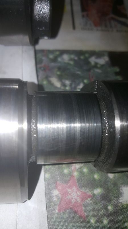

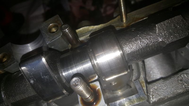

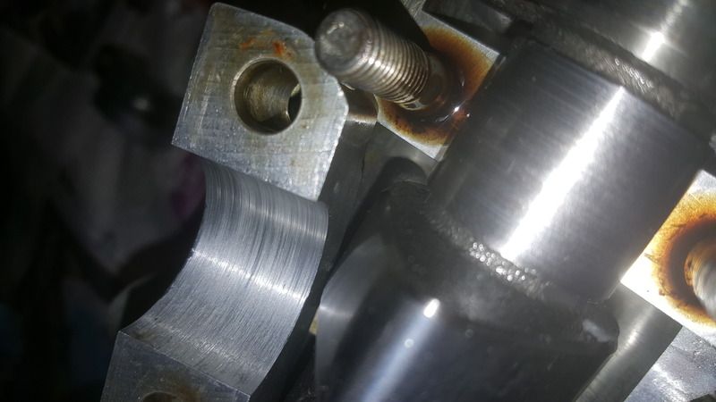

Jim Bowen 1 Posted December 12, 2016 Went and collected the engine back from Stealth last week, they haven't fixed it, just took it apart and took me about the crank etc, i ended up deciding not to get them to rebuild it as i didn't know what was wrong with it and not wanting to risk it again. Got it home and started looking at bits myself and noticed this paint on the head was flaking off when the timing guide was removed, so rubbed it a bit and the paint just flakes off, am now suspecting this is what caused the oil starvation I didn't notice it was painted before, this head came from VEGE, although i bought if off someone else on here that hadn't ever used it (he did have two of these heads for sale so not sure where the other one is?) Took cams out and the head caps are the cams are all scored quite deeply, so guessing all that is junk as well now :( Just going to fit the engine i took out for now, and will have to go back to standard cams. Will take the 263's to a machine shop to see if they can be salvaged and thinking of taking all the valve gear from the head and putting into another head. Not really sure when, losing the will a little. Quote Share this post Link to post Share on other sites
Dox 26 Posted December 12, 2016 I'd say the head is scrap due to the scoring of the cam journals based on the pics shown above. The cams are much harder and may be salvageable with a polish - are the grooves deep enough to that your finger nail falls into them? Are both cams damaged? Someone sells them singularly on ebay if only one is scored Quote Share this post Link to post Share on other sites

Jim Bowen 1 Posted December 12, 2016 Dox said: I'd say the head is scrap due to the scoring of the cam journals based on the pics shown above. The cams are much harder and may be salvageable with a polish - are the grooves deep enough to that your finger nail falls into them? Are both cams damaged? Someone sells them singularly on ebay if only one is scored Yeah, i won't be using the head again, could be paint everywhere. You can feel the scratches in the cams as well. Quote Share this post Link to post Share on other sites
