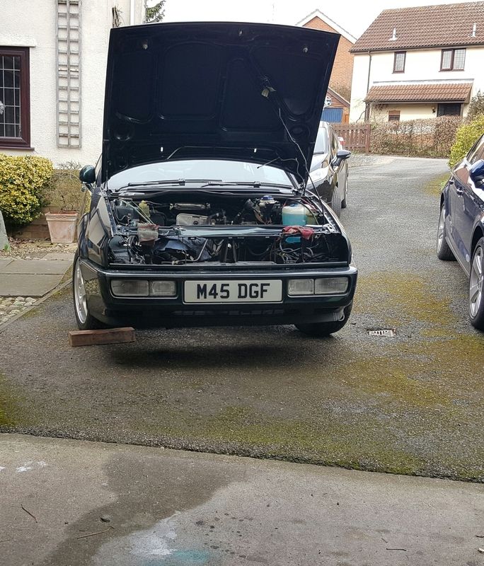

Jim Bowen 1 Posted March 4, 2017 Pushed corrado out of garage this morning, giving it a bit of a clean and sorting out garage ready for putting engine in it. Noticed from the dates that its been sat in garage for a year now. Quote Share this post Link to post Share on other sites

Jim Bowen 1 Posted April 8, 2017 Finally got the spare engine home today. Went straight to work on it, but quite a bit done today. Fitted new lifters, put standard cams back in it, then just swapping a few bits over from previous engine. Got all the timing gear fitted. This engine has a plastic rocker cover and i noticed one of the bolts had snapped in half, not sure how that happened. Decided to put studs from the other engine in so i could use the alloy cover instead. Will get pics sorted out. Hoping to fit it to car next weekend. Quote Share this post Link to post Share on other sites
