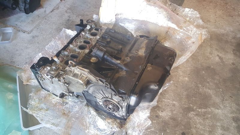

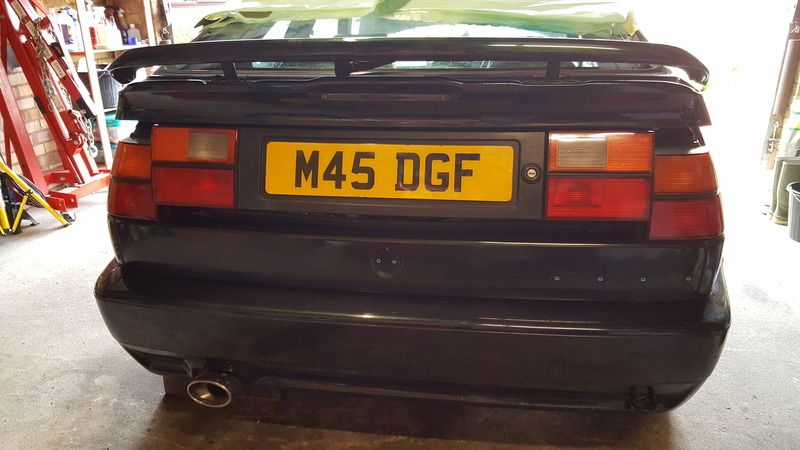

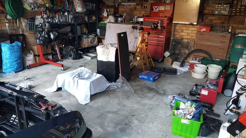

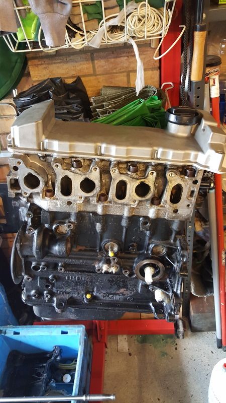

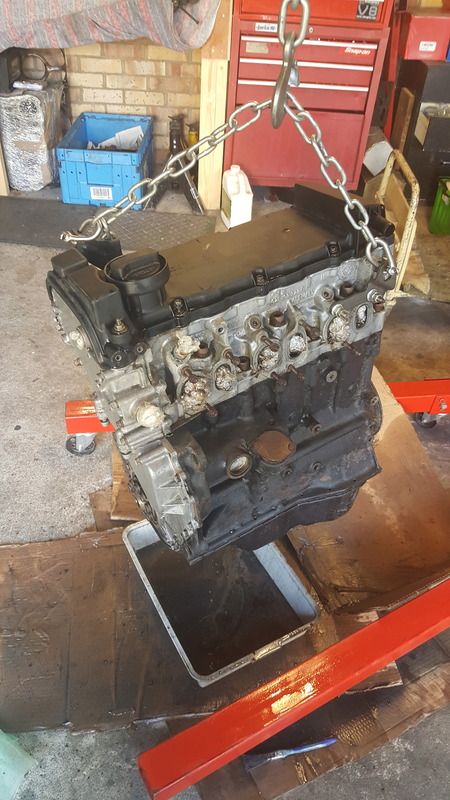

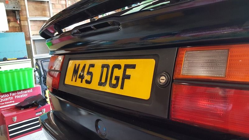

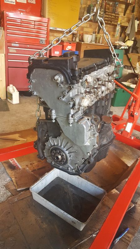

Jim Bowen 1 Posted April 10, 2017 Cheers guys, there is niggle in my head that something is going to go wrong with the engine again. But can only try and see what happens. Some pics, everyone loves a pic right? Engine turned up, been in a container up at a friends unit for a couple of years. Gave it a degrease and steam clean, not going to bother painting it. Fitted the alloy cam cover, have put new lifters in and swapped over the timing gear from my other engine as it was all new stuff. Car got to see a bit of sunshine The mess, can see the engine on the left, ended up fitting most bits to it, had to stop as need new flywheel bolts, could probably be ready to fit it to car next weekend. Thanks dad for the garage!!! Quote Share this post Link to post Share on other sites

Jim Bowen 1 Posted April 10, 2017 Am interested to see how this one sounds, as this is the one that had the top end tappy noise we dislike. But it had the 263 cams at the time and i've just put standards back in. Quote Share this post Link to post Share on other sites
Jim 2 Posted April 10, 2017 I don't want to break your morale any further on this but returning to OE cams, new tappets and even a new head (was replaced during the last rebuild) and that damn noise persisted on mine. The strangest thing about it all though was that the noise wouldn't be present initially for the first 50-100 miles or so and would gradually return, as the tappets broke in. I'd genuinely give my right testicle to understand what causes it to happen on some VR's and not all of them and more importantly how to fix it once and for all. Quote Share this post Link to post Share on other sites

g0ldf1ng3r 17 Posted April 10, 2017 Jim Bowen said: Am interested to see how this one sounds, as this is the one that had the top end tappy noise we dislike. But it had the 263 cams at the time and i've just put standards back in. FYI my VR didnt seem to sound any different on startup to OE with the 263's installed it has always sounded quite loud & tappy on start up but the tappy settles down after a short while, this is usually around the time when the ECU eases off the choke & revs settle to normal tick over Quote Share this post Link to post Share on other sites

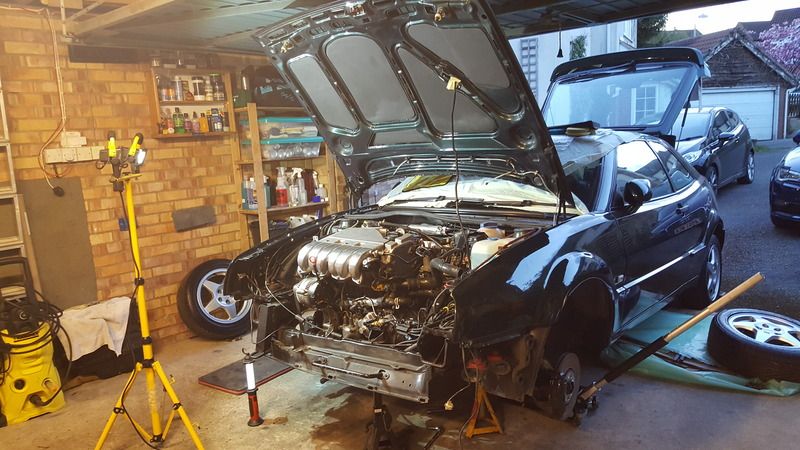

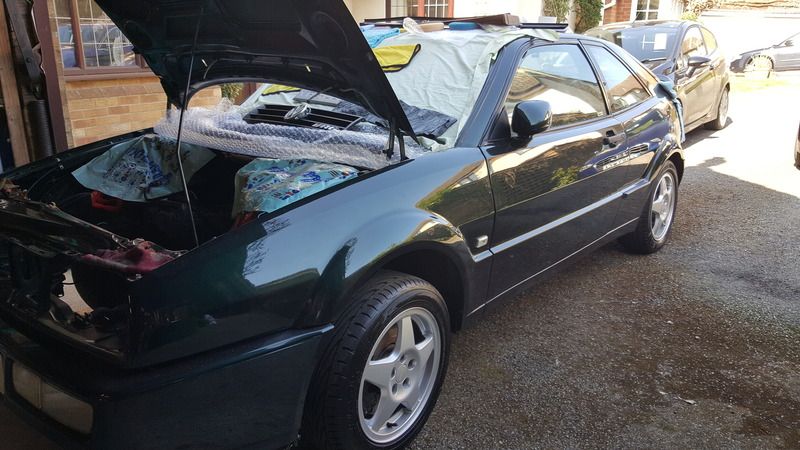

Jim Bowen 1 Posted April 15, 2017 Been at it all day, got engine in. It's a bit of a fiddle on my own but manage it with a bit of patience. Just stopped for the evening, should be running by Monday Quote Share this post Link to post Share on other sites

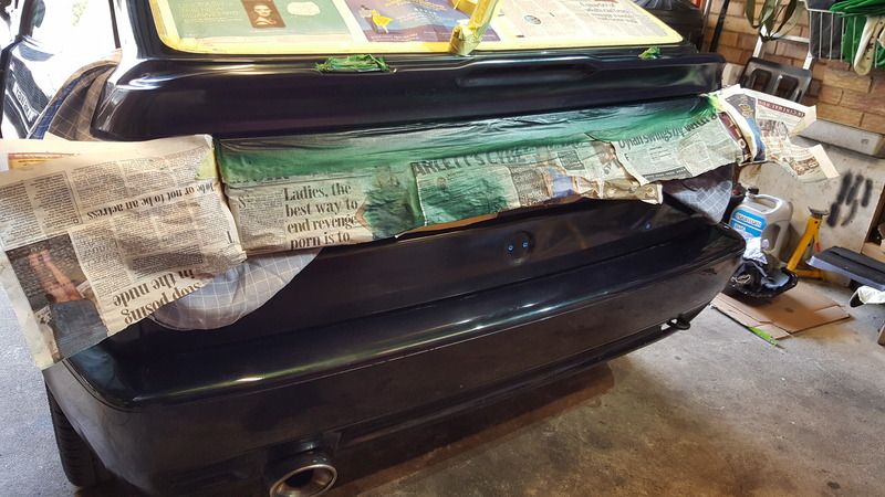

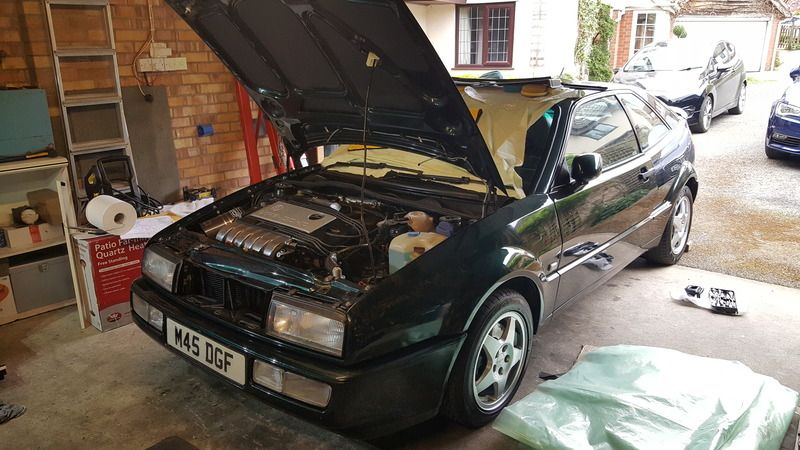

Jim Bowen 1 Posted April 16, 2017 Another day at it. Started about 11.30am, the little bits seem to take the longest, i did machine polish the bumper before fitting and have been spraying underbody wax on everything as i fit it together. Got to fit an oil filter and then should be ready to start. Quote Share this post Link to post Share on other sites
Jim Bowen 1 Posted April 17, 2017 Fired it up today, had a few issues but got them sorted. Somehow had the + and - connections to starter motor touching each other, so went connected the battery got a lot of spark and i presume the starter motor going mental, sounded like the aux pump whirring. Was rather loud at first and ran really lumpy, but sorted itself out, i turned it off and let it cool and started it again and it was much better, quiet and smooth idle, but when the cooling fans kicked it it started to rev itself up, and then let out a big pop/backfire that seemed to come out the air filter (bmc) and then died. Restarted ok, but turned it off and left it for during the evenings next week. Am sure it just needs a long drive. Thinking about disconnecting one of the spal fans, seems to put a big load on battery when both fans kick in Quote Share this post Link to post Share on other sites

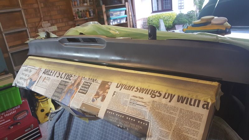

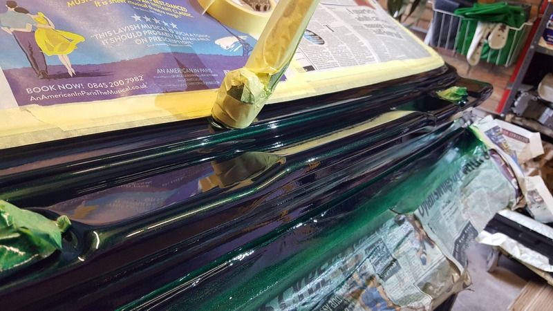

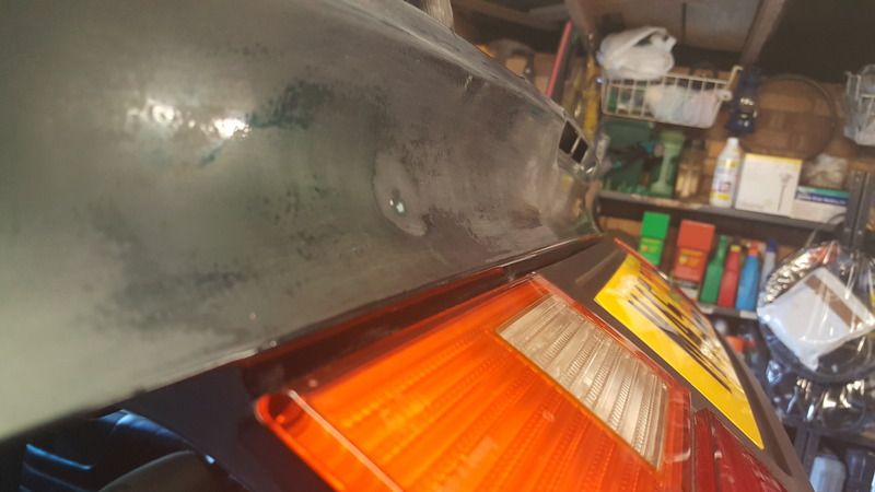

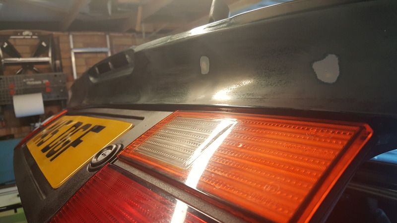

Jim Bowen 1 Posted April 24, 2017 Cheers Jim, I think its all ok, starts up fine and idles quite smooth, i've disconnected one of the Spal fans for now. Not really done much else, doing little things like sticking trim back on, indicators etc. Also painted one of the last bits of bodywork that was annoying me. Had a few rust spots/bubbles in the paint. Needs a polish to get rid of a bit of orange peel. Need a chip fixed in the new windscreen (not sure how i got some many chips in it already, hardly driven it).. Will probably get mot done in a couple of weeks time. Quote Share this post Link to post Share on other sites
Jim 2 Posted April 24, 2017 Are you just rattle canning it, or do you have a compressor / spray gun? Literally had my first go at a bit of a rust repair on the BMW last weekend and whilst the spot isn't rusty any more, I can't say much more complimentary about my spray work! Quote Share this post Link to post Share on other sites
Jim Bowen 1 Posted April 24, 2017 Just rattle cans, i don't want to fork out for a respray yet. TBh when it is respray time i think i'll buy all the gear and do it myself. I just don't believe other people you pay are as enthusiastic/anal about it as i would be. Quote Share this post Link to post Share on other sites
