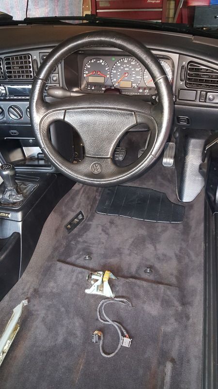

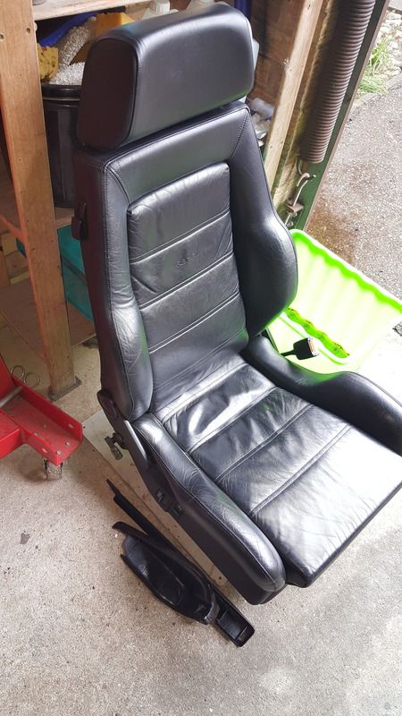

Jim Bowen 1 Posted May 7, 2017 I think in the summer when car is all running and in use i'll spend more time sorting out the overspray/orange peel. Had it out quickly last weekend, just up the road and back, noticed fluid dripping onto mu foot from the clutch pedal, so changed the master cylinder this weekend. The new master cylinder, not listed for a corrado but fitted fine Just need to bend the pipe to fit the new master, as the hole is in a different place. bit hard to see Old New Took the seat out while i was there, gave carpet a quick clean and the seat a wipe Not bad considering its the original drivers seat and car has done about 230,000miles Quote Share this post Link to post Share on other sites
easypops 8 Posted May 8, 2017 Love all the work you have done/are doing. I hope one day to be at your level 8) Nice seats btw :) Quote Share this post Link to post Share on other sites
seanl82 23 Posted May 8, 2017 Good to know Jim, I want to replace mine so nice to know there are alternatives. Seats look very respectable too! Quote Share this post Link to post Share on other sites

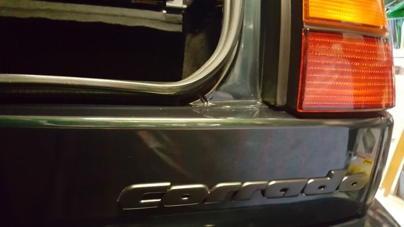

Jim Bowen 1 Posted May 8, 2017 Put the corrado badge back on. Still got the vr6 one to stick on. Repainted it in halfords satin black Quote Share this post Link to post Share on other sites

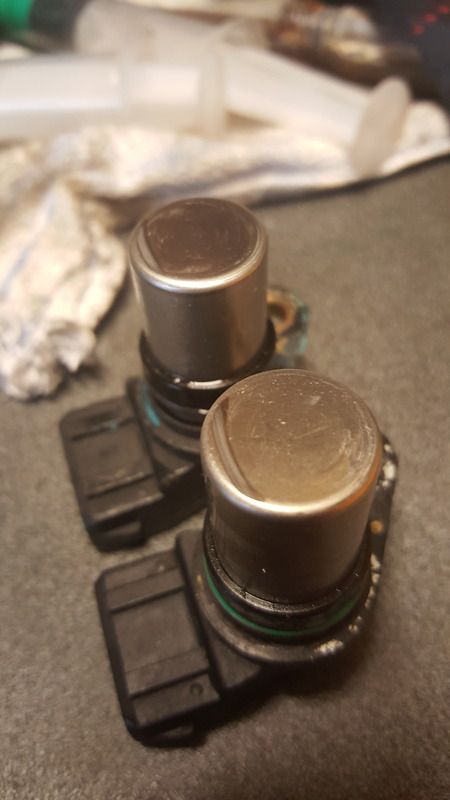

Jim Bowen 1 Posted May 29, 2017 Right this is weird. When i took the old sensor out i noticed a scuff mark on it, the one i put in definitely didn't have a mark on it as i checked. Now the one i put in, also has the same mark on it. Must be something in engine hitting it, so will have to look inside engine i guess. Could only be the cam wheel or the sprocket bolt is backing out. Quote Share this post Link to post Share on other sites
robrado974 1 Posted May 29, 2017 That is strange Jim . Surely if something was hitting the sensor, that part could not be working properly it's self ?, i.e. The engine would not run properly aside from lumpy running , because the part was not seated in its place . Hopefully when you have a look the problem will reveal its self . Quote Share this post Link to post Share on other sites
Jim Bowen 1 Posted May 29, 2017 Will try and get cam cover off tomorrow evening. Not totally sure but might be the bolt holding the sprocket on is loose and slightly hitting the sensor which pushes it back in a bit as it spins. I know i didn't thread lock them this time, which I've done in the past. Quote Share this post Link to post Share on other sites
