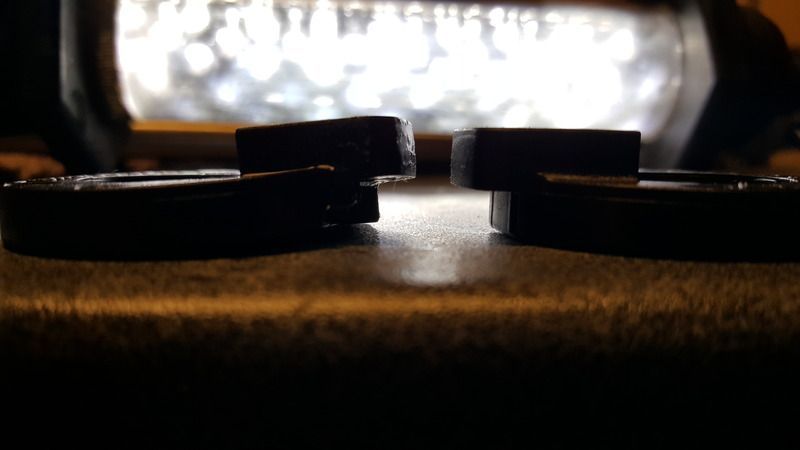

Jim Bowen 1 Posted June 1, 2017 Cheers Jim, I have about 3 of them already :lol: Found that the plastic pickup wheel fixed to the sprocket was cracked, not sure, but think it could be that hitting the sensor (i keep changing my mind) but this seems to make the most sense as it didn't seem to be hitting all the time, so maybe its distorting when hot/high revs?? Seems a hard part to find, i have one on the schimmel cams but can't get the bolt out, brought the bits into work today to see if i can do it. Quote Share this post Link to post Share on other sites
Jim Bowen 1 Posted June 1, 2017 Was the trigger wheel. Must've slipped off the notch slightly and I've tightened it which has bent it. Comparison pic Quote Share this post Link to post Share on other sites

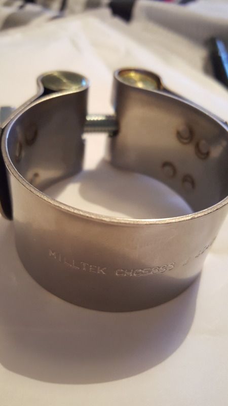

Jim Bowen 1 Posted June 1, 2017 In other news my clamp turned up Still waiting for the other part that it clamps to arrive. Quote Share this post Link to post Share on other sites
