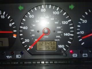

vwdeviant 0 Posted June 20, 2007 just thought I'd post this pic as it made me laugh! Weird thing was, I was actually sat in the carpark at my local VW dealer at the time when I noticed it :lol: :lol: What you mean made you laugh you were actually in it? :lol: Actually I can't talk been so long taht my battery's kaput! :oops: And won't be out for Mimms either as didn't have insurance cert to hand to go to DVLA with.. :grr: Quote Share this post Link to post Share on other sites
herisites 0 Posted June 20, 2007 Nice one :lol: Just a shame you cant quite get 789 miles to a tank of fuel :roll: :lol: Quote Share this post Link to post Share on other sites
mic_VR 3 Posted June 20, 2007 Nice one :lol: Just a shame you cant quite get 789 miles to a tank of fuel :roll: :lol: That's the stuff of dreams there Rob....... 789miles on one tank :shock: . As you can see in the pic I didn't do too badly on that tank. Averaged 31mpg but I have been driving like a granny in a vain attempt not to break anything else! Quote Share this post Link to post Share on other sites
herisites 0 Posted June 20, 2007 Nice one :lol: Just a shame you cant quite get 789 miles to a tank of fuel :roll: :lol: That's the stuff of dreams there Rob....... 789miles on one tank :shock: . As you can see in the pic I didn't do too badly on that tank. Averaged 31mpg but I have been driving like a granny in a vain attempt not to break anything else! Yeah you havent done bad looking at that, still got some left as well. me on the other hand, i dont know how much fuel i have as my sender has packed up so i have to guess :shock: i usually just work it out by what mpg i average lol, im on 28 mpg at the min and getting very close to empty i reckon so hopefully i get it to a petrol station in time :roll: :lol: Quote Share this post Link to post Share on other sites

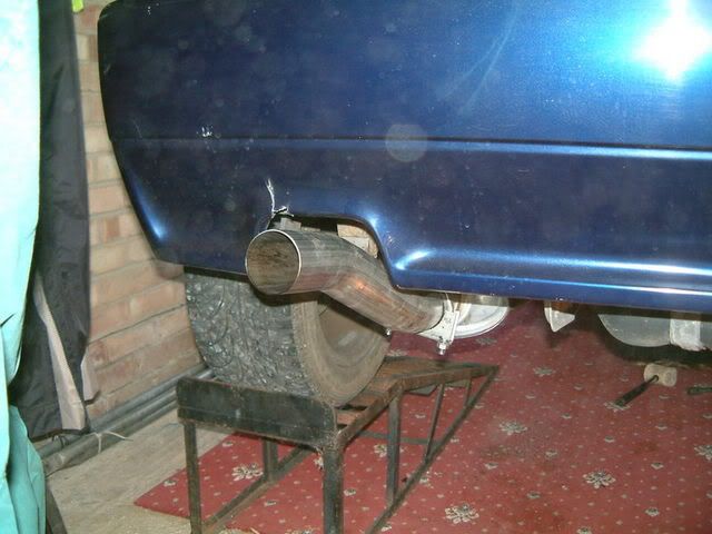

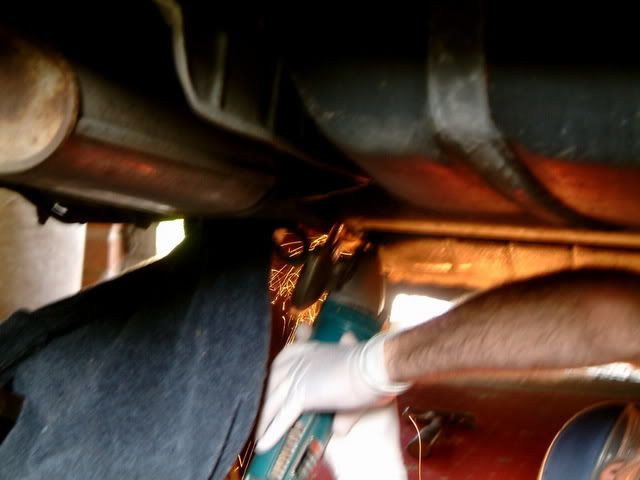

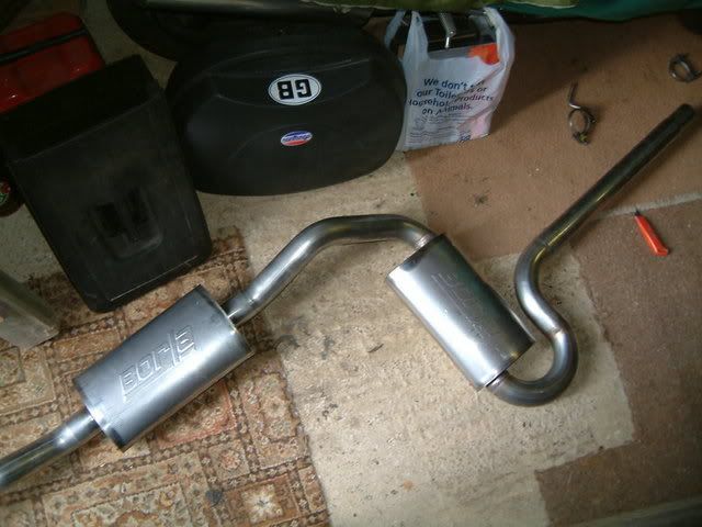

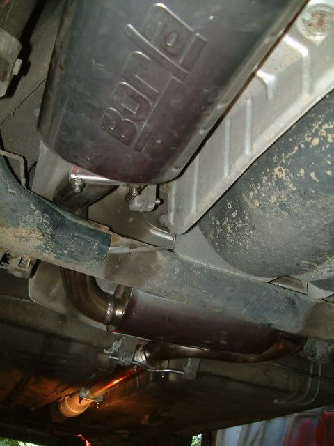

mic_VR 3 Posted August 11, 2007 Ok well after months of gentle blowing and various holes with various repairs, it's finally come time to get rid of the original exhaust off the VR and replace with something a little bit special. Namely a Techtonics Tuning full stainless system with dual Borla mufflers all the way from the US of A! :D It's a 2.5" full bore straight through mandrel bent system with no crimps or other dodgy stuff to stop airflow. Not cheap but ideal for when I finally get the turbo on it. So the old 'suitcase' mid box was looking fairly unhealthy, And after a few mins (i give up easily!) of the old hacksaw it was over to something a bit more heavy duty! Luckily I had the old man around to give me an extra pair of hands in a bit of a tight spot and the rest of the system came off without a problem. Then this bad boy had to be fitted, and tbh it was a lot easier than I was expecting. Maybe it was just because it was so well made or maybe I was just lucky but it seems to have lined up and apart from a little blow at the point where the new system meets the cat it's all working perfectly. So before fitting, And once fitted Obviously I'll need to sort that crack in the bumper now.... Sounds good, nice rumble from idle to about 3000rpm then a nice bark. But when cruising its OEM silent which my Dad was a little shocked at :lol: When we were fitting we decided to weigh the old and new systems to see the difference. Old system weighed in at 21KG but amazingly the new system weighed in at just 9.5KG! That's he kind of figures I like! 8) Quote Share this post Link to post Share on other sites
staffs_til_i_die 0 Posted August 12, 2007 Looks good. Did you get it off eBay? How much was it to ship over? Quote Share this post Link to post Share on other sites
mrbeige 0 Posted August 12, 2007 Fair play Mic,that looks good. Might have to sell the magnex and get one of them buggers. Quote Share this post Link to post Share on other sites
mic_VR 3 Posted August 12, 2007 Cheers gents, I am rather pleased with it even though it was not the cheapest option. It was $840 for the system and delivery for the extremely nice people at Schimmel Performance, and then I had to pay £80 in duty & VAT when it made it to the UK. So about £500 all in but well worth it if you ask me. 8) Quote Share this post Link to post Share on other sites

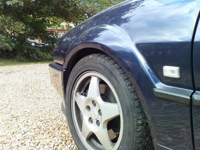

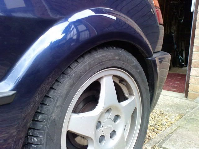

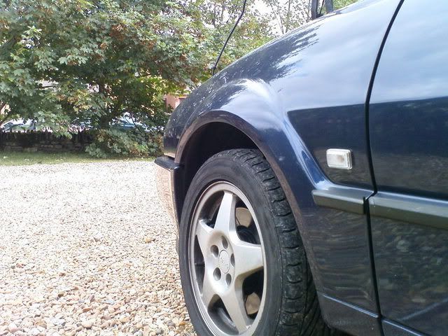

mic_VR 3 Posted September 2, 2007 Stunning - love it! Ahh you're making me blush! :lol: Well a bit more work done on the car this weekend as I couldn't get along to E38. Basically went from this To this! And also fitted some clear side repeaters. Suspension is a set of Weitec Ultra GT's (shocks & springs) with a drop of about 40mm all round, all kindly provided by Marcus. Fitted in part in a friends workshop although had to finish off on my parents drive as it took a fair bit longer than I expected, but fairly lucky as had no problems with rounded bolts or the such like. Only main problem was the fact that it was too low to get off of the parents drive after it was lowered without a good old scrape of the front spoiler..... maybe time to source a 50mm one! :lol: The old springs looked in really good order but the shocks and the rubber mounting were all pretty much shag**d, but replaced with VW parts all round along with all new bolts etc so should be good for a few thousand miles yet. Just need to get the tracking done now then I'll let you all know how it drives and maybe get some more pics up as well. Quote Share this post Link to post Share on other sites
vwdeviant 0 Posted September 3, 2007 Only main problem was the fact that it was too low to get off of the parents drive after it was lowered without a good old scrape of the front spoiler..... maybe time to source a 50mm one! :lol: You'll get used to that sound Mic, don't worry.. Splitters are made from tough old stuff. You'll now have to learn the art of Speed-hump driving... Car looks good shame Little Boris and his family have been evicted though... or have you put them to good use elsewhere? Quote Share this post Link to post Share on other sites
mrbeige 0 Posted September 3, 2007 Well, that does look better! Glad you got her sorted after our aborted effoprt the other night! Quote Share this post Link to post Share on other sites
staffs_til_i_die 0 Posted December 27, 2007 What's the ride like with the new set-up? Is it fairly smooth, or do you have to pucker up regularly? Quote Share this post Link to post Share on other sites
mic_VR 3 Posted January 5, 2008 On everyday roads the normal ride is absolutely perfect, nice and firm when needs be but with enough give not to be jarring. Only issue I have with the setup at the moment is that it was supposed to be a 40mm drop but now its settled (and after seeing an actual 40mm drop at the stealth RR day) its definitely more like 60mm+ which does mean that I manage to scrape the front splitter in pretty much everything as ground clearance in the centre of the splitter is down to a lowly 30mm! :shock: On the plus side the noise makes my dad wince everytime I even try to get it in/out of the parents drive which is always funny, and it looks so much better. :lol: 8) Quote Share this post Link to post Share on other sites
