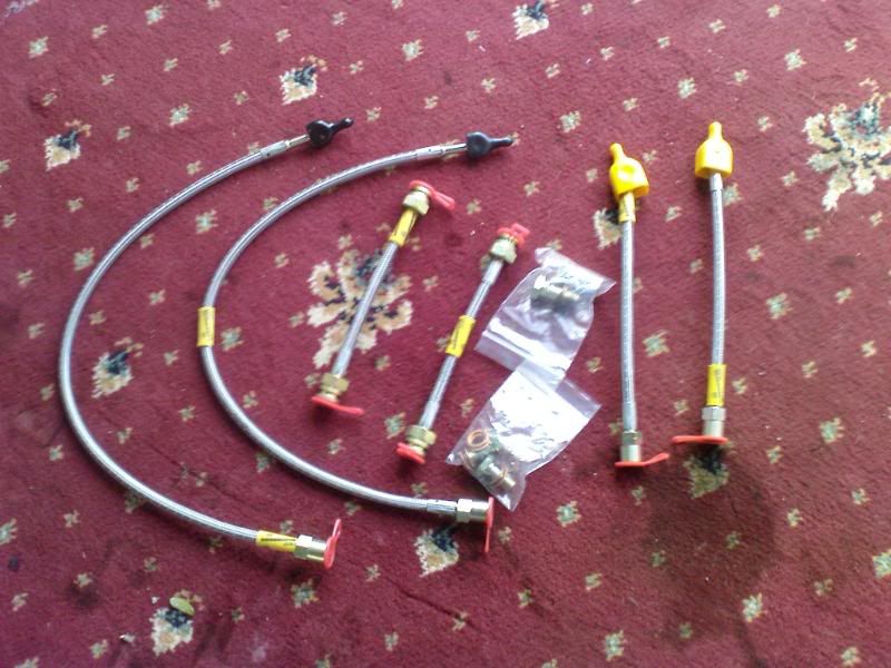

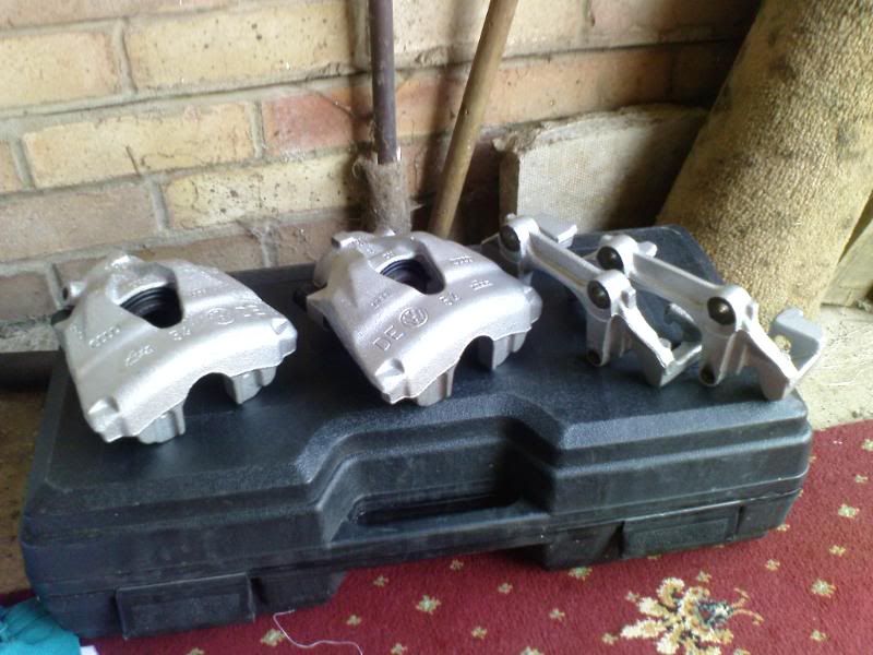

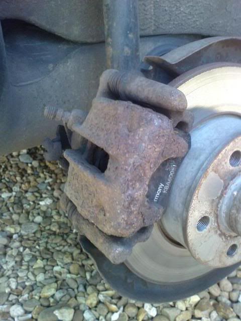

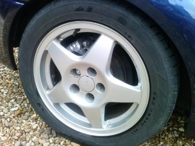

mic_VR 3 Posted August 8, 2008 Well after a busy couple of weeks I thought I'd better update my thread for what I've been doing to VR. Firstly brakes - Replacing fronts with 288's and EBC Redstuffs, replacing rears with mk4 calipers, and fitting Goodridges all round. Pics from Start to finish. Sorry I'd already put the wheels back on :) Mucho thanks go out to everyone who offered help and advice, especially Supercharged for lending me some tools and for a couple of phonecalls :notworthy: Quote Share this post Link to post Share on other sites

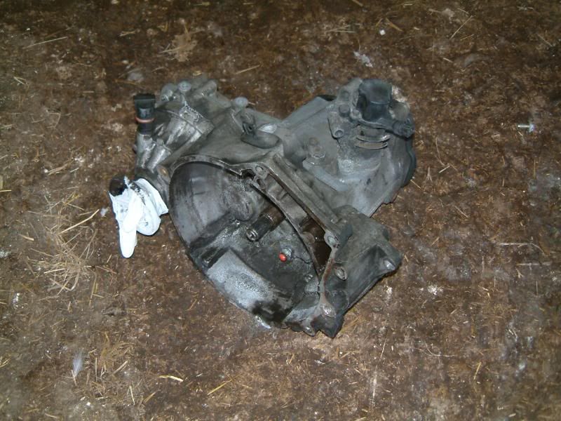

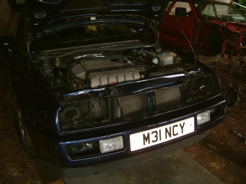

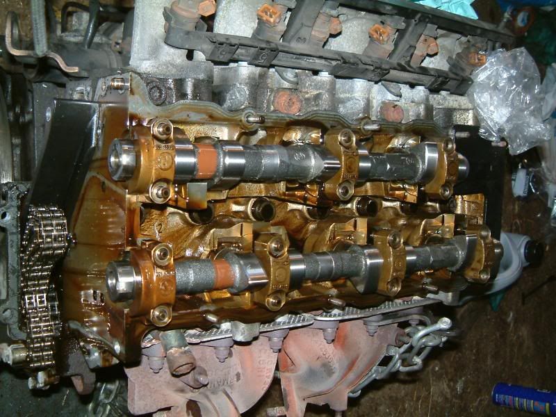

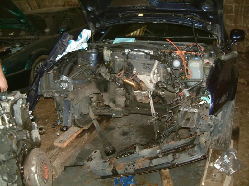

mic_VR 3 Posted August 8, 2008 And Secondly the cams and gearbox. HUGE thanks to Mr Toad for giving up a whole weekend to work on my car, even with his bad foot! And to Dinkus for sourcing some parts for me and letting me steal a Chain guide out of his set when we found mine had snapped. Again, pics are kind of in order although I didn't get many shots of the engine out/cams/guides part as it was getting a little to close for comfort as to whether I was going to make it home on sunday or not! :lol: So take a nice whole car, and just start removing stuff! It's at this point that we realised that my engine wiring loom has been butchered by some cowboy and we had to remove all the wiring from the engine inorder to remove it, all good fun! :? Replacment gearbox New cams fitted and timed up ready to go! We found a nice big crack in one of the chain guides whilst doing the cams but luckily Dinkus had some emergency parts that I could steal. Then you simply put in all back together again, Easy! :wink: Glad to say that the gearbox is a beauty, thanks nemesis360, and the car now shifts as smooth as silk. As for the 263 cams, it's not a night and day difference (not had a remap yet) but I'm definitely getting a wider spread of power and the car is feeling a lot more urgent in the 2500-3000rpm range. Fuel wise it's not made much difference, still getting over 30mpg and I've been driving a bit harder than usual in it... so overall extremely pleased with them :D Unfortunately we did find a few issues that we didn't have the time/parts to fix, including a really worn tensioner guide and my chains have stretched putting the timing out just a fraction, a bit of rust on the cross member, a tiny tiny leak from the water pipe in the oil cooler, my aux water pump is shot and the serp belt had seen better days....... but thankfully most of this is easy to put right and I'll be doing some more work on it over the next few weekend. Phew! Quote Share this post Link to post Share on other sites
mic_VR 3 Posted August 8, 2008 Looking gooooooood dude! 8) So how much better is the stopping then? It's amazing how much difference the 288's and Goodridges have made, highly recommend it as a mod and feeling much more confident to take it on the ring now. I'll take you out for a spin in it as soon as you're feeling better chap! Quote Share this post Link to post Share on other sites

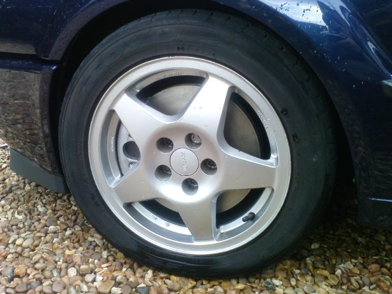

mic_VR 3 Posted August 16, 2008 Well I'm not sure what people are going to think of these but since I haven't been able to find any alloys I like I've decided to go a bit more.... old skool.... Originally I was going to band these, and even sent them away to get done, but having seen a set done and after conversations with the company about the trouble they were having getting them pressure tested and legalised I decided I'll run them as vw intended. As far as I can tell they don't weigh anymore than the original speedlines and they drive fine, I'm going to put some spacers on the rears to fill the arch's a bit better but the fronts seem fine. Honest opinions please people, :D Quote Share this post Link to post Share on other sites
KADVR6 0 Posted August 16, 2008 i bloody love steelies on a corrado 8) in fact seeing those i have decided what my winter wheels are going to be. oh yeh are they 16's?? Quote Share this post Link to post Share on other sites
mic_VR 3 Posted August 16, 2008 Yep, 16x6.5J (off a 2005 Beetle TDi) with 195/45 Goodyear Eagle F1's. The way I figure it they'll be fine until I find some fancy wheels I like and my speedlines were losing air all the time after a few years being bashed about by various owners. Glad you like! Quote Share this post Link to post Share on other sites
