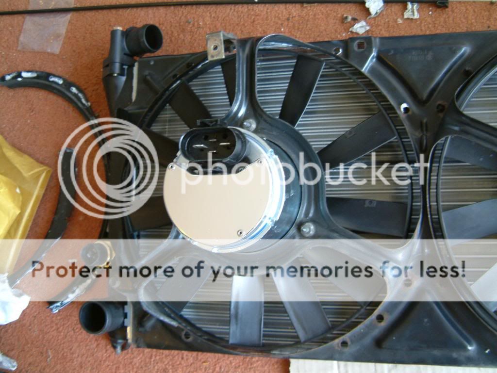

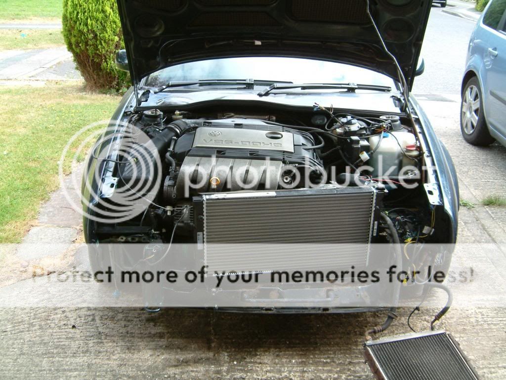

Dan_Storm 0 Posted July 12, 2013 Thanks for the tips. Money is a bit tight, so I've gone with a standard crackpipe. I've had a weep from the rad elbow for a while now. The elbow and o-ring aren't too old, so I suspect it is actually the radiator at fault. I've ordered a new rad, elbow and o-ring. My thermostat and housing aren't too old, so they should be good for a bit longer. Quote Share this post Link to post Share on other sites

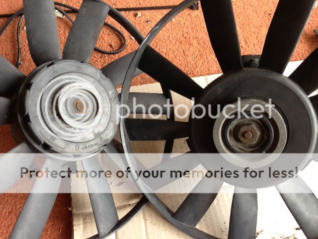

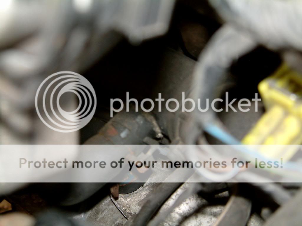

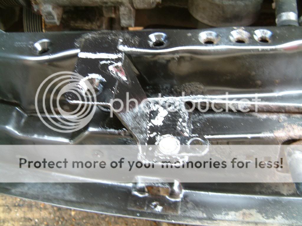

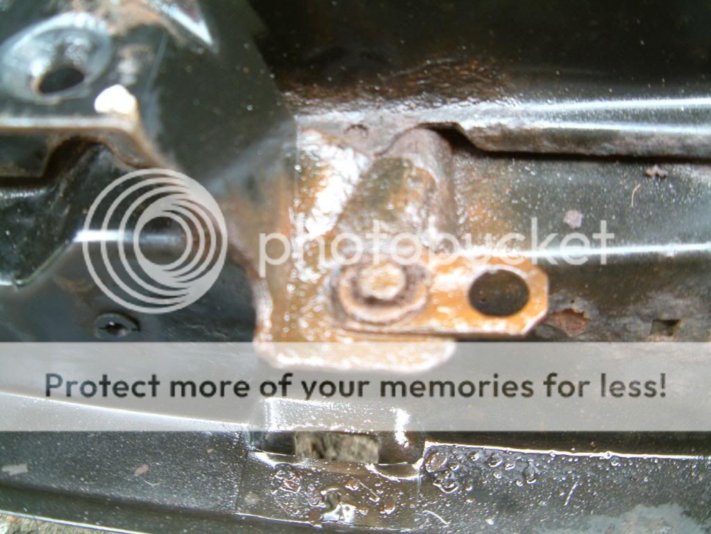

Dan_Storm 0 Posted July 14, 2013 I've had a busy weekend stripping everything down, all went very well until I got to the bonnet cable! The cable clamp was badly rusted, I gave it a soak in Plusgas then tried to release the bolt holding the cable on, but it sheared off :( I tried drilling out the rest of the bolt but ended-up damaging the cable in the process, so I'm now after a new bonnet release cable. As suspected, the leak was coming from the crackpipe. There was a split where the T-piece comes off to the oil cooler. I've got quite a bit on order ready for next weekend. I'd like to replace more and get the metal bits powder-coated, but it will have to wait till next year. I've decided to replace the coolant temp sensors while I have the thermostat housing out. I've had a new thermostat sat in the garage for years, so I will use that even though the old one seems to be ok. The housing is in good condition, so that will be going back on with new seals. Quote Share this post Link to post Share on other sites
