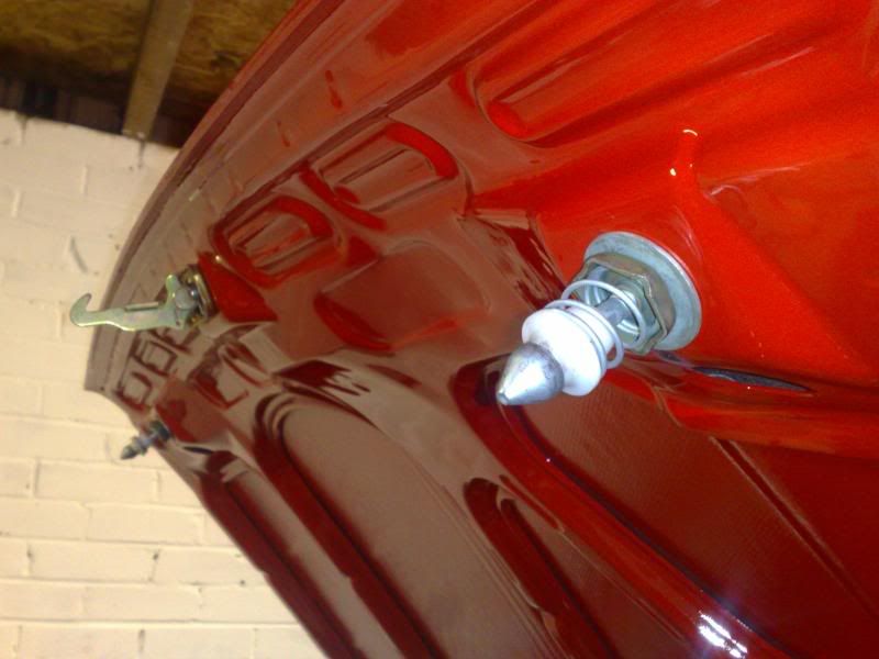

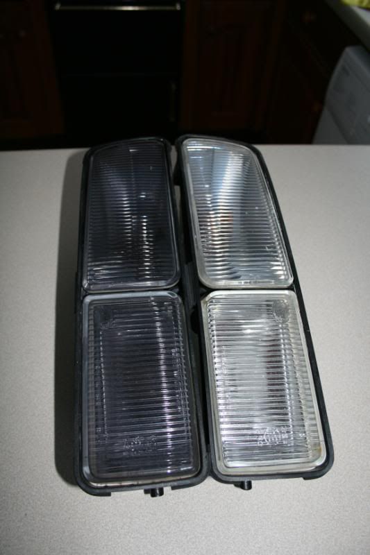

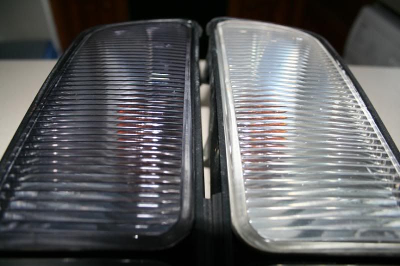

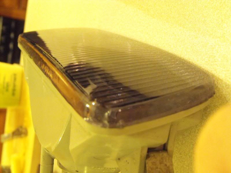

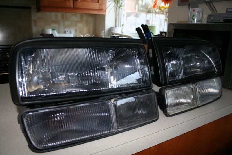

CorradoVR6-Turbo 0 Posted January 10, 2010 junkie said: I love your daily :luvlove: I know you do,it must be the shade of green :tongue: Well the car should be painted this month the lads say! :cheers: then its the mission to reassemble the lot,but im doing this at work in the body shop....nice and warm,lots of room to work around etc :D Ive also accumulated a selection of new parts to go back on...... New bonnet pin strikers New Bonnet centre catch New Corrado script covers New chrome door latches and striker pins. New Sekurit windscreen New windscreen seals New seals for wing mirrors New seals for door handles Various new nuts and bolts. New arieal base with seal. Also Ive bought some Lamin-x of Neil to give my headlights and fogs/indicators a subtle tint as this does suit red very well. But before i applied the tint to my indicators have uou noticed that the all the product info,number etc are raised on the plastic indicators? well i did not want to apply the tint over them to find the stick out like a sore thumb,so i ground them down,and repolished the plastic with wet and dry and i tell you what it looks great and like new as you remove all the years of road abuse. 8) As for applying the Lamin-x its real easy but heat is your friend and it stretches around corners etc so easily when using a hot air gun,well impressed with it. 8) Also it makes pitted glass look like new... 8) Later Share this post Link to post Share on other sites
StormchargedVR6 0 Posted January 10, 2010 Nice work james , tryed the Lamin-x myself but never stuck on the corners even with heat? look good for few days then lifted. Tryed everything to get it perfect Gave up in end :? DSCN0778.JPG[/attachment:1usoms3i] Share this post Link to post Share on other sites
CorradoVR6-Turbo 0 Posted January 10, 2010 time will tell,but it stuck on very well,no signs of lifting at all. :shrug: Share this post Link to post Share on other sites
coullstar 0 Posted January 10, 2010 Looks good, was thinking of doing the same to my indi's & fogs to match the headlight cover. Share this post Link to post Share on other sites

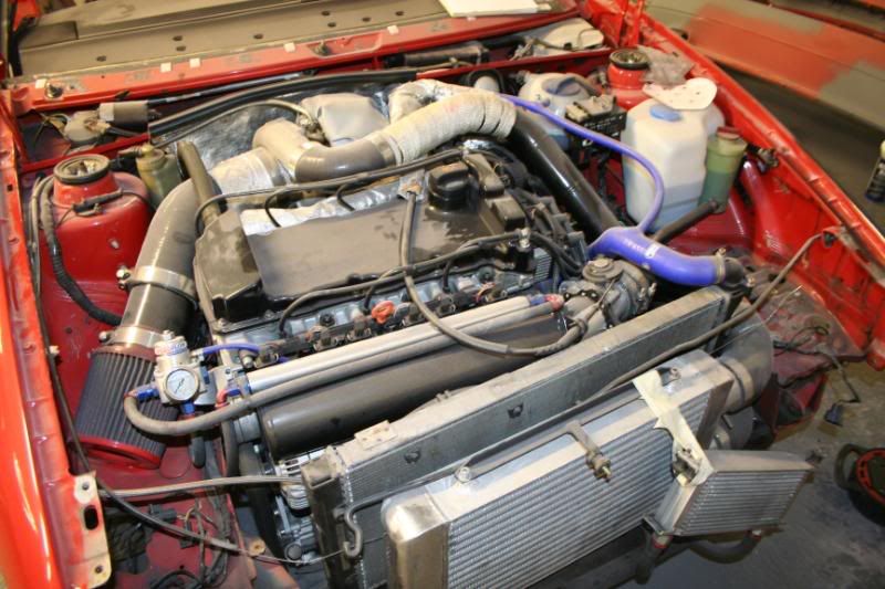

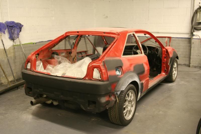

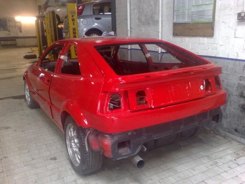

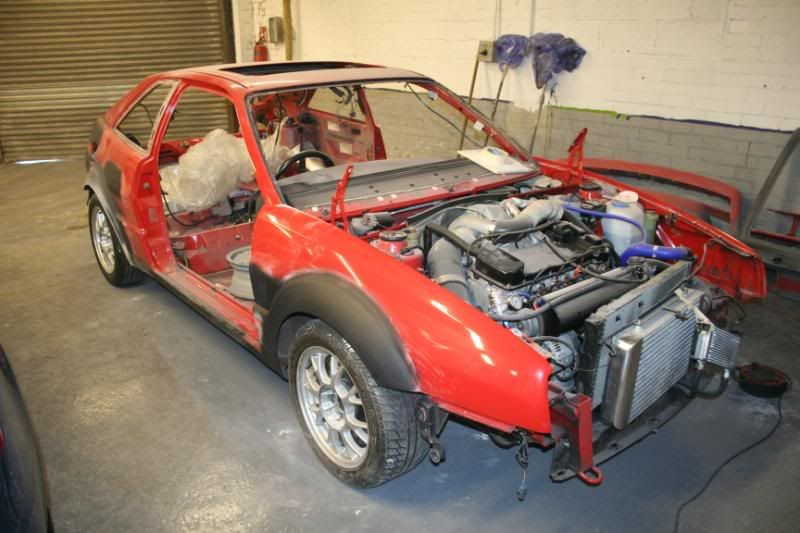

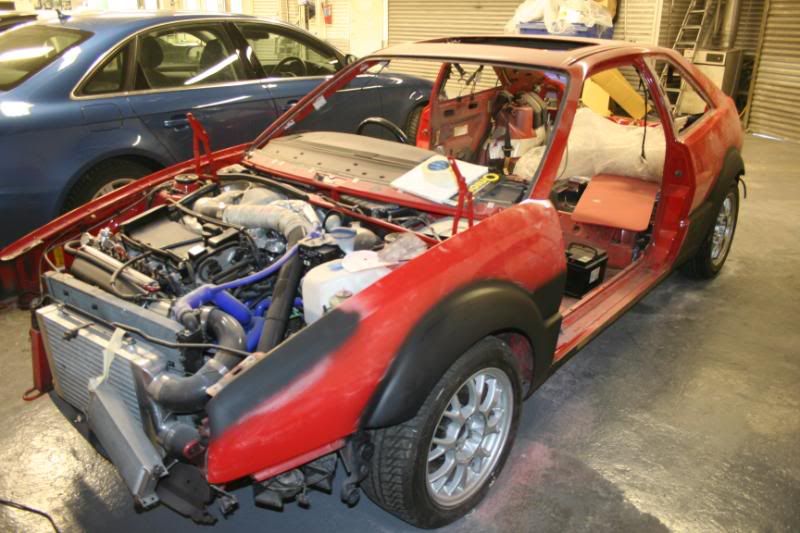

CorradoVR6-Turbo 0 Posted January 17, 2010 not been doing much bar tinkering... randoms from work... Engine has not been ran for months now.... :( Share this post Link to post Share on other sites
MK1Campaign 0 Posted January 17, 2010 Nice to see youve gone to the trouble of removing all the glass. Share this post Link to post Share on other sites
pete_griff 0 Posted January 17, 2010 looking great James - not long until it's gets sprayed now so you can put it all back together surely... :D Share this post Link to post Share on other sites
CorradoVR6-Turbo 0 Posted January 17, 2010 MK1Campaign said: Nice to see youve gone to the trouble of removing all the glass. yea the glass removal was a pain in the backside but besides having it sparyed correctly i wanted to make sure there was no rust and im glad to say there was non :D pete_griff said: looking great James - not long until it's gets sprayed now so you can put it all back together surely... :D Cheers Pete,yea not long now...i hope and then the task of reassembling which im looking forward to doing :tongue: Share this post Link to post Share on other sites
culshaw 1 Posted January 17, 2010 looks real good, what was your method to remove the windscreen?? Share this post Link to post Share on other sites
CorradoVR6-Turbo 0 Posted January 18, 2010 culshaw said: looks real good, what was your method to remove the windscreen?? cut the screen out with removal tool right round the screen besides the bottom,stick your head on the screen on the inside to lever it out and use a stanley blade to slice the lower part of the seal from the inside. I had a new screen to go in so i pushed it to the point it broke....the quater glass is a hole new ball game :brickwall: Share this post Link to post Share on other sites

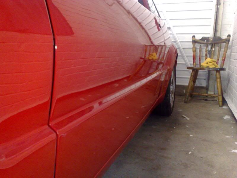

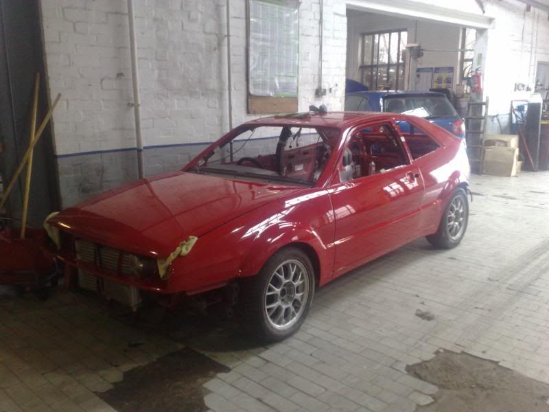

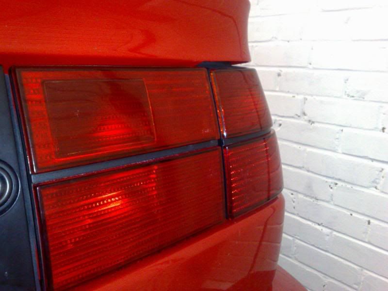

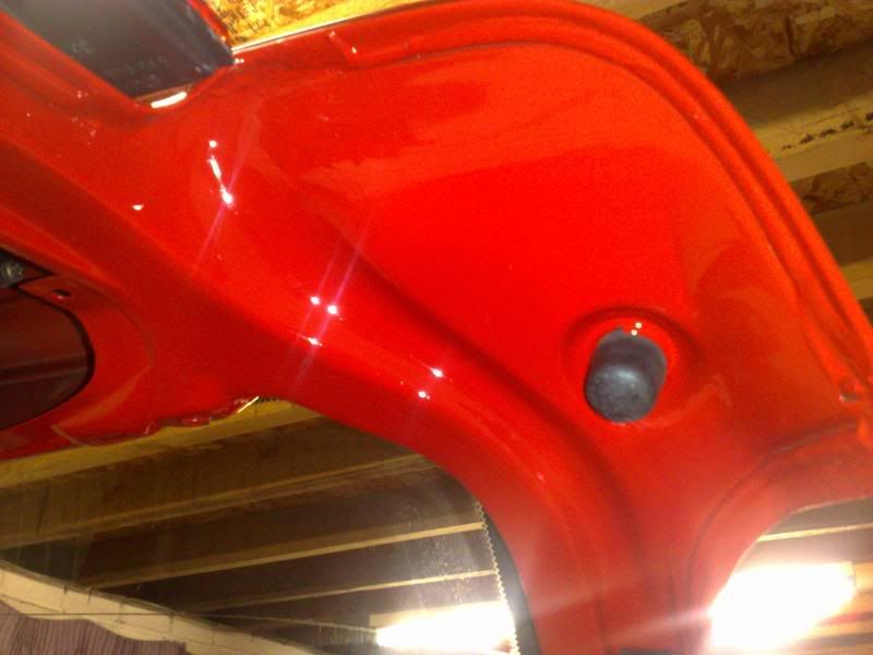

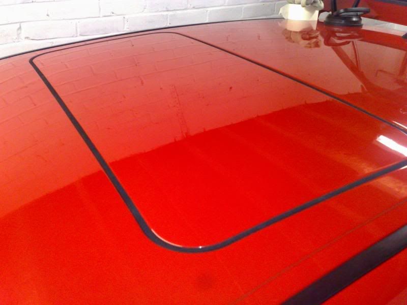

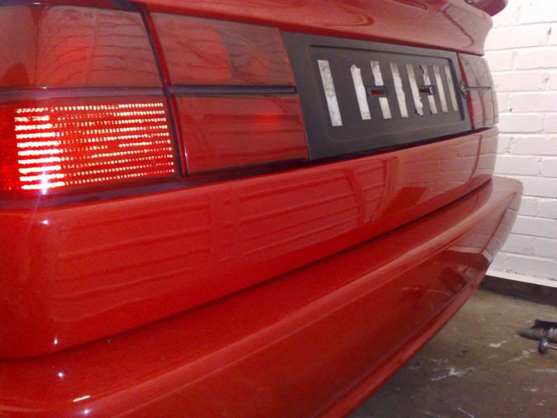

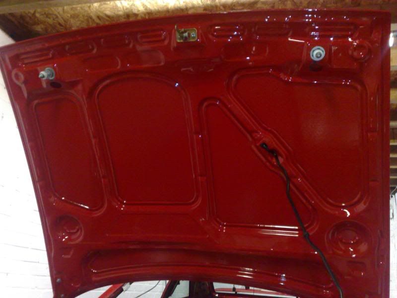

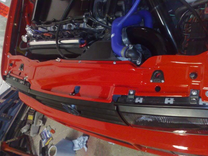

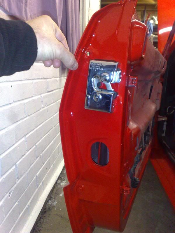

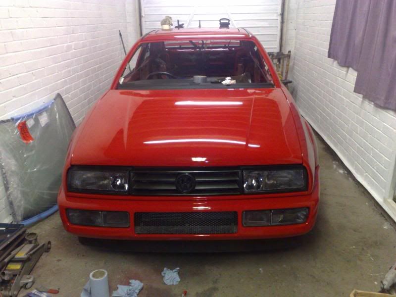

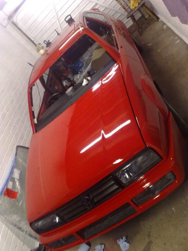

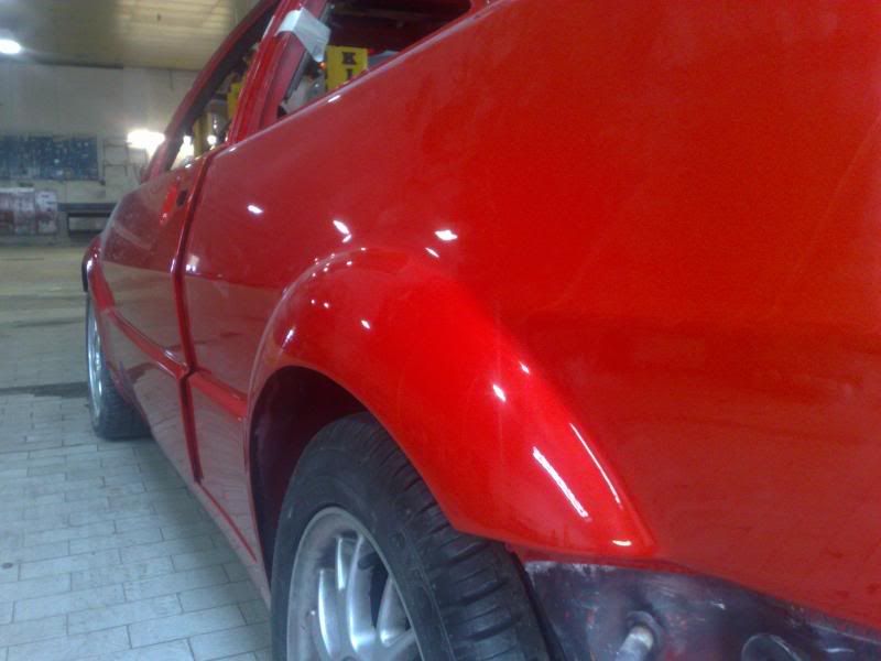

CorradoVR6-Turbo 0 Posted February 12, 2010 Ive put the rear glass in tonight and thought it might be worthy of some pics,its well dirty/dusty ect...will be fitting front screen tomorrow and then finishing the doors...then maybe fit the front brakes and wheels,play with suspension hight if i have time... Some randoms...sorry only mobile pics,my slr is bust :( fresh from paint... Back at home... :cheers: Carbon bonnet... :) Slam panel,de -holed 8) Rear end smooth....rear lights tinted then 2000 wet and dry,laqured,then 2000 wet&dry,then polished Built.... Share this post Link to post Share on other sites

KipVR 1 Posted February 12, 2010 The pic of it in the garage looking at the front just looks awesome. Not keen on the new wheels though :D New paint just makes such a difference, nice one for keeping it and sticking with it buddy. Share this post Link to post Share on other sites
