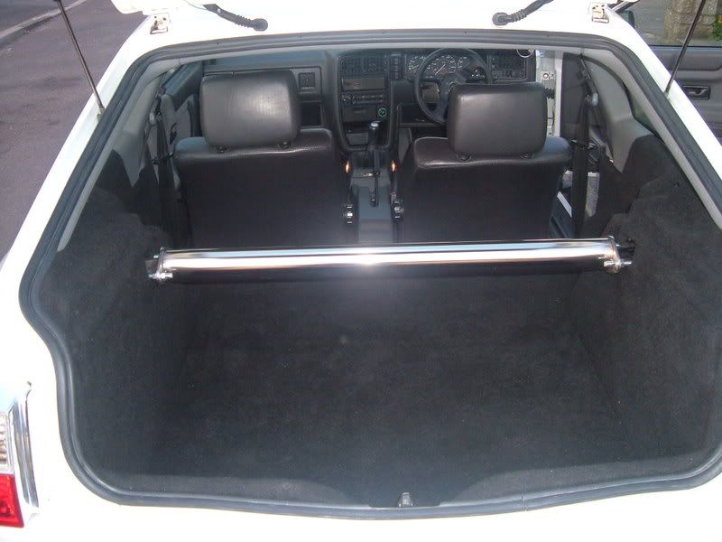

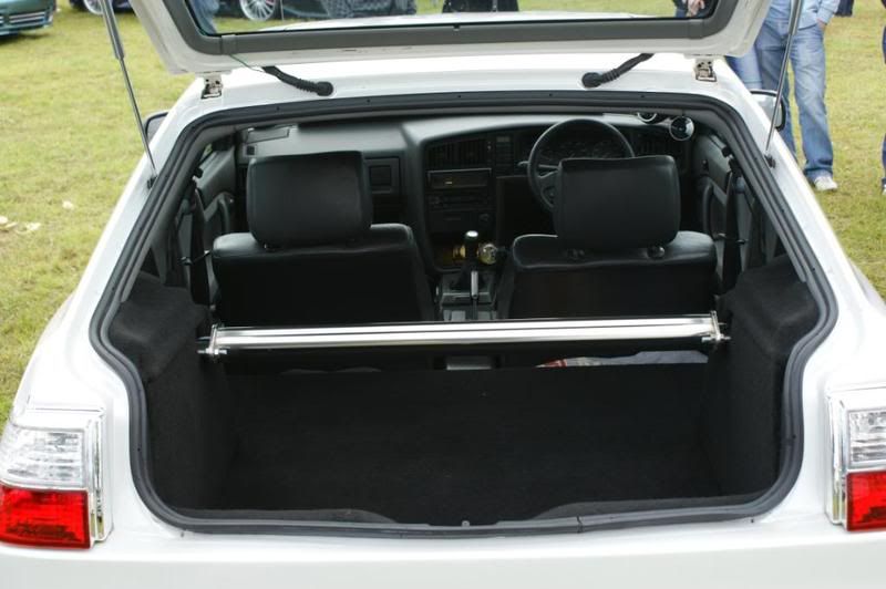

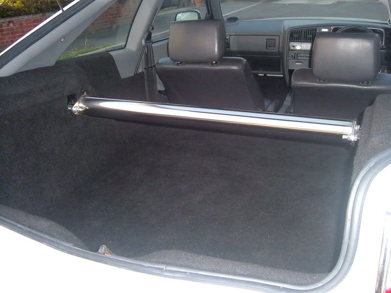

Rob_G60 0 Posted May 14, 2008 Just a quick sneak peak Got the strut brace in but not fitted properly need to do few bits, fit sub and a chrome aquamist bottle Rob Quote Share this post Link to post Share on other sites
nemesis360 0 Posted May 14, 2008 Looking good chap Im gonna be doing something similar in the boot of mine before its back on the road. Quote Share this post Link to post Share on other sites
Rob_G60 0 Posted May 14, 2008 Cheers mate, really pleased with it so far only cost £230 and thats wood, carpet, spray clue, standard front carpet in black, strut brace, rust paint, screws, sand paper and a few other bits and bobs Quote Share this post Link to post Share on other sites

Neil VR6 0 Posted May 16, 2008 Will the amp be OK in terms of cooling? Quote Share this post Link to post Share on other sites
Rob_G60 0 Posted May 16, 2008 yep check with a audio company and they said its fine Quote Share this post Link to post Share on other sites
iggi 0 Posted May 16, 2008 thats exactly what ive been wanting to do with mine for the last year :lol: never get round to it though. ive got the same brace too. its kust bare metal in the back of mine Quote Share this post Link to post Share on other sites

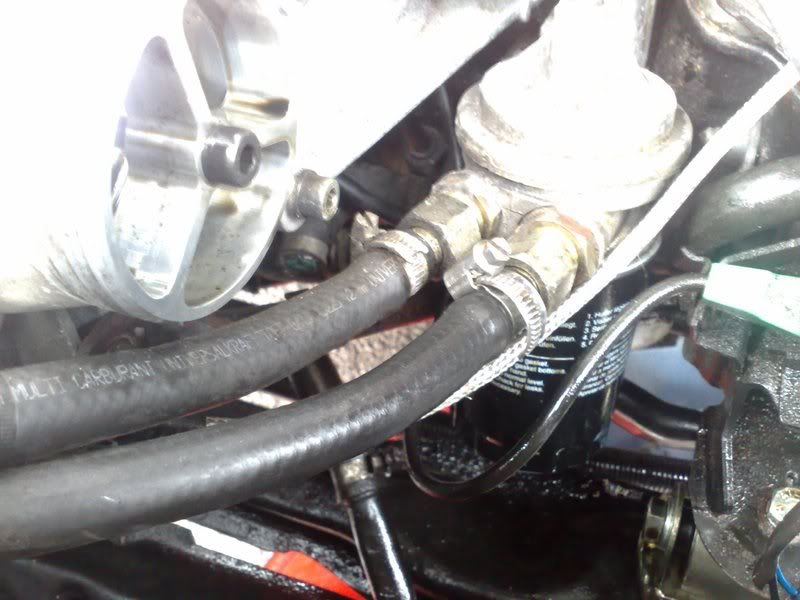

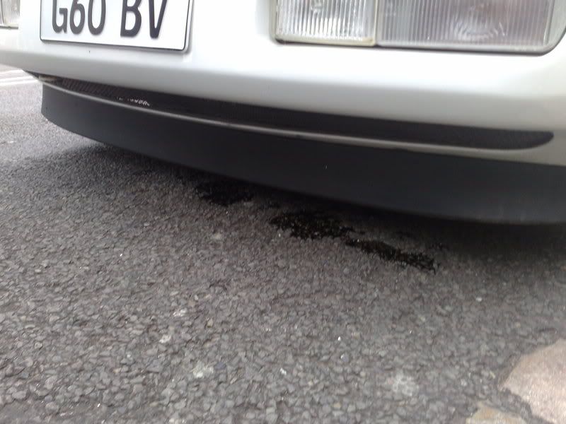

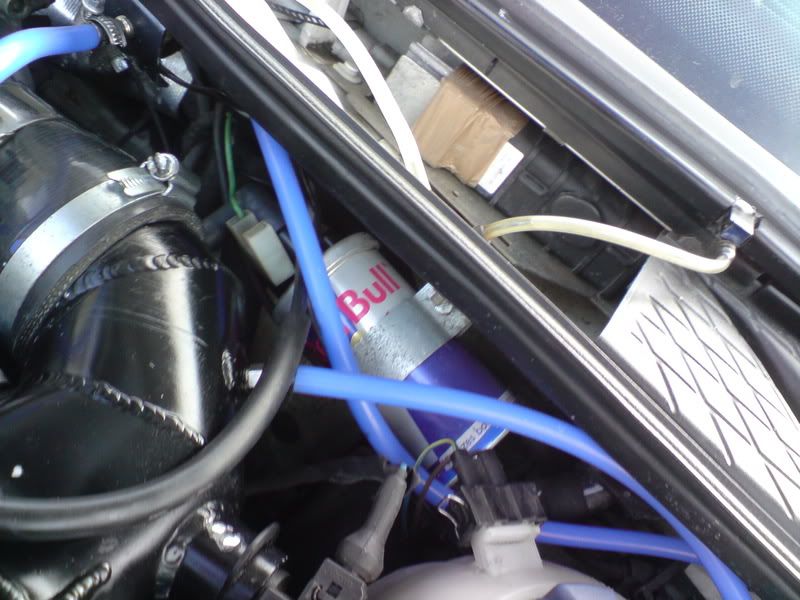

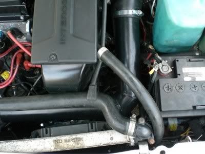

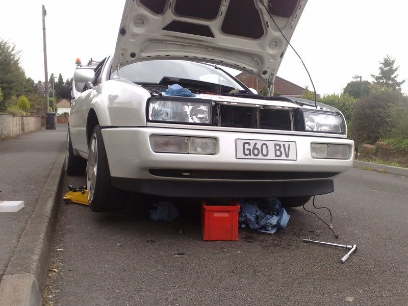

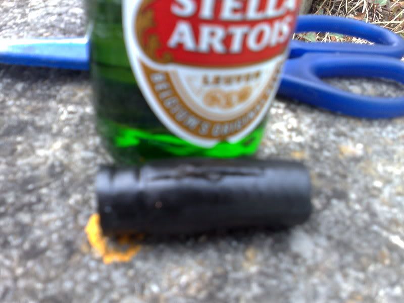

Rob_G60 0 Posted May 17, 2008 well after a little drive today, just on the way home oil light comes on and all starts beeping, so pull over and take a look under the car To find this After being towed home, car comes apart to find out what was leaking We found what it was after turning it over and more oil pooring out:(:( It was the pipe on the left To find it split like this Car is all up and running again now, thank god :):):):):):) Quote Share this post Link to post Share on other sites

boost monkey 0 Posted June 27, 2008 Glad to see you fixed the leak buddy, but is that rubber hose actually rated safe to carry hot oil? Personally, I wouldn't have thought so? :scratch: Quote Share this post Link to post Share on other sites
Rob_G60 0 Posted June 27, 2008 g60bv said: any further developments? Hi ian, Not alot really mate money is tight at the moment due to buying a house, passed the mot last week just need a new hand brake cable, also brought a new rad and fan and some samco hosing boost monkey there be changed next week to the proper hose's Quote Share this post Link to post Share on other sites

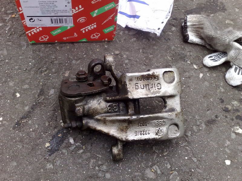

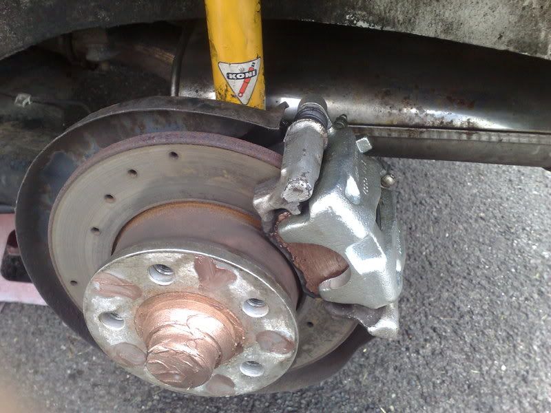

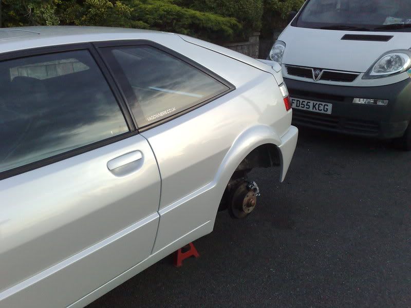

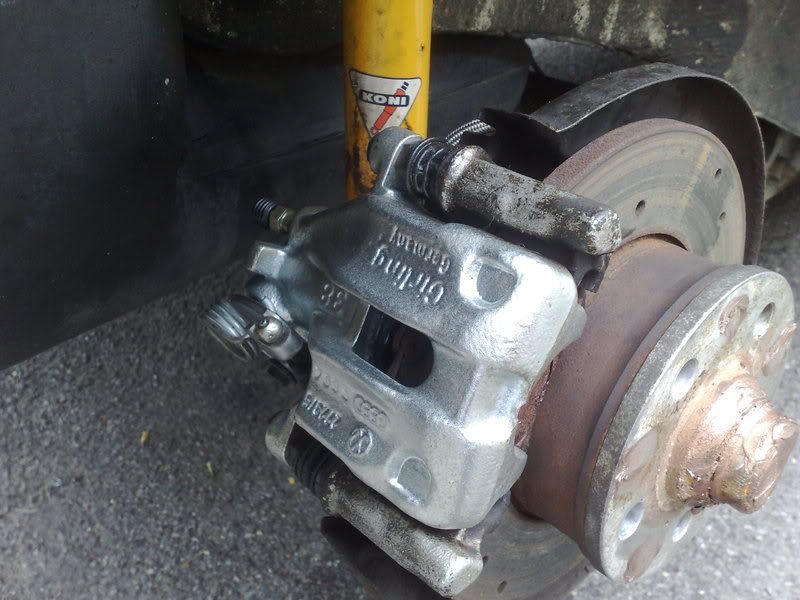

Rob_G60 0 Posted July 1, 2008 well its been a while since i worked on the car, so todays task was sort out the hand brake, so take it all apart new cable on, still nothing, so took the cailper odd and it was stuck solid, so got hold of Vee.W Autoparts who had them in stock, so was busy fitting them this afternoon , there all fitted and working now, happy days Old New one's Fitted Rob Quote Share this post Link to post Share on other sites

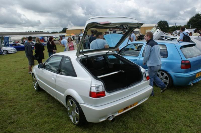

Rob_G60 0 Posted July 6, 2008 Went to a show today here's a could i stole of the show web site Quote Share this post Link to post Share on other sites

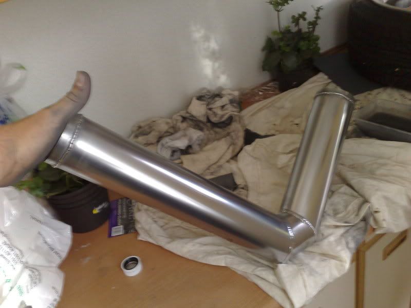

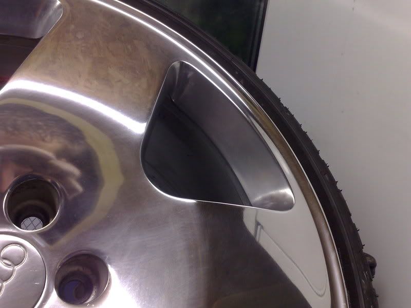

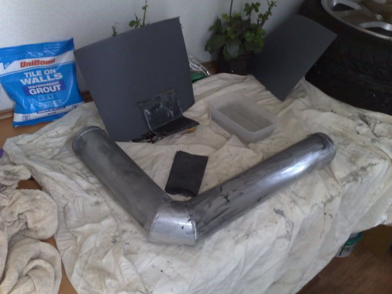

Rob_G60 0 Posted July 8, 2008 another little update Been cleaning up the wheels the past week and finished them tonight the fronts were ok, but the inner bits were crap, so i wet and dryed them with 800 then moved on to 1200, then got them up to a mirror polish Then the next job was the the main pipe that comes out of the charger Before it was black Then used nitromorse to remove the paint and then on to the 1200 wet and dry after a quick polish up look like this this is how the car will be going to sleep to night like My blue HT leads come today so will fit it all tomorrow, then my new rad on saturday Rob Quote Share this post Link to post Share on other sites

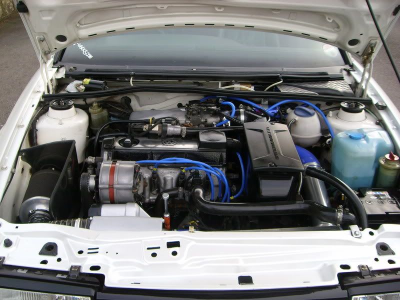

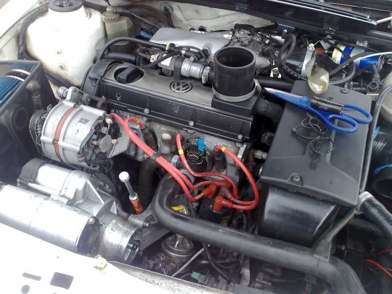

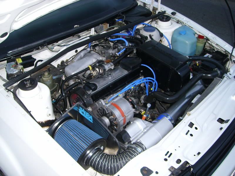

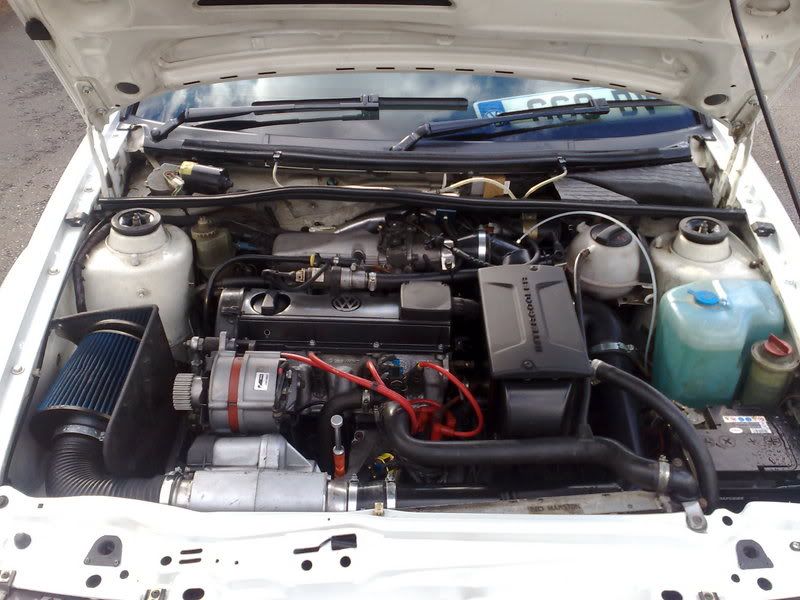

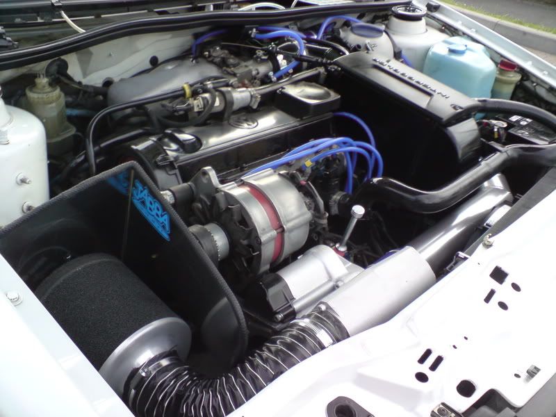

Rob_G60 0 Posted July 16, 2008 Well been cleaning up the engine past week or so, think im about half way there now, still waiting for more things in the post heres when i started This is now Cheers Rob Quote Share this post Link to post Share on other sites
g60bv 0 Posted July 16, 2008 looking nice rob. but i must say g60'd dont like foam filters. they dont stop fine dust which can turn to a paste on the apex seals.. Quote Share this post Link to post Share on other sites
Rob_G60 0 Posted July 16, 2008 yeah thinking of cleaning the old one up and refitting it, whats the best way to clean it Quote Share this post Link to post Share on other sites
Rob_G60 0 Posted July 16, 2008 There we go, old one back, thought the new one looked way to small :clap: Rob Quote Share this post Link to post Share on other sites
