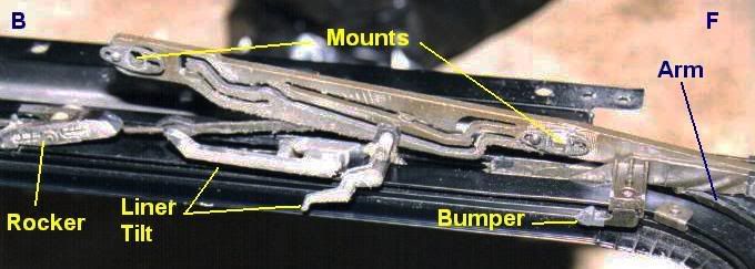

andycowuk 0 Posted April 7, 2011 I've had my sunroof out and in bits, and have also taken a broken mk3 one appart to see what parts are the same. My observations may be of no help to anyone, but are.... The rear guides with the rocker finger on it are exactly the same The actual frames are identical, but the outlets for the drain pipes are not at the same angles - i didnt offer up the mk3 one to see if that was a problem though The middle slider thats attached to the cable on the mk3 has no control levers (that i assume are to tilt the 'letterbox' on the inside of the corrado) The front slider has a different arm/clip for pushing and pulling of the interior trim, but as I was comparing the individual parts, I'm not sure if they will still engage enough to pull the interior trim back to closed The long arms that actuate the tilt appear differnt to look at, but I think they deliver the same result Quote Share this post Link to post Share on other sites

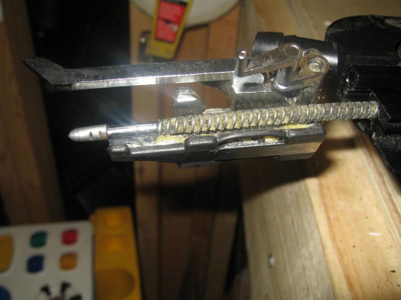

andycowuk 0 Posted April 15, 2011 (edited) Since I was putting mine back together tonight, I thought I'd take a few pics of the parts, and a video of the mech working before i put the lid on - just used copper slip, time will tell how that lasts compared to the special VW jizz... Left and right rear guides - both of the left hand ones are broken, the right hand ones are both fine. Two varying degrees of brokeness too; the top one with the sprung finger closest to the rocker missing actually jammed and snapped the cable, whereas the slightly bent bottom one only resulted in the tilts but doesn't slide issue. So annoying that these are so fragile and sensitive [attach]46248[/attach] [attach]46249[/attach] Front guides - these appear to be just as fragile as the rear, but not nearly as critical. [attach]46250[/attach] And a quick video to celebrate it being fixed.... battery is about flat as the car hasn't been used in almost a year... Edited April 15, 2011 by andycowuk Quote Share this post Link to post Share on other sites
