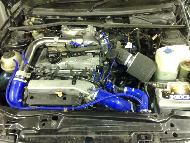

tim20vt 0 Posted March 20, 2008 finaly got my conversion finished, so far done about 100 miles in it all i can say is it was worth the wait :D :D :D on the qpeng high boost setting it realy shifts :) the only thing that isnt working is the oil temp im unsure where to put a sensor anyone got theres working with qpeng on the mfa what did you do with the sensor? just need to try get it on the rollers to make sure its running right im worried about running it incase its lean etc i dont want to melt it. im sure qpeng maps are resonably close Quote Share this post Link to post Share on other sites
Rob_B 0 Posted March 22, 2008 give it a little while mate and you will see that they over fuel, watch the fuel consumption! so no worries about running lean. also, the oil temp sensor can be put into the top of the oil filter housing. there is normally a little blank in there (same place as G60) Quote Share this post Link to post Share on other sites
alackofspeed2 0 Posted March 23, 2008 I doubt you'll have any problems with the map - I've only read of one person having problems with the QPENG MBE kit, and in that case I believe the issue was that the purchaser stated his engine code incorrectly. Quote Share this post Link to post Share on other sites

tim20vt 0 Posted March 26, 2008 iv had my newly recond k04 turbo fail after just 300 miles i have good oil pressure and feed lines new oil and filter all bled up fitted the unit with utter care. now it wont spool up just screams,blades have burs from rubbing the housing. so looks a bit dead. so my question is has anyone else running a k04 on qpeng had any problems? is the 1.6 bar way too mutch for the k04 as i only ran it full power for like a few mins it failed while running a 0.6 bar. or is it likely the recon was crap and the bearings have gone already even tho the oil is fine. i mite be best to get a second hand unit. funds are now running low it cost £360 for the recon and it only went for leaking seals so proves there was good oil pressure now this recon is compleatly knackerd leaving me wondering why. always sumat goes wrong :( but for them 300 miles the car was seriously rapid :) Quote Share this post Link to post Share on other sites
junkie 0 Posted March 26, 2008 I would say 1'6 bar is way too much for that turbo, i run an IHI VF22 @ 1.5 bar and thats pushing it to its limit for reliability tbh. Quote Share this post Link to post Share on other sites
Rob_B 0 Posted March 27, 2008 1.6 bar is ok, my mates pulls 25psi on the boost guage and doesn't have any problems. and he will break anything you give him! if you disconnect the oil feed pipe and return pipe (well crack them off) does the oil come out of both pipes (not at same time)? could be crap bearings. does the shaft have lots of play in it? if you have oil seeping out of the return pipe then there must be oil getting to the bearings. does the unit come with a warranty? if so, get on the phone! Quote Share this post Link to post Share on other sites
alackofspeed2 0 Posted March 27, 2008 so my question is has anyone else running a k04 on qpeng had any problems? Nope - my friend has had none. From memory peak boost with the closed loop should be ~1.5 bar in the mid-range, tailing off to 1 bar at the top end. If you were running 1.6 bar for anything more than an overshoot, something wasn't quite right. Quote Share this post Link to post Share on other sites
Rob_B 0 Posted March 27, 2008 Thanks mate, that was spot on. Its up and running now. Just need to tidy up the intercooler pipe work. Big thumbs up for the qpeng conversion kit from me, so easy to use that even a complete novice like me can get it up and running. all the effort and money will be worth it now! the only thing i find with the qpeng is that it fuels so much. i might change my water temp sensor and see if that helps. im getting about 50 miles to £10 of super unleaded at the moment with normal driving (not racing everywhere). be interesting to know what others are getting. apart from that, the qpeng is spot on for me Quote Share this post Link to post Share on other sites
rado-steve 0 Posted March 27, 2008 When mine was overfueling and dumping it into gimp mode it was a knackered Lambda probe Quote Share this post Link to post Share on other sites
Rob_B 0 Posted March 28, 2008 "gimp mode"-quality! that could be a possibility, mine is the probe that came with the engine. ill run the mapping software on it and see what it is reading. allthough with £10 actually getting you about 2litres at the pump, maybe 50miles is good! :) Quote Share this post Link to post Share on other sites
tim20vt 0 Posted March 28, 2008 turbos now off oil and oil lines and pressures are fine but the turbo on the intake side on just 3 blades big burs have formed on the blades,but why only three im sure the turbo rebuilders will try say its me but surly its a fault with them why only 3 blades bured up? out of balance or a bent shaft? yea theres a 12month warranty so il have to see what they say shud be back with them monday. ben at qpeng says hes had no turbo problems during development at 1.6bar. Quote Share this post Link to post Share on other sites
Rob_B 0 Posted March 28, 2008 sounds like a bent shaft to me, but then im no expert. if you have oil there, then it cant be your fault, that is the only thing you need for it. get onto trading standards if not. if it came off your engine working, then it should come back working Quote Share this post Link to post Share on other sites
