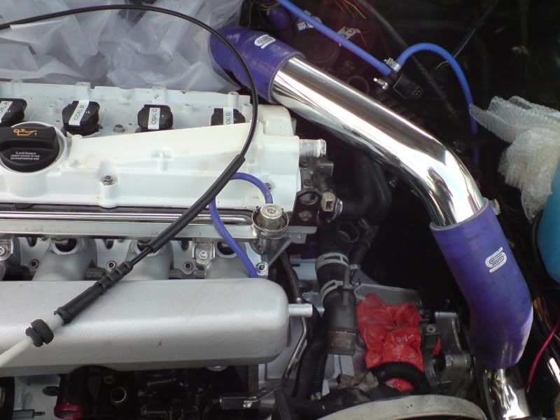

blue95 0 Posted June 11, 2009 Nice work mate! 8) Are you mounting three oil pressure sensors? as the original housing has 2 mounting points? Quote Share this post Link to post Share on other sites
waynos 0 Posted June 11, 2009 nah just the two, tried to get the bloody allen screw out of the housing but it wouldnt budge and it eventually rounded! Quote Share this post Link to post Share on other sites
blue95 0 Posted June 11, 2009 waynos said: nah just the two, tried to get the bloody allen screw out of the housing but it wouldnt budge and it eventually rounded! LOL - always the way! Quote Share this post Link to post Share on other sites
waynos 0 Posted June 11, 2009 yea ill sort that properly one day, my next hurdle is working out where all the coolant hoses go as havent got a scooby doo. Quote Share this post Link to post Share on other sites
blue95 0 Posted June 11, 2009 waynos said: yea ill sort that properly one day, my next hurdle is working out where all the coolant hoses go as havent got a scooby doo. Thinks yours will be slightly different to mine, as I had an afterun pump (which I never had) Quote Share this post Link to post Share on other sites
waynos 0 Posted June 11, 2009 i think i had the pump too ( lol think i binned it ages ago - canny remember now) Quote Share this post Link to post Share on other sites
waynos 0 Posted June 15, 2009 right ive figured out my coolant hoses, shall try and hook up the most of them in the week, just starting to work out a rough route for the intercooler piping, damn i cant wait to get this in and running! Quote Share this post Link to post Share on other sites
blue95 0 Posted June 16, 2009 Looks fookin clean mate! What intercooler you running? What throttle are you running and is there any adjustment for idling on that? Quote Share this post Link to post Share on other sites
waynos 0 Posted June 16, 2009 intercooler is an ebay jobbie,think theres a pic somewhere in the topic somewhere. The outlets are smaller than my boost pipes so i need to get a silicone reducer for each side. The throttle is off a 20vt, You can remove the black cover on the side and bend the throttle stop if idle needs adjustment Quote Share this post Link to post Share on other sites
blue95 0 Posted June 16, 2009 waynos said: intercooler is an ebay jobbie,think theres a pic somewhere in the topic somewhere. The outlets are smaller than my boost pipes so i need to get a silicone reducer for each side. The throttle is off a 20vt, You can remove the black cover on the side and bend the throttle stop if idle needs adjustment OK cool, I'm using the mk3 golf one, it has an idle screw but its still lumpy from cold. i'd try and minimise the joints on your boost pipework, managed to blow one of my boost pipes of the intercooler today...even though it has bloody expensive murray clamps! Quote Share this post Link to post Share on other sites

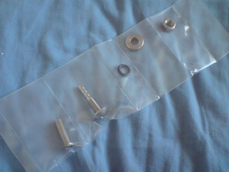

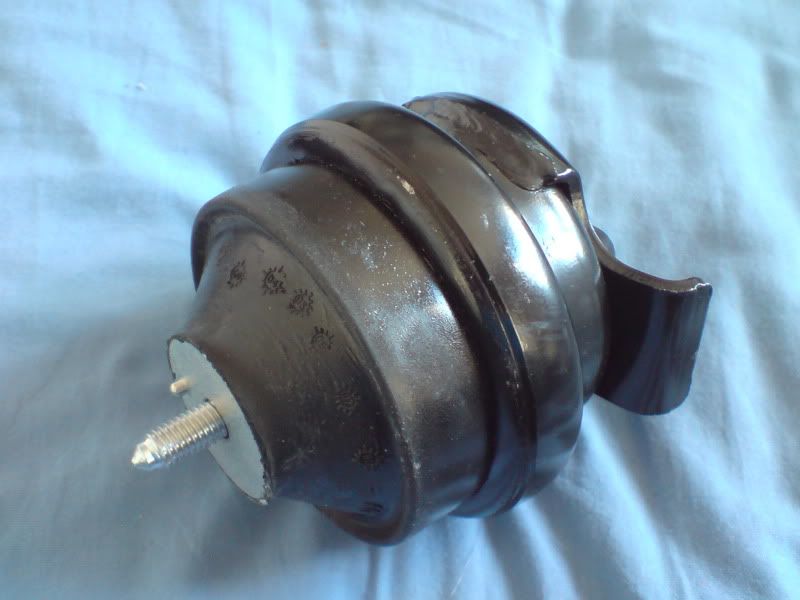

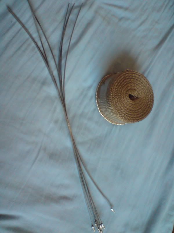

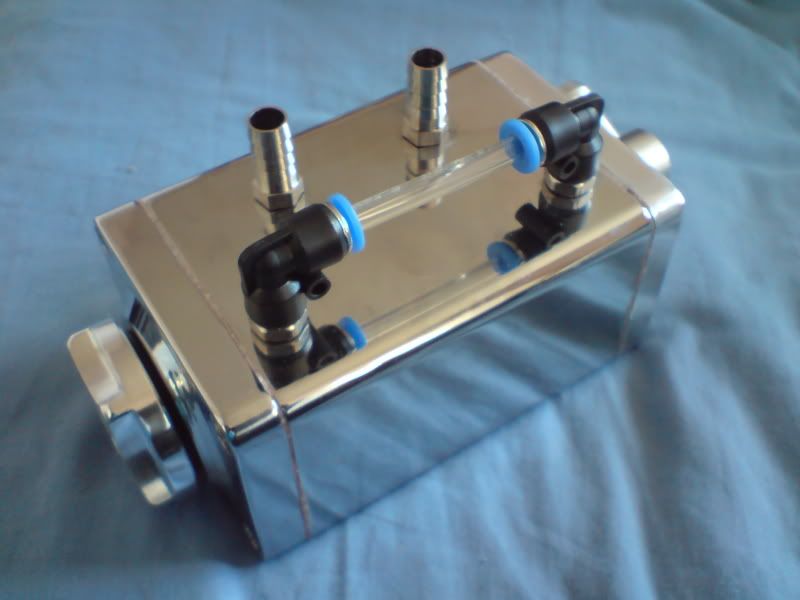

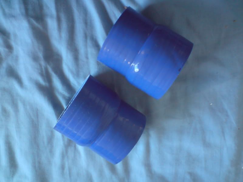

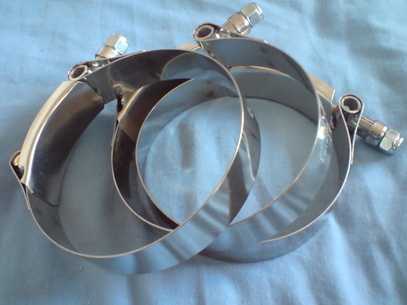

waynos 0 Posted July 1, 2009 update! last few parts are arriving this week, heres what i got so far some exhaust wrap and metal cable ties silicone reducers to match my intercooler pipe to my boost pipes new engine mount (febi) the old one is seriously mashed! nice shiny hose clamps - no jubilees here! self sealing hose take off kit so i can plumb the n75 valve into my silicone boost pipe And last but not least some bling - oil catch tank aiming to get the g60 engine out this weekend and then take it from there Quote Share this post Link to post Share on other sites

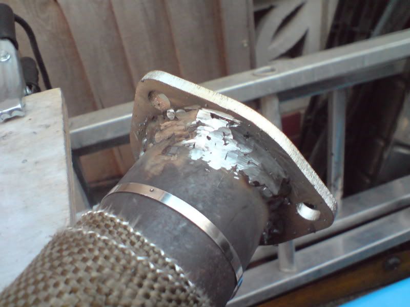

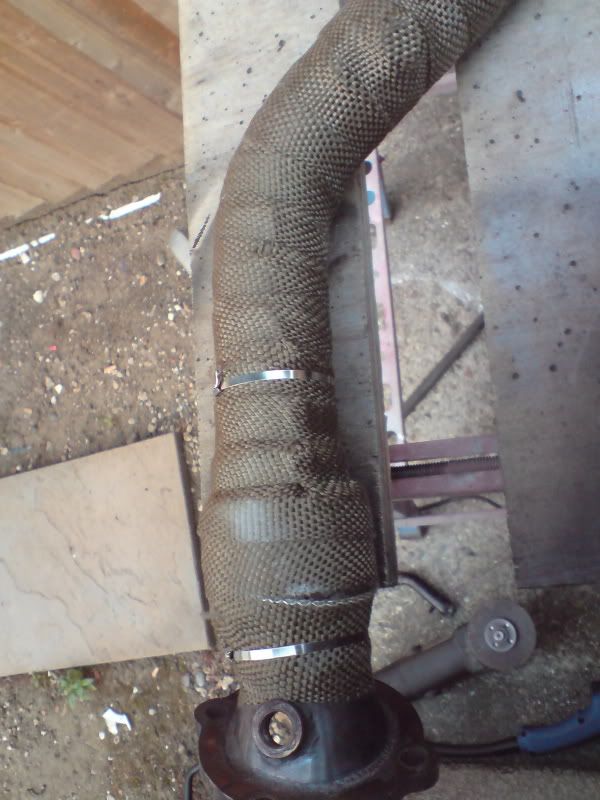

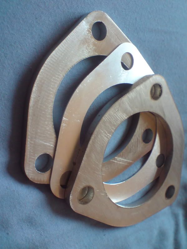

waynos 0 Posted July 2, 2009 got these today, they are flanges for the exhaust system - one to go onto the down pipe and the other on the ,mid section then ive got a reducer pipe to mate it up to my exsisting exhaust started to weld the first flange to the down pipe (looks a bit scruffy as ive started to grind the welds smooth but it got dark so ill save that for the weekend) And its wrapped Quote Share this post Link to post Share on other sites
blue95 0 Posted July 2, 2009 lookin good dude! Might have to give those clamps a go! my murray clamps keep blowing off :( had to stop a couple of times coming back from inters! Quote Share this post Link to post Share on other sites
waynos 0 Posted July 2, 2009 ive not heard of murray clamps, ive seen mikalor ones though but they are big bucks! hopefully these will do the job (better than jubilees lol) Quote Share this post Link to post Share on other sites

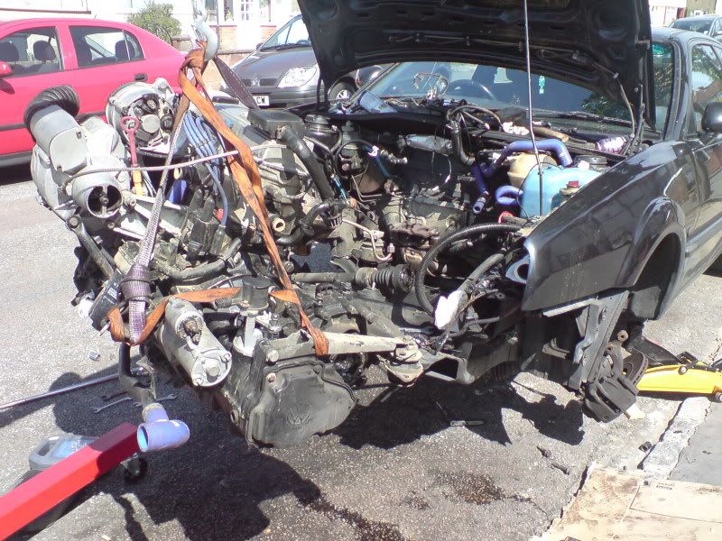

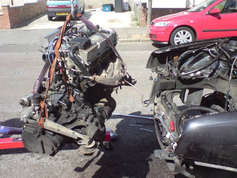

waynos 0 Posted July 4, 2009 the fun begins got the g60 lump out today that is all lol Quote Share this post Link to post Share on other sites
blue95 0 Posted July 5, 2009 Theres nothing like pulling out/fitting an engine to get your adrenalin going! 8) LOL Quote Share this post Link to post Share on other sites
waynos 0 Posted July 5, 2009 oh yeh the adrenaline was there! tell you what though vw like to pi$$ people off by putting manifold bolts in places where you cant get to them. As for undoing the down pipe...... put it this way , if i had a swear jar id have a couple thousand by now :D Quote Share this post Link to post Share on other sites

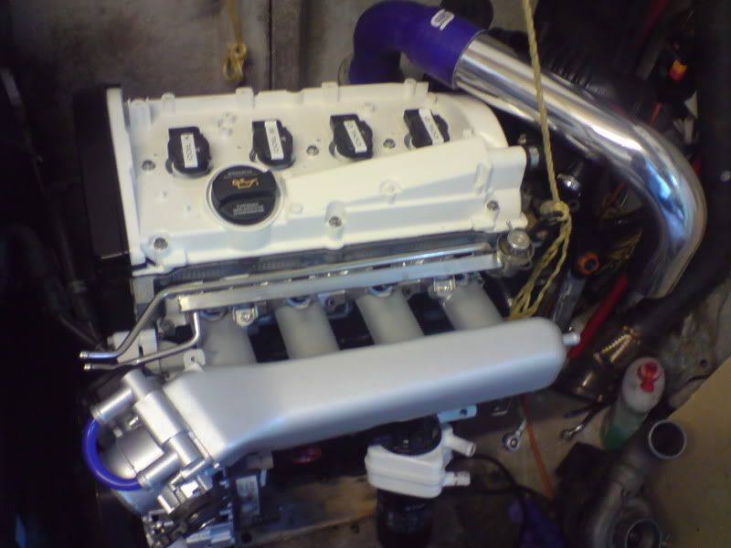

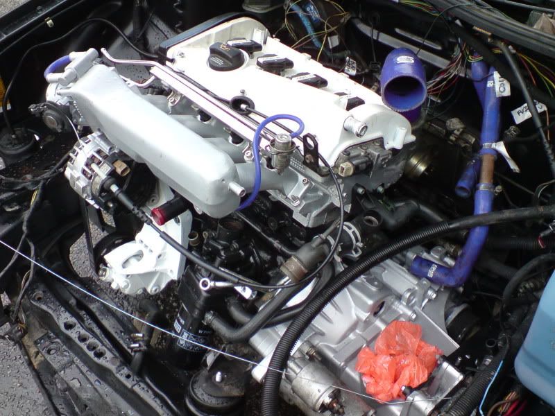

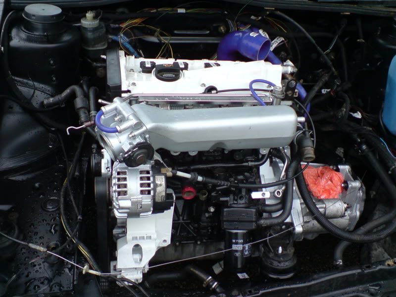

waynos 0 Posted July 8, 2009 well shes in at last gota take a bit of material off the brake cylinder as its fouling the timing belt cover slightly. Tommorrow i need to torque the gearbox bolts up properly and the mounts, then i want to work on the boost piping Quote Share this post Link to post Share on other sites
20vtvw 0 Posted July 9, 2009 wel done mae shouldnt tke to lng now :clap: Quote Share this post Link to post Share on other sites
dirtytorque 0 Posted July 9, 2009 omg clean. :) Come clean mine. :lol: Quote Share this post Link to post Share on other sites

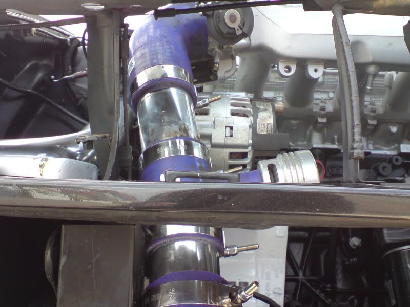

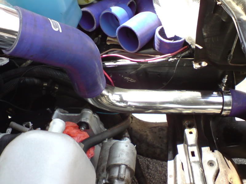

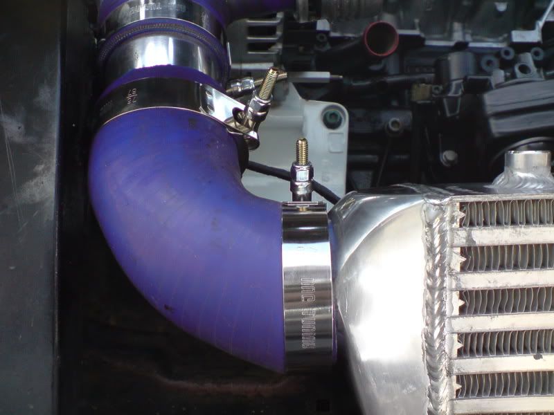

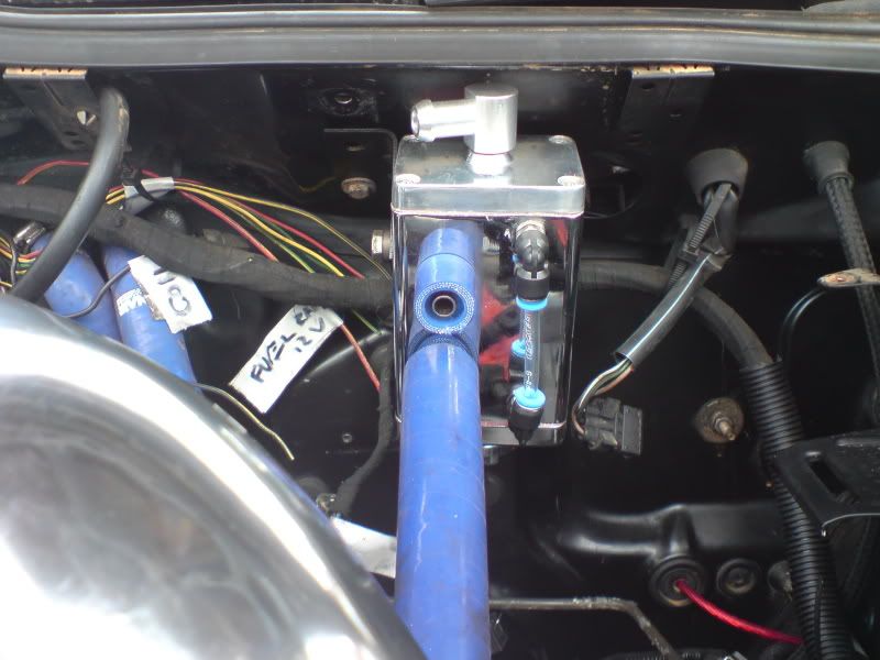

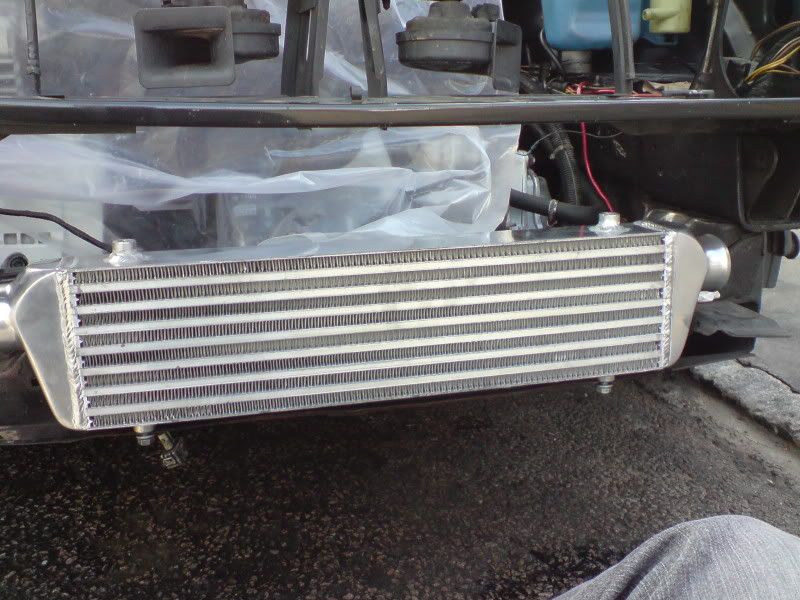

waynos 0 Posted July 9, 2009 haha ill make your engine clean if u give me that g60 u aquired the other day - fair trade :D got some more done today - take a look see The driveshafts were bolted back up and the engine mounts torqued down,gear shifter cables are bolted down. Also managed to put the take off in the turbo boost pipe for the n75 valve intercooler mounted, had to cut the centre part our of the front panel. the route it takes up to the throttle body The route from the turbo to the other side of the intercooler And i mounted the oil catch tank where the coil used to be Still working on it as i write this, putting the rad from my 16v in - the outlets are on the drivers side so the other side doesnt get too cluttered Quote Share this post Link to post Share on other sites
