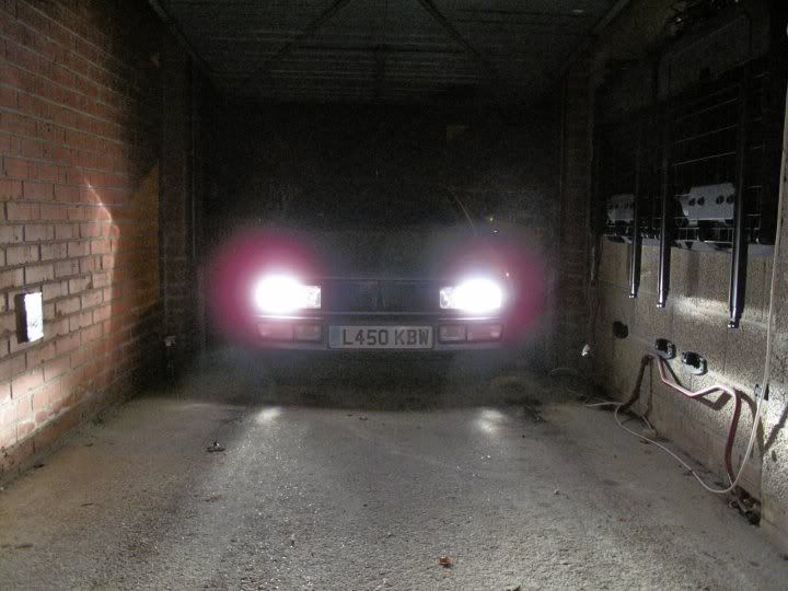

As promised, a pic showing the difference between 1 year old Philips Extreme +80% and Philips Rally 100W/90W.
Sweet FA is the difference, LOL! :lol:
Philips Extreme 60W/55W on the right, Rally 100W/90W on the left
On full beam, the Rally H4 and H3 are very slightly brighter.
Can't really recommend the Rally bulbs (over the Extremes)tbh because all you're doing is drawing twice the current for no gain.

wow that picture shows much more glare than my HIDs in my light setup.
what color temperatures are those?
They are halogen bulbs in that pic mate, as described above it.

It seems the color of the light is giving off alot of glare. The purple violet halo around the headlights.
