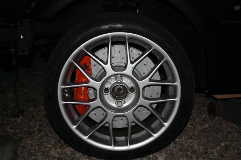

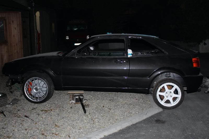

They are large :shock: what size of spacer you got in there
there is no spacer (the wheel is the standard corrado offset) eventually i might have to put on a 1mm or 2mm spacer just to be safe.

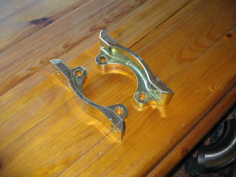

my front caliper brackets arrived

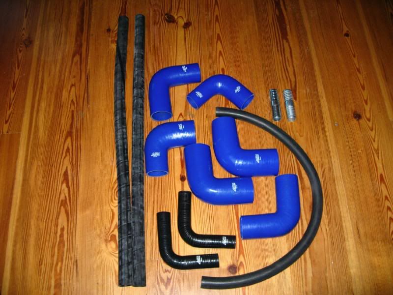

the hose for pluming the engine

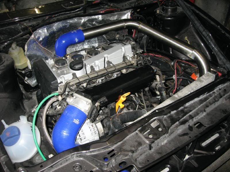

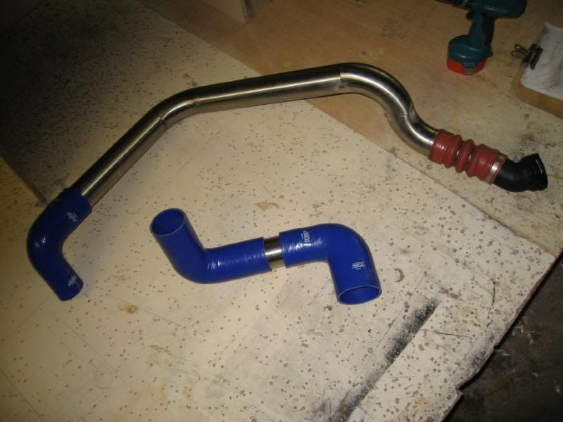

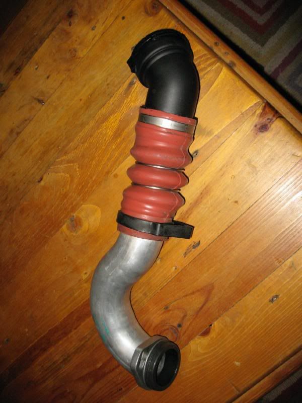

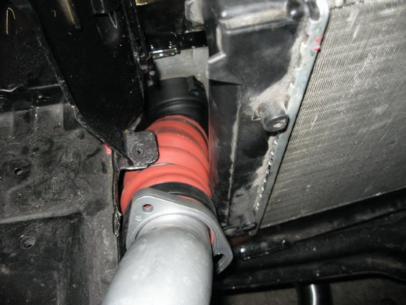

i bought a inter-cooler pipe from a bmw 7 series. it cost a fortune but well worth because it just clips onto my inter-cooler(bmw) and goes around the end of the rad perfectly
test fitting the hose
i took the alloy pipe out of the bmw hose and made up my own out of 2,5" stainless pipe. all my inter-cooler pipes made
fitted in the car

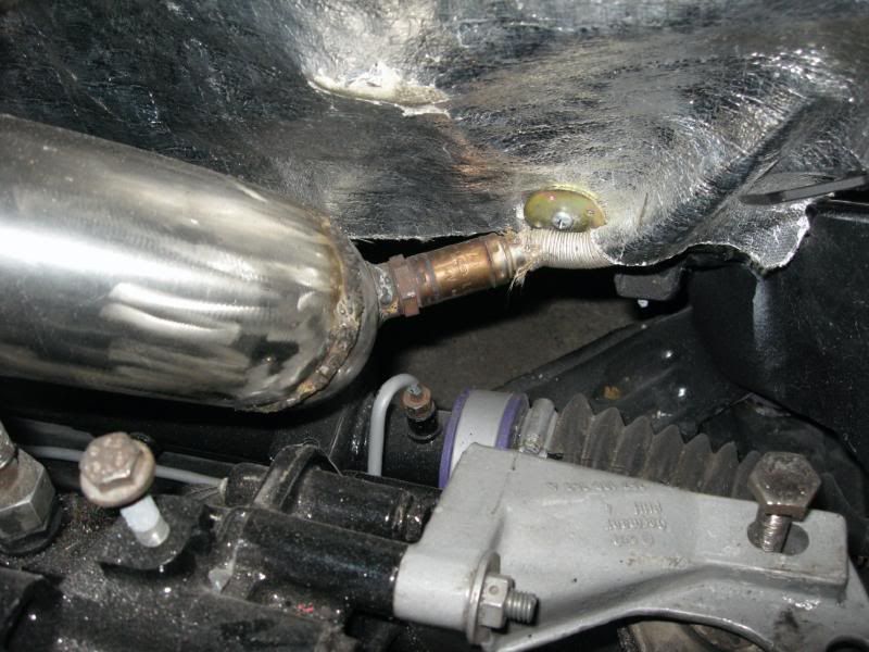

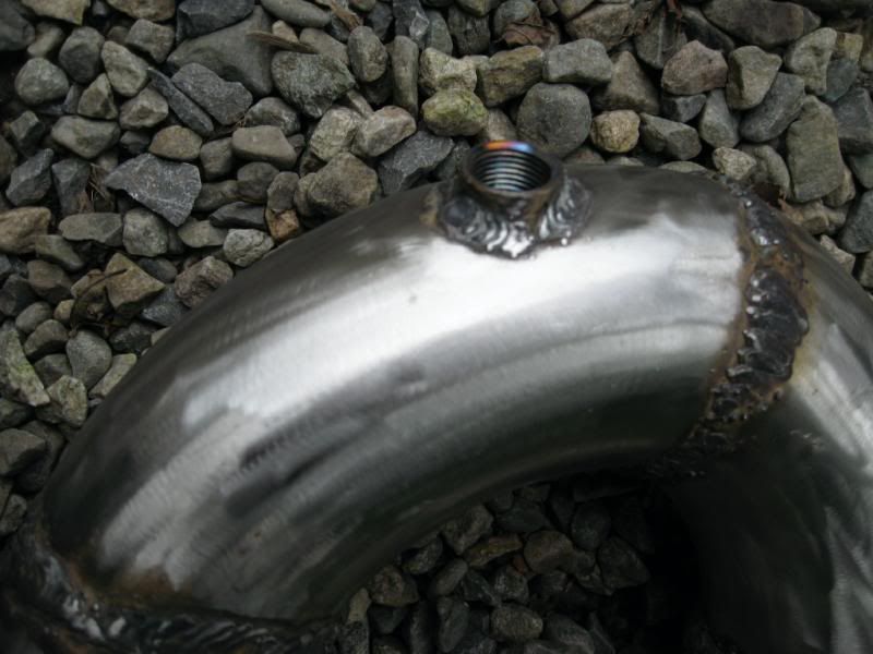

then i put a lambda sensor in my down pipe

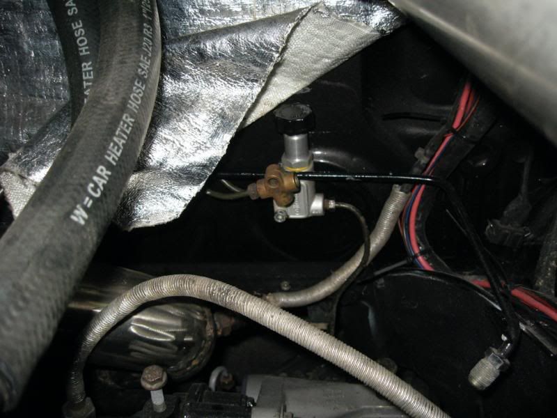

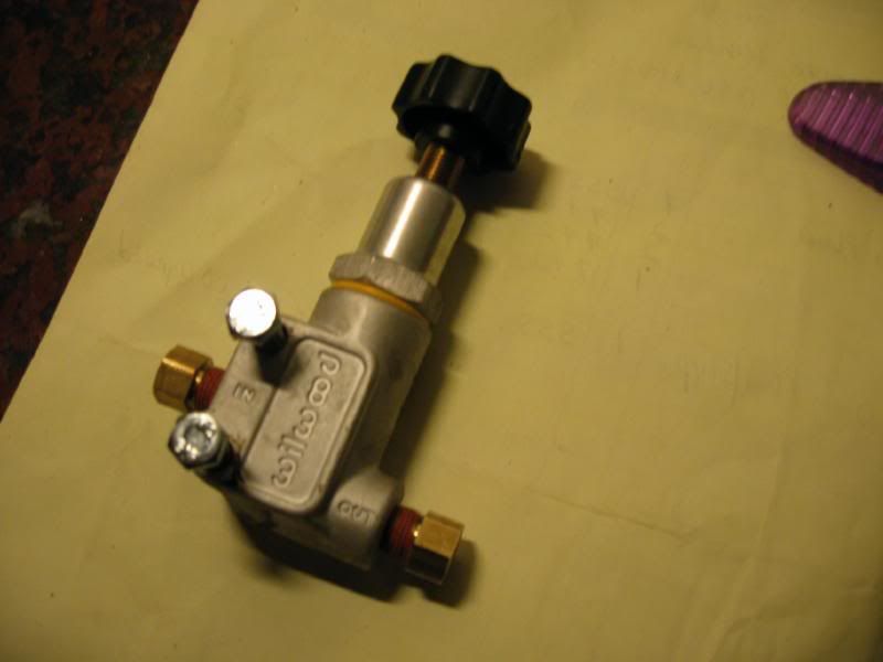

and a bias adjuster to stop the 4 pots on the rear locking up
i mounted the bias adjuster on the bulkhead behind the heat shield

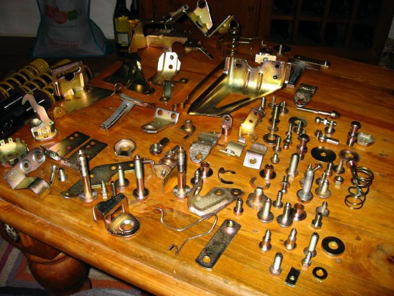

all my bits arrived back from the platers, no gay chrome just the proper original finish

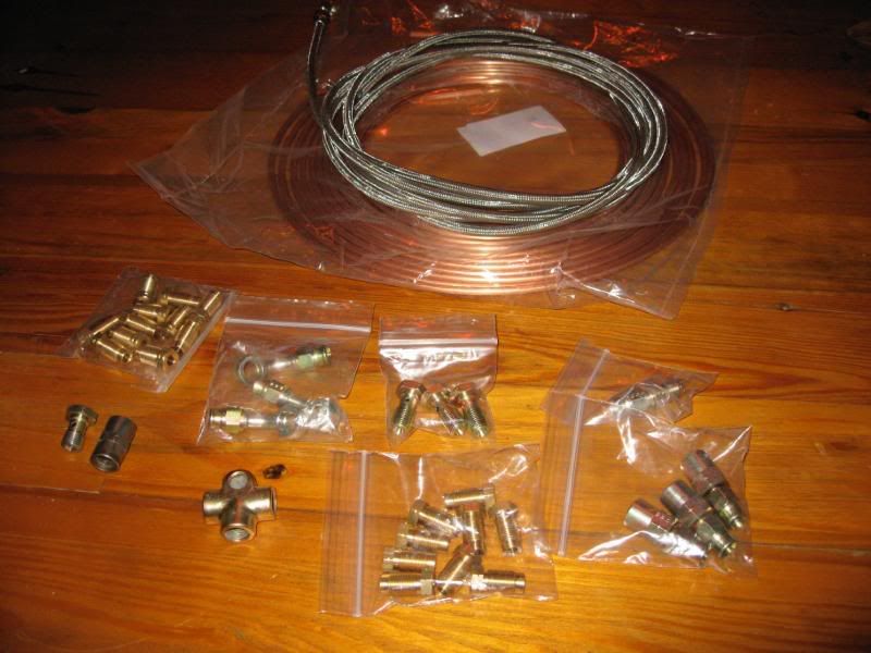

i have all the brake pipes made

i got a set of 17" bbs rc's off geo, i love them and the have plenty of room for the large stoppers
Awesome, looking like its all really starting to come together :clap:
Those 17's RC's i love, they look more like 18's to me, maybe its because the big brakes, windows, bumper etc missing and not bein fully lowered ...
