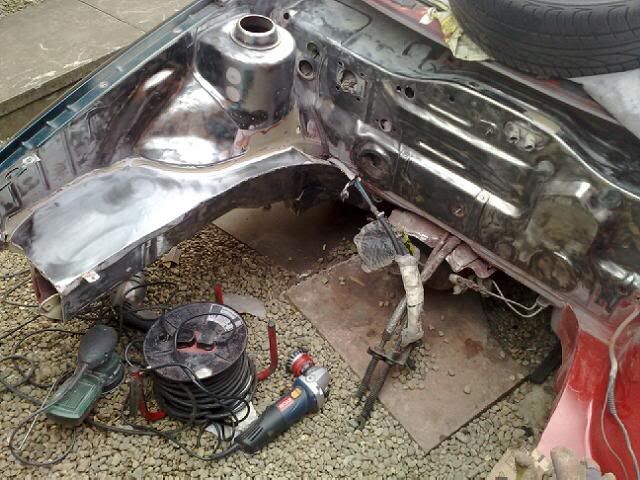

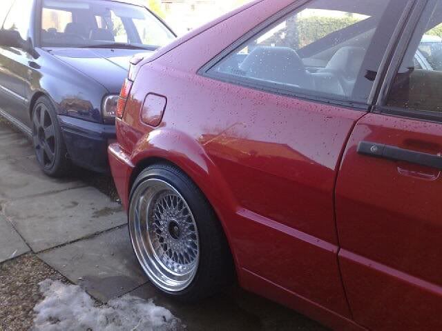

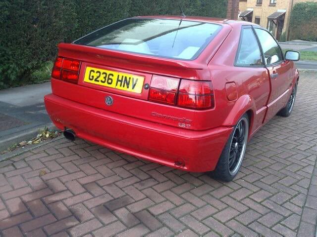

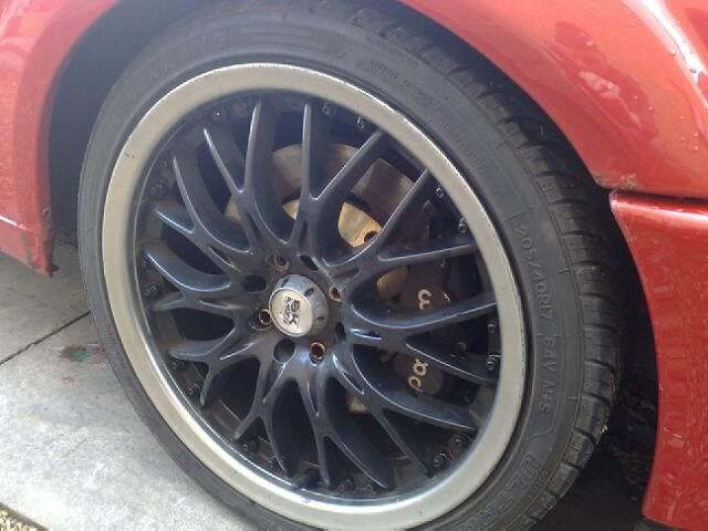

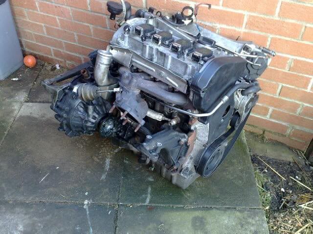

20vtvw 0 Posted February 25, 2009 hi all,ive been on here for a wile and put a couple of pics of my car up but thought i would show you what ive been up to ..ive owned the car over 6 years now started life as a 1.8 16v then a couple of years ago i fitted a agu audi a3 20v turbo engine in it using the qpeng loom and down pipe., now ive decided to change a few bits as its looked the same for a wile now.,first things are a set of 9x16" OZvegas with 3" dishes ,the fronts are too wide so will be ordering a pair of 2" dishes from image wheels to make the fronts 8s. Inside i have fitted a mushroom(biege)leather interior and am going to trim the A,B,C and roof linning in beige faux suade .. under the bonnet the ko3 turbo was showing signs of wear so have bought a ko3s which is a straight swap just need to send my ecu back to qpeng to have it re maped wile the engine is out i decided to clean up the bay a little but ended up removing all wireing, brake servo,expantion tank,washer bottle and battery tray.and started welding up holes and done lots of smoothing.. Thats about as far as ive got so far but im hoping to have it all done and back on the road for inters 09 and the big fat tour.,hope you enjoy the pics!! also fitted willwood 4 pots 310mm floating discs! :luvlove: Quote Share this post Link to post Share on other sites

20vturbo 0 Posted February 25, 2009 what are the 310mm discs off? Quote Share this post Link to post Share on other sites
20vtvw 0 Posted February 25, 2009 they are 2 piece willwood discs 310mm x(cant remeber of top of my head but are about 32mm thick)i think. these are the reason the front wheels dont fit ,i have to space them out 15mm to clear brakes. Quote Share this post Link to post Share on other sites

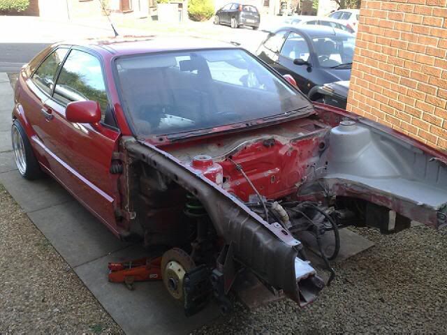

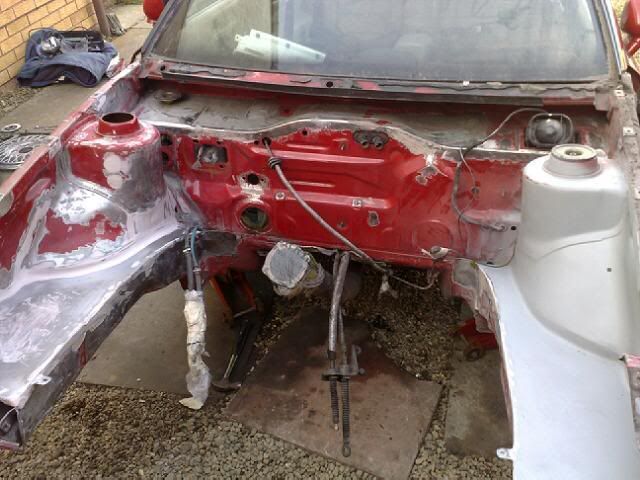

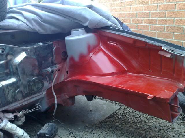

20vtvw 0 Posted March 17, 2009 almost ready for paint now ive removed the subframe and wings ,just doing a little filling then should be painted by end of this week., ive got a place on the Demonvw club stand at vw festival so has to be ready for that but am hoping to get it done by mid june???? couple of pics from last weekend., Quote Share this post Link to post Share on other sites

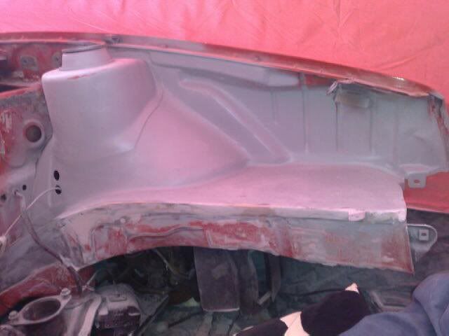

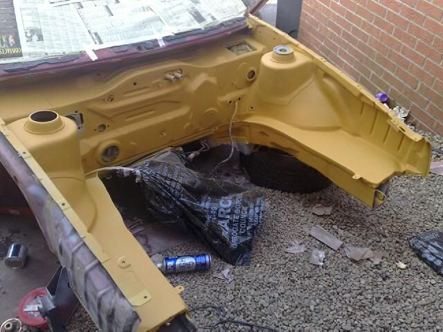

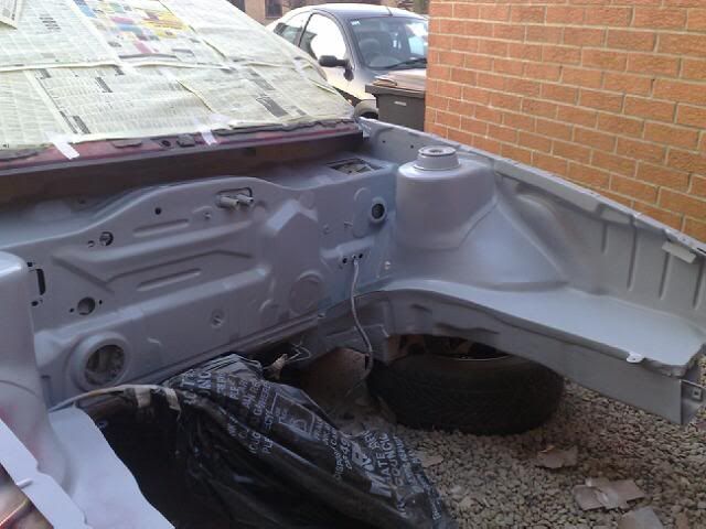

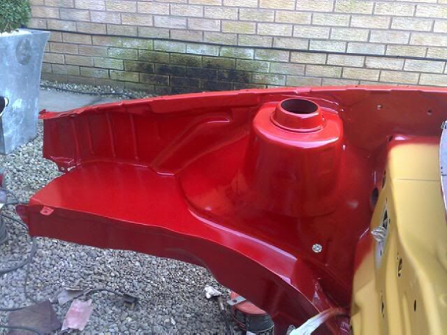

20vtvw 0 Posted March 18, 2009 Couple of pics from today,.all in primer now did a splash of red to see how it looks but this needs to be rubed down and some normal primer putting on b4 final paint ., should be all red by friday., then have to clean up all the parts that are going back on and get lots of new bits.,. filler primer test colour. final primer. what u think?? Quote Share this post Link to post Share on other sites

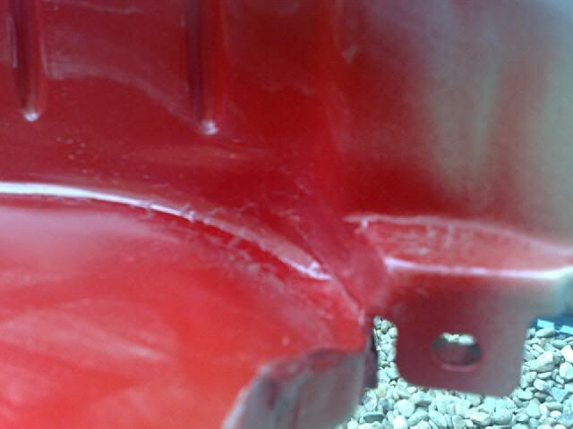

20vtvw 0 Posted April 3, 2009 ok so bad news when i started painting the top coat started to react? now everytime i rub down a little it still wrinkles up so going to rub it right down and start again!! better news is seen as im starting again i was thinking of removing the matrix and smoothing a few more holes that arnt been used because of this, im going to keep the fan for cold air and drill holes in the top of the fan housing for recierc air??.also im going to run the brake and clutch lines behind the firewall so can weld up the other two holes in the strut towers as i will run the brake lines through the inner wing completely out of sight.then re paint again using the same brand for everything.. will put some pics up once the bay is ready for paint (again) Quote Share this post Link to post Share on other sites
Emkayvr6 0 Posted April 3, 2009 Gutted, what do u mean by wrinkles up? does it just roll upinto a sausade instead of dusting up?? Does the sandpaper just clog up? Quote Share this post Link to post Share on other sites
20vtvw 0 Posted April 4, 2009 it lifts in little crosses ill stic a pic up b4 i rub it down ., Quote Share this post Link to post Share on other sites
tim20vt 0 Posted April 4, 2009 you can get a sealer primer if not dust realy light coats on mite help too getting it too wet wont help good luck mate :) its bad when stuff goes wrong with paint. Quote Share this post Link to post Share on other sites

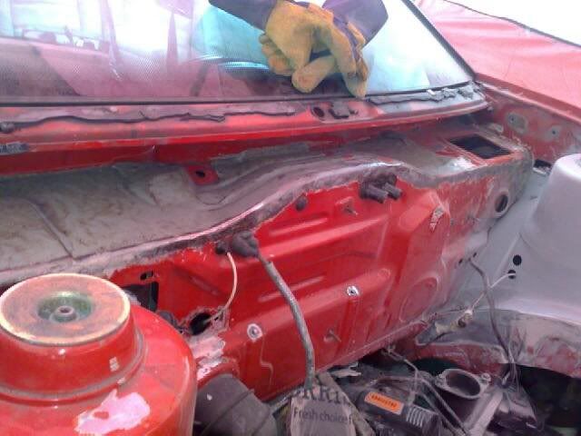

20vtvw 0 Posted April 8, 2009 this is the reacted paint so did this just got this side to strip then re fill Quote Share this post Link to post Share on other sites
