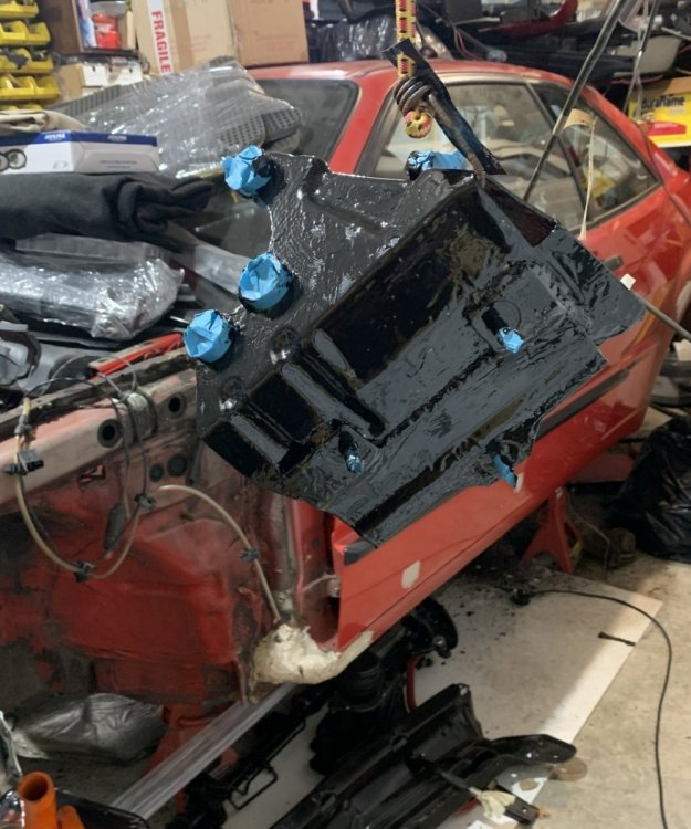

Decided to look at making a bracket to house the new abs. Advised by Tonedef and having read the same previously I set about making a Frankenstein. As you’ll no doubt see, my welding skills are up there with my wiring knowledge 🤣. Fortunately it doesn’t need to be pretty. It’s nice and solid which is the main thing
Edited by easypops
Forgot something
It turns out I made the new bracket upside down(thanks Tony) so I had to do it again 🤣
Just think of it as welding practice 😉
It happens. Funny though, thanks for sharing that Easy.

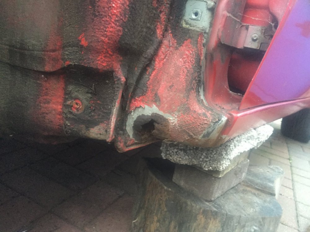

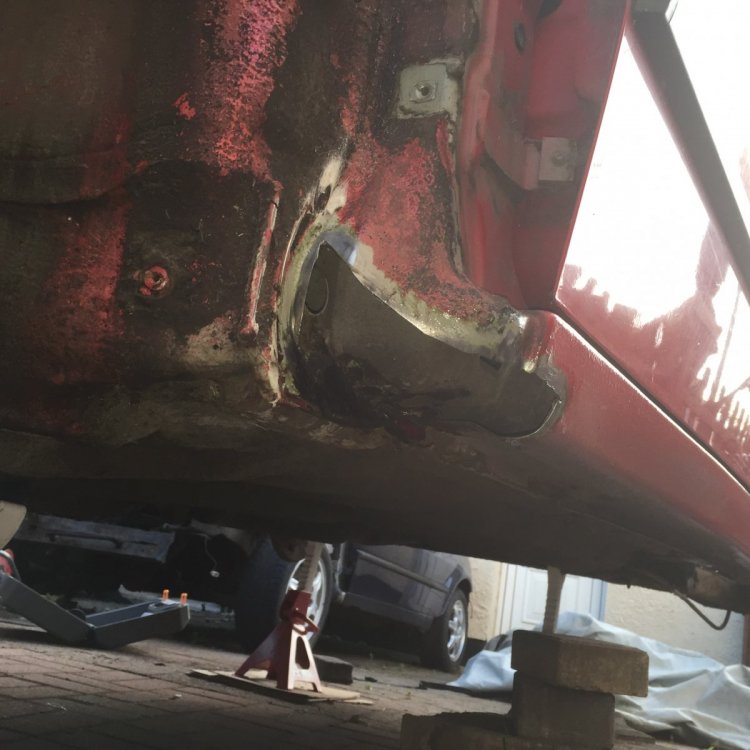

can I ask what’s going on with the front of the passenger sill, it looks strangely like an ice cream.

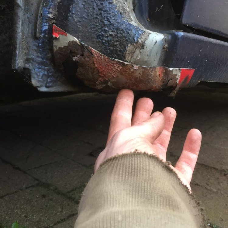

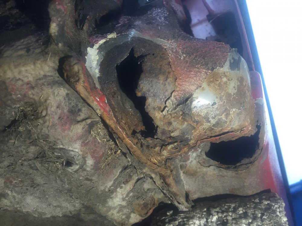

Ha ha, good spot. There was a massive rusty bit there. Along with a few other bits I cut it out. I repaired it along the others but was running out of time so I just blootered it with filler to be looked at again. That time is fast approaching and I fear that when I grind the filler off I might have to redo the welding repair. No real matter as the opposite end of that sill is also rotten, so I’ll be chopping/welding/grinding/filling on a few bits, luckily they are just about all hidden
I’ve found some of the pictures, couple of years old now possibly 3 years. I can’t find any of the after welding pictures..........probably a good thing 🤣
Aha ha I had my suspicions, petty rust that, shame you can’t get the panel anymore that has that knuckle on, it was pretty cheap when available compared to other stuff. I wouldn’t really want a lot of filler down there as it’ll chip with the stones coming up off the wheel, several coats of under seal might be better for it,
Absolutely mate, I knew it was gonna have to live outside under a cover for a while so I just covered it up knowing that once it’s inside I’ll need to remove it. This car was cheap so it’ll always be worth the effort. I’ve got so many nice parts to put in when it’s eventually done. Bodywork isn’t awful but it’ll never be the prettiest unless it gets a full respray in the future. But that doesn’t worry me, I’ll be delighted just to get driving it again 😁
