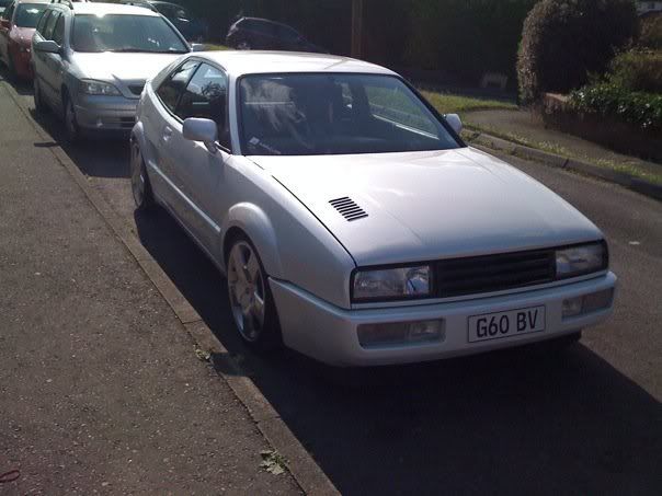

Rob_G60 0 Posted June 11, 2009 this is what i have on mine, its over the air filter :) Rob Quote Share this post Link to post Share on other sites
Danny B 0 Posted June 11, 2009 oooooo thats cool rob :salute: Quote Share this post Link to post Share on other sites

Danny B 0 Posted June 11, 2009 I just had a thought though.....arent vents like that meant to disperse air, so why over air filter ? :scratch: .....genuine quesiton Quote Share this post Link to post Share on other sites
blue95 0 Posted June 11, 2009 this is what i have on mine, its over the air filter :) Rob OOOooo defo like that!! Any probs with water on the filter??? Quote Share this post Link to post Share on other sites
blue95 0 Posted June 11, 2009 I just had a thought though.....arent vents like that meant to disperse air, so why over air filter ? :scratch: .....genuine quesiton sucks in cool air Quote Share this post Link to post Share on other sites
Rob_G60 0 Posted June 11, 2009 this is what i have on mine, its over the air filter :) Rob OOOooo defo like that!! Any probs with water on the filter??? nothing to date mate, just be abit more carfull when washing it (dont spray water direct on to it) Rob Quote Share this post Link to post Share on other sites
blue95 0 Posted June 11, 2009 nothing to date mate, just be abit more carfull when washing it (dont spray water direct on to it) Rob cheers, Did you notice any temp drops when in traffic etc? Quote Share this post Link to post Share on other sites

Danny B 0 Posted June 11, 2009 I just had a thought though.....arent vents like that meant to disperse air, so why over air filter ? :scratch: .....genuine quesiton sucks in cool air doh....of course Quote Share this post Link to post Share on other sites
Rob_G60 0 Posted June 11, 2009 nothing to date mate, just be abit more carfull when washing it (dont spray water direct on to it) Rob cheers, Did you notice any temp drops when in traffic etc? nothing at all mate Quote Share this post Link to post Share on other sites

blue95 0 Posted June 11, 2009 nothing to date mate, just be abit more carfull when washing it (dont spray water direct on to it) Rob cheers, Did you notice any temp drops when in traffic etc? nothing at all mate[/quote:uugl91qy] LOL maybe I don't need vents then Quote Share this post Link to post Share on other sites
Rob_G60 0 Posted June 11, 2009 hang on i read it wrong lol i thought u ment up, no its cooler than before Quote Share this post Link to post Share on other sites
