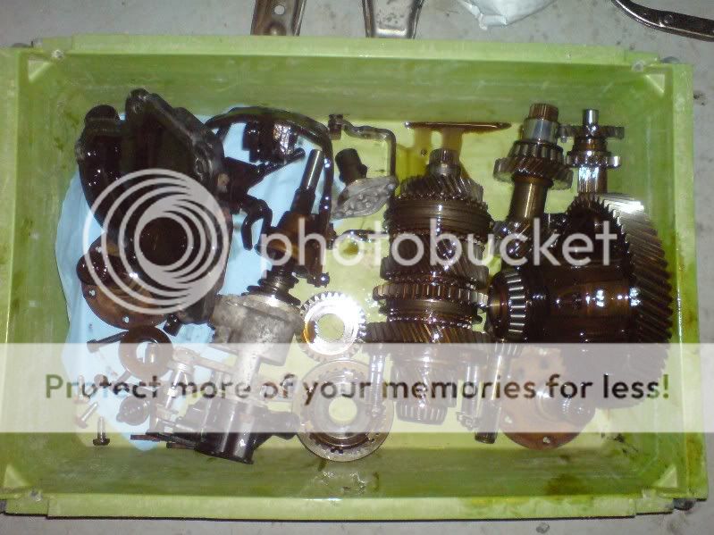

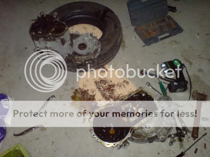

Well ive had a day on the car today and got the gearbox out.....and this is what it looks like now:
Got to admit, in my ignorance of pulling apart gearboxes, i had hoped that i could leave all the shafts and gears in the main casing and just take the bellhousing off. Not so! There is a plate bolted to the bellhousing from the inside of the box so it has to come apart completely. You have to first remove the other end and remove fifth gear, then various other bits and bobs before you can lift the casing off leaving the bellhousing with all the shafts, then pull all that off to lave the bellhousing free for the 02S, and same again for that.
I havent stripped the 02S yet, but things are looking very promising. The 02S has an 02J style diff with bolt in flanges, basically im hoping that vw have left the machined bit of shaft behind the diff bearing to sit the nylon speedo drive gear on (see the 02A one in the pic above) Failing that, i'll have to fit the 02A diff and output shafts but that means swapping the crownwheel and that has huge rivets that will have to be replaced with bolts. Talking of the output shafts....the 02S ones are the same type and size as the VR6 ones.
