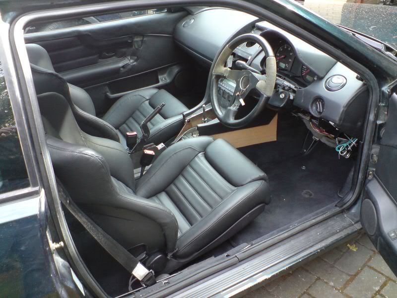

Spent most of this weekend getting the car back together so its respectable for its remap on friday.. got the complete headling , a b c pillars etc in, drivers door sound deadened and built up, a few more parts of the dash went in, glove box etc and then the seats in.
Still a way to go yet but its getting there...
the seats go so well with the dash - the whole interior package you've done from the carpets to the headlining looks the absolute business. i really like where you're taking the car here Doug - top work and good taste 8)
I Was just going to say the same as pete, the seats only work so well because of the dash. Brilliant and genius.

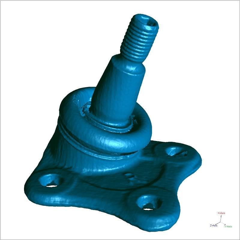

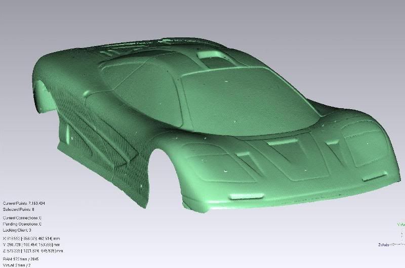

One thing I have set up in the time off the car, which may be of interest to some people on here, is my new company 'Capture Point'. I can now offer 3D scanning services. This, up to now, has been a hugely expensive thing to get done and well out of reach of 'home engineering' however I'm offering it at much more sensible prices. Please see below:

Here's a quick vid of a Corrado VR6 front hub assembly
[youtube:1bo41cbp] [/youtube:1bo41cbp]
Or full size Corrado scan.... (low quality, sent from iphone)

I'm interested in the scan of your front hub! A guy on here wants me to do make a pair of caliper carriers and that would really help me! Where i'm working at the moment (Jankel Armouring) they could really do with someone to do the scanning of chassis, body panels etc, are you mobile?
PS, what file does it come in as, iges, step or is it surfaces?
Hi Kip. Yep totally mobile! I haven't quit the day job yet so doing jobs during work hours is a little tricky, although if its worth it I will take the day as holiday. Other than that I'm more than happy to do work out of hours and even over night. If the items not too big I happy to be sent objects in the post, scan and return.
I can provide it in any format you like. native output is stl or asc (point cloud) which is good for most uses although the file size can quickly go nuts! further post processing means I can output 'automated' surface model (ready little extra £) or I can create surfaces patches (read £) or you can go the whole hog and go for 'A' class curvature matched surface model (read £££ and time!) for perfect body panels but only really needed by OEMs.
We can work together to get the detail you need at the best cost and time. Unless its a massive model, stl's can generally be supplied 'next day'
Igs, step, stl etc all available.
If you get me some good work, the hub is yours!
