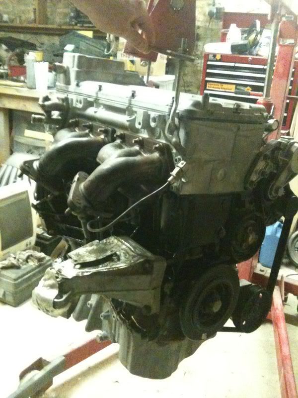

No great leaps forward today but I did manage to get all the parts I needed off the 2.8 and on the Audi 3.2. Also spruced up a few bits before it goes in the bay. Will fit the gearbox tomorrow and get the engine on its mounts.
Then I have to workout the bits I need to make it run on the VR6 ECU. shouldn't take too long to work out but the motor on my lathe went bang a little while ago so until I get a new one I wont be able to make the parts... fingers crossed for Christmas... 'thankyou darling, thats a lovely single phase 1.5hp motor' but its more likely socks! lol

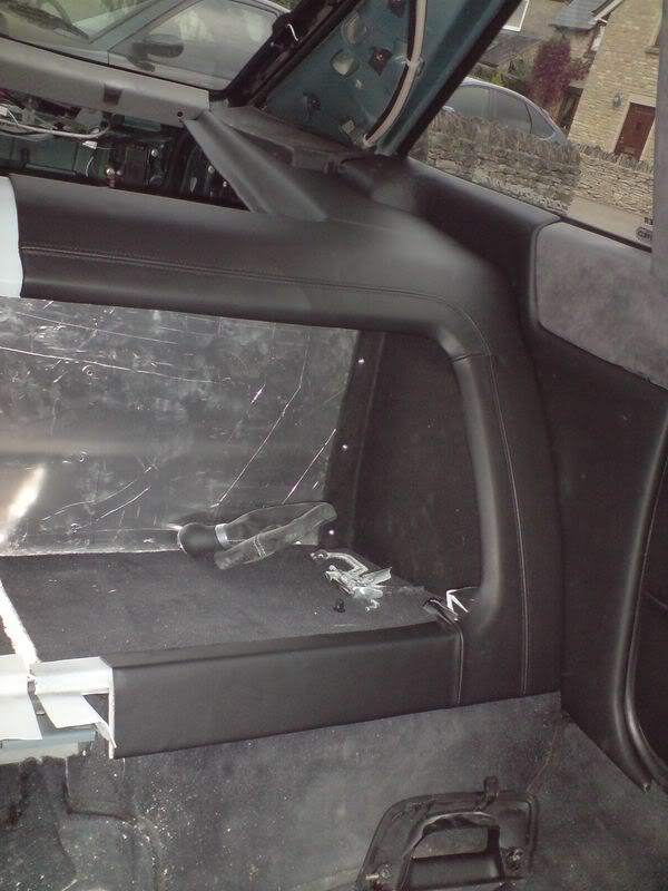

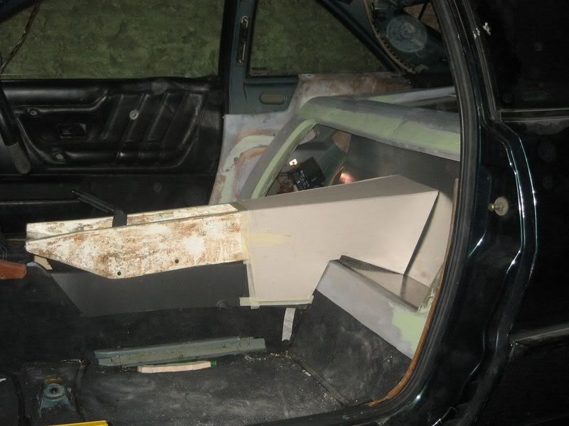

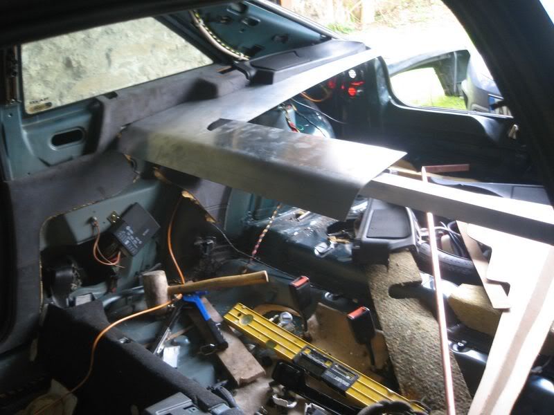

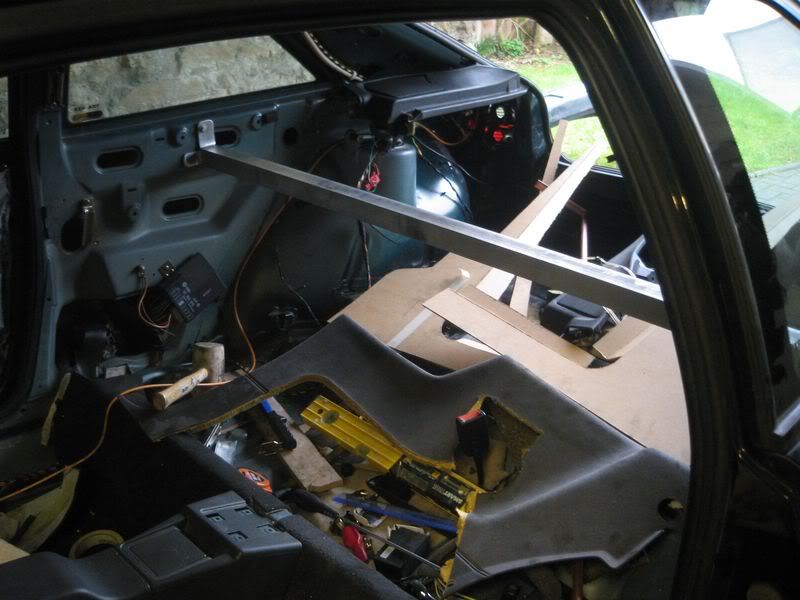

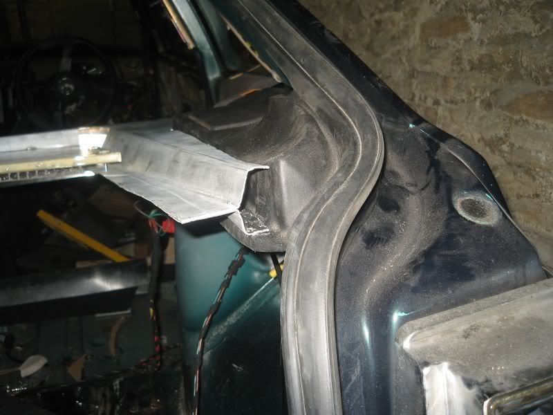

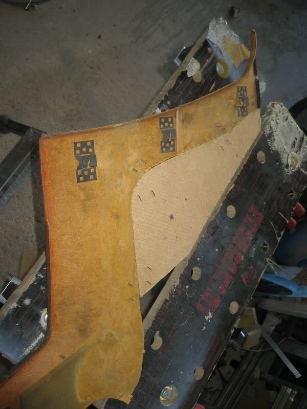

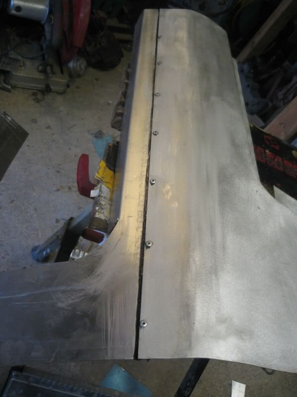

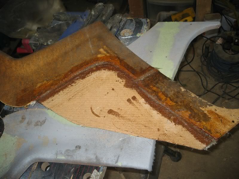

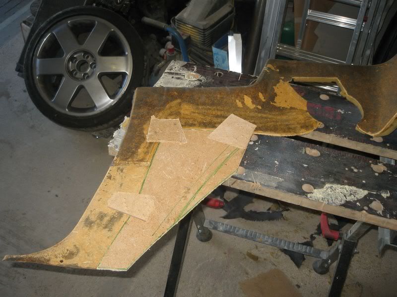

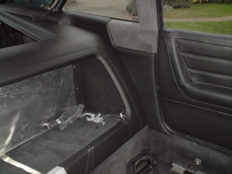

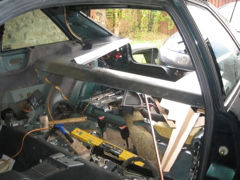

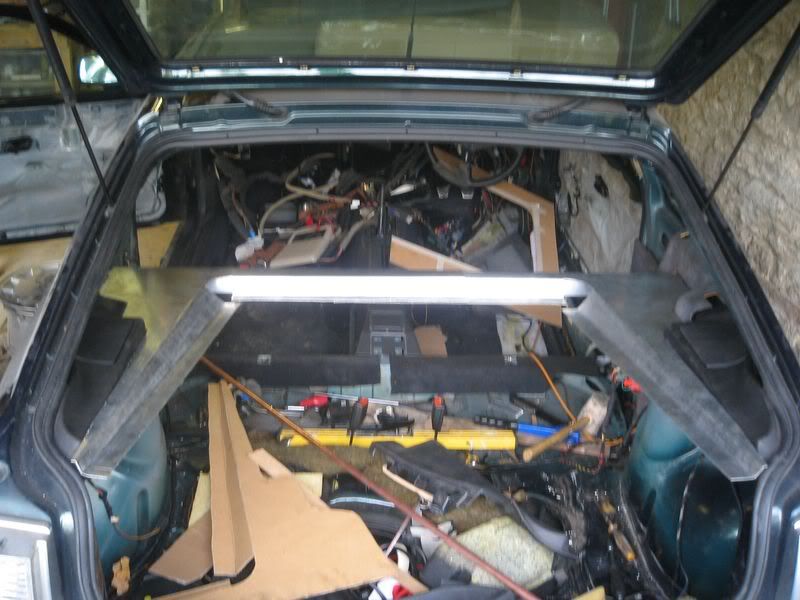

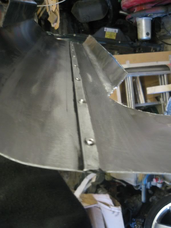

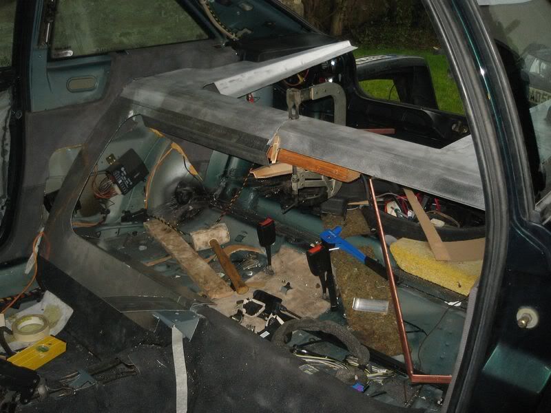

I've also been doing quite alot to the rear of the car and just been going through my photos, heres a few of the progress....
No rear seats.

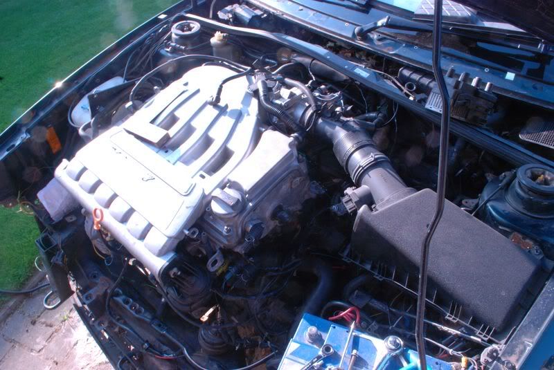

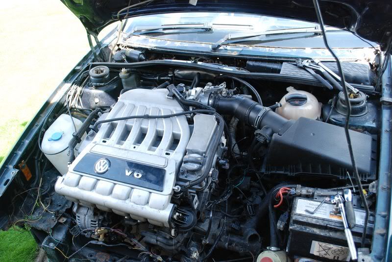

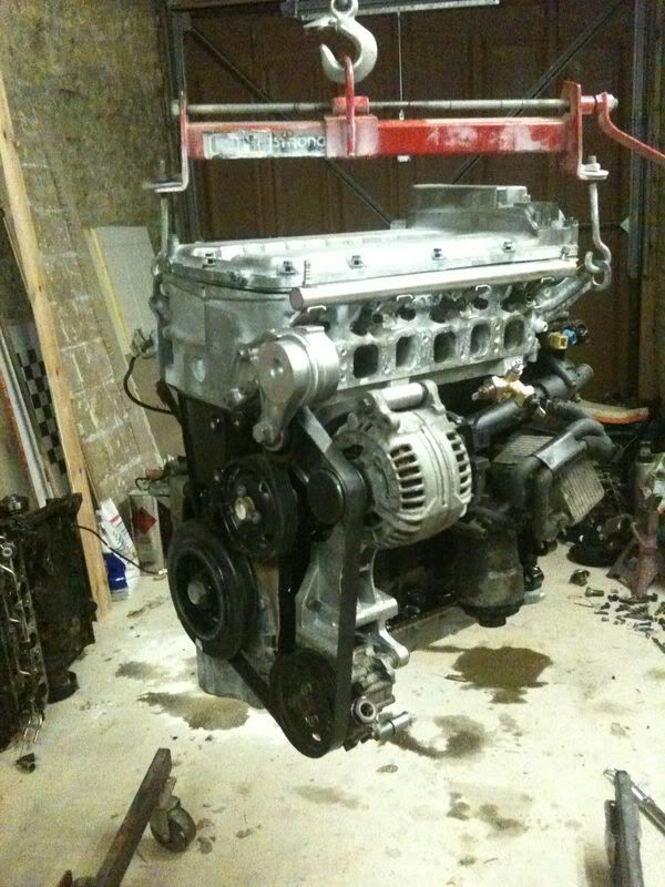

Its been soo long since I last worked on the car that it took me a good while just poking around to find out what I had got up to! It looks as though I got the R32 engine in situ then stopped there. So first job was to get the engine in properly. I started with fitting the cover which goes over the the pulleys and then fitting the cam cover.

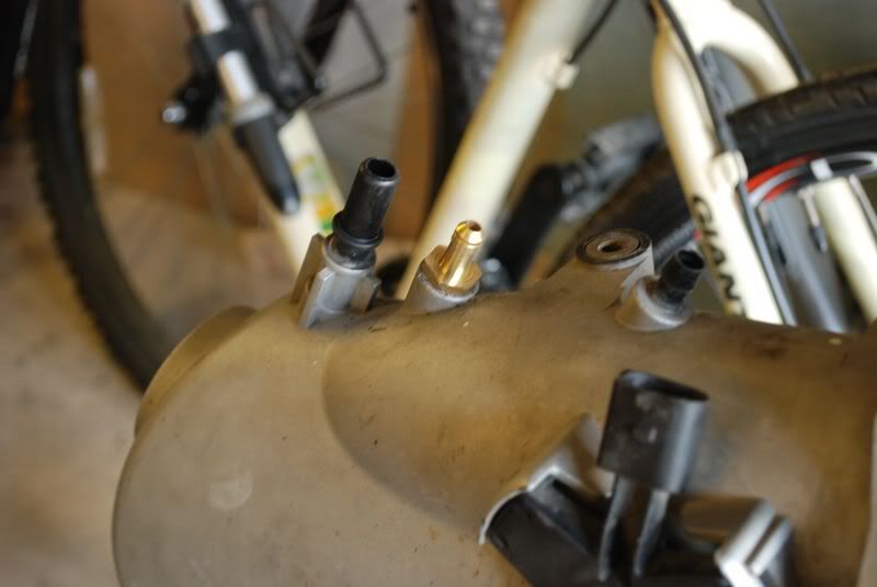

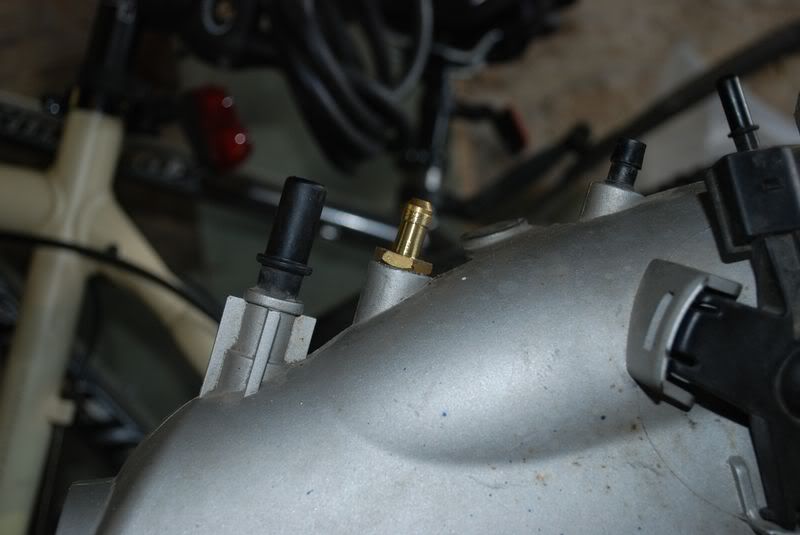

Then I looked at the Inlet manifold, this was in need of some tlc, the variable inlet actuator was bust, the nipple the pipe attaches to was snapped and I also noticed on of the pipe fitting on the rear was broken to. Fortunatle I found a 2.8V6 inlet for sale locally, bought this as swapped the broken actuator. I needed to fix the pipe inlet on the rear, the molded in plastic one had snapped so i had to have a think was to how best to fix it. tried a couple of things which turned out to be useless. In the end I resorted to making my own, I had some various hydraulic fittings kicking about in the garage, like a larger brake bleed nipple. I turned one end down to suit the pipe it was to fit (the other end was still threaded) to fit it into the manifold. I cut flat the broken one and drilled a hole to suit the thread. As this was a hydrauic fitting, it has a weird thread. to get around this and to ensure an air tight fit I couter-bored the hole slightly so it would fit in it then heated the fitting up with a blow torch. when it was hot engouh to slightly melt the plastic surrounding it I could screw it in. I was very pleased with the result, its air tight and way stonger than the origonal!

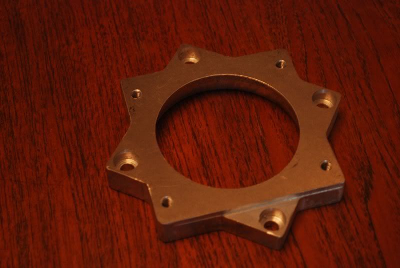

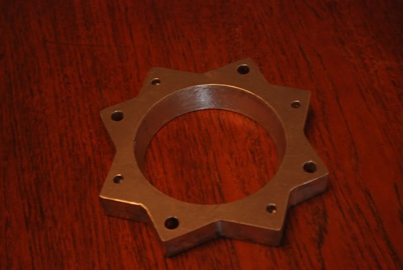

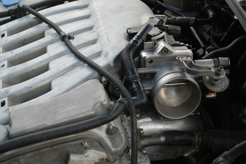

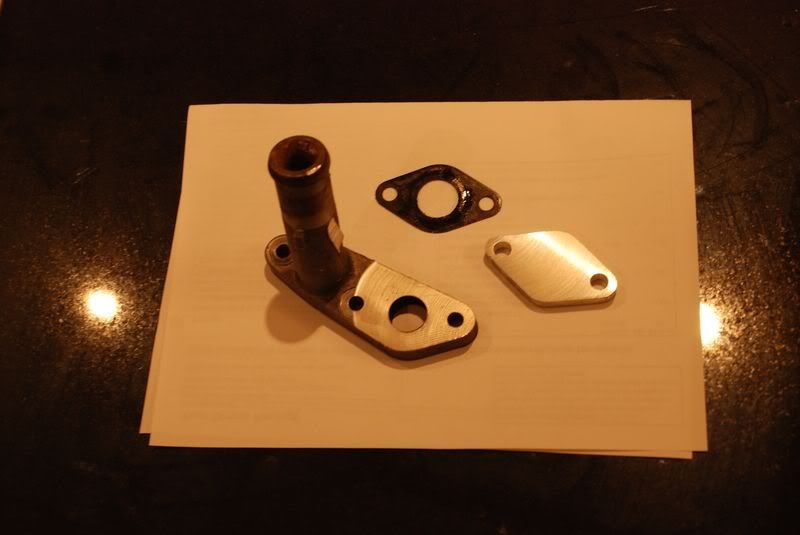

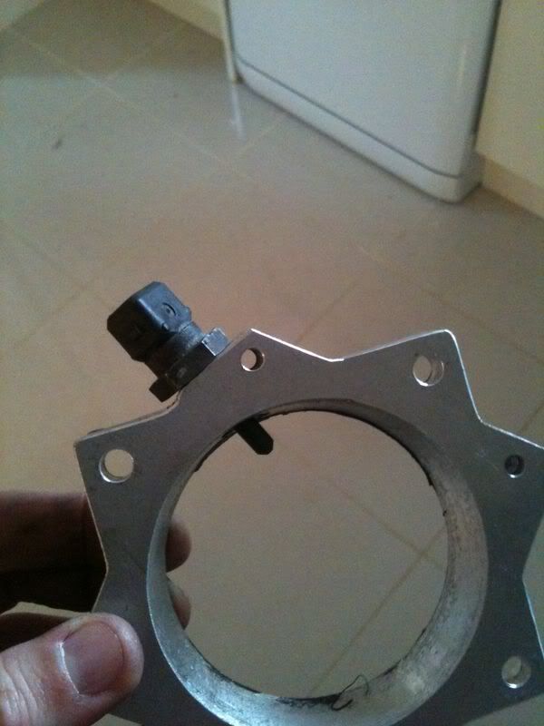

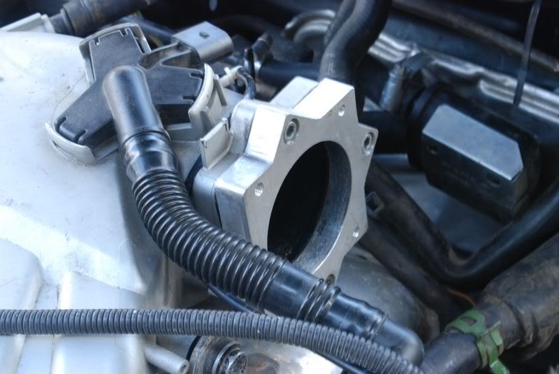

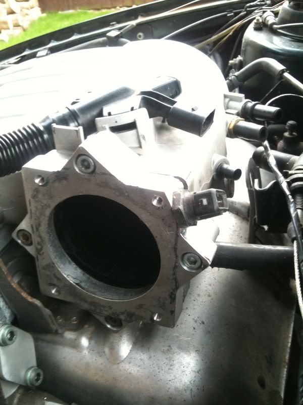

I've decieded to go ahead and use as much as what I had made before ref the inlet, I i'm going to go ahead and use the VR6 throttle. I had previoulsy had this fitted to a 2.8V6 inlet manifold so i had to make a new adapter to suit the R32 one. This was time consuming as the mounting face has a lot going on! so some measuring, a little CAD and alot of time on the milling machine resulted in this....
The main hole in the center is tapered to smoothly transition from the R32 inlet dia to the smaller VR6 dia. The inner diameters matched up perfectly and while the outer shape fixes to the everything nicely I may revisit the perifery to get a better match - after I get the engine runnning and the car finished!

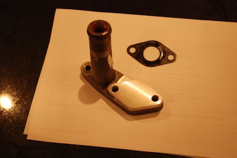

I also encountered a problem with the throttle clashing with the aluminium casting for the water pipe and the EGR system. I had previouslty blanked the EGR bit off without modifying the casting but as the throttle was now held differently there was now a new clash, so out with the hack saw, chop stuff off and back on the milling machine...
This also gave me more room for the throttle position connector. Before, I had to fit this to the throttle and then fit the throttle to the manifold.
I bought a new gasket for the manifold so fitted this. I also oreder new bolts for the manifold as they are a weird size (M7!) and as I bought my manifold and engine seperately I didn't have the old ones. Unfortunetly the VW dealer I got the parts from managed to confirm I needed 9, gave me a price for 9, then ordered ONE!!! so I have it held in place with the one I got but I cant progress at the front of the engine till I get the others, tomorrow apprently, or maybe it will take me nine orders to get all of them!
I attached a few more bits around the engine bay then called it a day there on the engine.

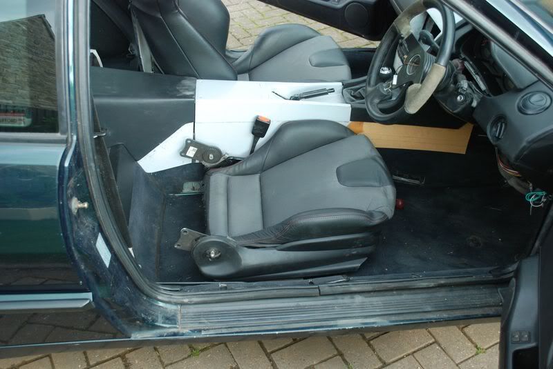

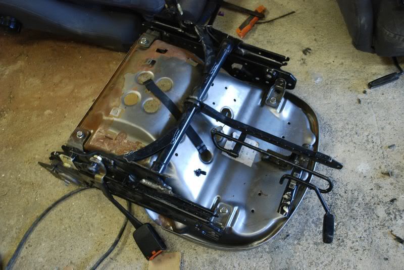

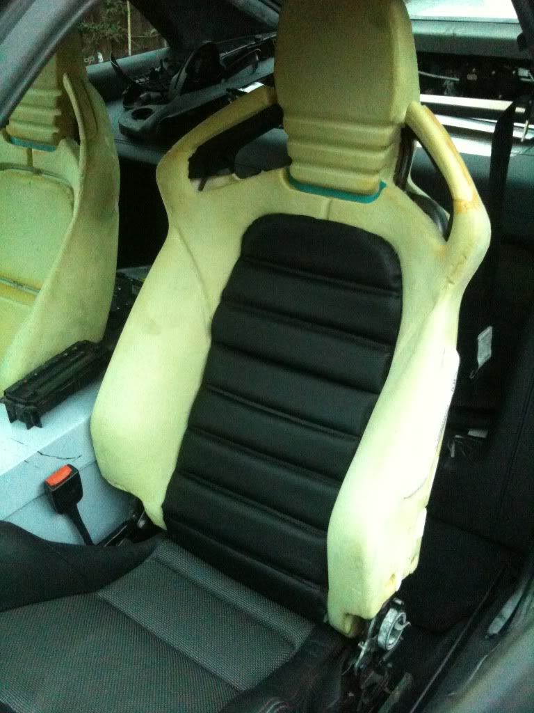

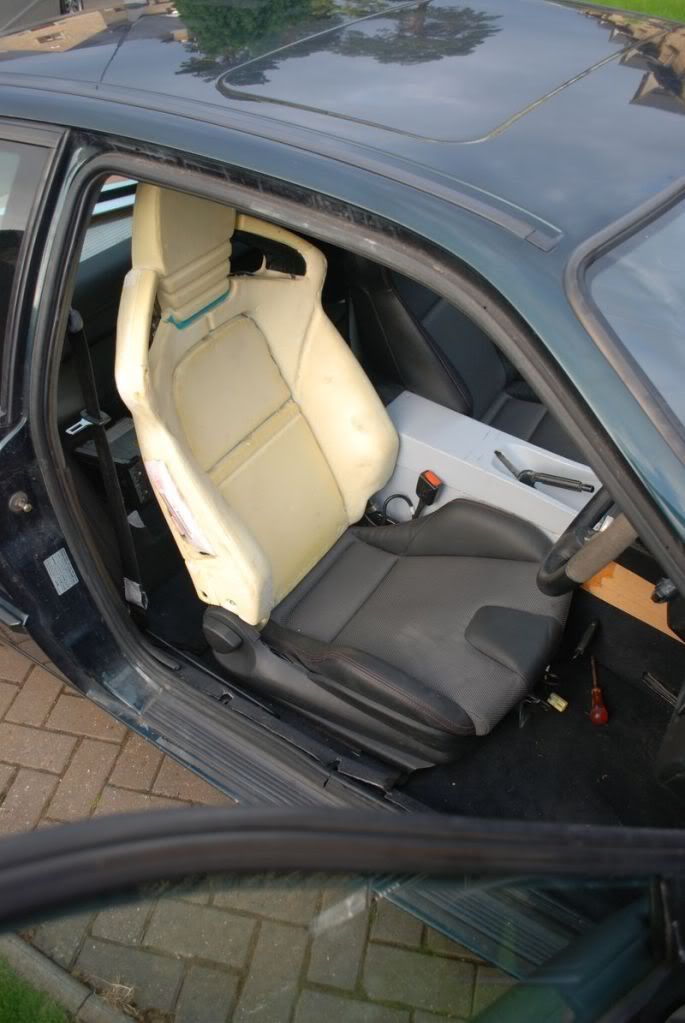

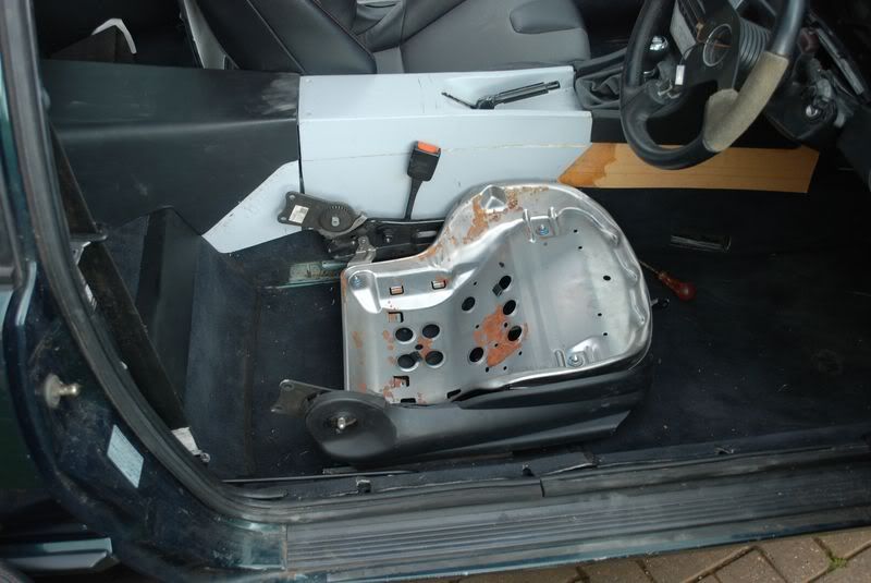

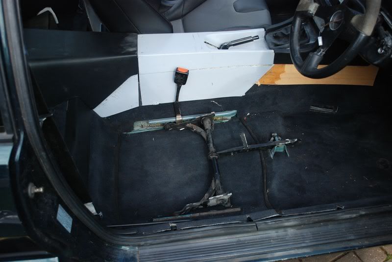

Next job was to make some progress on the seat. Nothing had happened on this for ages, one, because I haven't looked at the car ages and 2 because I couldn't find any old seats to use to make subframes for them. Luckily the E38 Clasifieds came up trumps and I dashed out to pickup a pair of corrado fronts. I then stripped down the seats I'm going to fit and started to work out the best way of making the subframes...

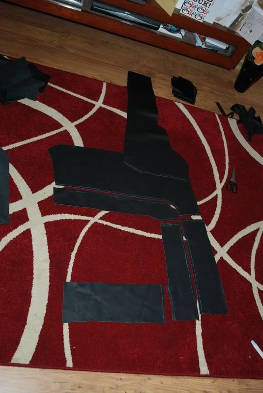

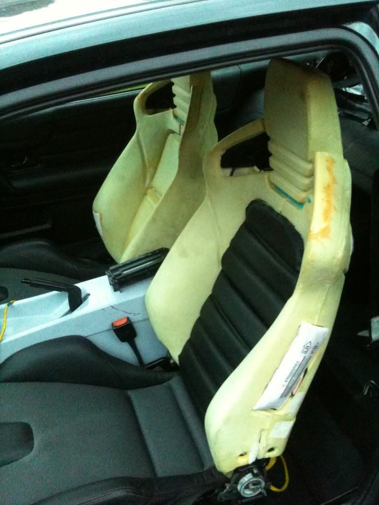

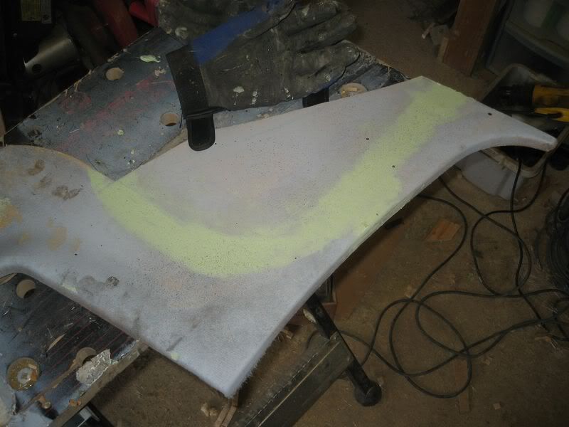

I've made a start on the seats. I'm hoping to have a good crack at finishing one seat on friday but thought I'd throw up a pic of the paneling of the centers.... (cr*ppy iphone photo, but you get the idea ;) )

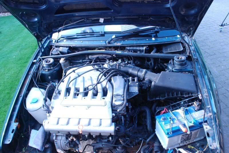

Continued to tidy the engine bay and get all the VR6 bits on.

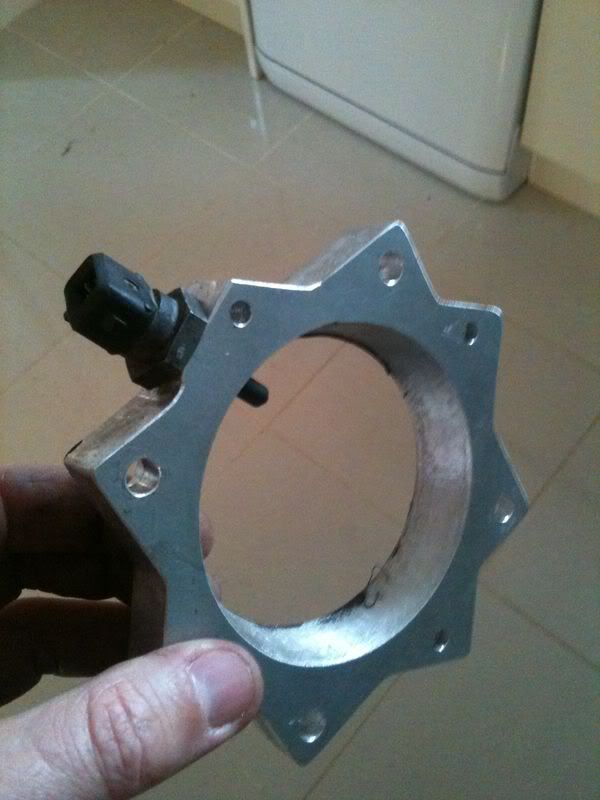

When I did the 2.8 I added the VR6 inlet temp sensor into the inlet manifold which meant drilling and tapping into one of the inlet runners in a position similar to where it sits in the VR6. I was never really happy with this as it didn't seem robust enough to me. So this time I took some more time to sort a better solution out. I ending up with incorporating it into the throttle adapter I made (see pics). I really like this as a solution as it leaves the R32 inlet manifold completly std.
I did have to shave alittle off the throttle and the inlet to get this one to fit as the hex of the sensor overlapped the edges of the adapter. Thats fine for this one but if/when I get to do this again I will make the adaptor a couple of mm thicker and this would mean no mods to either the inlet of the throttle. All you need to do is lengthen the wiring to the new position.

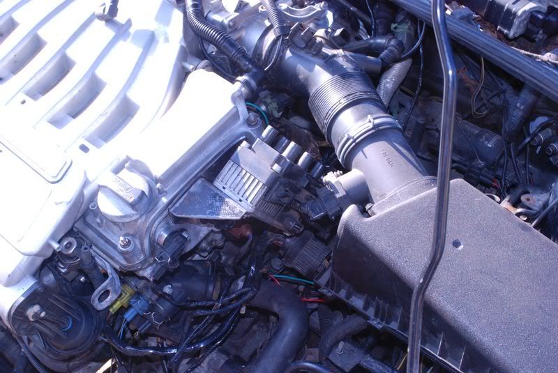

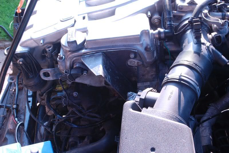

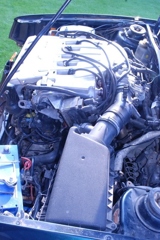

I then set about trying to sort a good position for the coild coil pack. this was tricky as the R32 inlet is designed for coil on plug so doesn't leave a good route for the HT leads to go from head to coil pack. Also there's a whole bunch of stuff hanging of the side of the engine which isn't there on VR6's, all the variable cam stuff.

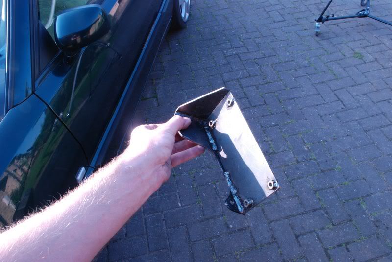

I made this bracket which I think is a nice compomise, fits in the gap between the engine and the airbox and works around all the cam solenoids and sensors I also angled it so water will drain off the coil pack...
All thats needed now is to adjust the length of the HT leads and make something to nicely route them. In the future I would like to look into whether its possible to make an adapter harness to go from the coil pack VR6 harness to the R32 coil on plug. I've seem this done on some BMW's but it's a little project which can wait for the time being!

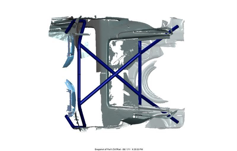

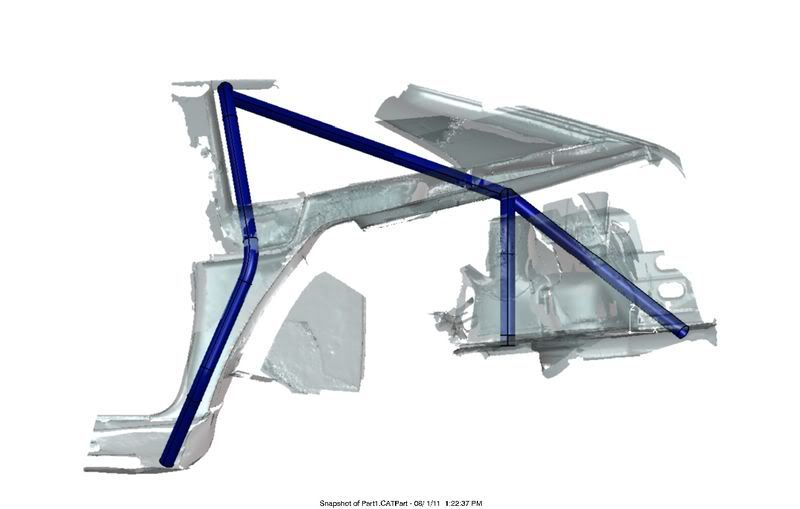

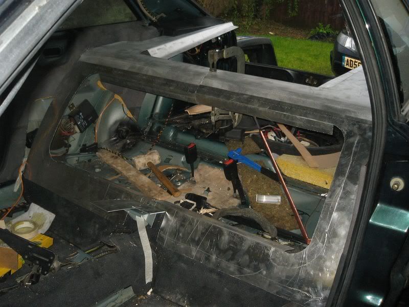

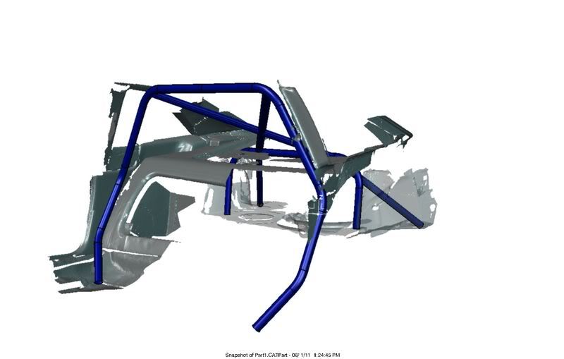

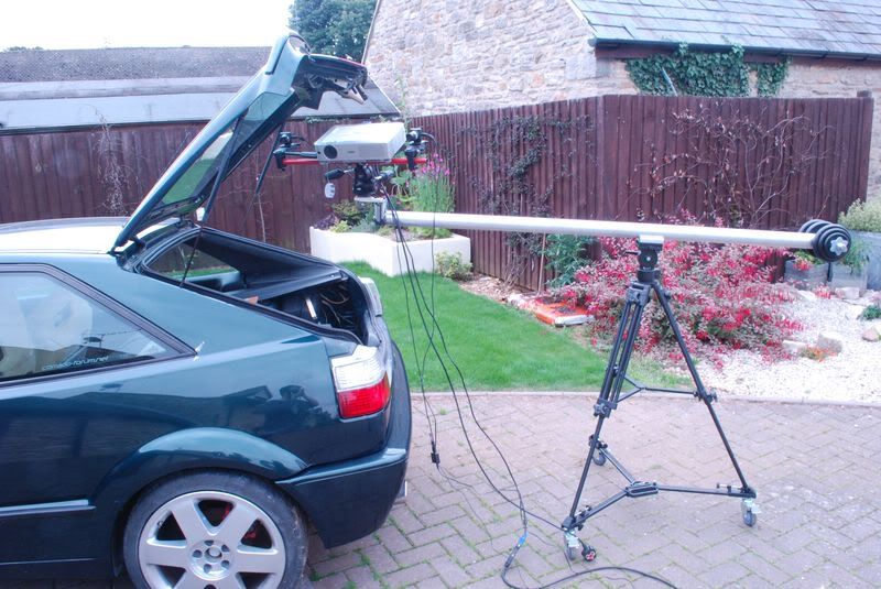

I also wheeled the 3D scanner out and started on scanning the rear env...
your skillset never fails to impress Doug. One very accomplished enthusiast!
LOL thanks, it keeps me busy!

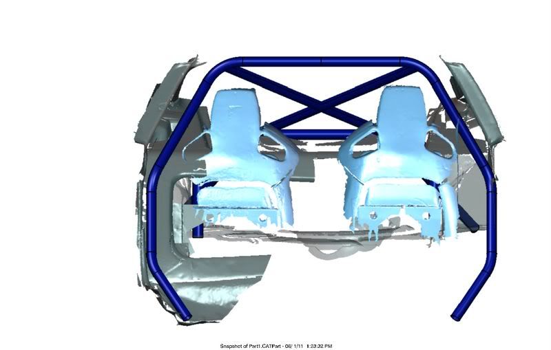

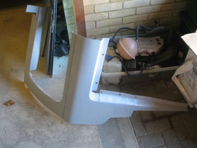

I've still got a fair bit of work to do aliging all the scans more acurately but I couldn't resist doing a quick rough model to see what it would look like...
just got to find a good place to order the steel from..?

Coil pack and leads look better than you described mate.
