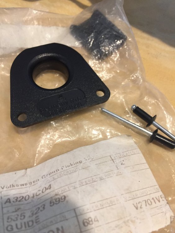

Found my 10 year old, NOS of slam panel fittings for the bonnet pin locators (had to order black rivets as VW only had silver at the time). Oscar thought the rivet gun was brilliant, but disappointed he didn't have the hand strength to "pop". He did laugh at the fact that new bits were nearly as old as him.

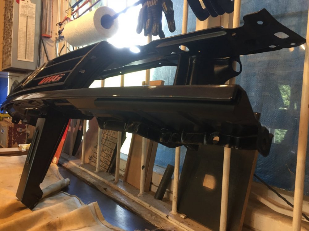

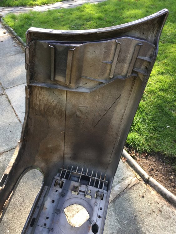

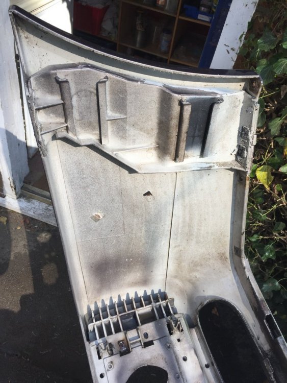

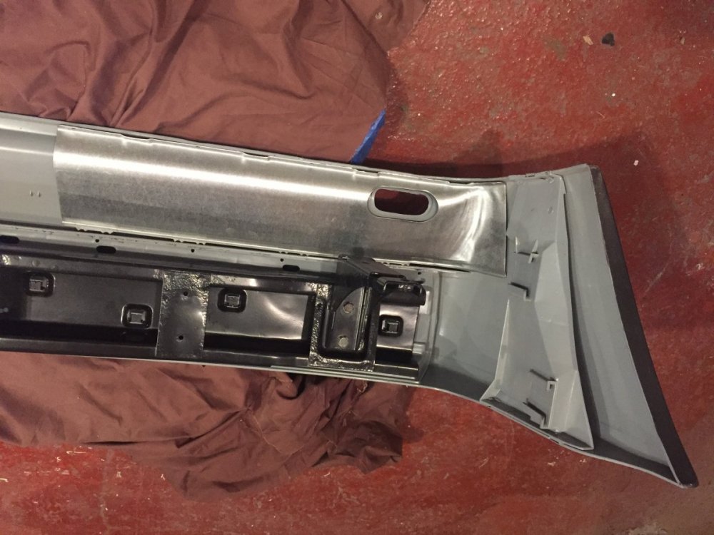

Washed and cleaned the rear of the front bumper. Sprayed with primer and clear coated to match the rear bumper and floor pan.
Rear

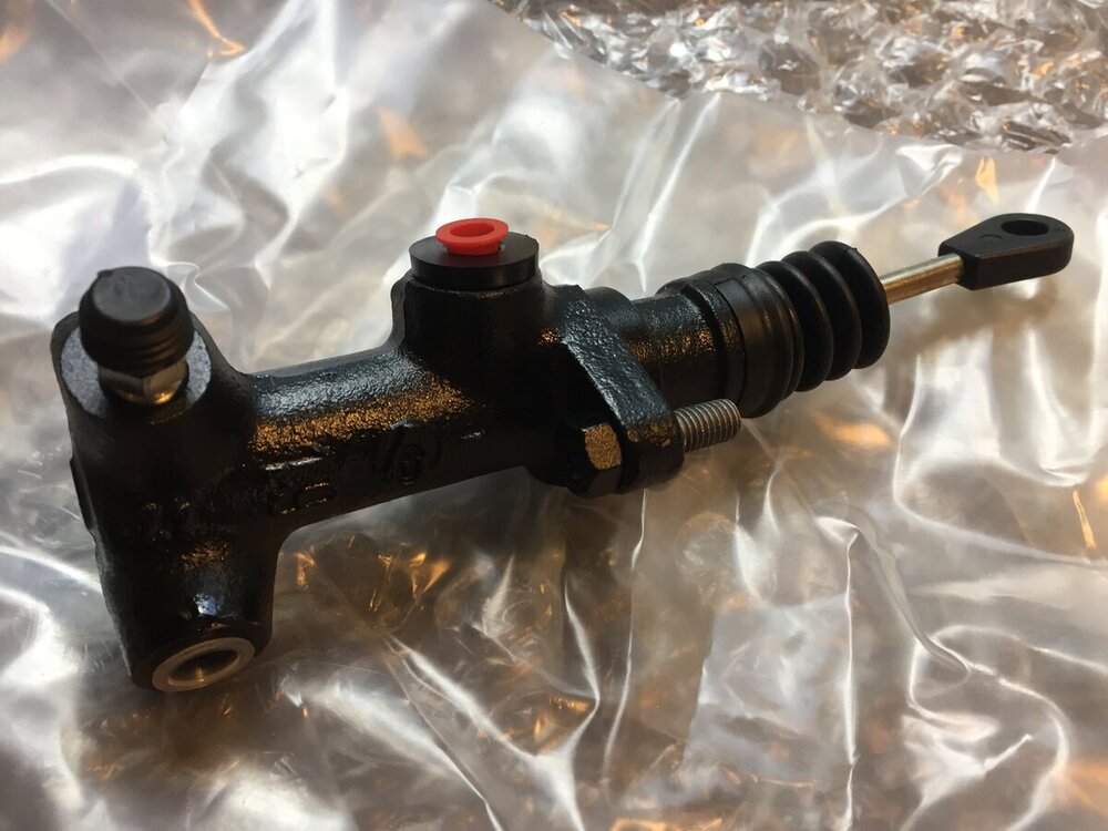

Sent the Clutch master way for a refurb to past parts. I've said it before, but what a service. Took less than a fortnight door to door and came back as new. Cost £90.

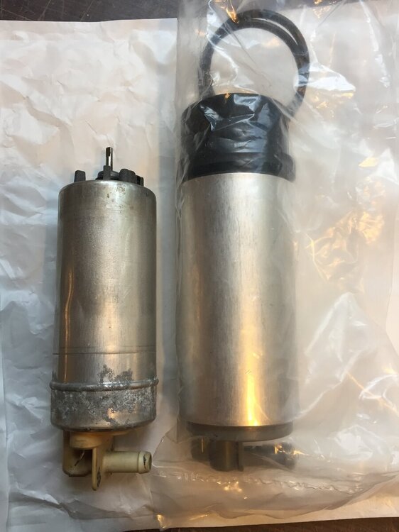

Also ordered and received a new fuel pump from https://www.fuelpumpsonline.co.uk. It looks (at last for the time being) that this is a replacement pump for the later VDO unit. I've emailed them this morning to see if there's anything we can do, as the fuel pump from the pierburg unit is a little smaller in diameter. There's a solution out there, we just need to work out what it is. Anyone have a (working/faulty) VDO unit that they don't need anymore ?

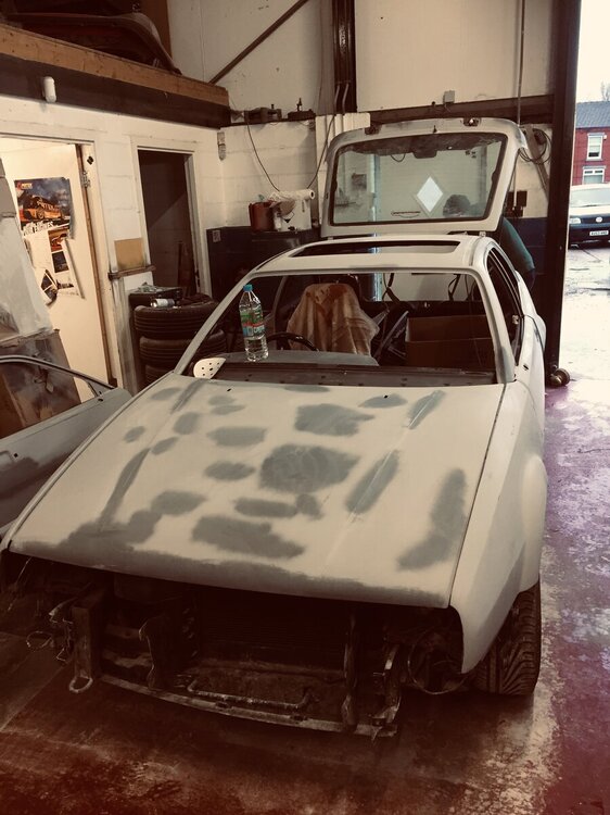

In other news, the 8V paint is nearing completion:
I'll be calling in this afternoon to see the finished job. Hoping to get it trailered back on Friday, so that Oscar and I can start to rebuild it over half term next week.

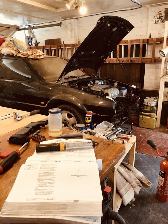

What a day !
Having spent the last six months looking over my shoulder at the VR getting covered in more and more dust, and now having the 8v in a more “day to day” condition, I decided to re-visit the long term project.
After the 8v had an overnight stay at the local specialist, I quizzed about the fuel pump and a little advice. Get some pliers on the shaft and try to free it off. Put power through it and try running it backwards.
After a little soak of oil and more than a little persuasion, we had some movement. Lumpy at first, slowly freeing off with a little resistance.
That was a few months back. Half eight this morning, I’m fishing around in the tank, removing the pump to carry the same procedure out.
Pulled the fuel pipe from the rail and tested that the fuel ran off, when turning over (into a catch pot).
So we have fuel.
I’d already checked we had spark.
Pipes are all free and able to breath easy.
So what gives ?
I could smell petrol in the inlet of injector number 4. But none of the others.
Have I put the distributor back on 180deg out.
Turned the engine to TDC and re-fitted the dizzy as per Bentley.
Next up, checked the coil. All within Bentley parameters. Output when ignition on, pulsed etc.
Injectors. Resistance good. Immediately thought it must be blocked injectors ? But five going faulty to the same end. Mmm, not so sure. Power ? Nope, nothing, nada.
Ignition on and turning over, nish.
Bugger. Bentley advice: check loom back to the ecu. Great. Just about to start sticking pins in the wiring, but decided to check the obvious points of connection. About to rotate the main loom junction open and there it was, the main red/blue feed wire had been pushed out of the back of it’s housing.
Multimeter back on the injector connectors and we now have power at each and every one of them.
Feeling brave, I opted to chance my arm at starting it up.
I didn’t get chance to finish the line “ah well I tried”, and it burst into life. First time, no hesitation, as though it had started just yesterday.
