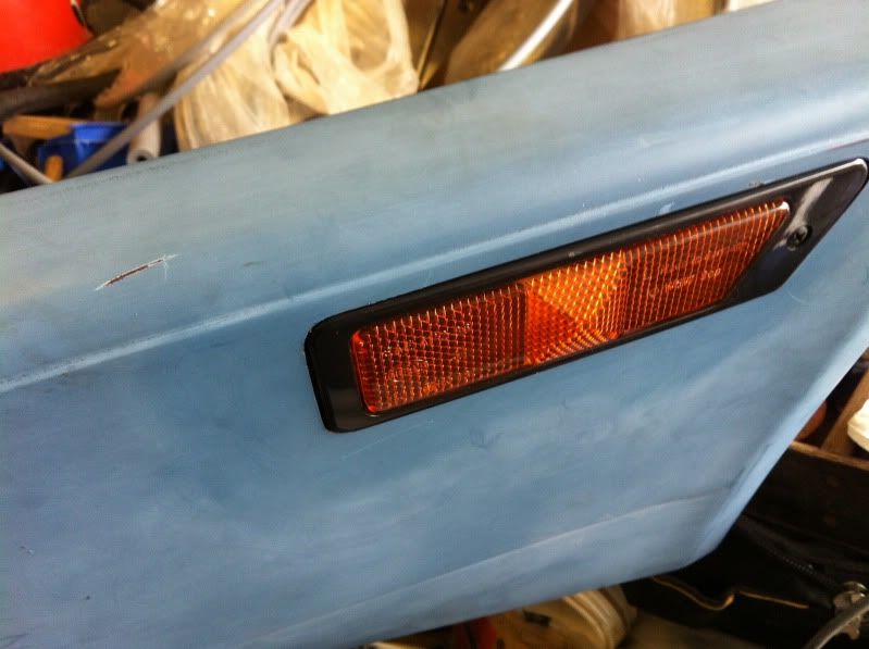

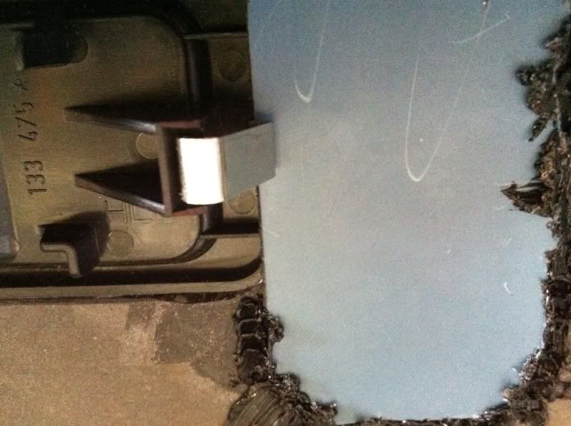

it doesnt have to be pretty its not going to be on show..
and it fits!

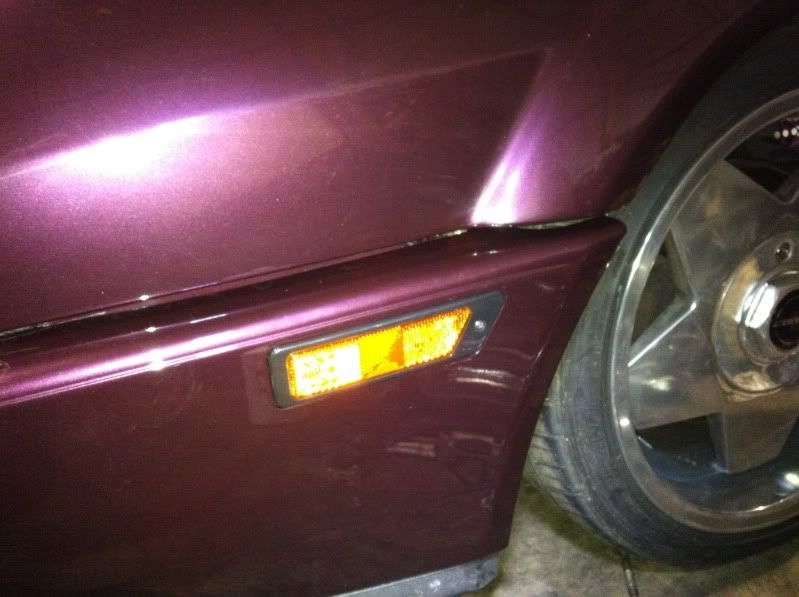

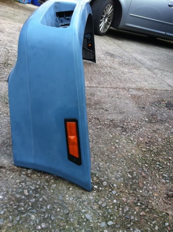

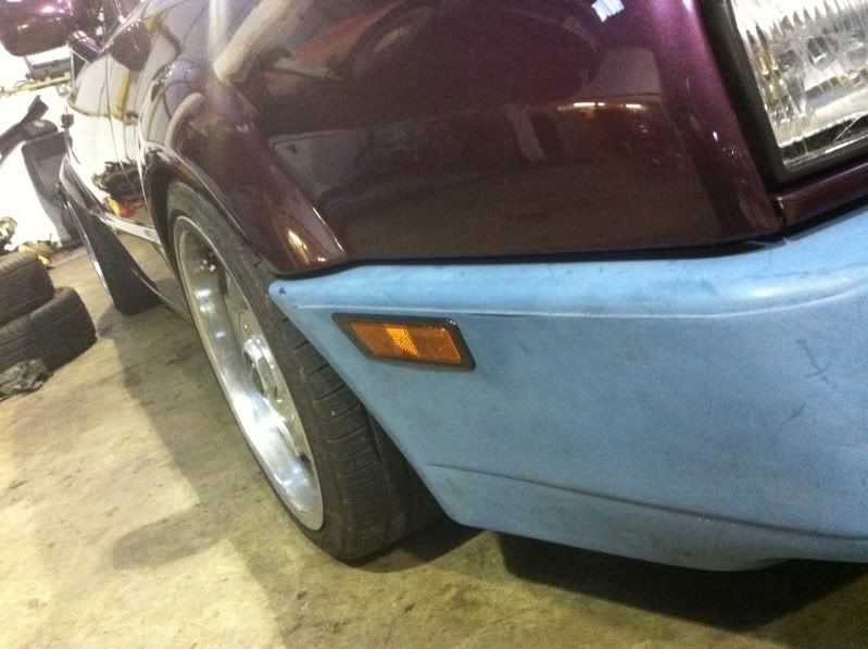

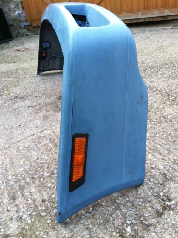

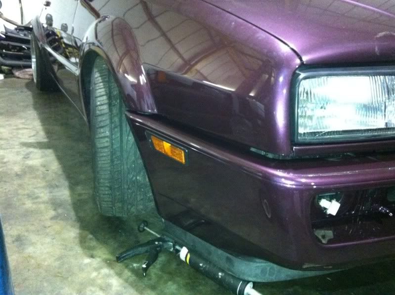

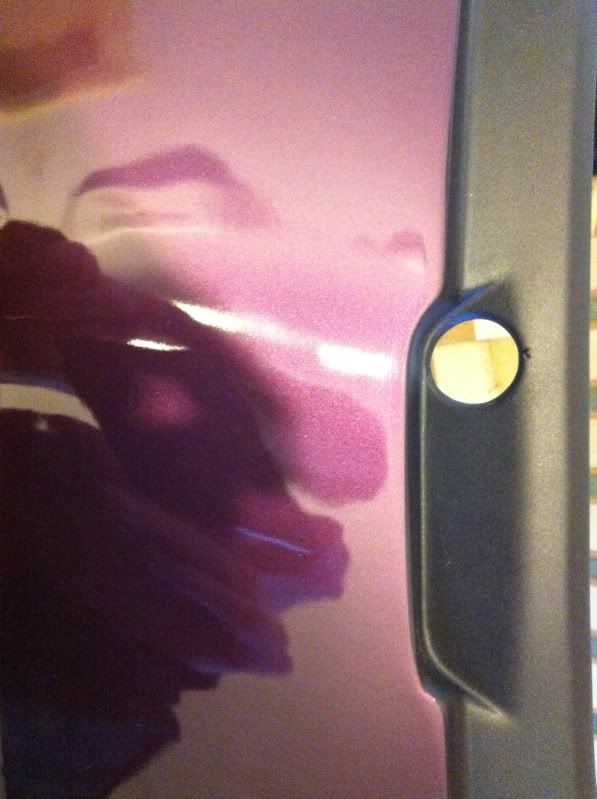

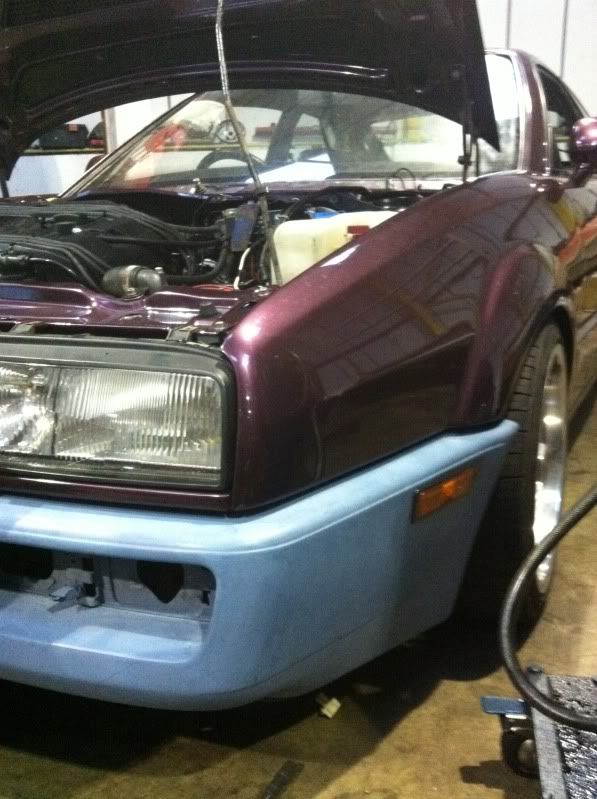

a quick trip to the garage to offer it up on the car to see how it looks... no bumper iron in this so its a bit flopy
to support te section of the side marker with the screw in i unforunatly will hae to eave you to your own devices i used 15mm talon pipe clip cut down and mitre bonded in and then drilled a small hole so the self tapper could bite onto it to secure the unit in place im sure someone can do this beter what with the day running on and me not feeling any better it was the best i could do in a rush!

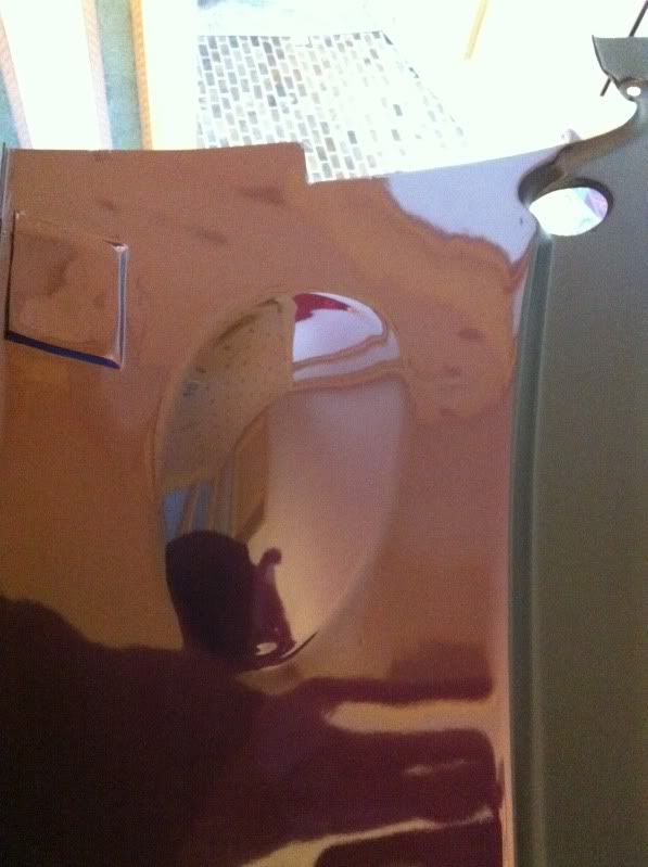

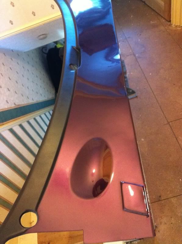

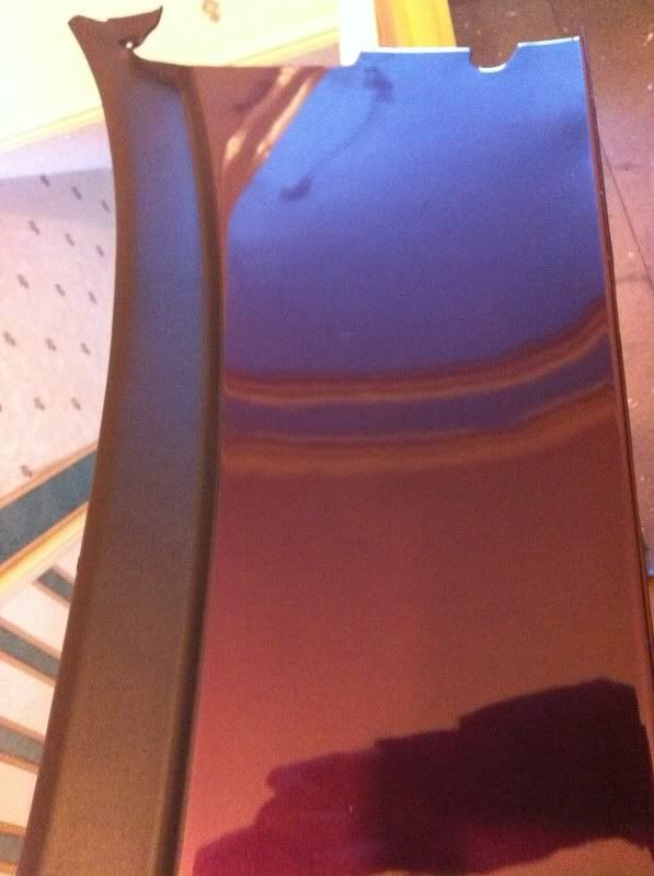

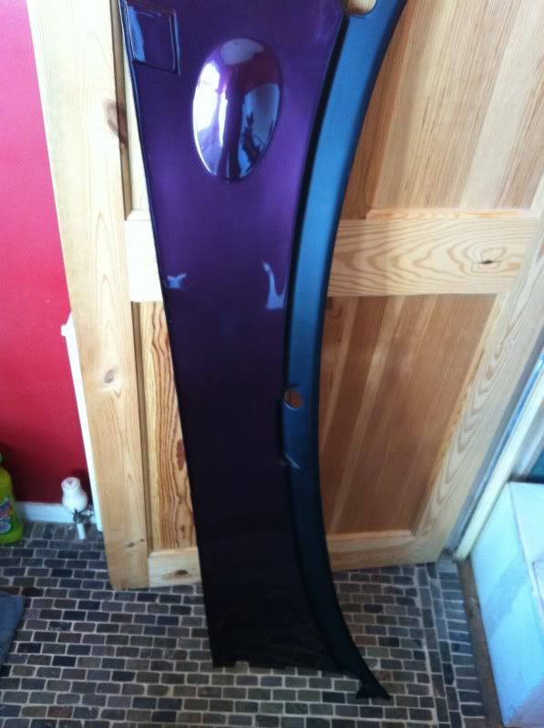

also heres a pic of the SWG scuttle panel i bought off of here somewhere.... seen some action has this bad boy, all repaired up and ready for show!
had it body coloured then the bit that sits up against the windscreen ive had texture painted so it looks like and original piece when the bonnet is closed it looks standard ish.... which is what i wanted to achieve!

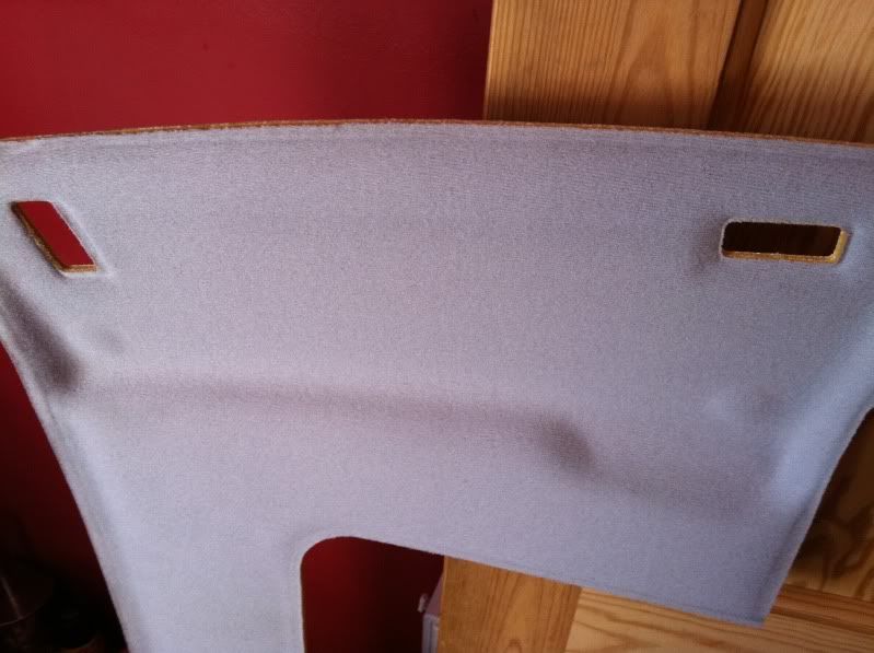

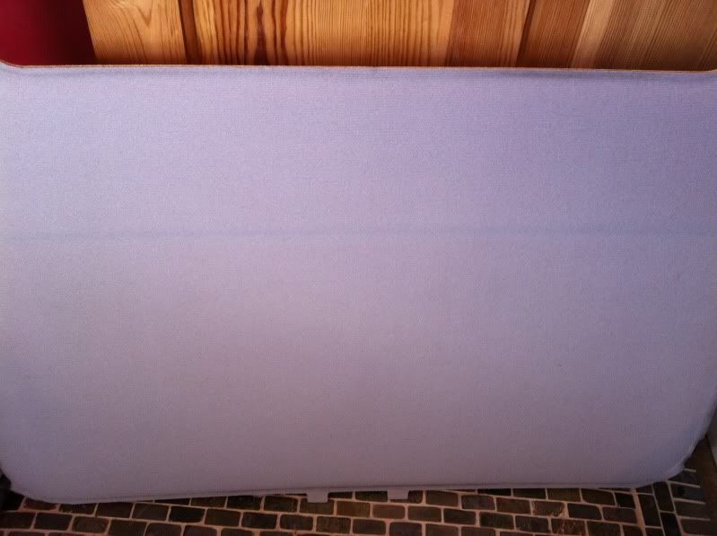

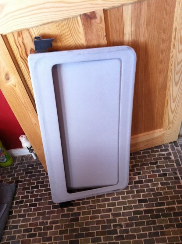

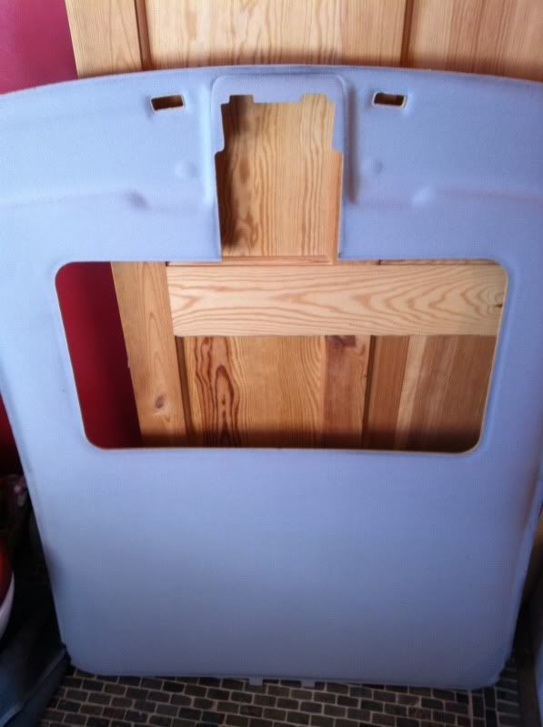

cleaned up the old headlining and sunroof panel ready to sell on...

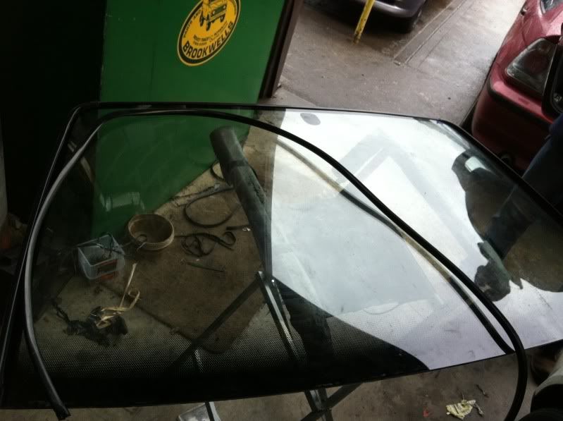

my mate turned up today with a nice shiney new windscreen for the car , couldnt turn it down so in it went!

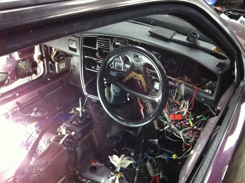

got the dash back in at last well nearly!

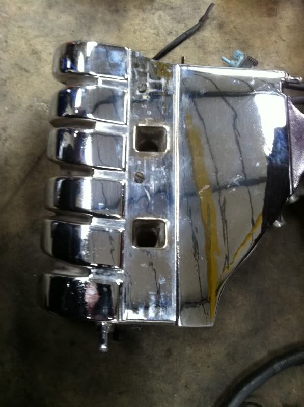

as im selling all of the chromed goodies i got bored and started to wire brush the obd2 manifold....

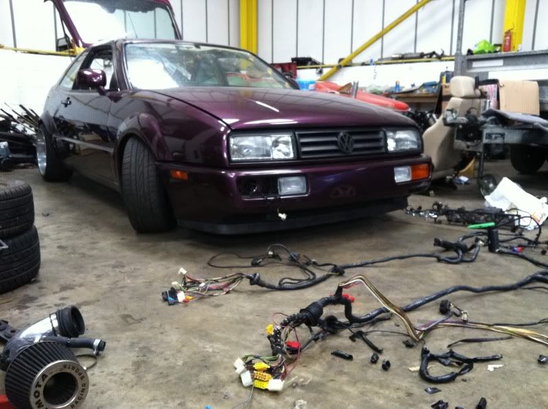

the two loom s are sat in fron tof the car at the mo.....il get teh interior fonished in no time its just the wiring thats holding me up!!! so close but so far , been off the road since september really geting the itch to drive her again now!!

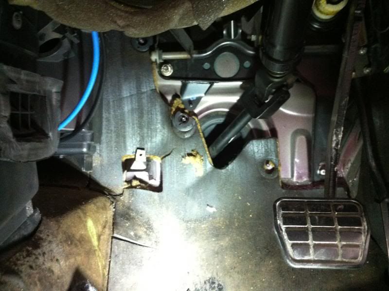

inside the car drivers foor well remove shelves and get a lead light of some sort if you can remove the seat then do it you need to be comfortable when working on this and the less stress the better!
there are 4x 13mm nuts just undo them around the brake pedal youl see where i mean,
in this photo just above the brake pedal you can just see the nuts
well maybe not! not a very good pic but you can just see the white round bit the nuts are situated around it in a square undo these...

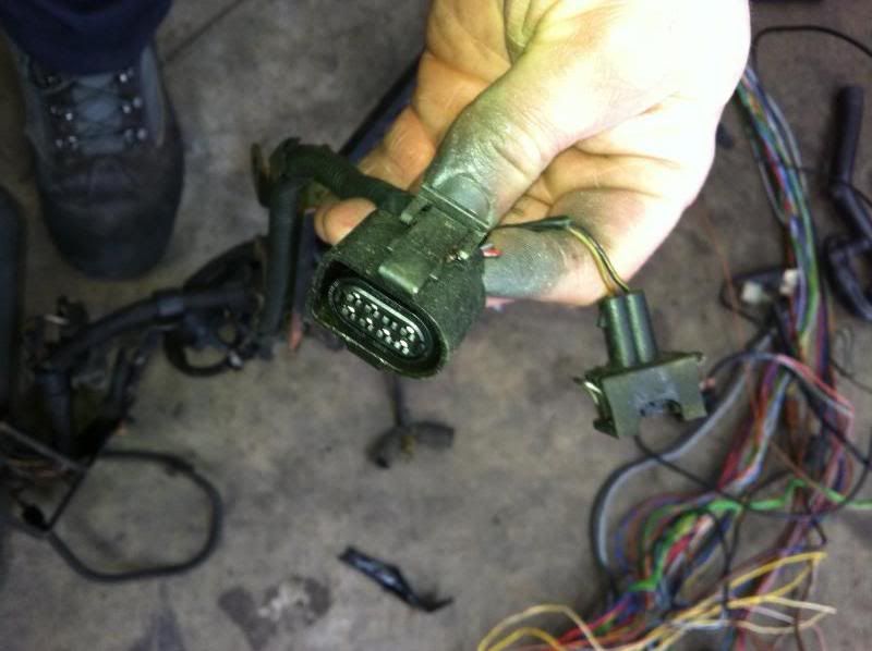

round multi pin connector block from engine bay loom
the ecu multi pin connector

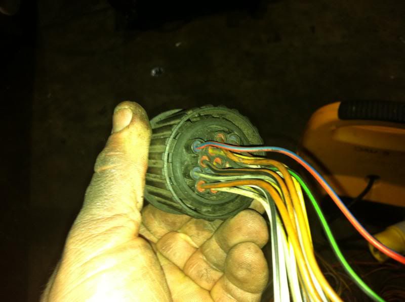

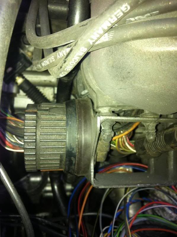

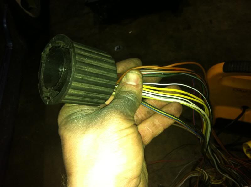

once stripped back get the golf loom and you will notice it has two big round multi pin connectors on it one is obviously engine harness attachment and the other is the golfs lighting ancillary loom ....ditch this cut it out get rid of it fcuk it off throw it away....
ok you got the idea

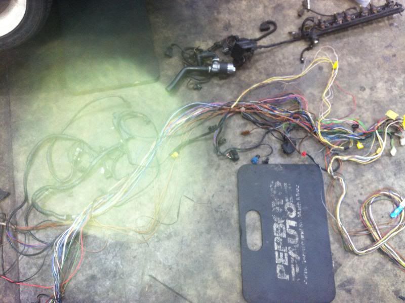

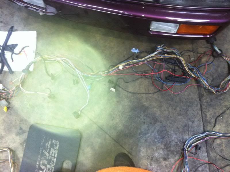

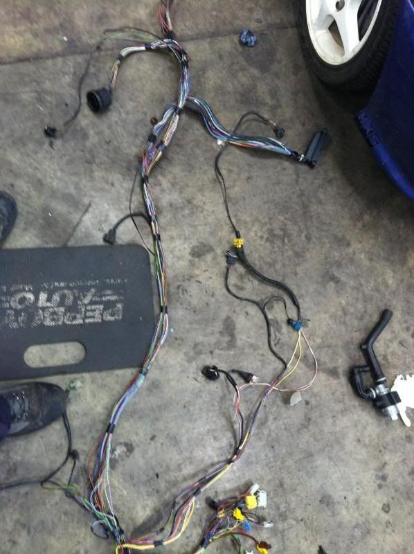

you should start to have a pile of wires that look a bit like this , dont worry ,this is going to get bigger!
the golf loom should now resemble something like this after you have used the black insulating tape to give it some shape..

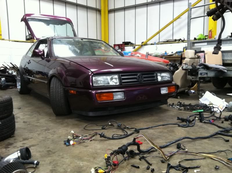

so both looms are on the floor next to each other

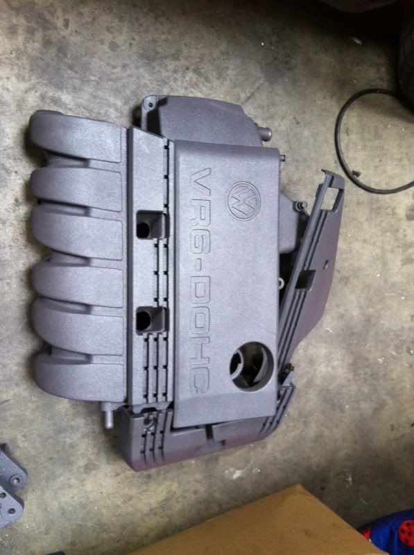

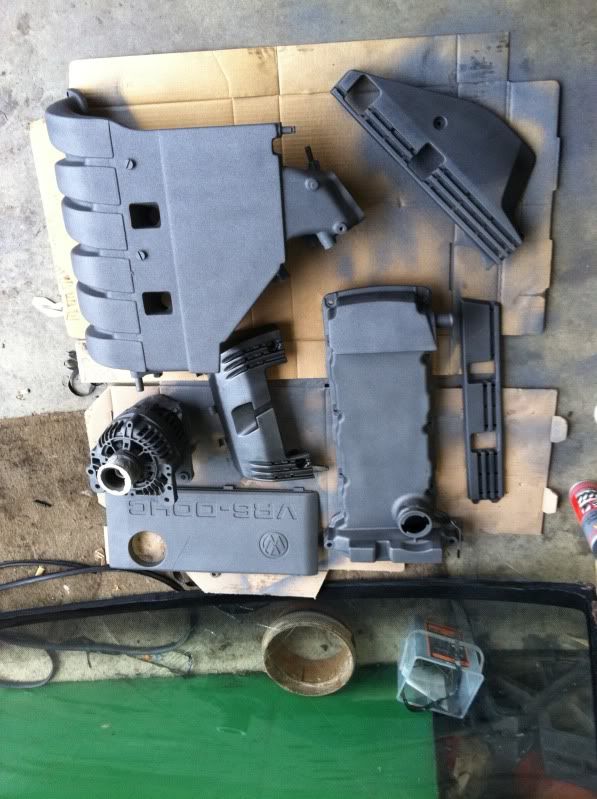

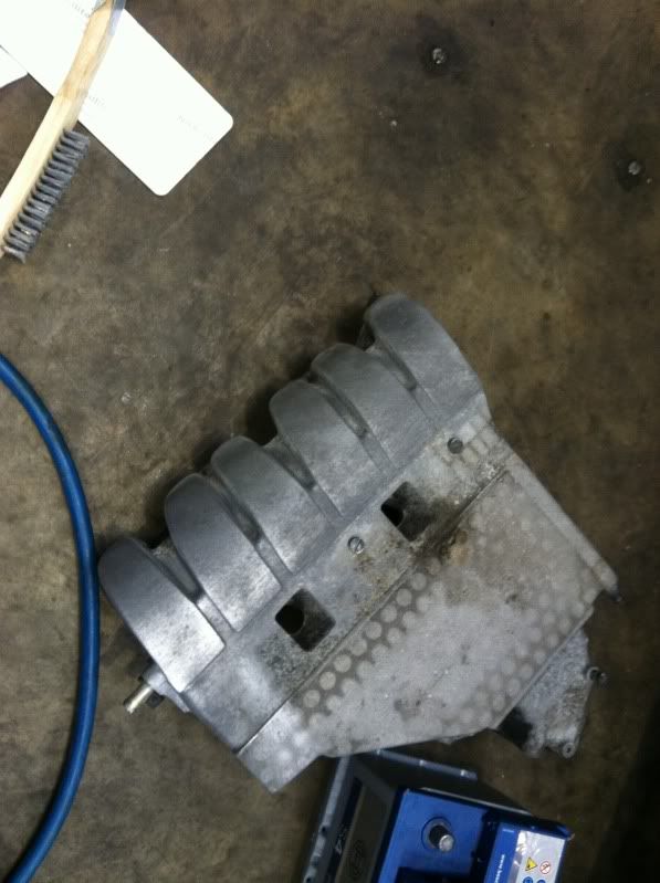

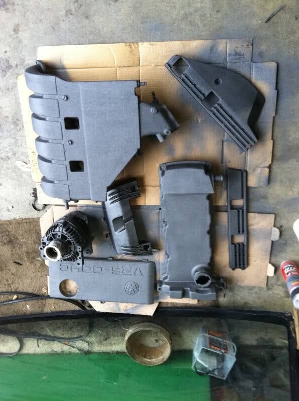

the obd2 manifold in no doubt will be manky as hell and look rubbish, i took the oppertunity to do something about it
a quick wire brush and they really come up quite nice , well respectable.
i bought some vht metallic black spray from halfords.. £5.99 and sprayed the manifold the rocker and all the plastics i also painted the engine loom plug bracket as i had a spare just so it looks cleaner it gives quite a good finish.
looks a bit neater than it did before..

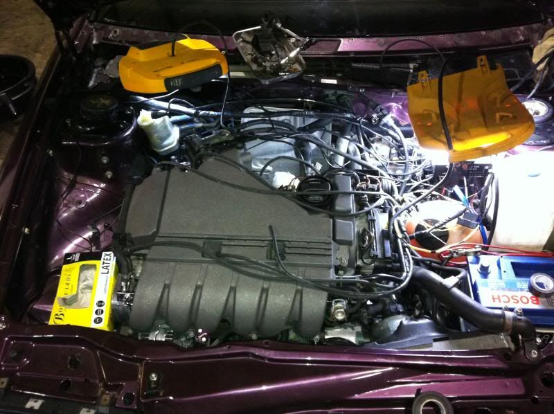

firstly remove the engine plastics
then the accelerator cable
unplug and remove the isv
unplug the connectors on the throttle body

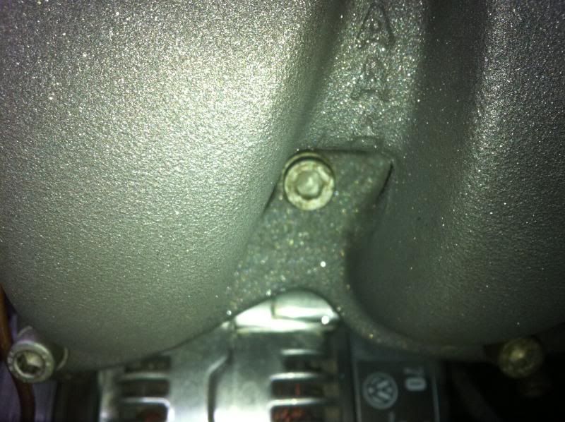

6mm allen bolt on the side of the manifold which holds the earth bracket and one again into the back of the head remove these.
6 x 6mm allen bolts that hold the front of the manifold on remove these

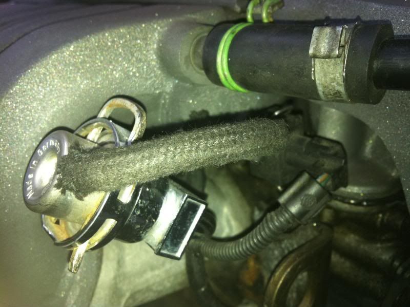

disconnect the oil breather pipe on the right hand side
disconnect the air temp sensor on the right hand side
disconnect vacum pipe on the right hand side

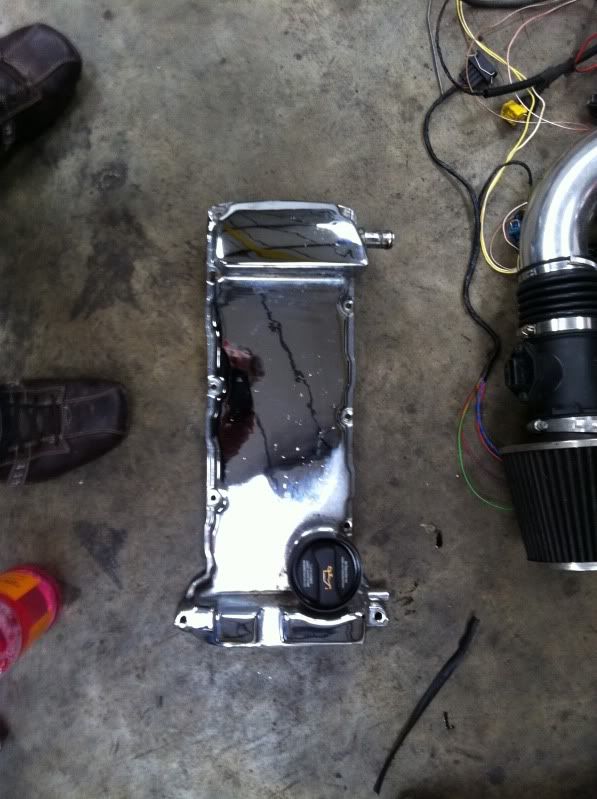

while i was at it i had an old metal rocker so i painted it to match the obd 2 one just so it look neater this job takes ?? 10-15 minuets
engine bay looked like this with rocker removed

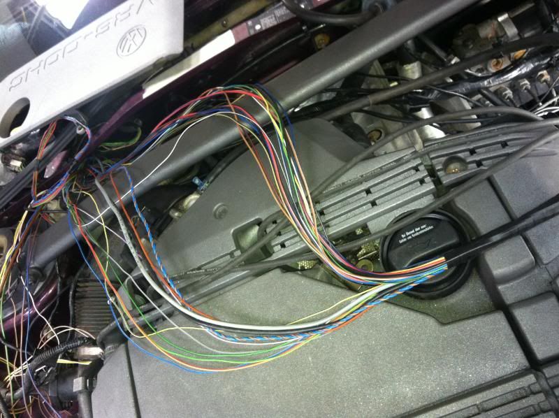

get the obd2 engine wiring harness and familiarise yourselves with it, its going to be manky and oily i removed the multi pin conector from the metal housing as i wanted to paint it and it was manky

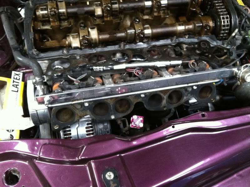

i then removed the fuel injector plugs one at a time and replaced with the obd2 plugs one at a time.
i used the vr6's fuel rail and injectors from the obd1 set up.

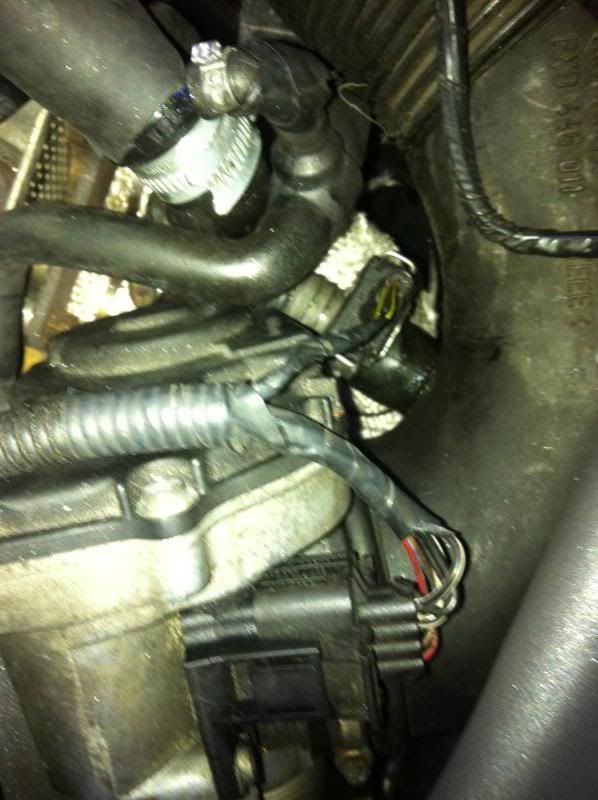

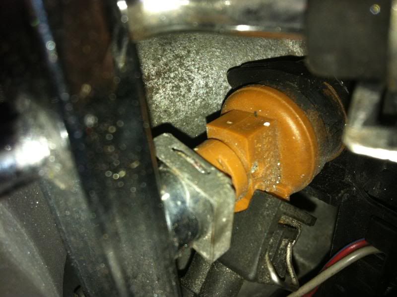

again unplug the blue and yellow temp plugs from the housing and pull the loom out from under the coil pack around the back of the head and it should all come away quite nicely.
plug in the obd2 plugs from the end of the fuel rail relocate the loom all the way around the head and place the multi pin connector back in the housing (i did this with the housing removed from car 3x 10mm bolts)

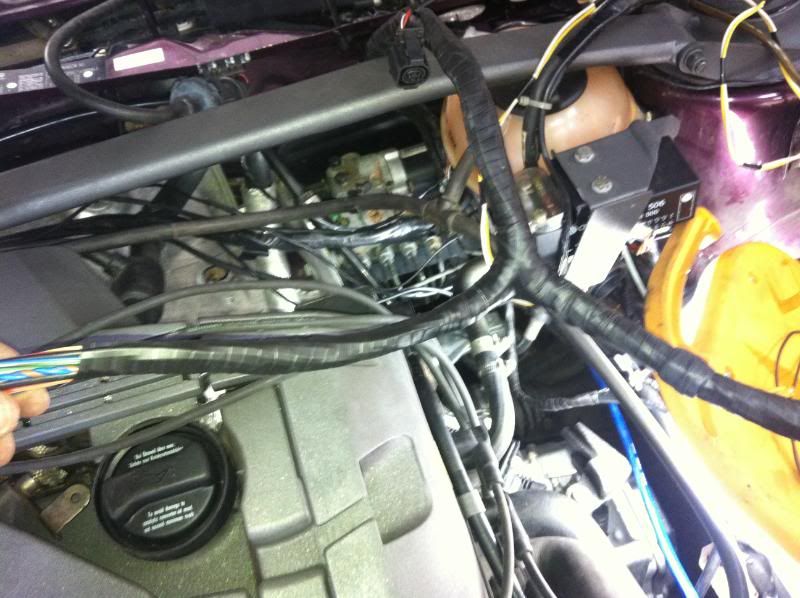

at this stage you should replace the rocker cover and refit the manifold the loom then will be easy to put back into place
connect up the obd2 throttle body and make sure all the plugs on the obd2 engine wiring loom are plugged in and everything is nice and secure.
double check you have the accelerator cable guide on the inlet manifold. you can refit the cable now if you like its an easy task.

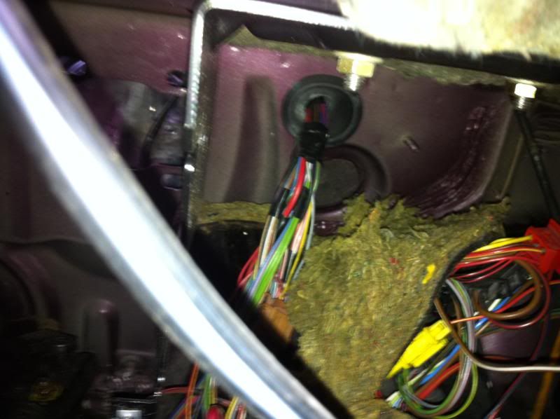

pass the obd2 plugs through the bulk headand dont worry they only plug in in certain locations due to the way the plugs are deigned!!
now the important bit

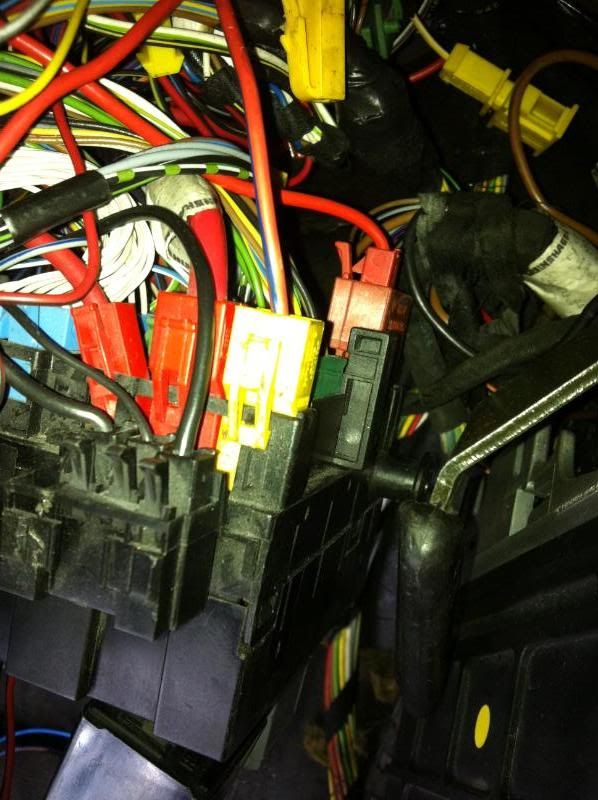

all four plugs are in the fuse box.

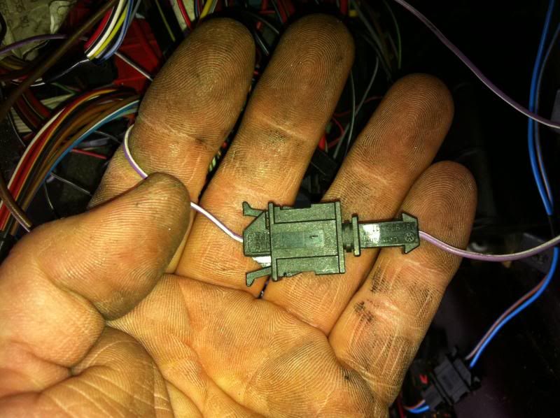

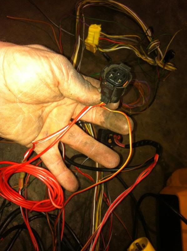

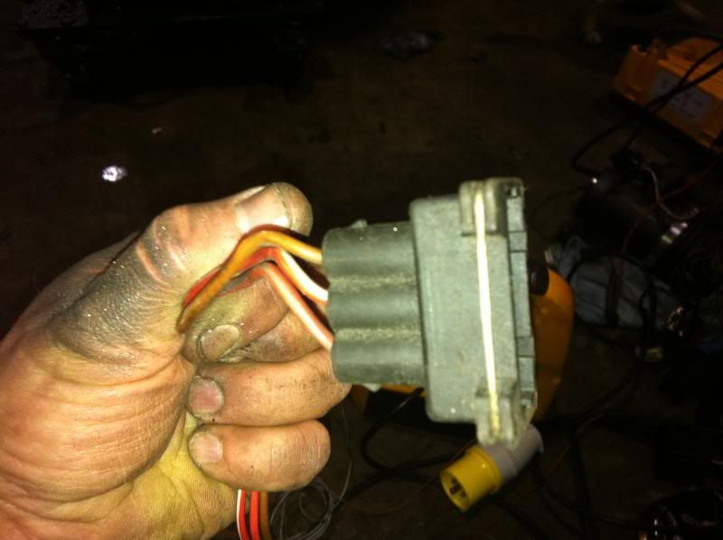

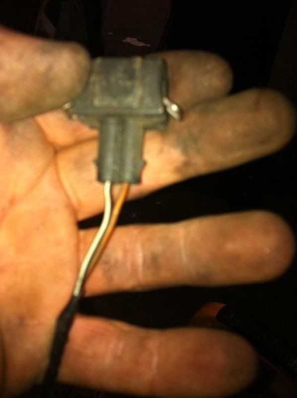

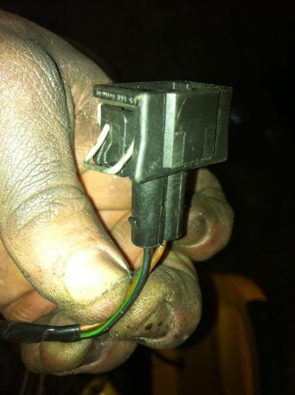

the white wire with purple tracer (this is the speed sensor wire) on the inner corrado loom needs to be connected to the golf loom (same colour wire) this bit of wire will need to be extended by about 6 inches.
i cut the plug off of the corrado loom that we took out of the car, and added it to the golf loom, this then just plugs in nicely.

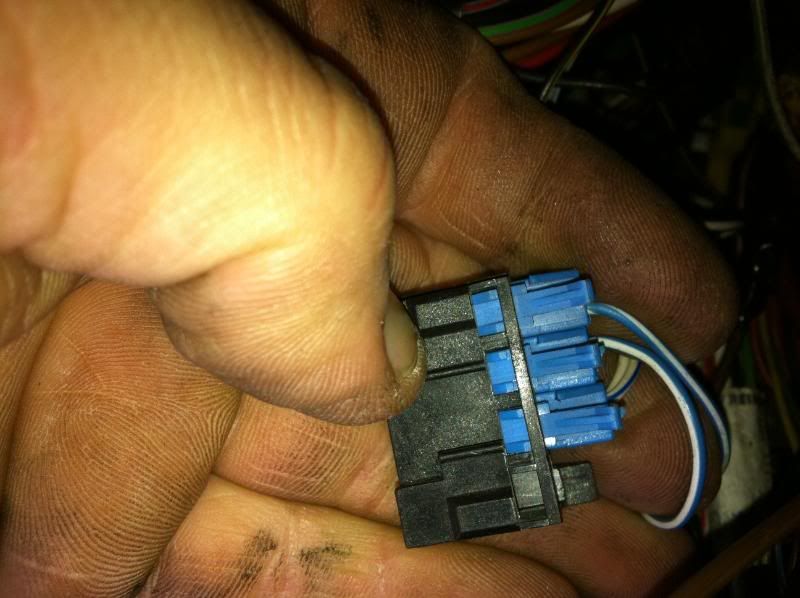

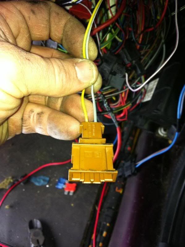

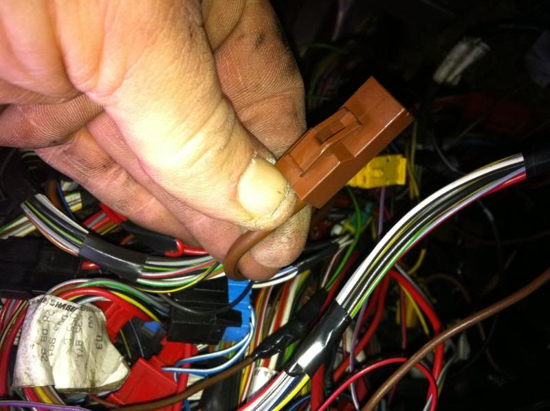

look for a twin yellow plug it will have a grey wire with a white tracer and a yellow wire, the golf loom will have a grey wire with a white tracer, this needs to be connected to the grey wire with the white tracer on the corrado loom this connects the obd diagnositcs
PLEASE NOTE IF YOU ARE CONVERTING A PREVIOUSLY AUTO CAR THE GREY WIRE WITH WHITE CHASER STARTS AT THE BLACK CONNECTION BLOCK BEHIND THE CENTRE CONSOLE WHICH IS CLIPPED TO THE METAL PLATE THAT THE CONSOLE IS SCREWED INTO. THIS WIRE WILL BE CASED IN A BLACK PLASTIC SHROWED. TRACE THE WIRE FROM HERE AROUND THE SHIFTER ACROSS THE CENTRE TUNNEL INFRONT OF THE DRIVERS SEAT , ALONG THE DRIVERS SILL AND IT WILL TERMINATE IN THE AUTO ECU MULTI PIN CONNECTOR ON THE DRIVERS SIDE WALL BEHIND THE BONNET PULL. TAKE OUT THE WIRE FORM THE MULTI PIN CONNECTOR AND CONNECT IT TO THE GREY /WHITE WIRE FROM THE OBD2 LOOM THAT STICKS THROUGH THE BULK HEAD.

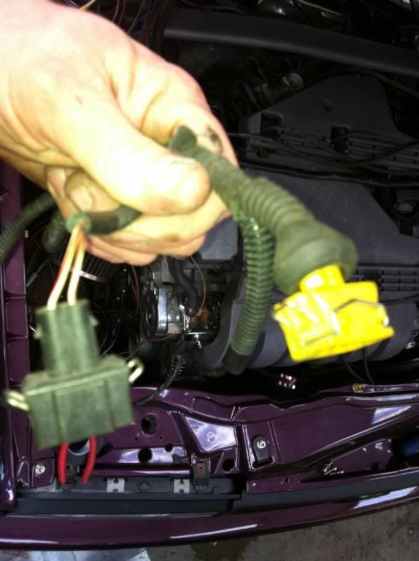

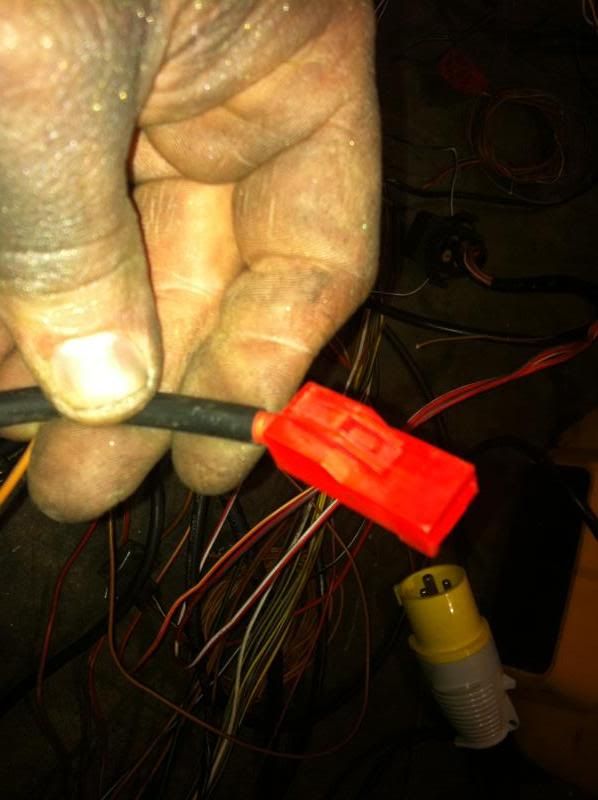

the big fat red wire with the blue tracer on it that comes through the bulk head on the obd2 loom needs to be plugged into the top right hand side of the fuse box
the blue wire with the white tracer also has a blue plug on it this needs to be plugged into the small block of four connectors attached to the front (top) of the fuse box again this wire might need to be extended
ok with everything connected in the fuse box double check and make sure you have plugged everything in on the engine side of things this is ready to fire up now , make sure nothing is dangling in the way of anything in the engine bay connect the battery back up .

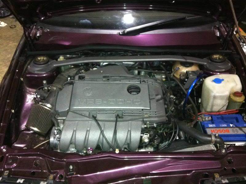

good fire it up
so its running

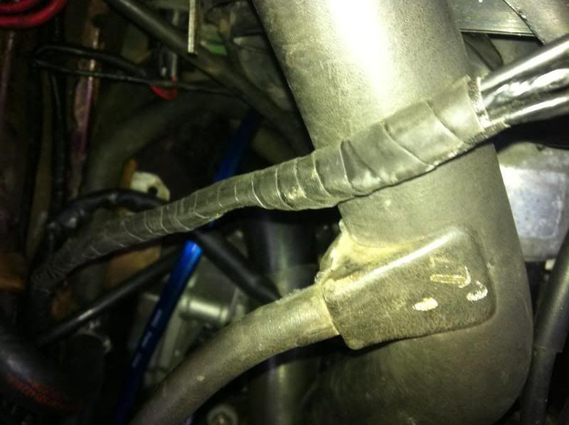

with this done you can start wrapping the loom i used self amalgamating tape 2 x rolls cost £10
i started with the plugs down by the starter motor and worked my way back to the fuse box yes the loom was still in the car as i wanted to get the loom back into the most original position i could...
top tip start at the plugs by the starter motor and work up to firt join.
then start from multi pin plug on engine loom and work back to first join then wrap the joint and continue up to the 2nd join work from th eecu plug back to 2 nd join and then wrap that join ....you get the idea .

Really liking what you've done with your SWG scuttle panel. The original gloss black finish is a right PITA to keep looking good, I'm seriously thinking of following your example.....
M.
cheers mark once you have had the swg scuttle panel painted etc it is a lot stiffer than it was before fitting it is a little harder not much i guess just being cautious as didnt want to mark it but feels quite stiff...
