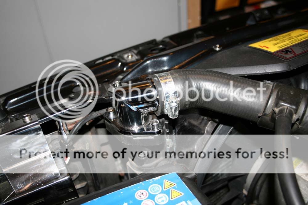

Redfox 10 Posted November 3, 2011 I for sure would also like to buy one of those well made radiator necks, if you chose to make up some for sale. Great work anyway ;) Just an idea: how about making up a small stop for the hose as per original? Cheers, Redfox. Quote Share this post Link to post Share on other sites

daves16v 1 Posted November 4, 2011 Gaz, the corner shouldn't cause a problem and yes the internal and external sizes are identical. Yeah seals are available from VAG. Jim, I guess it depends on demand and price. I've got some testing to do first and already I'm wanting to make a slight change. I can't see them being available before Xmas. Redfox, just for you................ Quote Share this post Link to post Share on other sites
Jim 2 Posted November 4, 2011 Ok Dave.. keep us posted! I may have to end up getting a plastic one soonish by the looks of things :( Quote Share this post Link to post Share on other sites

Redfox 10 Posted November 4, 2011 Hi Dave, Perfect. This way it supports the hose perfect ;) I am in for one if so happens, no doubt. Time is not an object. No need to hurry. Cheers, Redfox. ---------- Post added at 06:16 PM ---------- Previous post was at 06:12 PM ---------- Dragon Green, That may help you on the short term, but they are known to degrade anyway, so a stainless Dave-model would do you good in the long run ;) This is not meant to put Dave under any presure ;) No, not at all ;) No hidden agendas or anything ;) Cheers, Redfox. Quote Share this post Link to post Share on other sites

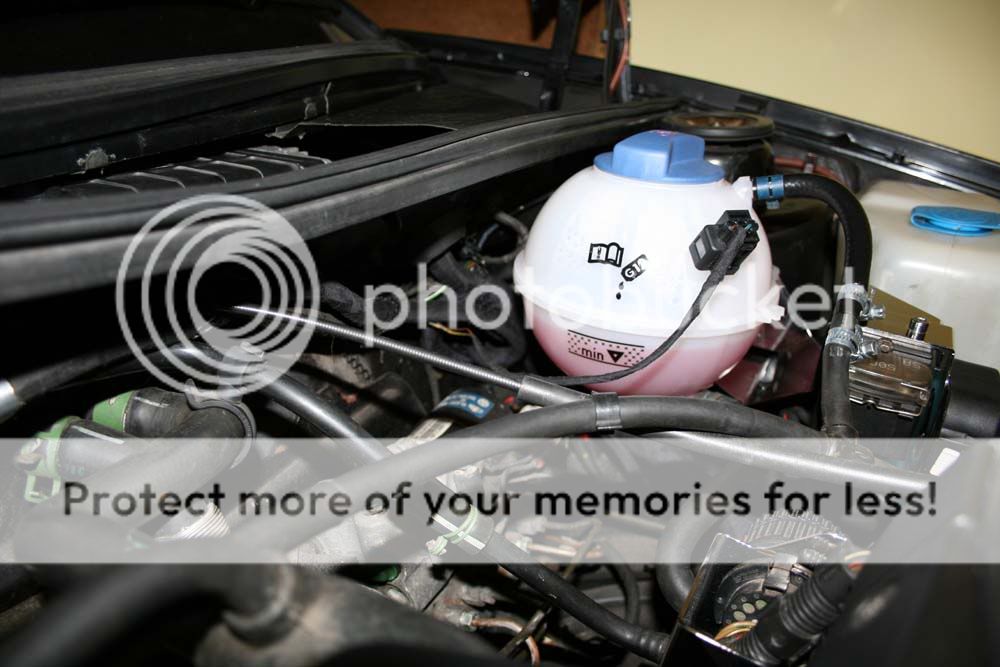

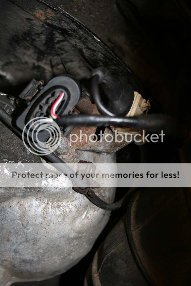

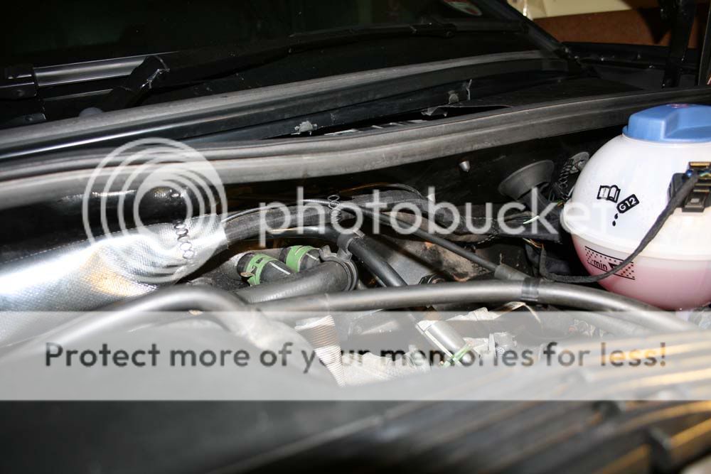

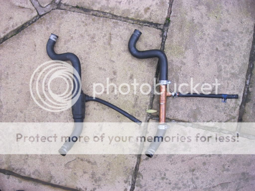

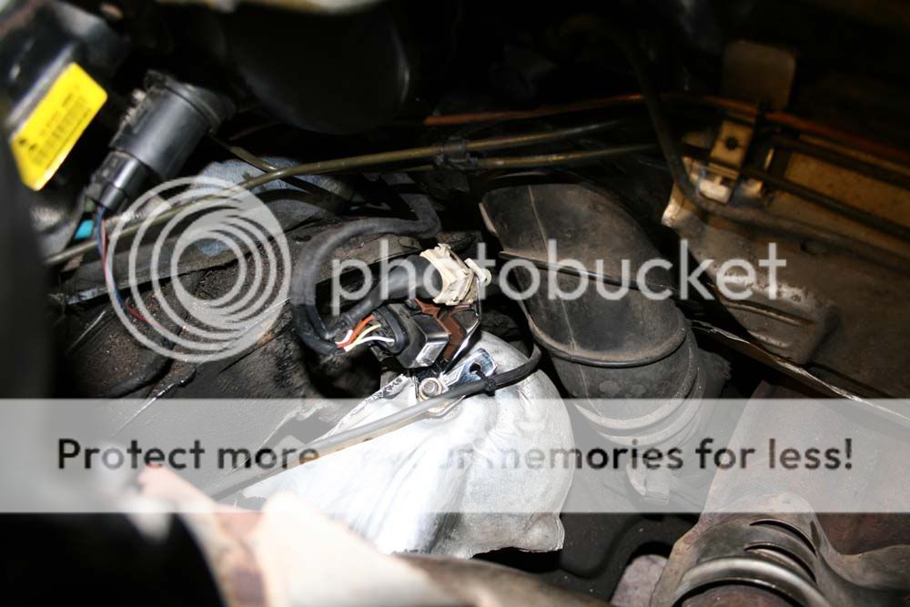

daves16v 1 Posted November 15, 2011 Well there isn't a lot to see under the bonnet regarding the OBD2 conversion. I did run out of harness tape so there is some wiring to tidy. The Golf loom is indeed longer than the Corrado loom so I've looped it, you can just see it behind the expansion tank. New stud mounted cable ties. One problem that I've got and suspect others will come across it or already have is that the Lambda plug that is mounted in the bracket has a bigger body so interferes with the other plug. The slot in the bracket is the correct size but is just too close to the other plug. I've had to cable tie it to the bracket so I'm going to make a new bracket that will accommodate both comfortably. The new rad elbow is on, is a perfect fit and doesn't leak. One other thing that I've been meaning to do is swap a coolant pipe, I'll let the photo tell the story lol................yes it's copper pipe which was painted Black on top, you're looking at the underside. Quote Share this post Link to post Share on other sites
daves16v 1 Posted November 16, 2011 New lambda bracket done. Quote Share this post Link to post Share on other sites
VR6Pete 0 Posted November 17, 2011 looks good mate, would be willing to pay for a new bracket if you fancied making one up for me? :-) I've currently done what you did prior to making your bracket and cable tid it up... Cheers Pete Quote Share this post Link to post Share on other sites
