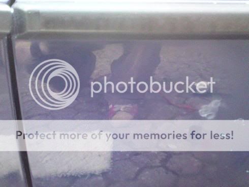

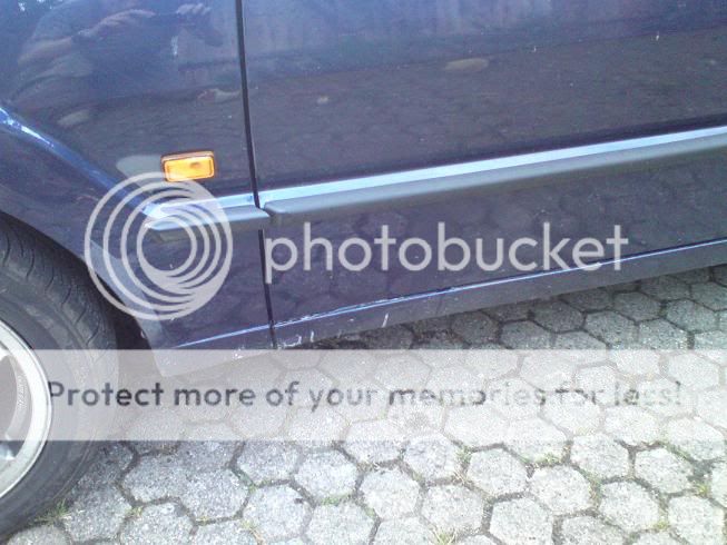

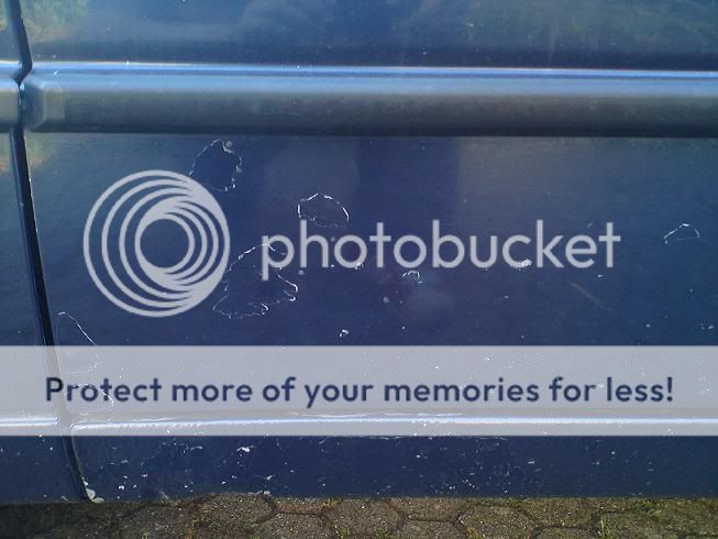

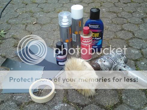

Basically on the legside door I had some laquer peeling off. It has had a respray at some point in its past, and my guess is they didn't do a great job on the prep. :nono: Anyway i thought I'd give it a go myself, try and get it half decent in the interim and figured if I cock it up it has to go the body shop anyway, so I've not really lost!Thought I'd document progress with a few pics!
Bad bits.
The tools. 400, 600, 2000 wet and dry and some ancient Woolworths rubbing compound! :lol:

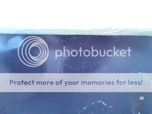

Start rubbing down the old stuff with the wet and dry
Spray a thin coat of laquer to try and give the paint a bit more protection from the sanding

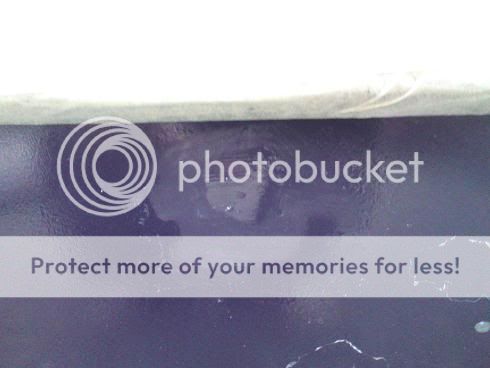

More rubbing. Then after some more new laquer and rubbing:
Done! Skipped a few steps there, obviously. Gave it a good buff up with the buffer and the finish has come up better than the rest of the car! It's by no means perfect, am unsure whether to spend more time on it getting it absolutely flat, if you get close you can see slight ripples were the patches were, or to just leave it in case it turns into a forever job :nuts:

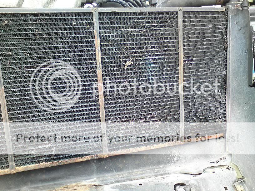

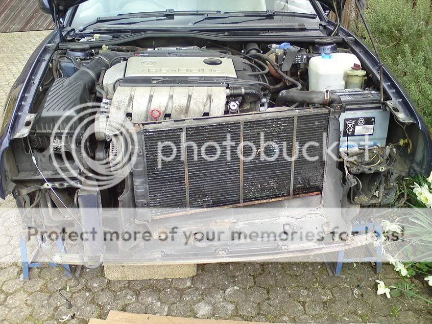

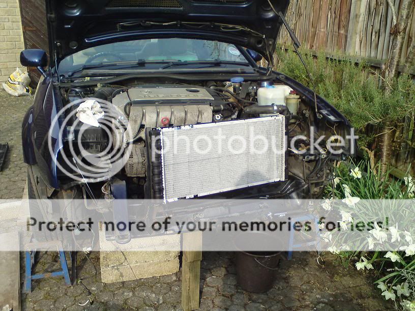

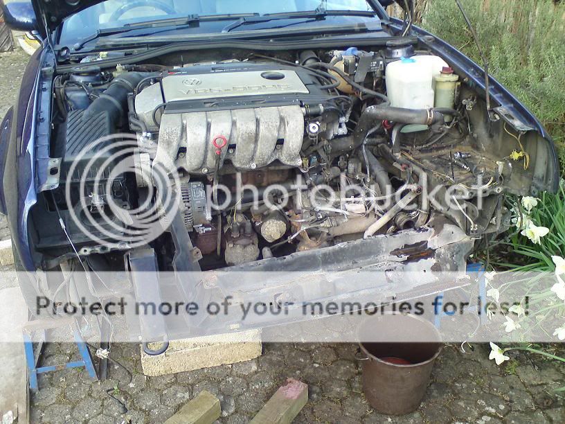

Next job, was a radiator replacment which was still leaking coolant at a fair rate, which the fans were then handily distributing around the engine bay. I decided on a GSF one, I know they've got a bad rep on here, but the OEM from VW was just too expensive for me at the moment. I can always upgrade it further down the line I figure. A job which I thought would take a couple of afternoons ended up taking the best part of a week, mostly because everything was a battle! Any fixing that needed removing was inevitably seized ... took several hours just to get the plastic splash time under the bumper off! Anyway, got there in the end, and replaced all fixings with new stainless ones awith lots of greese applied. Also reqrapped some wiring which was looking a bit worse for wear. Pictures:
Front end off, can see where the radiator was leaking bottom right corner... completely rusted away.
Looked even worse in real life, picture doesn't do it justice. In a generally terrible state; a lot of the veins were smashed and just crumbled away when moved, depositing themselves all over the place, rusted all over, and with a large moth embedded in the middle!
Old rad off, and generally things are in a pretty decent shape. Spots of rust on the cross members, but nothing major, all the piping in goo dnick and the wiring just needed rewrapping which I did. Got a lot of dirt out from under the battery as well and then applied a liberal helping of waxoyl to everything!
Lovely shiny new rad! For comparison. Think the old one may also have been from GSF, as looked very similar. Only issue was the 6 metal tags which I can only assume fit some other vehicle rad assembly as they need to be bent completely back to fit the fan hosing on. Best to be done before you have the rad in place!
New rad in. Looks much better. Topped the coolant up from the top of the radiator. Then everything went back together reasonably straight forwardly, with just a moderatel amount of things sent to try your patience!

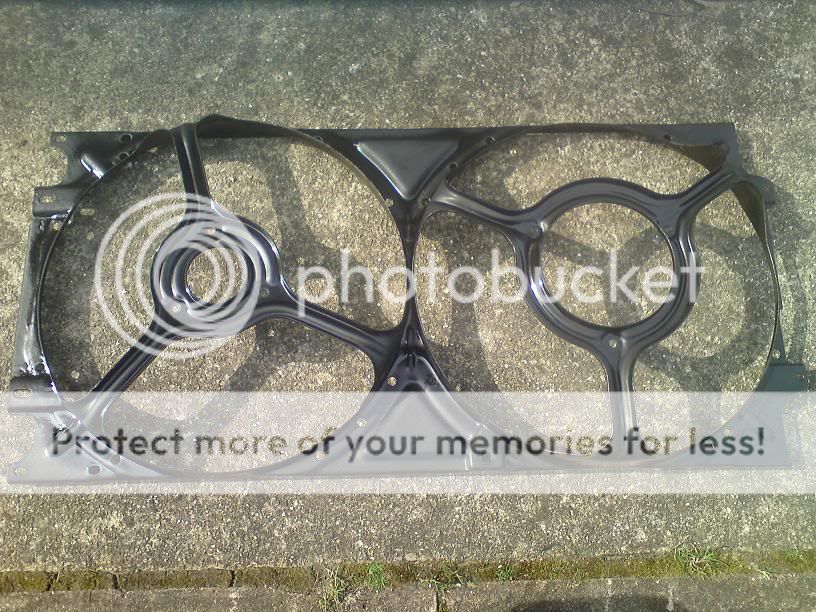

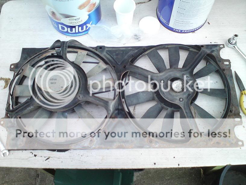

i also took the time to smarten up the fan cage which was a mass of rust again. Couldn't get it all off, some lumps were so hard and solid, all the grinder was doing was polising them and chipping away at them with a hammer and chisel was frustrating!
Couple of coats of thick hammerite primer, and some hammerite spray later:

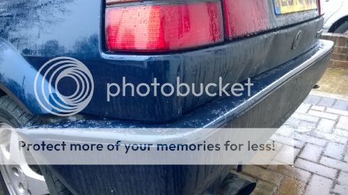

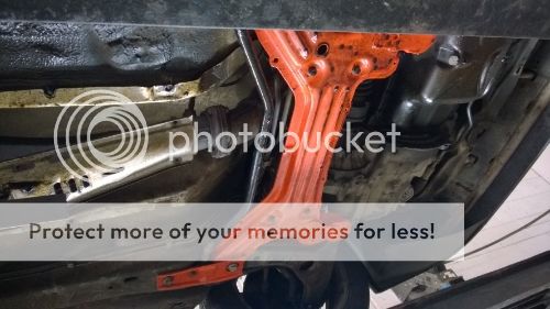

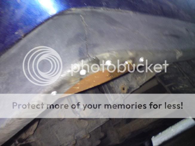

Thought the post was getting a bit long, so split it in two! The other job I had to unfortunatley do was repair the splitter which had been... split. I suspect it was done when in the garage having the head gasket replaced, and they somehow managed to do this: :(
That's from the inside, it's the passenger side corner. I had straightened it out in this picture. Whatever happened it had hit something fairly hard. The plastic was overlapping itself, and you can see the screw holding the splash trim has been ripped out of the plastic. Additionally the steel reinforcing bar that runs along the top edge was bent out of shape, I managed to roughly bend it back into shape so it still fits, and the grill trim in the bumper had been forced out.
The reason I suspect it happened at the garage is I sure as hell haven't hit anything! Unfortunately I don't have any pictures from immediately before I took it in of that side of the car to prove it. The only other incident I can think of is back when we had the heavy snow before christmas; a sharp right hander at the bottom of a hill, covered in snow meant I ended up going over the verge. However i checked ater for damage, when I reached my destination and beefore I left again, so I am certain I woul dhave noticed had it happened then. I also only noticed shortly after it had been into the garage. So that's frustrating, especially as VW say they are now obsolete. Managed to bodge a fix with some glassfibre and epoxy resin along the back, and then riveted a bit of Aluminium at the bottom:

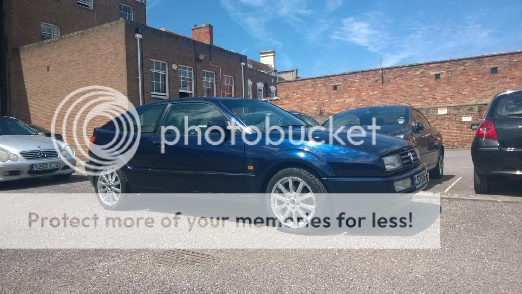

Probably about time I updated this a bit. Mostly not a lot has happened for a couple of years apart from general maintenence. Nothing very exciting but all essential stuff like brake lines and the torsion bar links after one of them sheared off and made a mess of the CV boot, I also replaced both water pumps. That is until this happened on valentine's day:
Courtesy of a nice (!) man in a Range Rover who wasn't paying attention at the lights. Not sure if the photo does justice to the damage, but the seams were torn, the boot wouldn't close and that whole rear was pushed in. So I was expecting the worst, and the initial assessmment from the bodyshop did nothing to help matters as they reckoned a new backend was needed and that I'd need to source one. I was thinking this could be game over, but I quickly managed to source one from an old G60, plus bumper. Unfortunately it was in pretty ropey condition and not really useable. Fortunately Range Rover man's insurance assessor decided he liked the car, that it was fixable and went and had a word with the bodyshop who were able to fix it. Some 3 months after the initial prang I got the car back and the body shop have done a great job on it. They managed to repair it, so it is still original, it is absolutely straight and the boot closes with a nice satisfying clunk. They've also matched the paint in perfectly. I am more than happy to recommend Bodytek in Taunton if anyone is around there. Only downside is I've lost my paintcode sticker inside the boot!
The car then promptly failed it's MOT, to add to an already poor year. Exhaust and wishbone bushes needed doing. Both jobs I knew about really, the exhaust was in an awful state and was just rotting away, so much so that the top of the box kept banging on the underside of the car which was very unpleasent and it just sounded bad. The worn bushes were also the cause of the steering issue that had just cropped up, so at least I had found the cause of that.

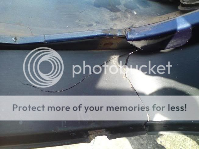

What should have been a fairly straightforward repair suddenly turned into another disaster when one of the captive bolts inside the sub-frame sheared off and the garage couldn't find a replacement. Again thought I was staring down the barrel but had a massive slice of luck as Vag-Hag from here saved the day and so the underside of my rado now looks very orange!

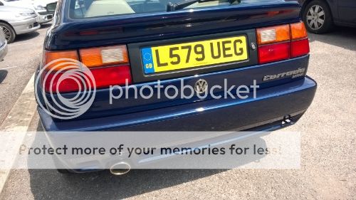

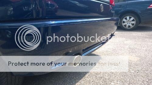

On to the exhaust. I decided I'd bite the bullet and go stainless as I'd always wanted to do that, and now seemed the opportune moment. No point getting another steel effort and never getting around to the stainless I wanted. Due to the MOT time pressure and plenty of internet recommendations I dropped it off at Infinity Exhausts in Bristol. Again, really pleased with the results. The tailpipe is exactly what I had always had in mind and they got the angle and position absolutely spot on. Really looks proper, very smart not too flashy or ridiculously big and keeps that OEM+ look. Had a shifty under the car and the work looks pretty good as far as I can see, and the engine immediately felt a bit freer. Noise is pretty good as well, setled down now so it's not particularly boomy and there's a few naughty burbles and pops on the overrun. It is interesting how the exhaust note changes... It gets louder until about 3000rpm when it really quietens off, briefly is almost whisper quiet and then the VR6 roar takes over.
Anyway pics:
Very happy with the car now, managed to iradicate most of the horrible bits in one fell swoop, including fixing a long running oil leak eventually traced to the sensors on top of the filter. Good timing really as I think I was starting to get a bit down about the car as each new problem appeared and I didn't seem to have the wherewithall to deal with them. But the MOT rather forced the issue, so I am going to put some effort into correcting the remaining bits. First up new wheels on the way!

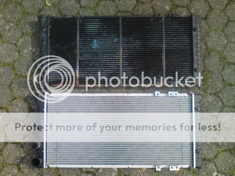

So the decision to buy the cheap GSF radiator back up there some 6 years ago finally came home to roost. Car had been running hot recently culminating in the top hose pulled the screw fixings out the rad. Cue my first ever trip home on a flatbed.
Did it properly this time and bought a Hella rad. Here's why you shouldn't buy cheap:
y4m8tzUvTgdCjAU3JjjR3kT49rD6G2sHS-OTKxHRb-ozOg8aghi8CGSdeHkqRVR02EEt3AHhfCCmLVgB6A0L-03cu8XwSKNvNqLJsZGFn6no6bLAUhoCqerw7HEksVQHNdzb4gByj1kYG4upPcIYaUaQgvX35gPCLZe2W_EsAlutQ_R7YzDnIurAncpQ7zIP9QnDlY9Ie6LfvRE1zjdeiUytA?width=371&height=660&cropmode=none
New Hella on the left is significantly wider for a start, at least 10mm. can also see where the fixings pulled out of their housing on the old one.
y4mvJUHrRNJtv5Q1gvcrzIHRg2YYCR0uTmNSqJcdQzO_CnrH4SA6kcoPeTN9U2bjPzuOQca534UdWvTExVCUJ43oOMcR58BQA_FUcWMiZQBbMDrN6zGGVhFtz9rD7uliSUpGzTcsNqhShU33y8XnGdegChdo3x17GJgnMcIAnRJr6OTJR6TOLN_nh3lXYoSlDjNUW-eae1s_LxNzPDzgUYnnA?width=660&height=371&cropmode=none
Also has much better vane design, much finer with two cross tubes... the GSF looks an old design in comparison. The Hella is just all around better in quality. Internally the GSF had a lot of plstic flashing poking out, but the Hella was completely smooth. Additionally the top elbow was a really bad seal on the GSF. Basically it didn't, and had to seal it with a load of gunk. Hella fitted perfectly. Car now runs a lot cooler as well, stays down at 90 in traffic whereas before it was nudging 110. Really do buy a good rad is my advice here!
May do a coolant flush as well as there seemed quite a lot of deposits in the coolant which may have gunged up the rad a bit. Not sure where that has come from as always just use G13. On the plus side my Hammerite job on the fan cage is holding up remarkably well!

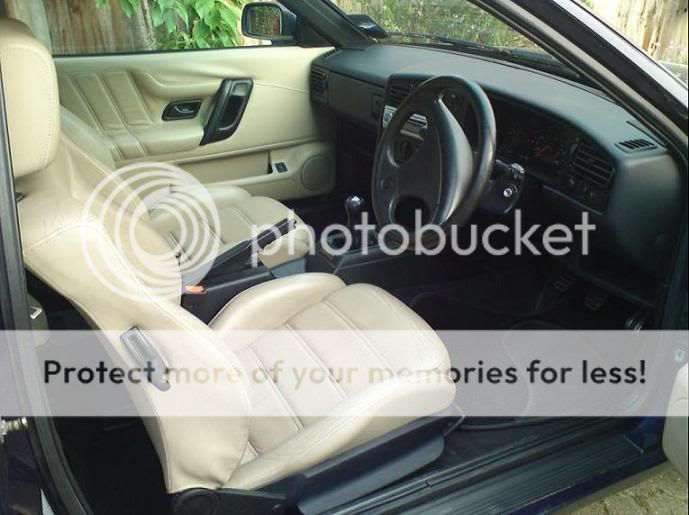

Just updating a bit. Sorted out the leather last summer:
y4moNyISODKIrOww5MSlJ7jIE4qaFwdbYZUN7ogOwzZvNmxjosScNs5SC3DpLY_DUbK4dyjlrcTtozrFjthA6mgNBb6I3Yzft3wu-JWrlLqBRgjd-dreJY-y8QWeP3KLXOP5VE0HJmwSuIMk_yO2jxwT7uK3_9MiAt5ptQihOLoU8QI3TXRApI3n0-GjfYI1Mf-yjM842taltQgiY87pY-rCA?width=372&height=660&cropmode=noney4mf8tpZhrh9eODa8xXCz67QZP7nyQhn4dsjdI1JLbKqhknYRW5TtRu5udPg73TFmvqDZ0xcW-A90QY4F9XHAii054N4IwNtCLDoiNIRotzgb0qSxwqL0TFAXH5N4mcCwFc7T6NU-Pu6_wgskbNR88BVAR27fi4Cri6LjtTm_kLk_db0F9cY_Lv9mHc-O7CftzwkfBNSWdkKuA1Ljo3gvKq2A?width=371&height=660&cropmode=none
Was horrible worn and scuffed, not to mention dirty. Was really letting the care down. Got to work on it with the liquid leather cleaners and dye. Worked brilliantly, happily recommend that stuff:
