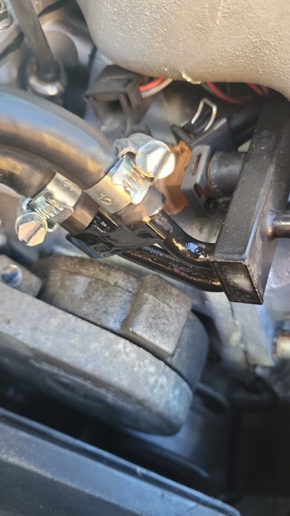

_Matt_ 32 Posted May 7, 2024 oh no! Are you sure it isn't from the fuel pipe into the fuel rail? They can harden over time and leak. Mine were replaced because of this also. The fuel is at high pressure so it is feasible for it to spray everywhere. Each injector is locked into place with a little clip, perhaps one of those has worked its way loose as another place to look. Quote Share this post Link to post Share on other sites
oneohtwo 8 Posted May 7, 2024 Yeah, fairly sure. The pipes were new braided ones from Hel and didn't see any traces of fuel around them. Good shout on the clips, I'll have another poke around and see if I can see anything, but I think I am just going to get it towed to a garage. Don't really feel like I have the time and energy trying to fix this one... and it's not ideal with it parked on the road! Quote Share this post Link to post Share on other sites
oneohtwo 8 Posted May 9, 2024 Well this is very odd. Couldn't really see any obvious issues, and when the tow truck arrived to pick the car up it started and ran perfectly. No misfire or lumpyness, and more importantly no fuel spraying out! I've had it taken to the garage anyway to get checked out, and speaking to the mechanic apparently that does happen with fuel leaks. So we shall see. Quote Share this post Link to post Share on other sites
_Matt_ 32 Posted May 9, 2024 That is odd! Perhaps it is an O-Ring like you thought that had dried out but now moistened up with fuel. I am only guessing though! Good Luck with the resolution. Quote Share this post Link to post Share on other sites
oneohtwo 8 Posted May 10, 2024 Yeah, it's what the garage thinks as well. They're not getting any leaks either. He's going to leave it over the weekend and see on Monday, but looks like it might just have resolved itself. Quote Share this post Link to post Share on other sites
oneohtwo 8 Posted May 23, 2024 Garage couldn't find anything in the end, so this one goes down as a mystery. Runs all OK again. Quote Share this post Link to post Share on other sites
oneohtwo 8 Posted May 28, 2024 Nope, this wasn't finished! Started the car at the weekend and thought I'd double check for a fuel leak myself and sure enough it was leaking from the fuel line at the rail connection. With the engine off the leak stopped until I wiggled the pipe and then it'd spray out again. Not entirely sure why this would have happened now, the fuel pipes are only a couple of years old and decent quality Hel items, and the clips used are the ones that came with the pipes. Anyway, I adjusted the clip and retightened, so that is that one solved. Quote Share this post Link to post Share on other sites

_Matt_ 32 Posted August 5, 2024 Re the fuel leak - is it engine bay or at the rear? I'd be tempted to replace the fuel lines just incase they have perished. Even newer fuel line that is supposed to be compatible with newer fuel can perish quickly. I bought some Mocol fuel line assuming it was a good brand / not a "chinese knock off". All good so far. https://mattlewisracing.co.uk/products/mocal-6mm-r9-rubber-high-pressure-e10-petrol-diesel-ethanol-hose?srsltid=AfmBOoqR_xM2dnIdj8QxceVU-NYlxEbDApslCHtix1P9VJYGKZ1y7nl7 Slow starting I have only experienced when warm and that was the FPR for me but start with Dox's suggestion on monitoring temps when starting as first port of call. FPR if you need it: https://www.ebay.co.uk/itm/332308717053 Quote Share this post Link to post Share on other sites
oneohtwo 8 Posted August 7, 2024 I'm slightly unsure where it's coming from, I've run the engine again and can't trace it. It's definitely towards the front of the car and I think it is the fuel lines under the car. There seemed a bit of fuel residue on the chassis near where the fuel lines run into the chassis before the engine bay, so will investigate a bit more around there. Not sure if there is a join there, but those lines are a lot older. The new fuel lines all look dry now. What's the connection with monitoring the temps when starting? Quote Share this post Link to post Share on other sites
_Matt_ 32 Posted August 8, 2024 The engine bay rubber fuel lines connect to the hard line fuel lines that run through the chassis below the brake booster cylinder. Perhaps there is a problem there and fuel is making it's exist via the chassis rail holes the hard lines run through. It is unlikely the hard lines themselves have failed. Re the Coolant temps - if the reading is way off the car won't fuel right for a cold start (i.e. it may think the engine is warm) so is more difficult to start when cold. Quote Share this post Link to post Share on other sites
oneohtwo 8 Posted August 8, 2024 Ah, gotcha. That makes sense. So there's no joint in the hard line by the chassis rail? I guess, as you say then, it can only be from the where the rubber hoses connect. Will have another look around there. I suppose the slow start from cold could also be due to a leak especially if it's small. The pressure in the hose will drop over time, and air will get in. Then the pump has to overcome the pressure difference and force the air out before fuel starts getting to the injectors. Once it's running it can probably maintain it a bit. Pump might actually be fine. I'll tighten up all the hoses again and see if that makes a difference. Quote Share this post Link to post Share on other sites

_Matt_ 32 Posted September 14, 2024 I too have just had a fuel leak, haven't turned the car on since a couple of weeks before my hols, so now sat for 6 weeks. I went around the village and could smell fuel. I realise the the clips for the fuel hose aren't the oem ones that move with heat cycles so will change those as first port of call. Those lines are new in the last year. Quote Share this post Link to post Share on other sites
blue95 0 Posted September 15, 2024 (edited) jubilee style clips don't supply a consistent tension, can distort if over-tightened and damage the hose. Use OEM style clamps or proper injection hose clamps Edited September 15, 2024 by blue95 Quote Share this post Link to post Share on other sites
Wild-Animal 0 Posted September 16, 2024 yep, as CF Nutter says - You need to use 360 degree fuel clamp. Jubiless are not allowed in motorsport for fuel systems, It will be the same for automotive. Quote Share this post Link to post Share on other sites
_Matt_ 32 Posted September 17, 2024 Oui, I have made the changes now. I knew they were wrong but left them, I was just sharing for oneohtwo as he had a leak after not using for while and wanted to highlight what can happen if you leave it a while with that type of clamp. Quote Share this post Link to post Share on other sites
oneohtwo 8 Posted September 22, 2024 Ah thanks. I used the clamps that came with the HEL fuel lines they sent so assumed they were suitable, but having checked again they are just worm drive type clamps with an aluminium capping piece. I did notice that when I found the leak and retightened they did seem a bit loose. I will swap them out. The only nice thing is they finish off the braided hose quite nicely and stop any fraying. Quote Share this post Link to post Share on other sites
blue95 0 Posted September 26, 2024 On 9/22/2024 at 7:37 PM, oneohtwo said: Ah thanks. I used the clamps that came with the HEL fuel lines they sent so assumed they were suitable, but having checked again they are just worm drive type clamps with an aluminium capping piece. I did notice that when I found the leak and retightened they did seem a bit loose. I will swap them out. The only nice thing is they finish off the braided hose quite nicely and stop any fraying. I would have assumed the same as well tbh...maybe you can you use a band of heatshrink tubing. Quote Share this post Link to post Share on other sites
oneohtwo 8 Posted October 10, 2024 Interestingly I spoke to HEL and they reckoned they were suitable for fuel lines and are the standard ones they use and send out, and are the only connectors they use (other than for hard lines etc). Quote Share this post Link to post Share on other sites
