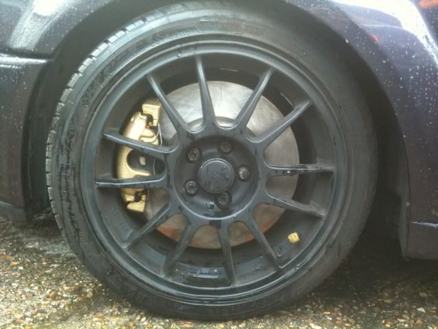

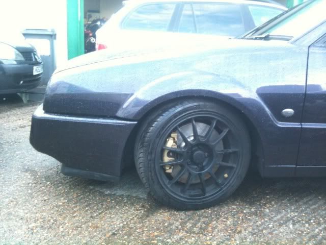

Small update, been collecting parts for a while to finish off the charger install. Had my 312s and mk4 rears in the boot and decided to get them installed in prep for getting the car mapped
Had some trouble bleeding the brakes as has been discussed before. There is a lot more pedal travel than before but once they bite the braking force is immense :) they are certainly an improvement and don't fade after a second or two like the 280s, they just bite harder and throw you forward in your seat.
Painted them smooth gold to match the charger bracket and intake pipe :)
Standard 280s
Audi TT 312s
Edited by Craig
Bought the tt calipers off of a chap on here and were already painted red and in good nick so Repainted them, bought one piece machined stainless steel 6mm washers off eBay with some high tensile longer bolts and new discs and pads. :)

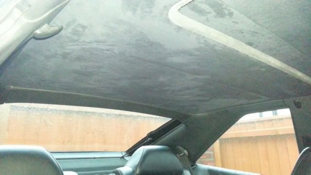

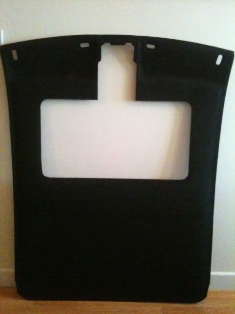

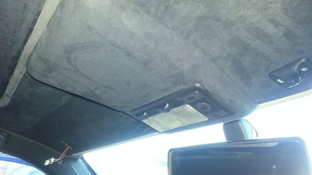

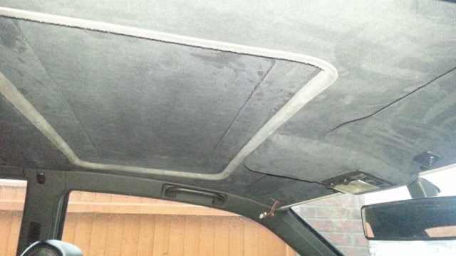

So while waiting to get the car mapped at stealth I've been missing driving it so treated the inside to some tic and retrimmed the headlining and sun visors etc.
I really wanted some nice alcantara but its not cheap and As it was my first attempt at trimming I opted for some nice plush black cloth at about £40 for a 2x1m strip, just in case things didn't go to plan.
Theres a few tiny niggles but overall I'm chuffed with the results. Cost about £55 in total what with spray glue and evostick glue.
The interior has been totally transformed and I'd recommend everyone should give it a go!

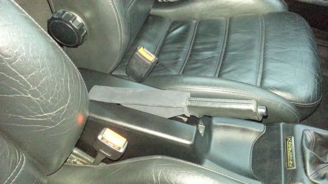

My handbrake cover was from another car and has never been quite as black as the surrounding trim so thought Id cover this too. Looks much better in the flesh than in the pictures. :)
I also decided to strip the plastic off of the sun visors and retrim these rather than spray them. I'm just waiting for the paint to dry on the grey plastic then I'll pop them in too.
Great results mate, well done!
She's really coming along now and how is she running?

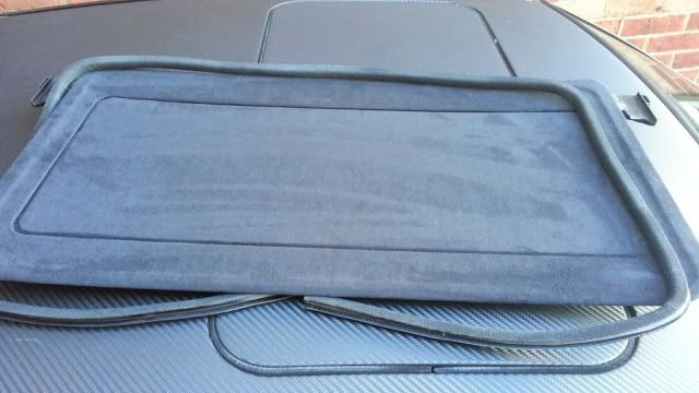

Can you try and find a black sunroof rubber that will fit?

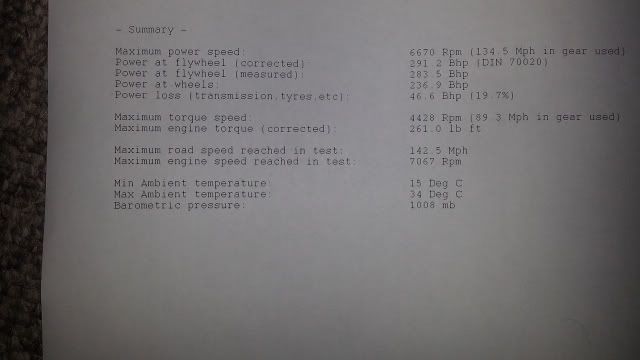

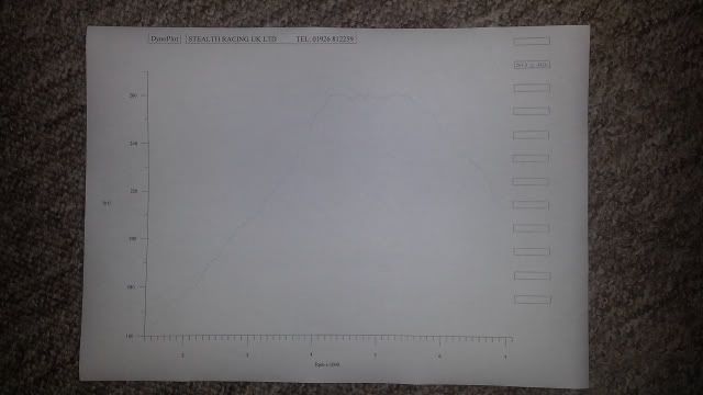

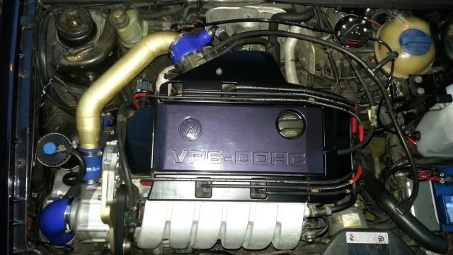

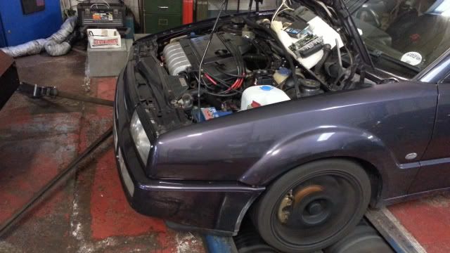

So managed managed to get everything ready, injectors fitted, progressive meth kit installed and relocated the filter and maf to the passengers gets wing. Limped up to stealth and finally allowed vince to work his magic.

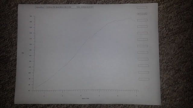

Vince installed a new high flow fuel pump, map and unfortunately I needed a new lambda sensor as mine was non responsive. Luckily one was delivered and the end result
291bhp & 261lbs ft.
Vince has done wonders with the car and there have been a few moments I considered giving up but I'm pleased with the results.
Would just like to say a massive thanks to vince for his hard work, genuinely top bloke.
On the drive back to bournemouth I took it steady as it was wet but when I did open her up 3rd and 4th are relentless all the way to the redline. Needless to say I won't be driving it that far up the rev band all the time but it's nice to know the power doesn't suddenly drop off.
The water temp stayed constant and the oil ranged from 98c to 104c when pushed.
Vince mapped the meth kit to begin injecting at 5 psi so it's not on all the time driving slow around town but there when it's needed. He did say he was surprised how well the kit worked compared to some others available so thumbs up for the devils own progressive methanol injection kit.
Next on the cards will be just enjoying the drive, then future plans of wheels, rear bumper respray and the we shall see how the engine is coping ;)

Glad to hear you got this up and running, so what did you end up doing as a MAF solution?
And do you know what boost your hitting?
Cheers John, Vince mapped it with the Maf. Me and my mechanic relocated the maf to the passengers side behind the bumper. One reason was i didnt like the filter being so low to the floor when it was just under the carbon canister hole, risking hydrolocking the engine. The other was that at low rpm/idle the turbulence from the charger can cause the maf to hunt being so close to the charger inlet so having the maf as far away as possible alows the air to settle down before it hits the maf.
Result is a super smooth idle and even though the filter is stilll quite low, i would need to go through a substantial puddle/volume of water to suck any up. There was such a limitation of space though behind the bumper we really struggled t get the large air filter and maf in a secure location.
One bonus of going turbo is you can keep the air box/filter in the same location :)
I Think the boost was close to 10psi, i never actually asked vince what max boost we were hitting.

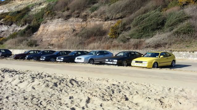

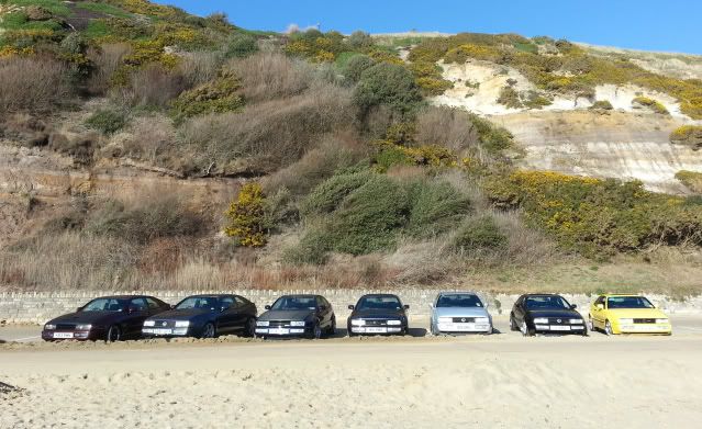

Also had a mini meet with the southern corrado club on Facebook, sunny weather made for some nice pics down the beach :)
And an attempt at being arty
Was a great day and good to meet some new faces in the area.

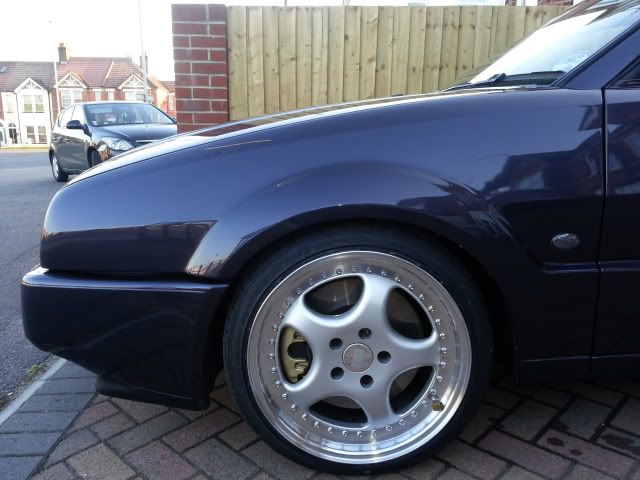

After the hassle of stripping the threads on one of my rh adapters on the way to Stanford, I managed to order some new 25mm rh adapters with steel inserts as oppose to the 20mm one i had one previously.
So i now have 17x8 rh zw1's all round with 205/40 falken ze914s with 25mm adapters. A great tyre that gives a little subtle stretch on the 8j rim.
If anyone was to run this set up in the future I'd recommend 25mm adapters all round. 20mm is too close to the suspension locking collars. If you have rolled arches then 30mm would be fine. But it all depends how low you want to go.
Managed a few pics.
