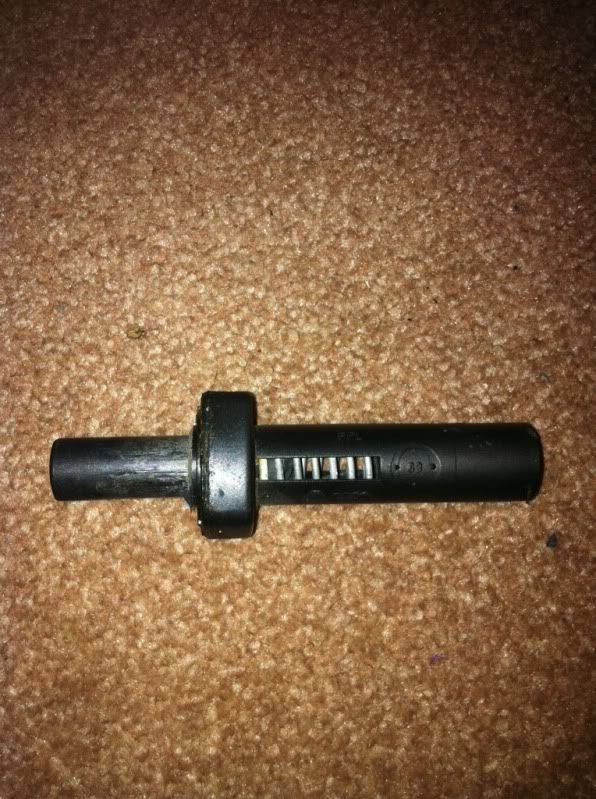

luke w 0 Posted December 14, 2011 While putting the shopping in the boot this fell on my head. Anyone know where it should go? I had a quick look but it's pitch black outside and peeing it down so I got inside pretty sharpish. Quote Share this post Link to post Share on other sites
Album56 0 Posted December 14, 2011 That looks like the boot lifting spring/plunger, its fitted in the boot lid to the left of the catch & lifts it slightly when you pop the catch so you can lift it easily. Quote Share this post Link to post Share on other sites
luke w 0 Posted December 14, 2011 Thanks mate, will check it out tomorrow when it's light. Quote Share this post Link to post Share on other sites
dalhalvaig 0 Posted December 14, 2011 I replaced one recently. It cost about 10 from the stealers. You'll need the little rubber stopper on the end as that doesn't come with the plunger. You need to take the boot lid trim off to get your hand in the fit it. There's a plastic collar/nut that you need to find. My memory is that it was inside the boot lid. If you can't find it then you'll need one of them too. Quote Share this post Link to post Share on other sites
dalhalvaig 0 Posted December 16, 2011 Just looking atthe picture now - was viewing on the phone originally - the part in the picture has the nut fitted to remember to take it off before chucking it in th bin Quote Share this post Link to post Share on other sites
