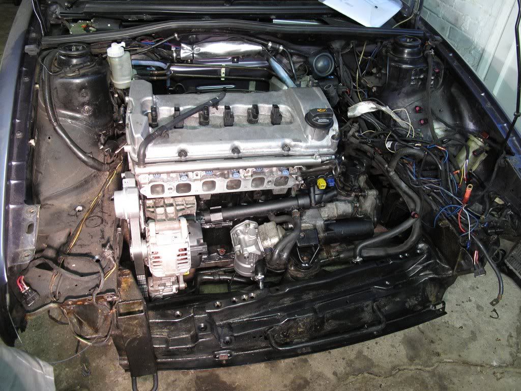

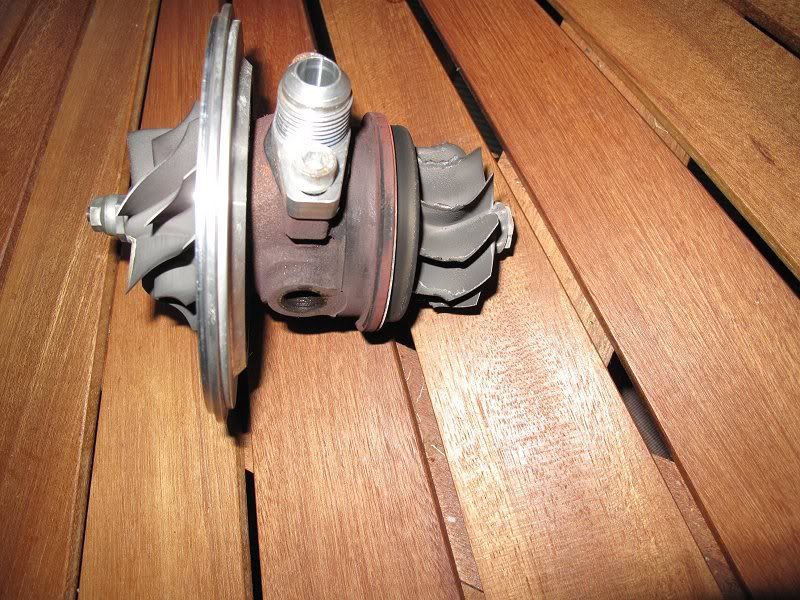

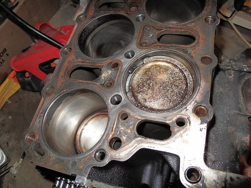

Kevin Bacon 5 Posted June 3, 2011 Time for an update whilst I'm online and the beers are flowing :D The car has been like this March. Not because I fancied using the engine space for some pot plants, but because I had some detonation problems. I still haven't found out what caused it, everything checks out fine, but just to be sure I'm going to dump the current tank of fuel and put some fresh stuff in before it runs next. Unfortunately the det caused piston 5 to let go...... ..... which spat itself through the turbo, slightly clipping the turbine blades. It still boosts fine, but I'll send it off to CR turbos for repair as it's not balanced in that state. The block is still perfect after 60K miles, no wear lip at all and no barrelling. Good old Silkolene :D A new Wossner piston costs £99 and that's all it needs to be perfect again, which the new owner of the engine is going to do. So what's next? In the meantime, I'm going for high power n'asp 24V as I had a spare AUE lump (4Motion) sitting in the garage. Haven't decided on the final spec yet, but I'm aiming for top end. Lightweight valve gear, cams etc etc. Aiming for 100hp/litre, 300 at a push with an 8000rpm limit and a short runner, but nothing's finalised yet. All I've done to that so far is paint it! The Schimmel 9lb flywheel and Helix clutch will be going on as boost is bound to happen in the future! And United Motorsport (formally C2) made this superb downpipe for me. 2" primarys and 3" collector for some proper high rpm flow. Sweet :D I will be sticking with my standalone and to that end I have installed a DBW controller for the 24V's electronic throttle into the Glovebox. 4Motion DBW pedal installed too. I tested the DBW on the old engine and it worked brilliantly. It gives the bottom end a welcome kick up the bum, something the 12V needs! Much neater with no throttle cable coming out of the bulkhead :D Quote Share this post Link to post Share on other sites

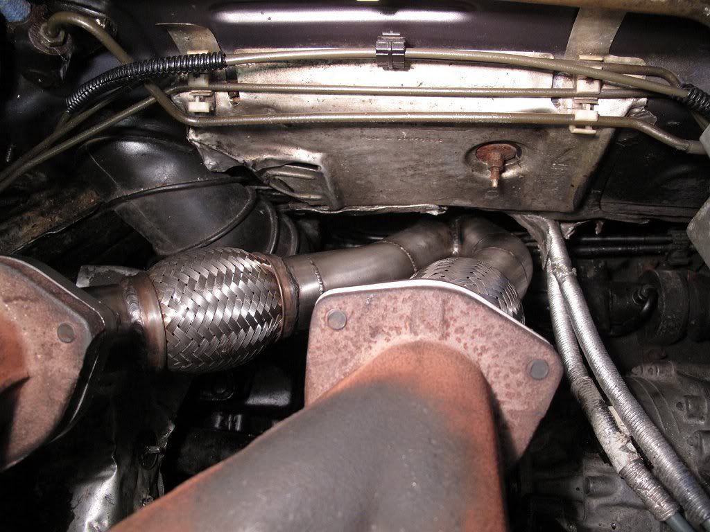

KipVR 1 Posted June 3, 2011 ^ Same here, will be interesting to see how much hp you can get NA! Did you just bolt the 4 mo pedal to the side of the pedal box bracket? Thats what I did, works well and simples. Nice downpipe and well made, can't help thinking it goes into one a bit to soon though. Quote Share this post Link to post Share on other sites
KADVR6 0 Posted June 3, 2011 nice down pipe, and oh yeh get yourself a spare pedal mate, my brothers old 4 motion went through two in about 3 months as they both snapped where the plastic meets the metal. Quote Share this post Link to post Share on other sites
chazrad 0 Posted June 3, 2011 Sorry to hear of your det problems with the DTA, Kev. Funny that that's exactly what happened to mine. My no.4 piston looked exactly like your no.5. At least your block is reusable and will live to fight another day. I suppose I was fortunate that there was no damage to my turbo. Will be interested to see how you get on with the 24v lump in NA form. You should catch up with John Munyard (corozin) on here who has some experience of trying the high power NA route, albeit with the 12v. Best of luck. Quote Share this post Link to post Share on other sites
Kevin Bacon 5 Posted June 6, 2011 Cheers chaps. I've changed my mind and decided to stick the turbo lump back in :D No matter how much power I could get out of a NA 24V, I just know it won't be enough for me, so I'd rather put the investment into turbos instead! Cheers Charlie. Unfortunately the 12V doesn't lend itself well to n'asp tuning and I'm aware of the flow brickwall Mr Munyard ran into. Having said that, although the 24V's head flows more than the 12V's, it's still not spectacular by modern 4 valve standards. Kip, yeah sort of, plus a bit of chopping and shaping :lol: RE the downpipe, the primaries merge into the collector at roughly the same place the 12V pipes do and it's been designed to bolt onto an existing 12V Cat to be as plug n play as possible, but it's all academical now. I'll bolt the 24V back together and stick it in storage again, awaiting the next 12V outage :lol: Quote Share this post Link to post Share on other sites

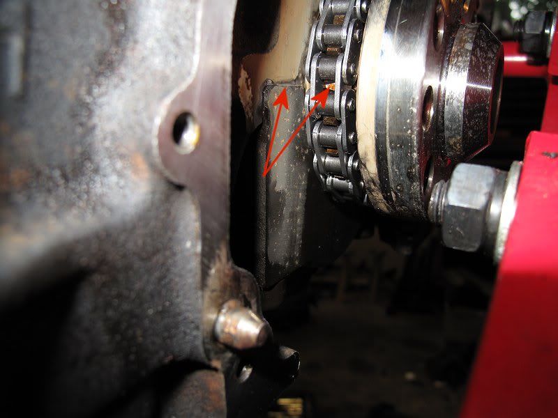

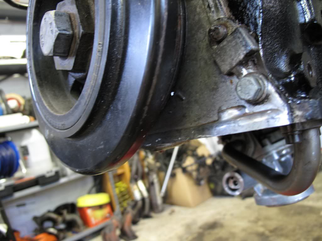

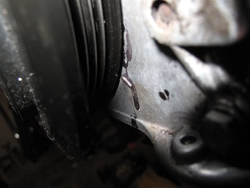

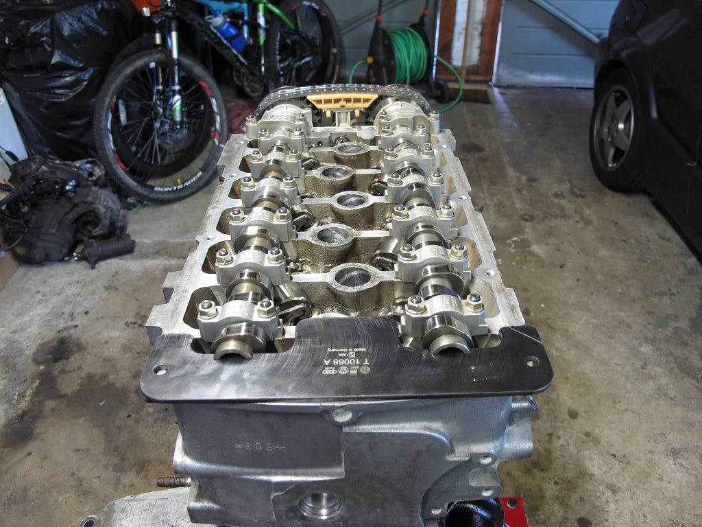

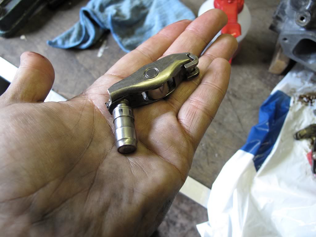

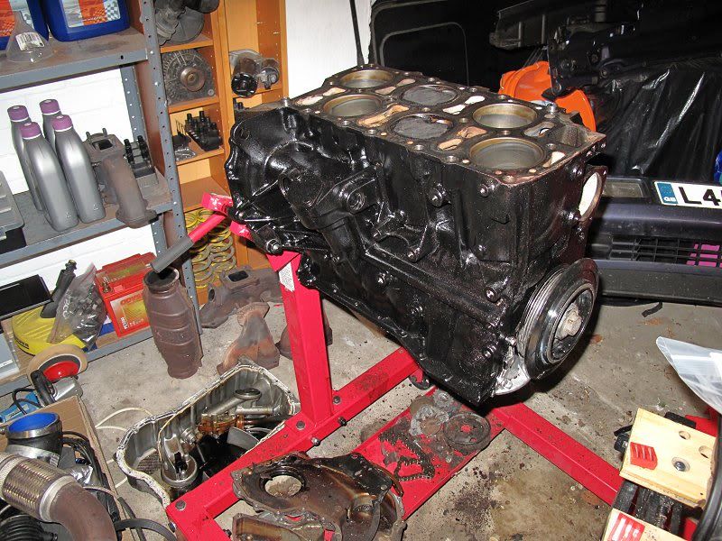

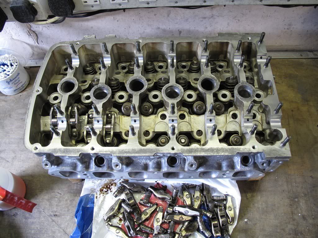

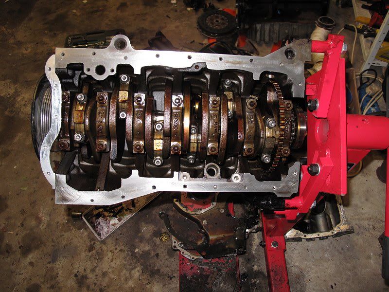

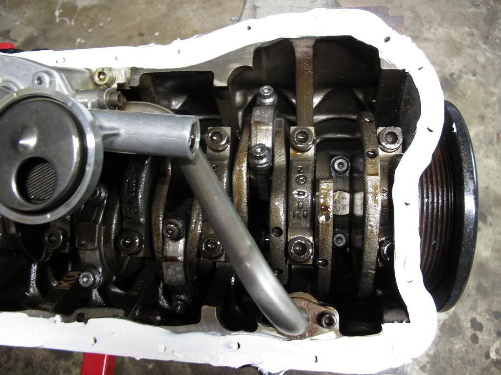

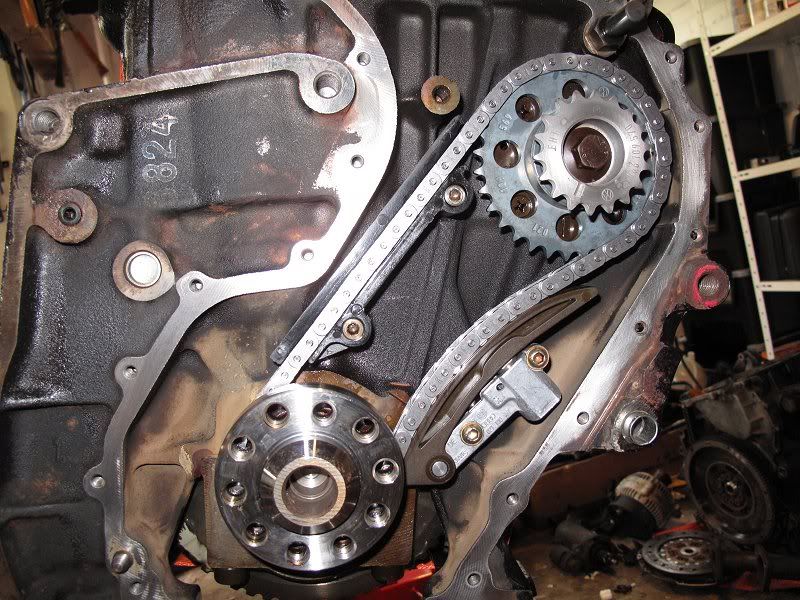

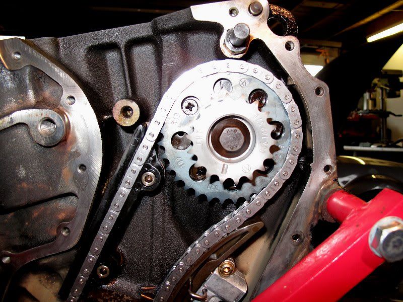

Kevin Bacon 5 Posted July 24, 2011 Haven't done a lot on it lately, but decided to get the 24V built up and out of the way today. Timing up a 24V bottom end is exactly the same as a 12V. TDC on No.1 cylinder. Notch in the crank pulley aligns with a rib on the front crank seal housing..... Crank sprocket has a ground tooth which aligns with the rear main bearing cap.... Same lower tensioner and chains..... And the intermediate shaft position. The arrow aligns with a notch in the block.... And remember guys, the intermediate shaft only aligns correctly once every 4 turns of the crank. A very common mistake people make with VR6 timing :D Block is great after 135K. Bores are a little polished but nothing out of the ordinary. 24V blocks and heads clean up a LOT better than 12V ones do... Negligable valve stem wear. Valves and valve seats look A1. Living proof that VAG's 20K oil services aren't as bad as people think. ARP rod bolts thrown in.... ARP head bolts popped in and head torqued up. C2 downpipes offered up and they are spot on. Really happy with those. Schimmel 264 cams arriving on Monday and I also need to replace the intermediate pulley as they're a weak spot on the 24V, but it's back ordered. I'll go through cam fitment and timing in the next instalment :D Quote Share this post Link to post Share on other sites

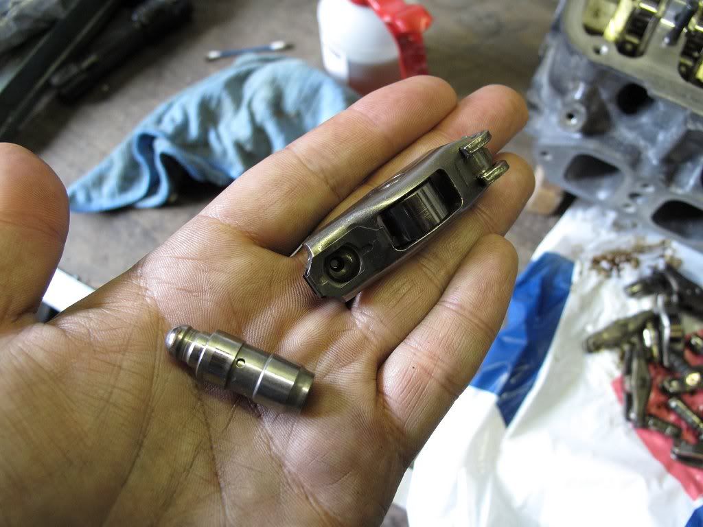

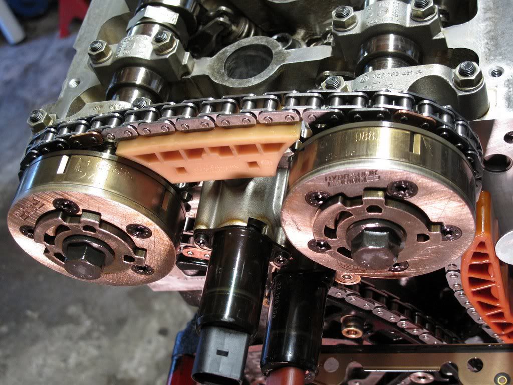

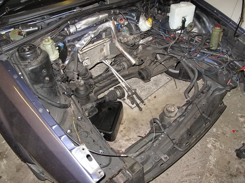

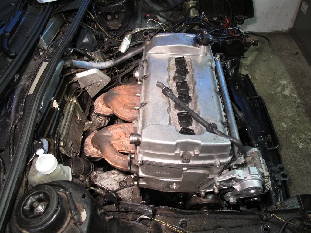

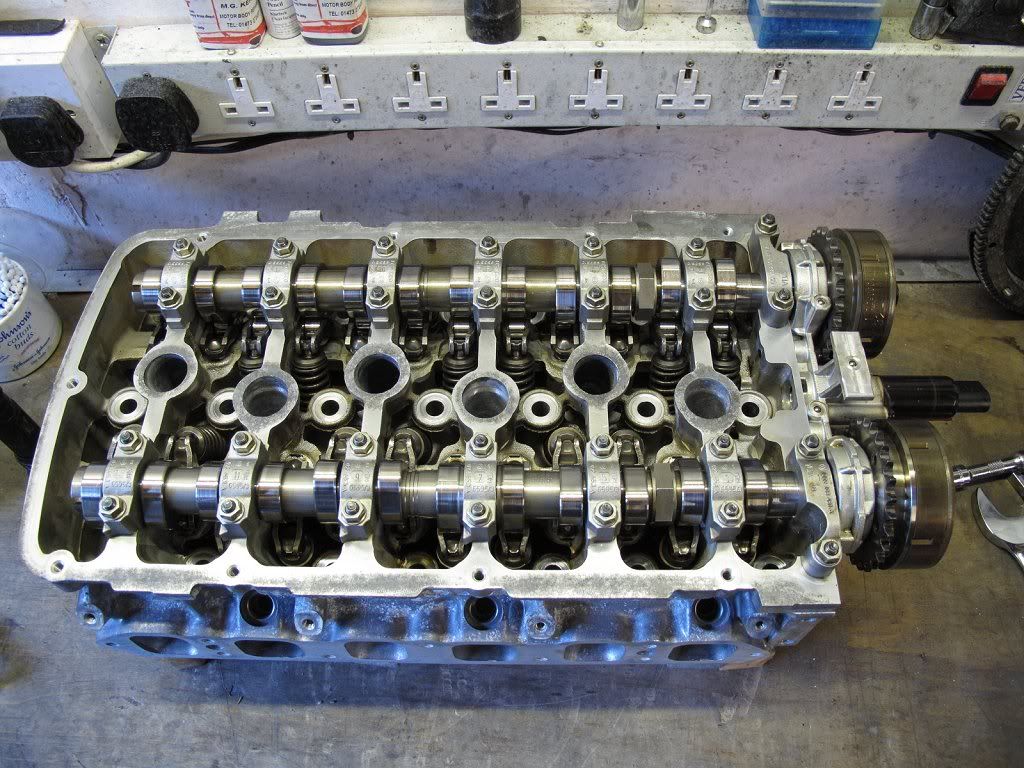

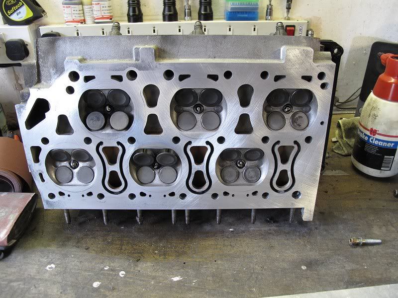

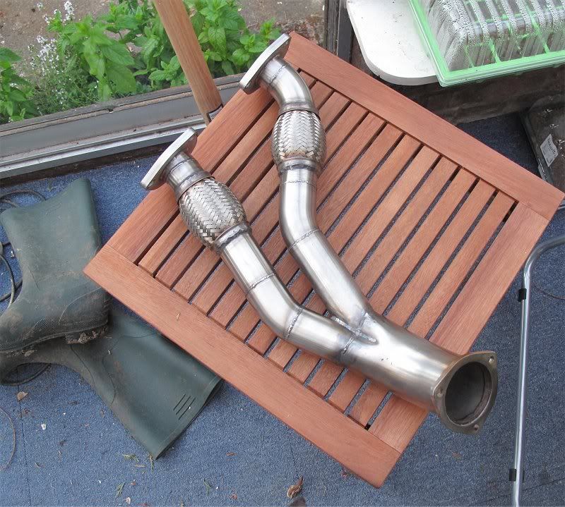

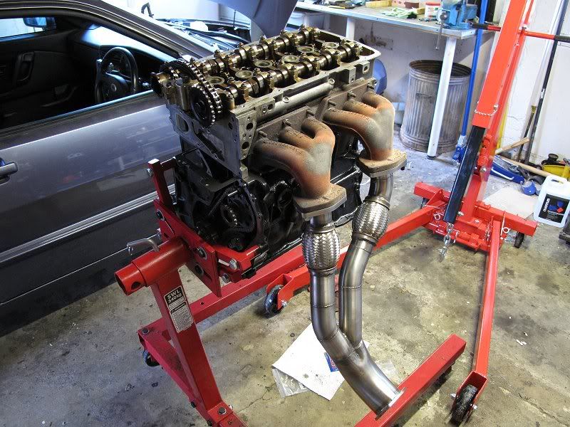

Kevin Bacon 5 Posted September 22, 2011 (edited) Thought I'd sprinkle my thread with a few updates.... The R32 motor went in recently, with a standard VR6 gearbox, standard 12V flywheel and a Helix clutch. I was going to retain my Schimmel 9lb flywheel but I think the R32's response is a little too fast as it is! It's a 2007 BDB lump from an Audi of some description and had been left in a garden for 2 years, so it was stripped, de-rusted, checked for wear, flex-honed and reassembled with new chain gear. It cleaned up rather well I thought :D United Motorsport big bore down pipes to help with my hp hunting goals :D Very happy with the way they fit. I had to bore out the 4Motion manifolds though because R32 heads have 33mm square exhaust ports and 2.8s have 31mm wide oblong ports, so I didn't want any steps in the exhaust path causing hot spots so close to the combustion chambers. Naturally some Schimmel products will feature on this engine, such as his 268/264 cams. Steel billets, not cast :D ...and this 600hp capable in-tank fuel pump, which is a Bosch 040 with a special adapter allowing fitment into the the stock pump housing. I like! Some pics I managed to capture during the build up.... ARP Rod bolts, of course! Always do them when you have the oppurtunity.... saves a lot of faff in the future. Timing up an R32 is identical to a 12V in the bottom end... ... but the cams are much trickier to get right.... VAG have added some brass links in strategic locations to help time them up properly. Proper VW cam locking tool, which I recommend... Count 16 chain rollers between the arrows on the VVT variators.... again, the brass links help you do this. The reluctor rings on the variators need to be turned fully clockwise before fitting onto the cams. Here's something you don't see every day, a stripped down R32 head! This is why 24Vs are so quiet. Roller cams! Rather than the tappets pushing the valves down directly from above, small rollers follow the cam profile and push the valves down via little arms instead, which = zero valvetrain clatter :D Other advantages of this method include a big reduction in valve guide ovalisation, and you don't have to replace the tappets when changing cams! Tappet on the left (tiny compared to 12V's), roller on the right... ...and the two married together... And with the cams and rollers installed... Sorry if that was dull :D I think the 24V is a masterpeice of engine design, which I didn't fully appreciate until I stripped it down! Edited September 22, 2011 by Kevin Bacon Quote Share this post Link to post Share on other sites
