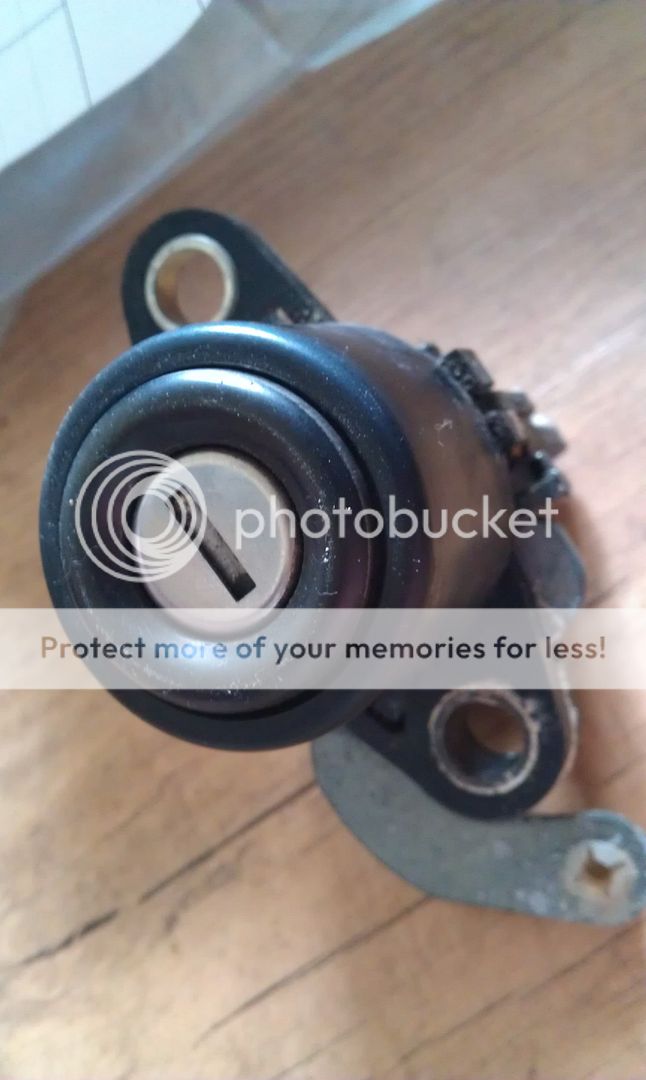

The door handle repair kit got here on Tuesday, so I fixed the door handle on Wendnesday. It's a little fiddly to manouvere the spring out of the way, but I got there in the end. I did it all without taking the door card off as I didn't fancy wrestling with the weather seal. That said, the weather seal isn't great anyway and I need to do both sides at some point. The biggest danger with the job is damaging the central locking wiring when messing with the clip, but I took it easy and it was fine. The handle now moves nicely (after a good 'grease up') but I'm missing the white plastic clip that keeps the middle of the handle tight on the door. I looked at doing the passenger side, but didn't have the time or inclination to tackle another handle, especially since the mech was still intact, so I just sprayed loads of grease on it, and it now feels a lot better as well.

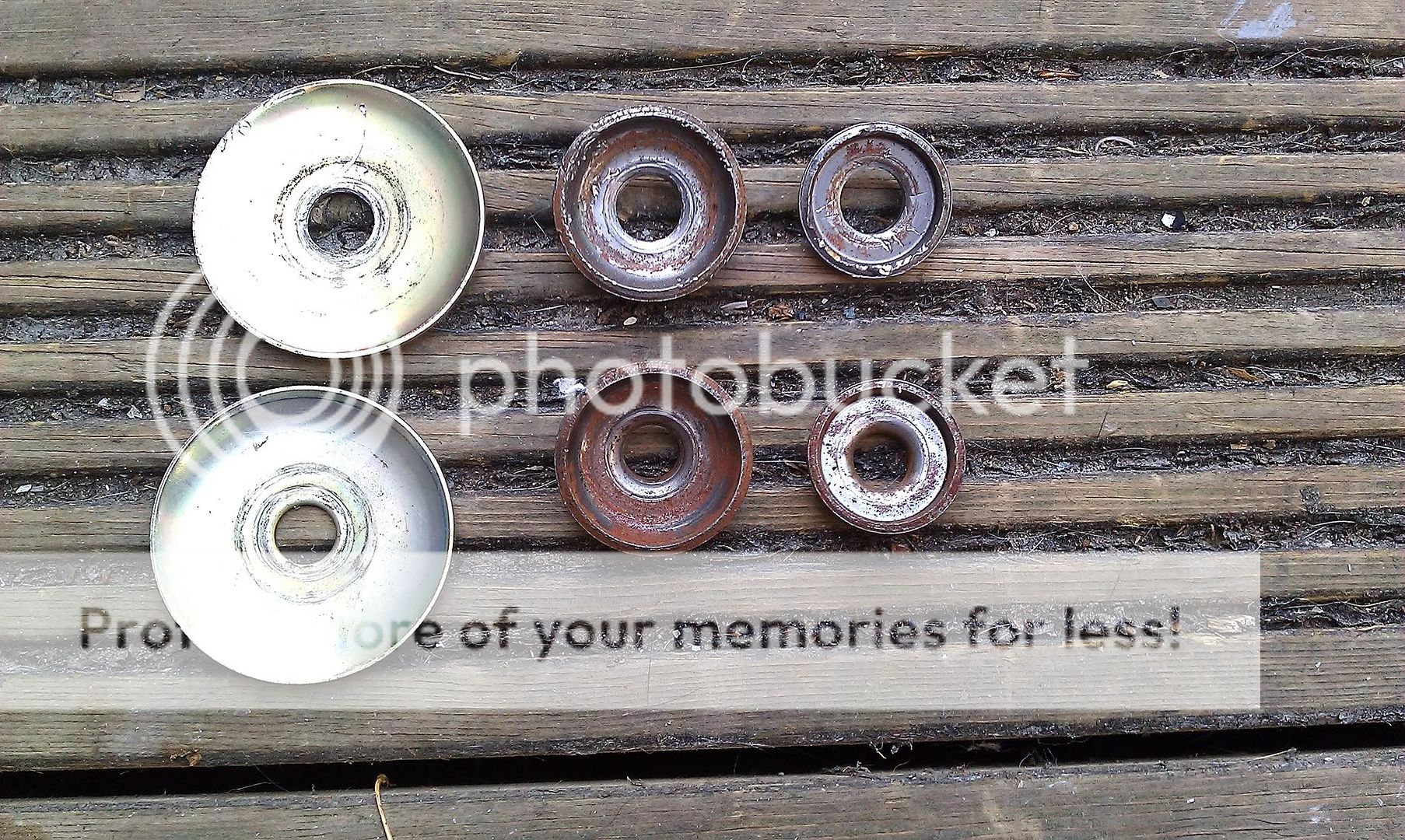

Then disaster. The VW top mount plates and nuts don't fit the Konis, and as the Konis were second hand, the guy I bought them off hadn't sent the Koni plates/nuts. I called the missus to go to B&Q for some M12 nuts and a 12mm drill bit, but the only nuts they had were the wrong thread. And then to top it off, the drill batterty died on me halfway through drilling the first plate. It was already getting late so I had to call it a day.
So the Corrado is off the road again for a week. I've ordered some nuts (M12 1.25 pitch, 19mm thin nut), and have brought the plates and drill home so I can work on them here. In another week, she may just be ready to go?
Got some nuts yesterday! I also drilled out all the plates and washers. They were fitted in 15 minutes, and the car was road-worthy again.

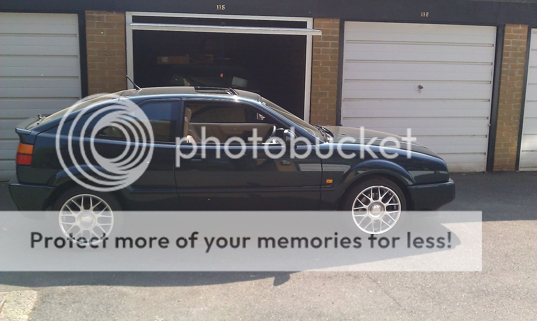

I got round to fitting fronts before it went dark. Driving up to the lock up in the Corrado was a fight to keep the car out of the kerb. The tyres had worn quite a bit on the inside. The new struts were easy to work with, though I forgot to bring the new top mount bearings with me, so I had to fit the old broken ones. So they'll have to come off again soon.
I guesstimated the camber somewhere in the middle, and the wheels look a lot better now. I think there's a slight toe-out, but nothing too bad. And it drives better too! It's like driving a normal car again!
I've set the fronts at 1.5 turns from soft, and the rears were left at 0.5 turns, and the ride is actually pretty good.

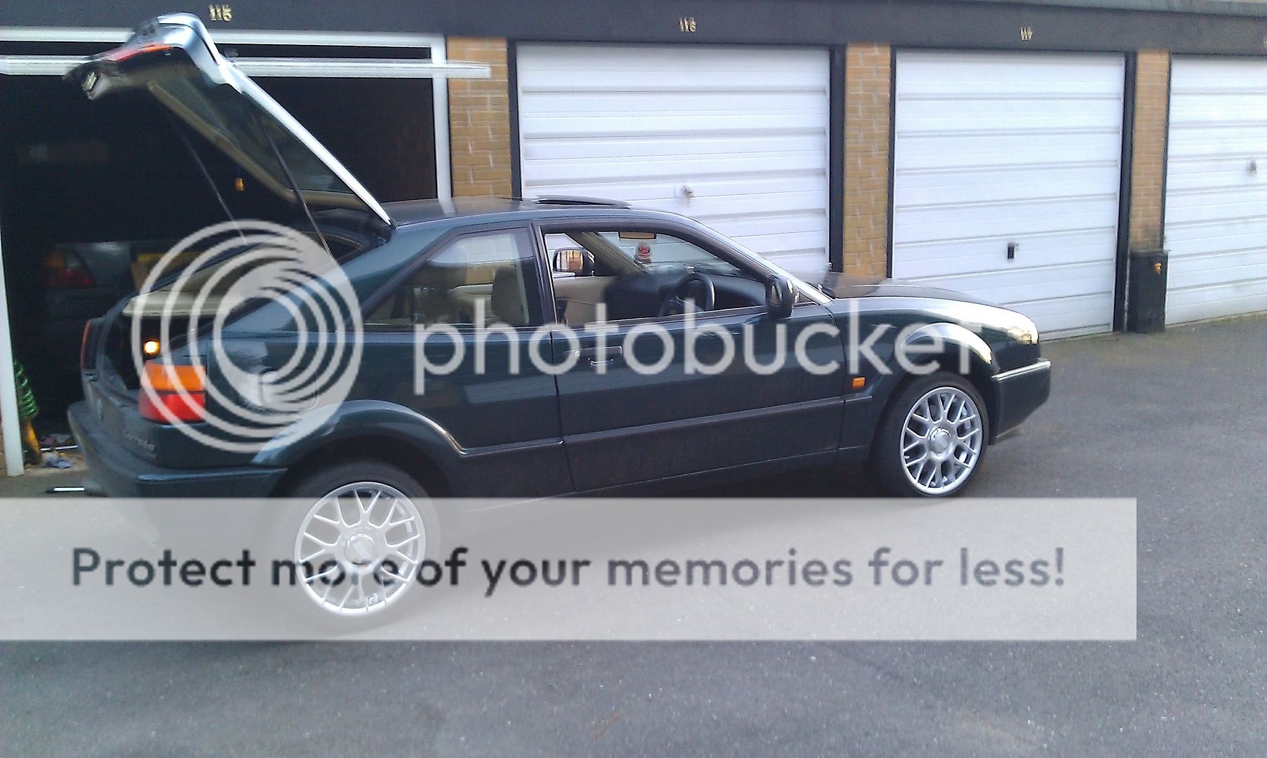

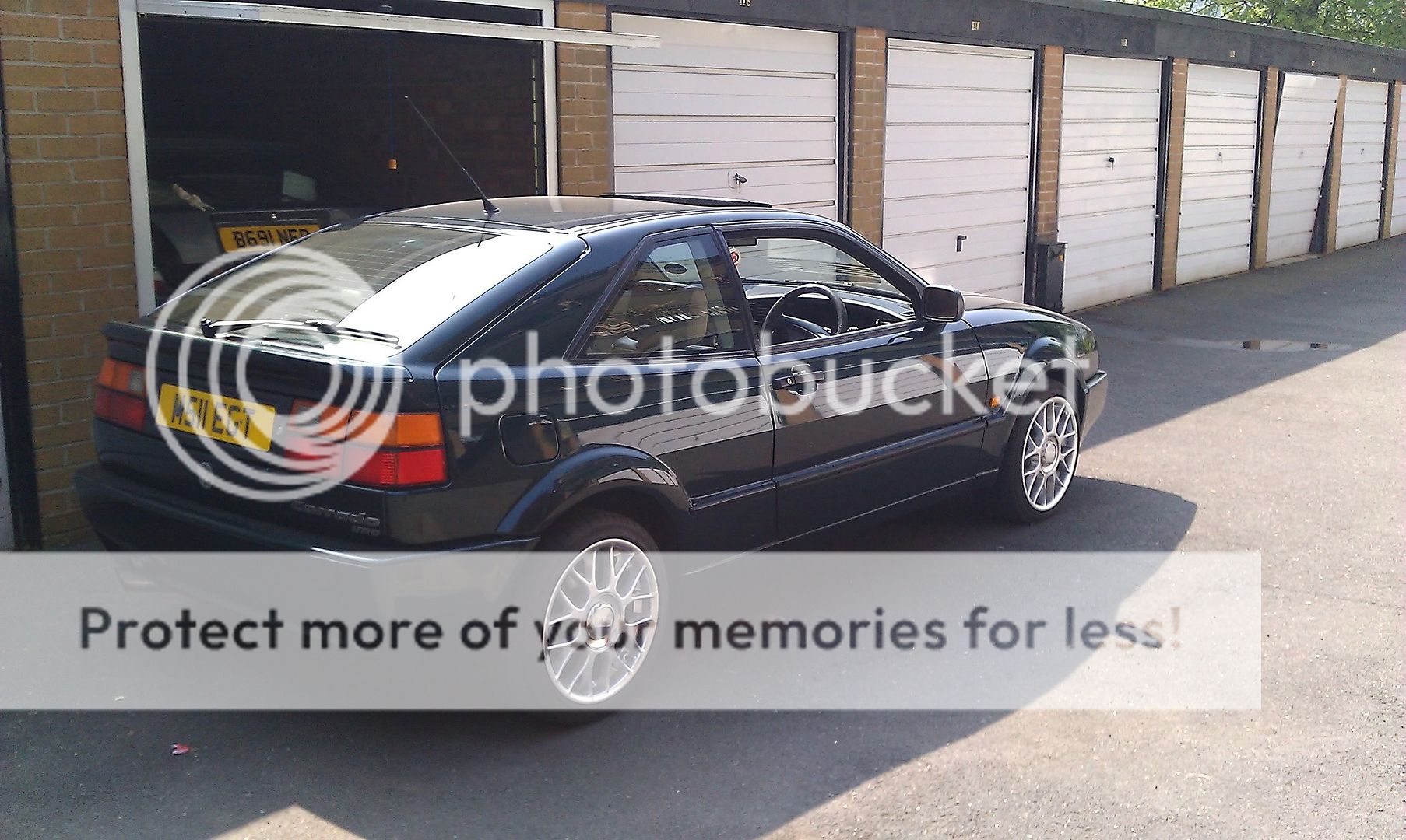

Pictures of the new wheels/suspension combo:
The difference between the rear top mount plates - standard and Koni-sized (now irrelevant as I had new plates in the kit for the new dampers!)

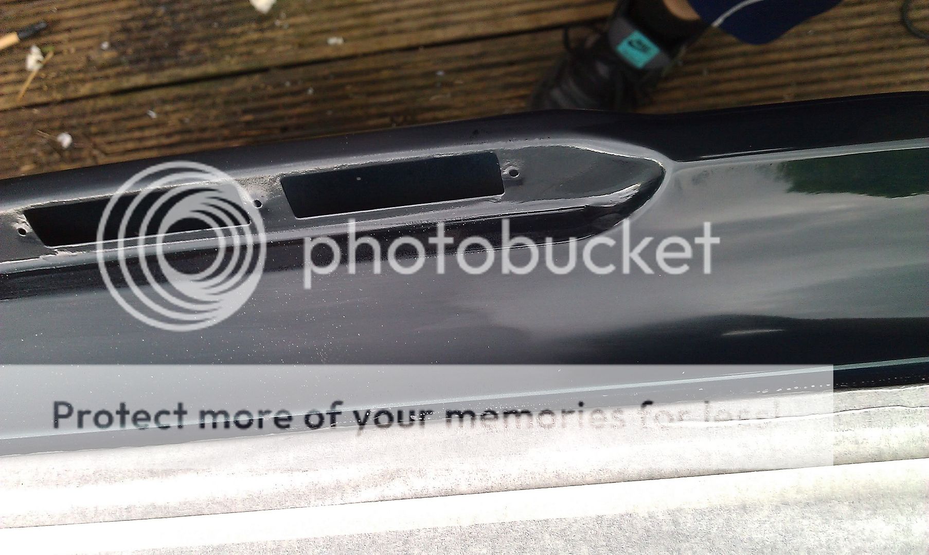

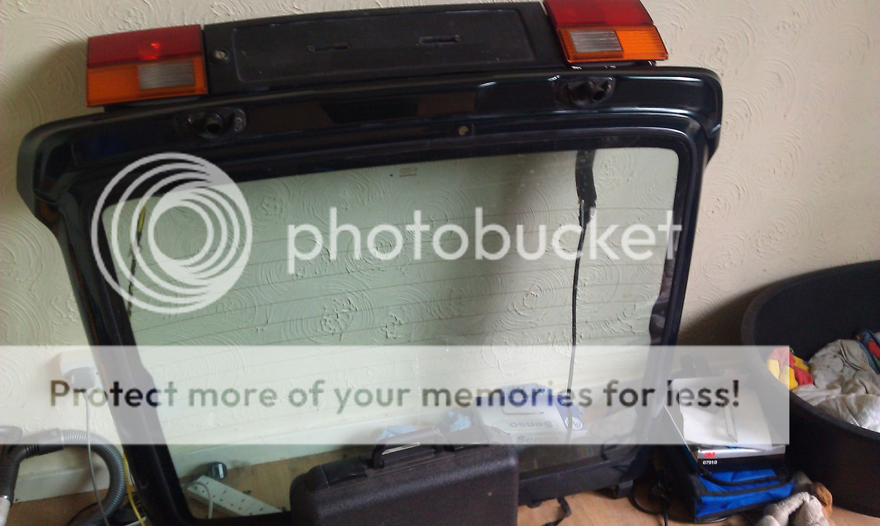

I have had a replacement tailgate sitting in my living room for several months and I decided that with free weekends becoming something of a premium, I would fit it today (I actually booked it into my diary 2 weeks ago!)
I got the tailgate from Phat, and it was pretty tidy, except for some light rust where they ALL go, around the number plate lights. I wire brush-drilled out all the rust I could, and followed up with the dremmel in hard to reach places. I treated with Kurust, cleaned and primered. Unfortunately the rust needed grinding beyond the plinth - only about 1sq cm, but enough to make touching the paint up a nightmare! I ended up spraying the whole rear panel below the spoiler and blended into the existing paint on the corner. The colour was from paints4u who I've used before and are always a pretty close match. I lacquered, let it harden, then went over with some 2000 grit to smooth the finish, followed by an hour or so with the DA polisher. I was very pleased with the results - the colour match is spot on. I looked around trying to find the blend lines, and keep thinking I have, only to realise it's just the metallic effect, and the 'line' moves, when I change position.
That's the way it stayed for a couple of months. I've not had much free time to fit it - it really takes a day to do. I did one on the MK2 a while ago and don't remember the job too fondly! This week though I started to do the finishing touches

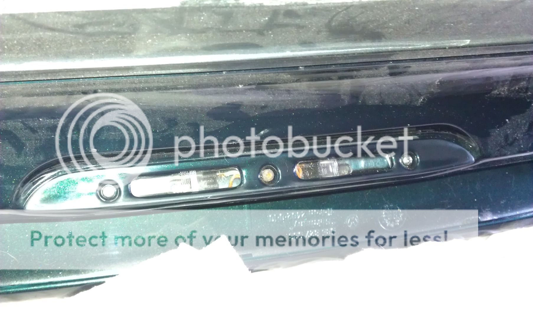

New number plate lights from VW (plinth is a grind/sand down and respray, but I need another one really as there's a small hole due to the rust)
Also took out the boot lock... I'll be needing to swap mine in!

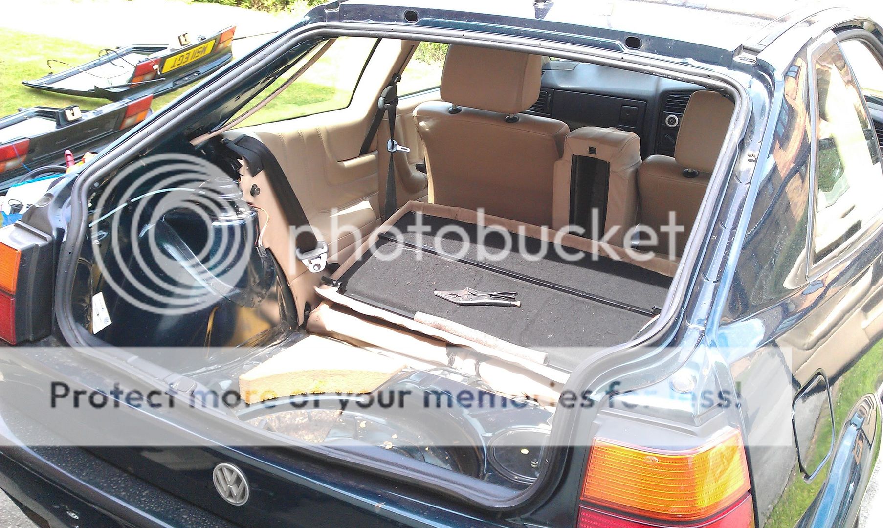

Oops... forgot to finish the tailgate update!

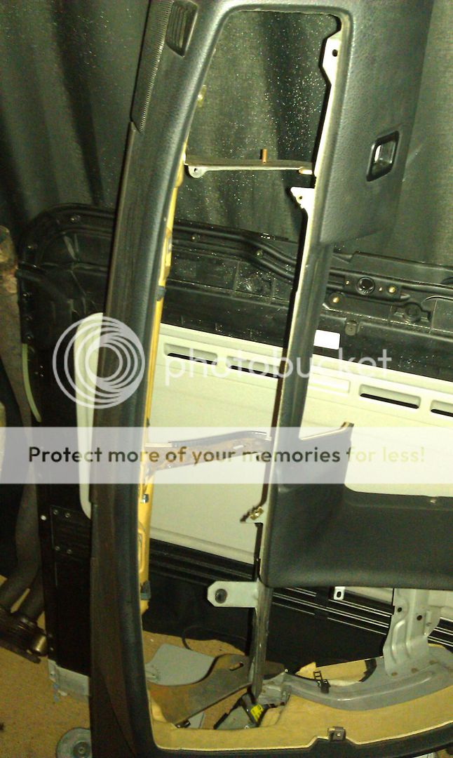

It took me about 6 hours to swap in total... I could probably have done it quicker, but I spent quite a long time swapping bits over from the old tailgate to new - making sure everything was put in exactly right.
You have to remove a surprisingly large amount of your interior at the rear to do the swap! Boot carpets, parcel shelf supports, rear headlining support and c-pillar trims all had to come out to get access to the bolts and wiring.
And what I learnt...
-The tailgate is heavy. Really heavy. Three people-heavy
-Taking out the circlip is the easiest way to remove the hydraulic struts!
-When putting the new tailgate on, those pesky bolts just won't go in without 15 minutes of fiddling around
-Check and check again that the wiper washer pipe is connected
-Lining up panels to get the correct gaps is a nightmare when you can only adjust when the panel is open

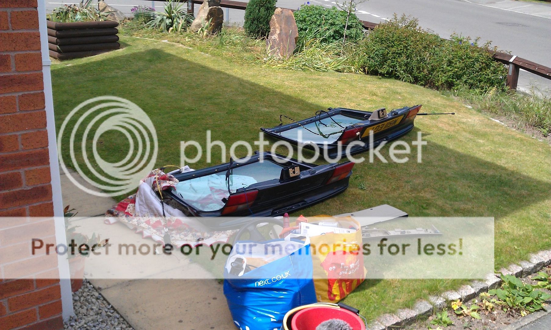

Some pics of my day...

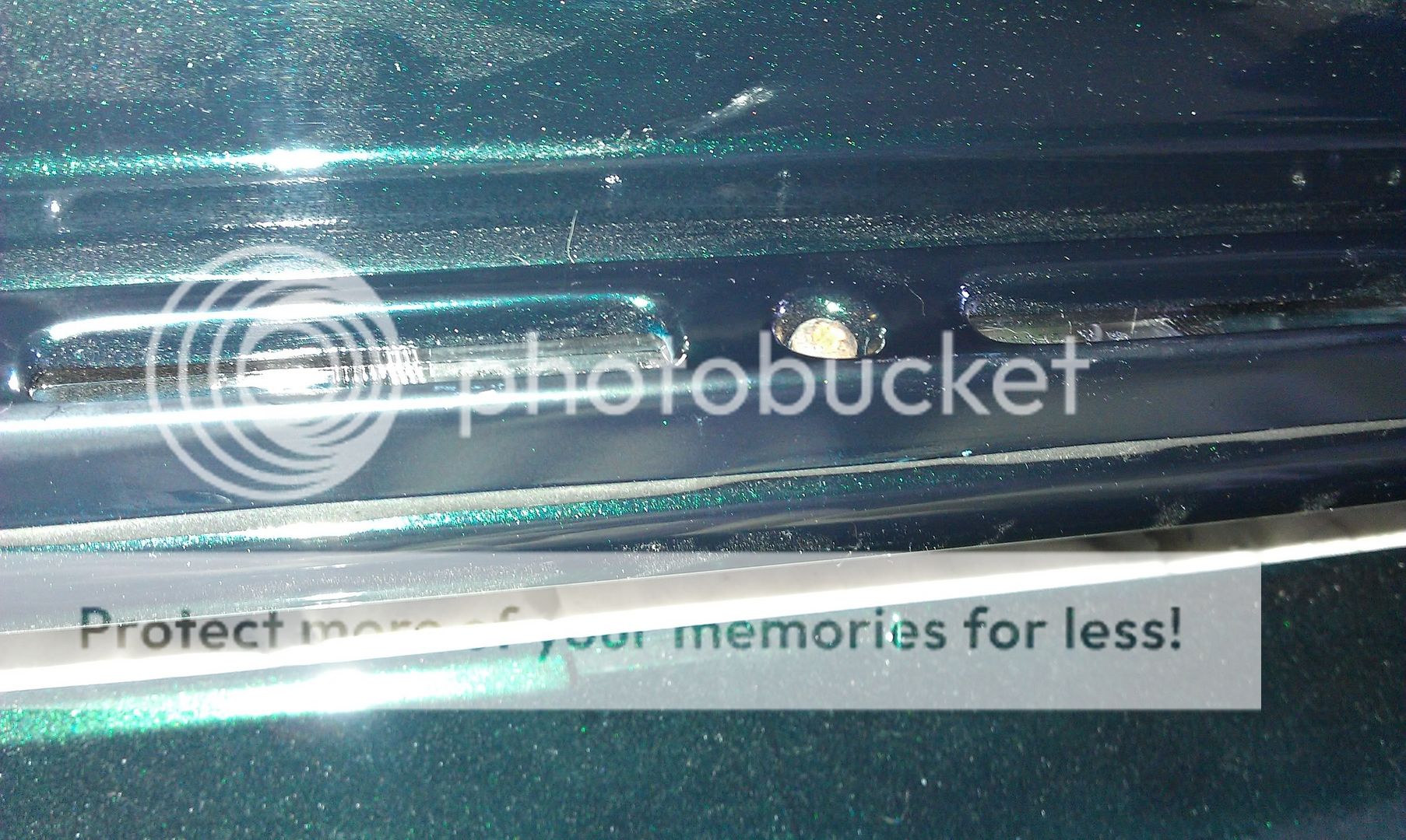

I also spent some time treating the rust on the driver's sill. It was surface rust, but getting worse, and was caused by rust on the inside of the driver's door dripping down when wet onto the sill. I wire brushed and ground out all the rust (I hope!). I was going to use filler to bring the repair back level with the surrounding metal, but the weather was not on my side - plus the repair was only really to stop it getting worse rather than getting it perfect. I sanded, masked and sprayed (using etch primer, colour coat and lacquer), and it's come out pretty well. I also discovered G3 rubbing compound for the first time (where have you been all my life??) so the finish, although not perfectly smooth because of the underlying metal, is shiny at least!
