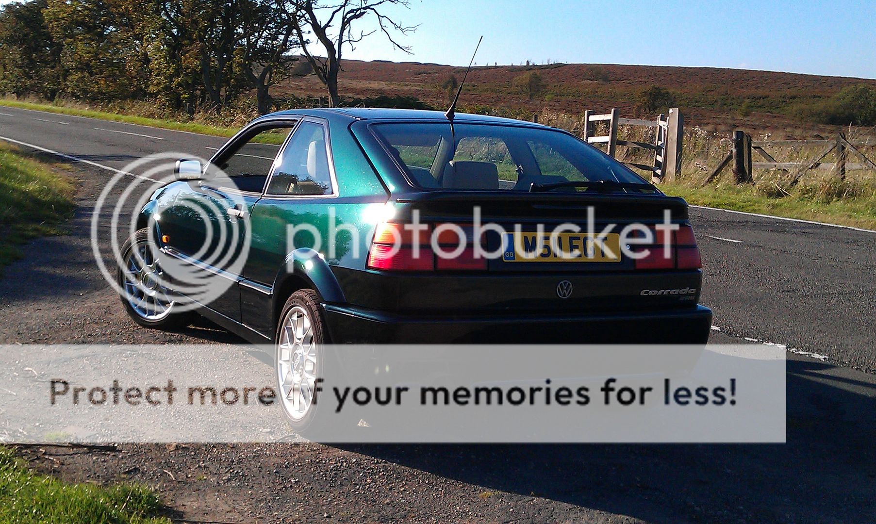

tony_ack 0 Posted October 19, 2011 Well after the non-starting drama last week, the car has behaved impeccably. Since I decided to take it off the road for the winter I have fallen in love with the car again - every minute of driving (even stuck in traffic) has been a pleasure. I came home this evening over the Snake Pass, and the car was simply amazing - when the VR6 turbo guys end up on these sorts of roads they must be s*****g themselves as it was mental with just a Schrick'ed VR6. The insurance runs out on Saturday so I'm enjoying the last few days! Quote Share this post Link to post Share on other sites

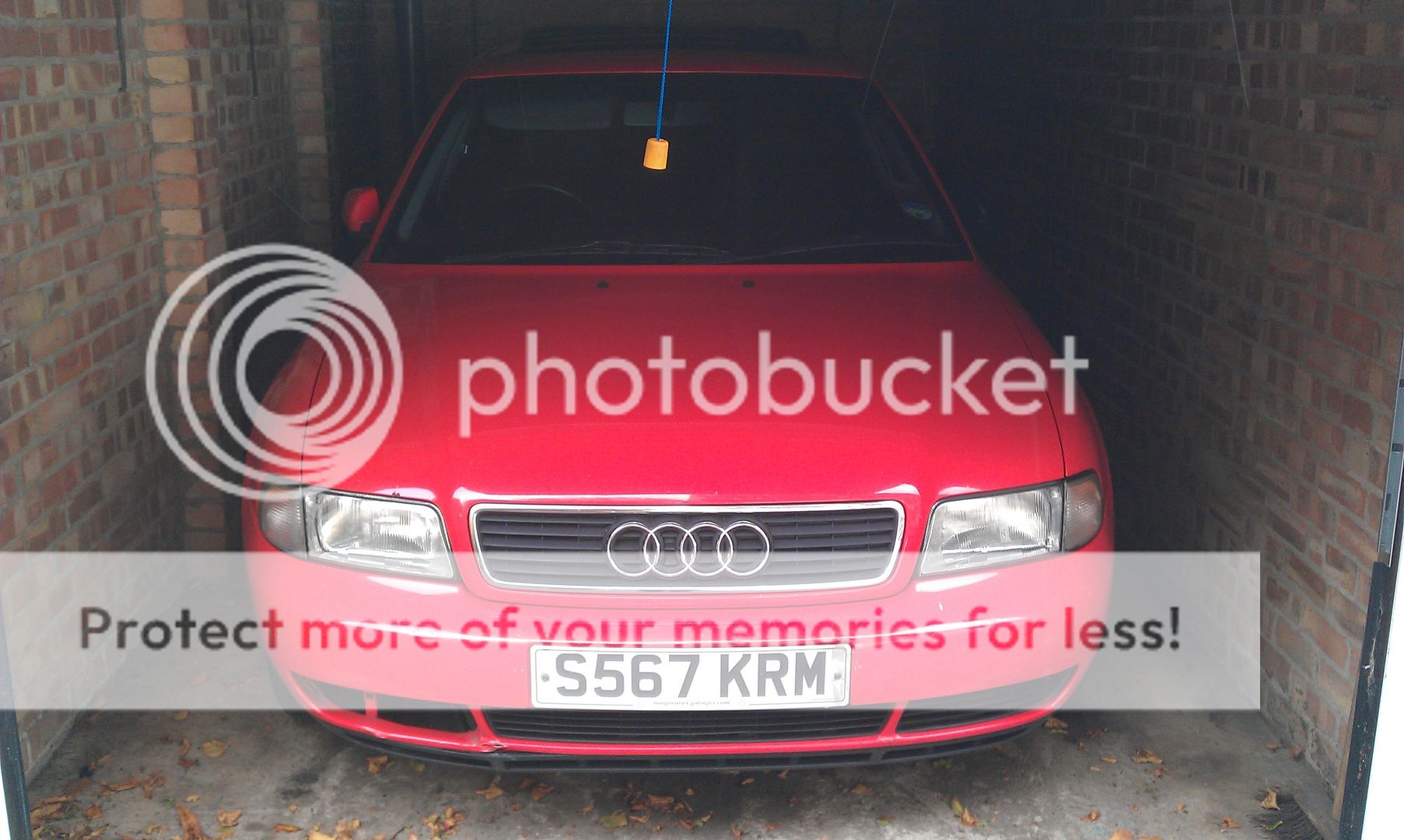

tony_ack 0 Posted October 23, 2011 Well, it's all tucked away now for the winter. It was a sad day. I'm now in my new daily - a diesel Audi A4. It's a bit of a comedown from the Corrado. A whole 90 bhp (when it is running right which this one isn't!). It is big as well. Big and heavy. But it's also economical and it means I can reduce the mileage on the Corrado. Quote Share this post Link to post Share on other sites
boost monkey 0 Posted October 23, 2011 omg ant, I got so worried that it had been wrecked when you said Retired! Glad to know it's safe and tucked up. I threw the tarp back over the Plum today. We can't all have garages! :-s Quote Share this post Link to post Share on other sites
VW_OwneR_85 2 Posted October 23, 2011 Well, it's all tucked away now for the winter. It was a sad day. looks like a safe little bunker :) Quote Share this post Link to post Share on other sites
VR6 0 Posted October 23, 2011 Great read Ant - not been through the whole thread but having looked through the last few pages, it's definitely one I'll come back to! That Audi sounds awful!! Is it less like driving and more like navigating a paddle-steamer? :grin: Quote Share this post Link to post Share on other sites
tony_ack 0 Posted October 23, 2011 Great read Ant - not been through the whole thread but having looked through the last few pages, it's definitely one I'll come back to! That Audi sounds awful!! Is it less like driving and more like navigating a paddle-steamer? :grin: To be honest, the Audi is okay... for £700 with 11 months MOT I'm pretty happy with it! The ride is nice even on the bumpy roads, though I need to remember to slow down a bit in the corners. It was rough when I picked it up, but I spent a full day yesterday tidying it up, including a clay/polish/wax and it's now quite presentable. The biggest problem with it is that it's just so big compared what I'm used to, which makes car parks a bit more daunting. It needs a cambelt sooner rather than later, and there's a split in the boost pipe which I think is causing a loss of power and excessive smoke. Other than that it is mechanically sound. The garage for the Corrado is dry which is the main thing, and pretty clean (the oil patches are from the Audi's service!). I want to give the Corrado a good clean as it still has the last 2 weeks of road dirt on it. Although there a few jobs that need doing to it, I'm loathed to start on them at the moment, because as it stands, the Corrado is still fully drvieable. ---------- Post added at 11:19 PM ---------- Previous post was at 11:15 PM ---------- Speaking of car parks, after the detailing session yesterday, I headed to Halfords for an air freshener and audio cable... it was pretty late so the car park was nearly empty, so I parked in a space with nothing around me. When I came back out a Land Rover Discovery had parked next to me on my passenger side, with very little room between that and the Audi. It is annoying to think that someone with the whole car park to choose from decided to park really close to me. So I got back in my car and started messing around with the air freshener/audio lead. While I was fitting them, the Land Rover owner came back and tried to get in his car. He had left himself almost no space to open his door, so opened it slowly, tried to squeeze in, and when he realised he couldn't he SLAMMED the door against my car and got in. I yelled at him but my windows were closed. I banged on my passenger window but he was already in his car now and didn't hear me. Still oblivious to my presence, he started tucking into a packet of crisps so I got out of the car to get his attention but he was already driving off. I don't think he ever even knew I was in the car. I checked my passenger door and he had chipped the paint. So glad I wasn't in the Corrado, but it's idiots like these who really annoy me. Quote Share this post Link to post Share on other sites

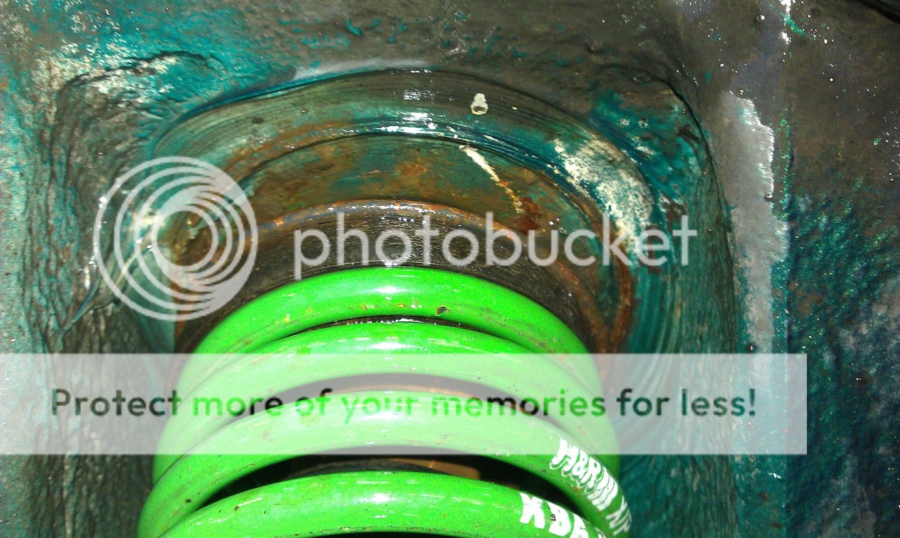

tony_ack 0 Posted November 19, 2011 I spent some time on the Corrado today. I took off all the wheels to give the wheel wells and arches a really good clean, but the main purpose was to see how badly it was rusting. Well, some good news and bad news. The good... -the rear arches are mostly okay -very little around the fuel filler - just a bit on the left-hand inside of the filler hole where the underseal has separated slightly -nothing around the windscreen -inner front wings are completely rust free -sills are mostly okay except for a small (less than 5p) rust bubble on the left hand sill near the front (smaller than the rust I ground out of the opposite sill) -all wheel wells clean and rust free -most of the visible body is rust free, just a couple of spots of very light bubbling The bad... -three visible rust spots on the rear panel... not bad on it's own, but I haven't checked the rear valence under the bumper yet, and... -1.5" hole inside the boot on the rear panel, where it joins to the floor. Seems to be on the join, and hidden by the foam that packs the spare wheel, but still needs fixing -rear arch to sill join on the near side looked okay, but the 'lip' was loose... after a bit of prodding it was rotten! I've removed the loose rust and the completely rotten metal from the area, along with some of the underseal to try and stop more water collecting there -rear arch to sill join on the off side was bubbling on the lip, but doesn't seem to be rotten (well, I can't put my finger or a screwdriver through it anyway and there seems to still be some solid metal there) -surface rust inside all the suspension turrets -front off side wing lip is bubbling quite badly... may be just enough metal left to salvage. Near side front wing is starting too, but should be easy to repair. -both front jacking points (not the actual proper jacking places, but the 'nipples' that stick out at the front of the floorpan) have collapsed and rusted So now I have yet another new priority. When the car is back on the road in the spring, I'm going to book it into a trusted classic car restorer (missus' friend's dad) to get me a quote to sort out the rust properly. He's meticulous about his work, and as these areas only get exposed once every 5-10 years, I want to make sure they're done right and the repairs will last. The car could do with a respray eventually as it's a bit of a patchwork quilt at the moment, but that can wait a few years. NSR arch-sill join OSR turret Quote Share this post Link to post Share on other sites
