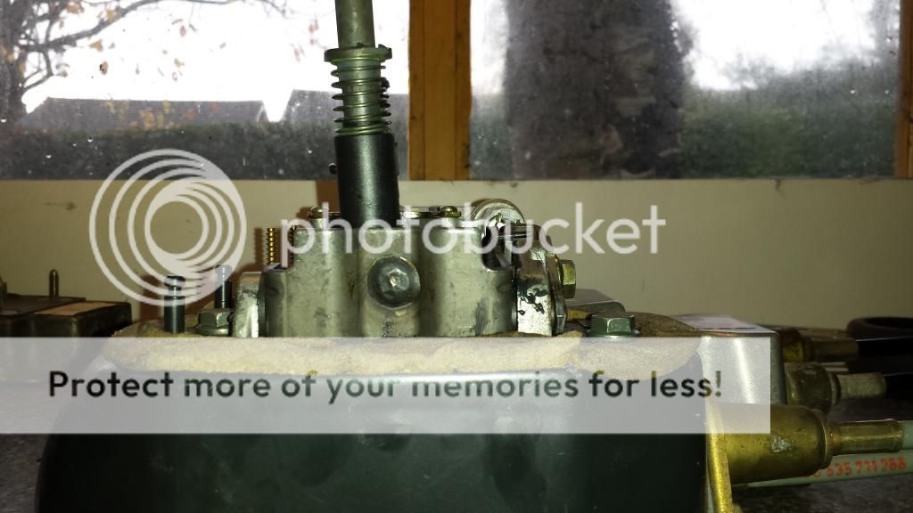

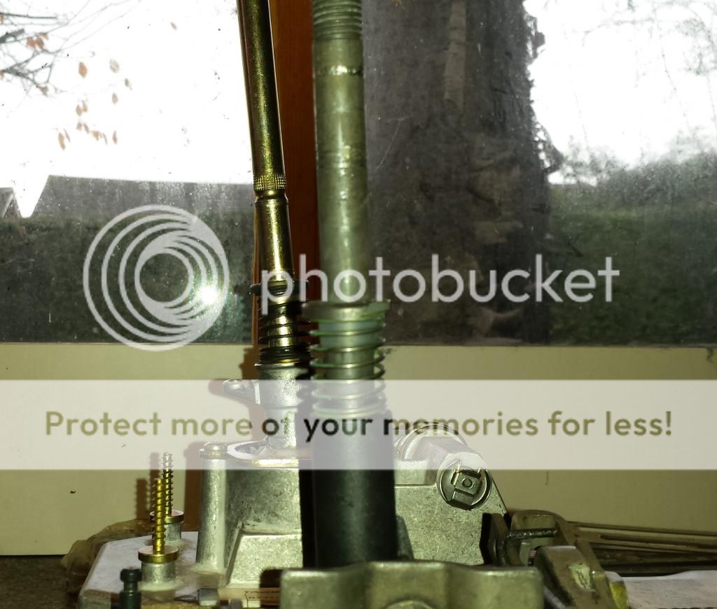

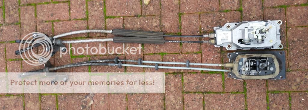

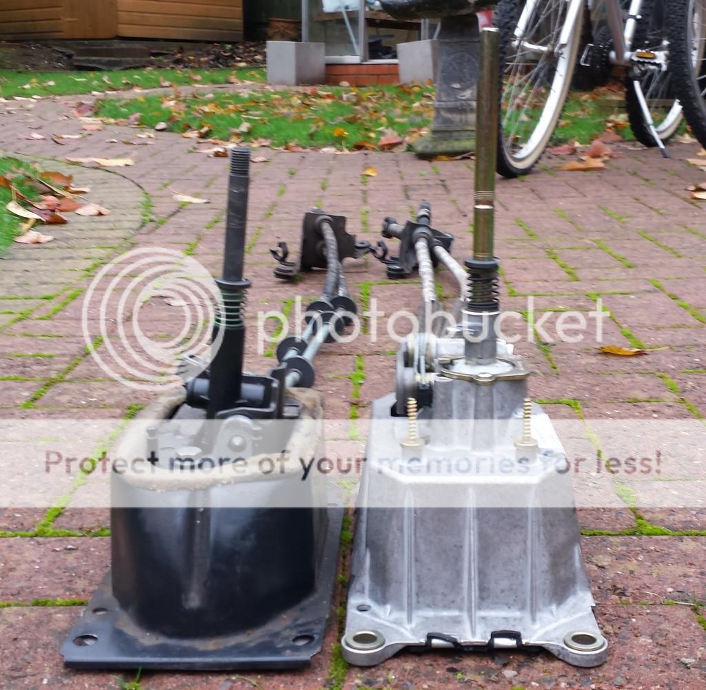

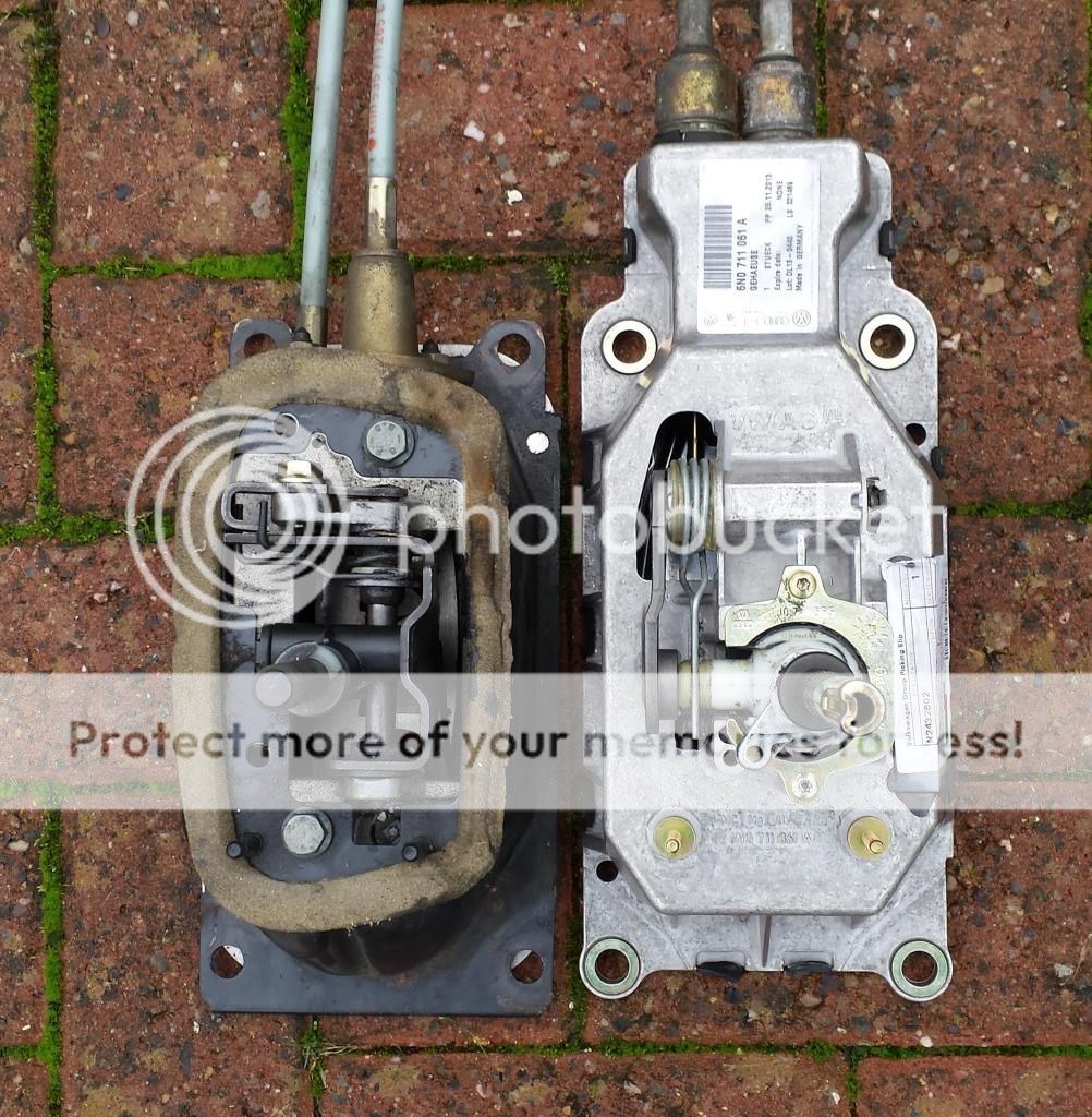

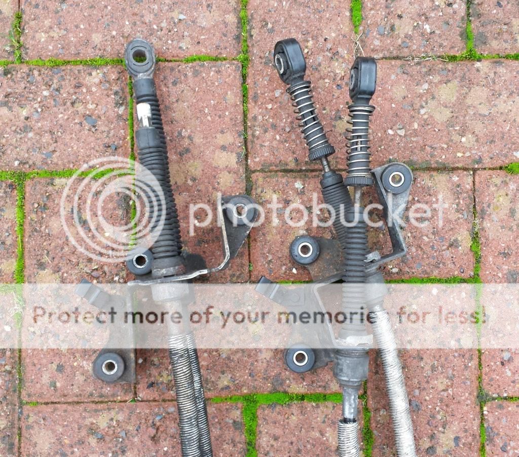

daves16v 1 Posted November 24, 2014 I've started getting the parts together for this conversion. So here is the new shifter assembly along side the Corrado shifter. The height of the actual stick is way longer than the Corrado so I've cut this down to match and will re-thread the end, it's still the original length in the photo's. When the shifter box is fitted to the Corrado tunnel, the stick will sit about 10 to 15mm higher if my calcs are correct, you can see the height comparison of the spring tops in this photo. This photo shows the comparison of the section of the shifter that will sit inside the car, the Polo box has a little more bulk to it but it should drop into the space without any interference with the plastic surround and gaiter. The only other thing I can see different is the centreline of the actual stick sits about 5mm further back than the Corrado but not enough to bother it, you can see it in one of the photos. I just need to get hold of an 02J selector tower now, then I can get it installed. Quote Share this post Link to post Share on other sites
