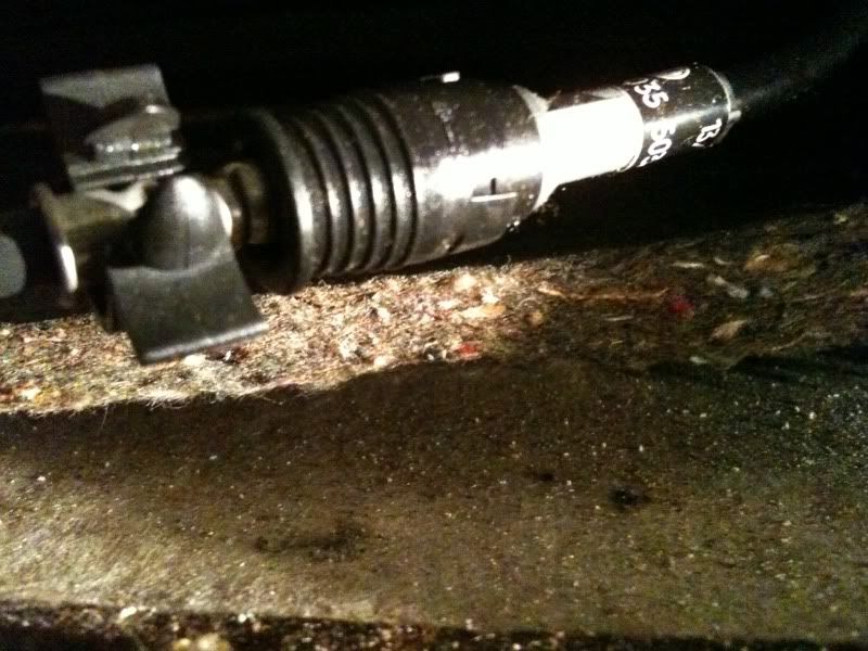

krishen 2 Posted June 27, 2011 Can anyone tell what ariel connection i need from this photo? Not the greatest pic but best i could get at the time. Will this ebay one fit as a replacement? http://cgi.ebay.co.uk/VW-Beetle-Golf-Passat-Polo-Roof-Aerial-Antenna-Base-3-/360322452672?pt=UK_CarsParts_Vehicles_CarParts_SM&hash=item53e4e44cc0&clk_rvr_id=244156808034&afsrc=1#ht_542wt_907 Quote Share this post Link to post Share on other sites
Keyo 47 Posted December 12, 2021 (edited) Hi is this correct for 95 corrado thanks cannot find antenna on etka. Note it has a none threaded end- I believe there are late and early but as mentioned cant see nowt on etka. Edited December 12, 2021 by Keyo Quote Share this post Link to post Share on other sites
ger040 3 Posted December 13, 2021 part number refers to mk3 golf / vento will probably have been fitted to corrado as i would assume vw just fitted what was available during build. Quote Share this post Link to post Share on other sites
Keyo 47 Posted December 13, 2021 (edited) 4 minutes ago, ger040 said: part number refers to mk3 golf / vento will probably have been fitted to corrado as i would assume vw just fitted what was available during build. Thanks mate I purchased it for £30 nos so cant go wrong really as i think vag charged £120 for them - might just have a different plug- easily sorted. Edited December 13, 2021 by Keyo Quote Share this post Link to post Share on other sites
