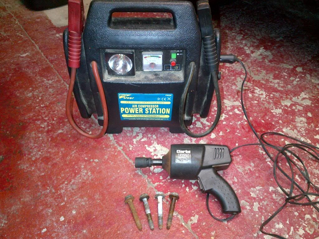

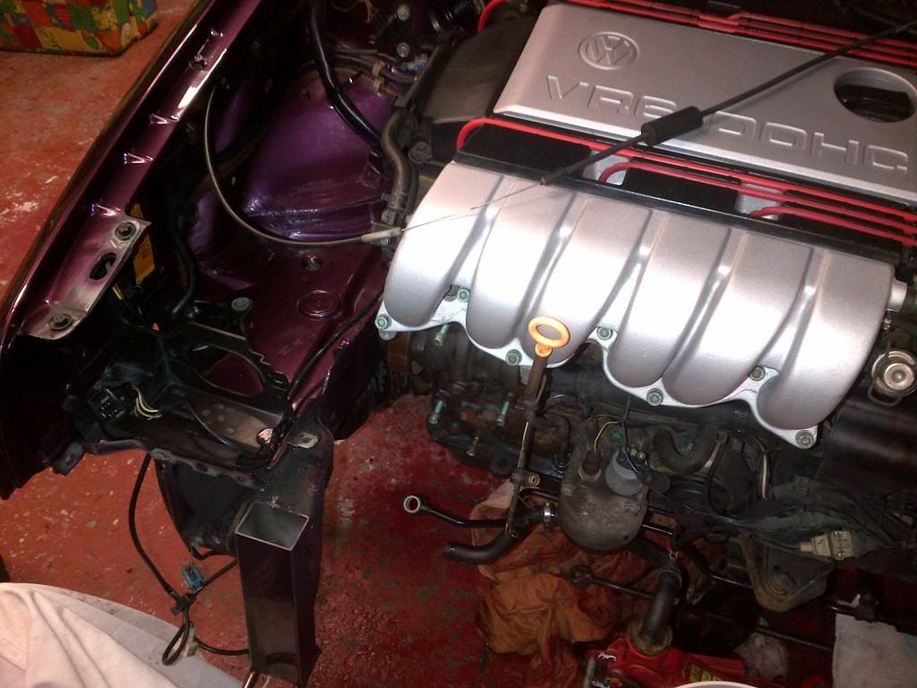

ChrisL 20 Posted November 13, 2012 Well, with the help of this little gem, I had no problems with the bolts at all..... So shortly after I am left with this: Didnt realise I'd have to mess with the power steering, oh dear I'll cross that bridge when I get to it. One thing I did notice, there is an electrical plug that seemed to connect to the bumper on the drivers side under the fog light and indicator - does anyone know what i'm talking about and what it is for please? Slam panel next I think then dump the water and remove the radiator then onto the cross members........ Quote Share this post Link to post Share on other sites
VWVW 1 Posted November 13, 2012 "One thing I did notice, there is an electrical plug that seemed to connect to the bumper on the drivers side under the fog light and indicator - does anyone know what i'm talking about and what it is for please?" ...Think thats your outside temperature sensor Quote Share this post Link to post Share on other sites
Jim 2 Posted November 13, 2012 Yep - outside temp sensor. Have a look down the bottom of the bumper on the drivers side - you should see it in there :) Quote Share this post Link to post Share on other sites
KIPVW 0 Posted November 13, 2012 There's a small hole in the mesh grill section where the towing eye covers are for the sensor. right at the far end. Quote Share this post Link to post Share on other sites

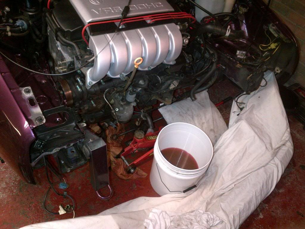

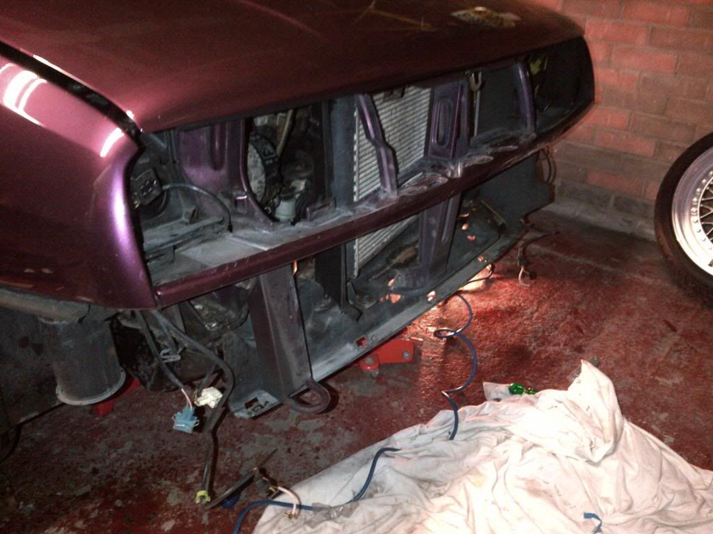

ChrisL 20 Posted November 18, 2012 had a good day on the car today, radiator, alternator, belt tensioner, power steering pump and bracket, air box, crossmember etc off. so the car now sits like this: What the hell am I doing!!!!!!! Took fans off the radiator cowl then the 2 plastic fan cowls, unfortunately most of the clips broke so not sure what to do there, can these still be bought new? Next job while the bits get shot blasted and coated is to get the alternator apart and spray the aluminium (got the pulley off already), clean the power steering pump and clean the wiring around the engine. Hope this goes back together.... Quote Share this post Link to post Share on other sites
KIPVW 0 Posted November 19, 2012 Oooooh! Hope the pump survives as once mine was off it packed in lol! Quote Share this post Link to post Share on other sites
Jim Bowen 1 Posted November 19, 2012 What the hell are you doing!!! :lol: Them plastic cowls for the rad fans are still available at the dealers and pretty cheap too, about £8 each Quote Share this post Link to post Share on other sites
ChrisL 20 Posted November 19, 2012 KIPVW said: Oooooh! Hope the pump survives as once mine was off it packed in lol! Dont say that, i've seen how much new ones are!! Are they self priming? I might fill it before connecting the top hose. I was going to leave it but the big aluminium bracket was so mucky. Jim Bowen said: What the hell are you doing!!! :lol: Them plastic cowls for the rad fans are still available at the dealers and pretty cheap too, about £8 each Brilliant, I was hoping they were still available. Quote Share this post Link to post Share on other sites

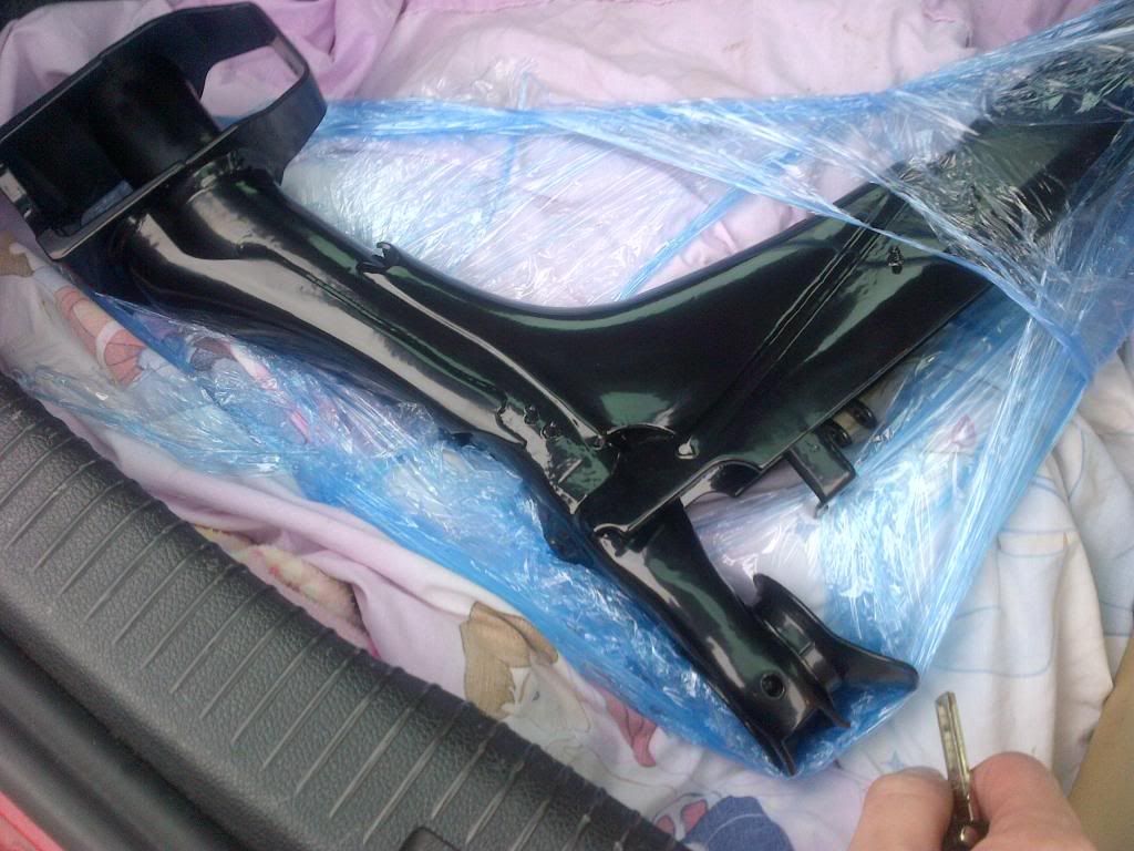

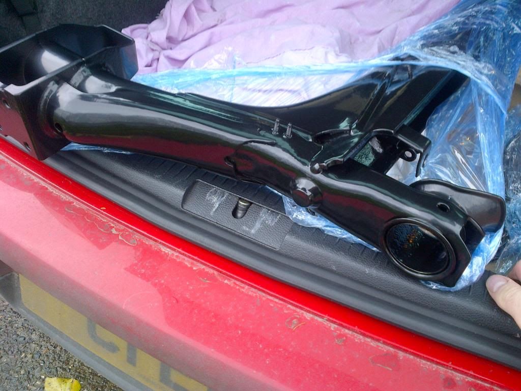

ChrisL 20 Posted November 25, 2012 OK, here's a small clue... http://www.supersprint.com/en/prod-146-6345-vw_corrado_29_vr6.aspx and collected these from powdercoaters last Thursday: Front end parts now gone for shot blasting. Quote Share this post Link to post Share on other sites
