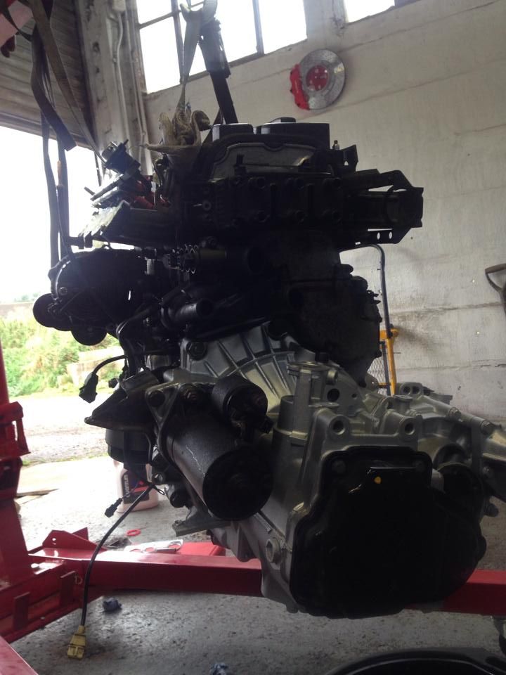

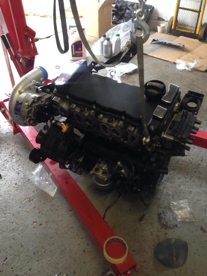

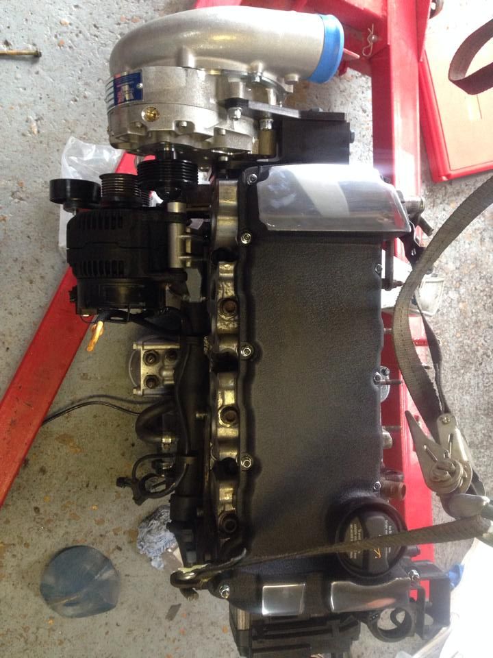

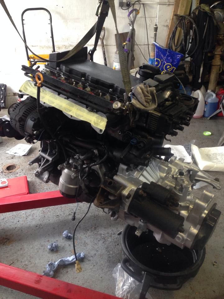

Block all painted and cleaned starting to re-assemble.
Got it all back in!

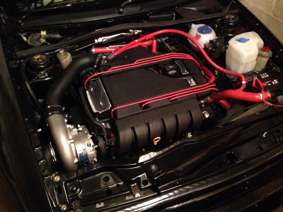

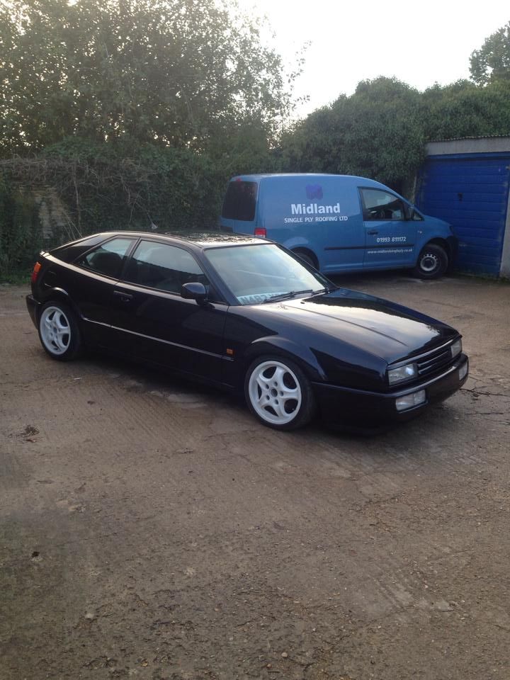

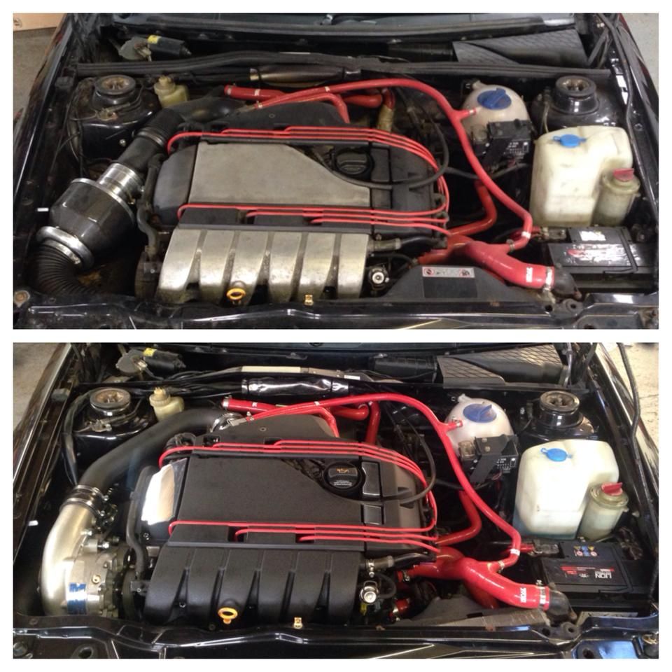

And the finished masterpiece! :dance:
A little before and after!
So yer, all up and "running", by that i mean it ticks over fine, but the fuel cuts at 3500 rpm, This is apparently due to the ****ty chip VF-engineering provide, so this is now on hold until i have the money for Vince at stealth to make me a custom one, absolutely gutted about it, and seriously ****ed of at VF/ the suppliers for wasting me about £400. But hey ho, these things happen and it will be all the more worth while when it does work! the race is on to get it sorted before the RR day! ill keep the thread up dated!

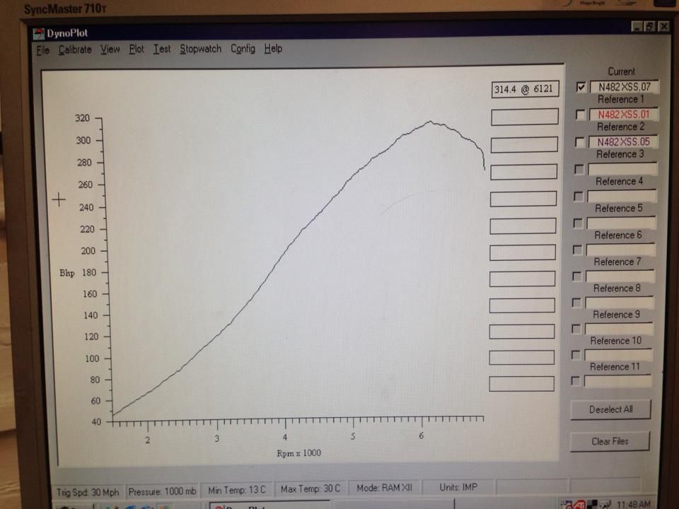

So yesterday i went to stealth racing for my custom chip,
One from the morning ;)
Vince diagnosed almost instantly it was a fuelling issue as he expected. Was fascinating to watch how detailed and personal the maps he does are, the things he was adjusting god only knows, run after run there was tweek after tweeek after tweek, until the graph was absolutely perfect. So much respect for anyone with that level of skill. Once again reminded why stealth have the awesome reputation they have. So... after a whole mornings fine tuning the end result from the V3 charger was 314bhp (279 Nm lbft) @ 9psi and a seriously smooooooth graph.
Really happy with the results even vince was surprised by her horses! Chuffed to bits with it, honestly that on top of all the other mods it sounds and feels like a freeking race car, will try get some videos up soon :)

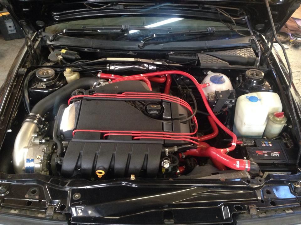

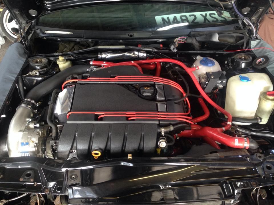

Just a random bay shot...
