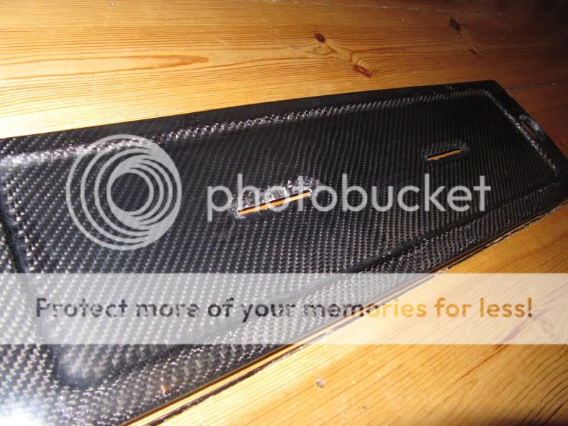

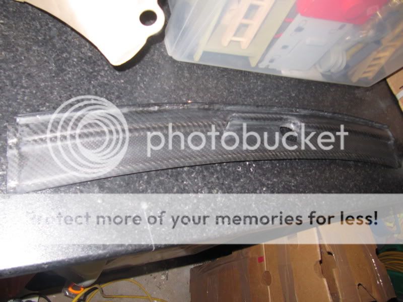

8vMatt 1 Posted January 4, 2012 Hey guys, Thought I would share my exploits about learning to work with sheets of carbon. Not the stick on crap but full on resin and carbon cloth. Bought myself a pair of uber sharp scissors to work with the cloth. And bought a kit with the resins and cloth. A 1m x 1m square can wrap a few parts so I've started playing with the scuttle trims. Wrapped all 3 I had spare, not rubbed them all down to a finish yet but here's one thats done. I'm not going to say I'm anywhere near a pro standard like Spoonfed dude , love your stuff and trying to resist buying. Might give in soon! Its an interesting subject and there's loads for me to learn about it. Wrapping parts is only one small area. Quote Share this post Link to post Share on other sites

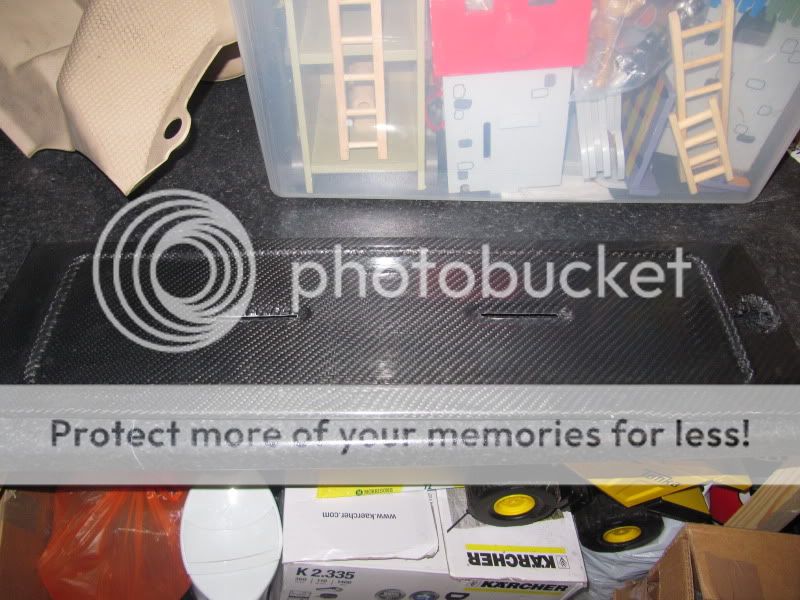

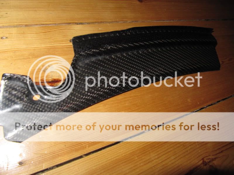

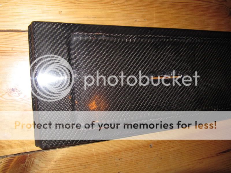

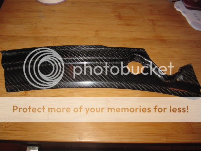

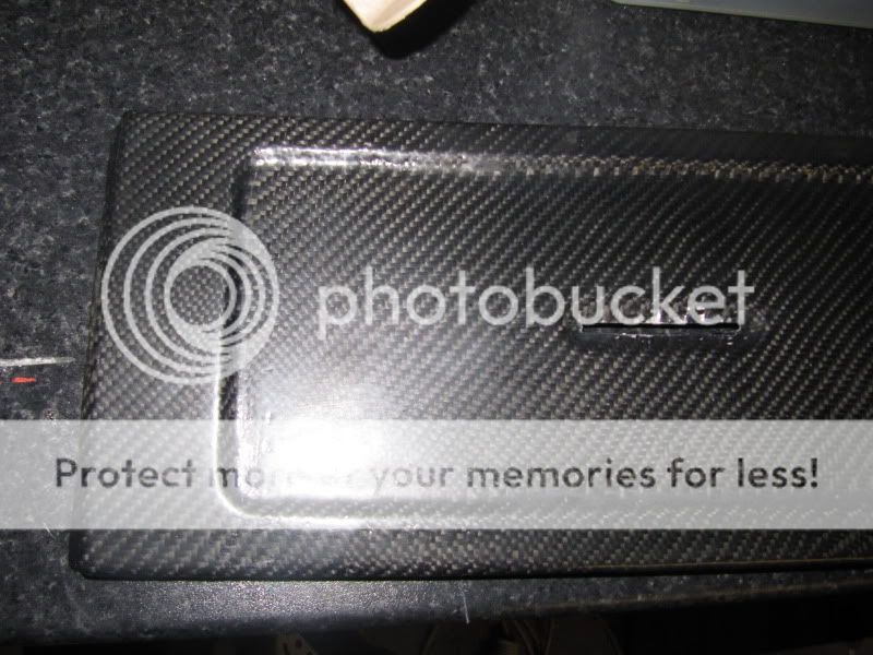

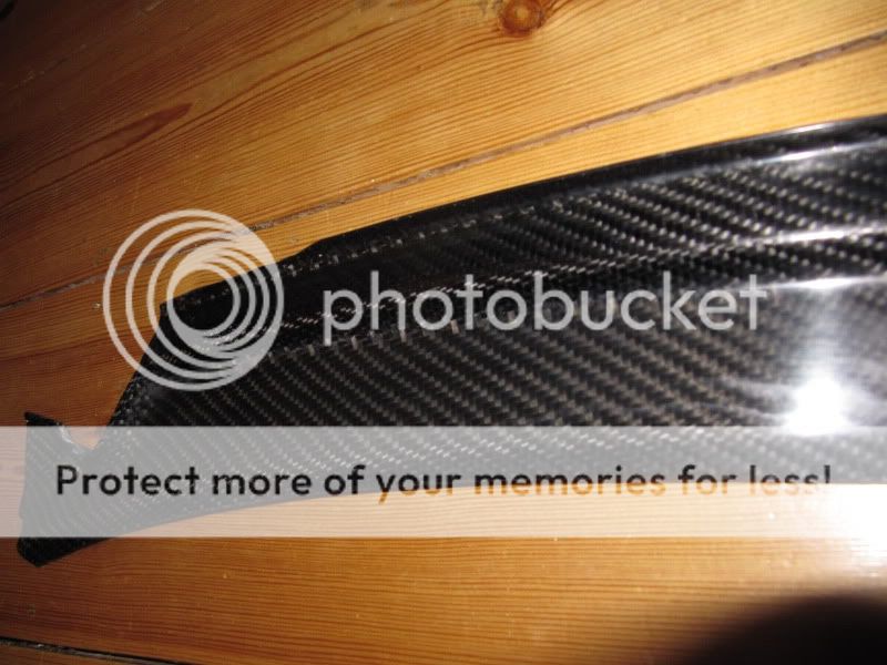

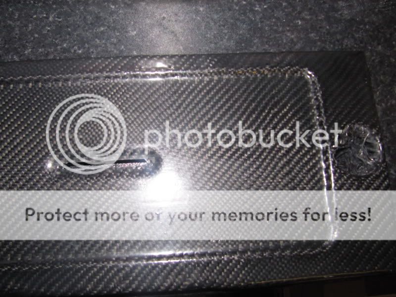

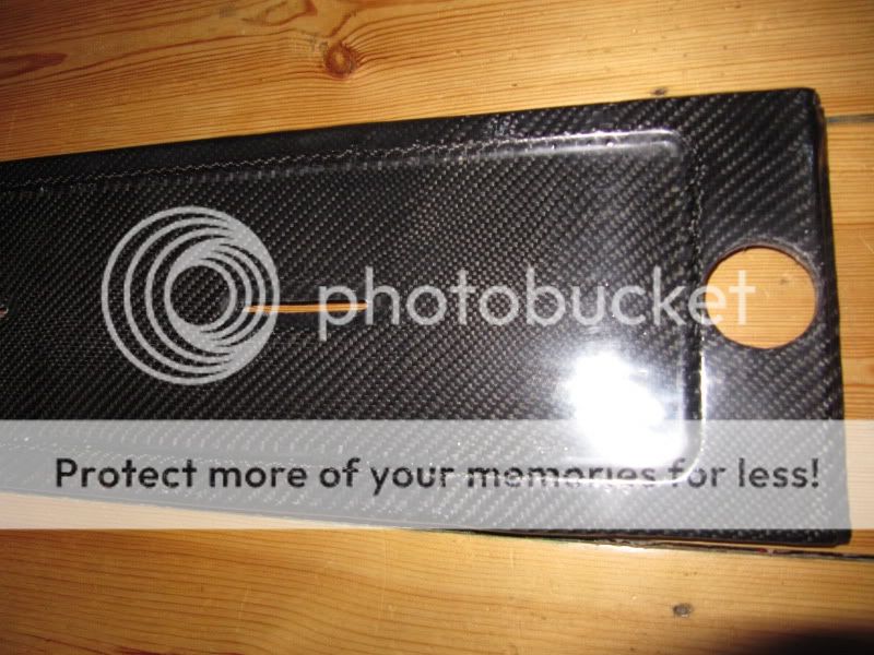

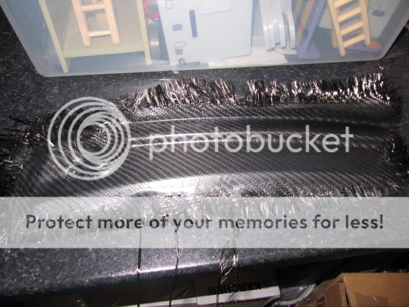

8vMatt 1 Posted January 5, 2012 Good stuff Matt, looking pretty good fella! Out of interest, ignoring the time involved, what would you say the 3x bits of trim have cost you? Er, I would say you could get 3 lots of full scuttle trims out a 1m x 1m cloth, prob could get a couple small bits out of the remaining. The kit cost £90 but if someone wanted to do this stuff properly then you could buy in bulk for a fraction of the price. ---------- Post added at 12:07 AM ---------- Previous post was at 12:04 AM ---------- that looks well good mate, as they say practice makes perfect Cheers bud, notice the few lines not dead straight, you would expect a pro to have all straight lines in the weave. But like you say, practice! I've also wrapped a number plate plinth I bought cheap. Haha, needs loads of rubbing down as I loaded up the resin too much. Sod it, I'll photo the work in progress now. ---------- Post added at 12:48 AM ---------- Previous post was at 12:07 AM ---------- Here's the other bits wrapped. The centre scuttle trim. Excess cut back and ready to be polished. Polishing takes ages going through the grits of wet n dry, then cutting paste and final polish. This is the other small scuttle section, just wrapped and with resin. The Dremel comes into its own when you trim off the excess. The resin is super hard once gone off. Now the number plate plinth, I'm quite pleased with how it went over a larger area. Needs a damn good rub down. I'll get these bits finished and have enough weave to do some more bits and bobs. Hmmm, what to do? I know its not everyones cup of tea but its fun to learn new skills and at least I'm not having to pay someone else for the bits to be done :thumbleft: Quote Share this post Link to post Share on other sites

8vMatt 1 Posted January 5, 2012 Cheers Chris, give you the fiver later mate! haha. Well I had a bit of a rushed effort at the number plate plinth, it has a load of imperfections but has played a part in learning to do this better next time. ---------- Post added at 09:57 PM ---------- Previous post was at 09:55 PM ---------- Looks very nice, where did you buy whole kit ?? Here you go buddy- http://www.carbonmods.co.uk/Products/Carbon-Fibre-Skinning-Starter-Kit---Large__CMCFSK1000.aspx Quote Share this post Link to post Share on other sites

8vMatt 1 Posted January 5, 2012 Thank you so much for the advice Dude, I've got a lot of research and learning to do! Cheers for the link. I had a bit of a go at one of the other scuttle trims. Cut the excess off with the Dremel and sanded down. Through the grits and cutting paste. Finished with a bit of wax to help protect the shine. Quote Share this post Link to post Share on other sites
