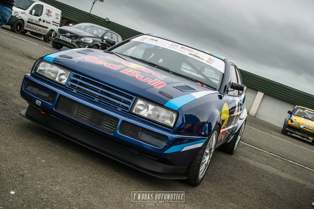

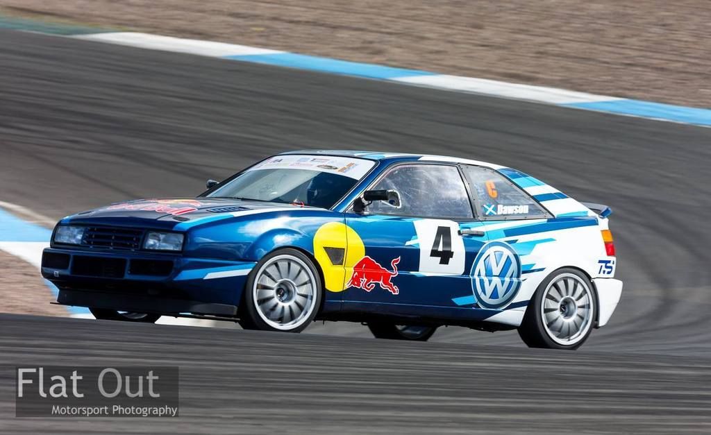

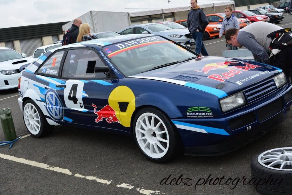

HummuH 10 Posted April 15, 2015 New livery done, wee sneak peak: Quote Share this post Link to post Share on other sites
Hairyarse 10 Posted April 16, 2015 Oooo nice, liking that!! Quote Share this post Link to post Share on other sites

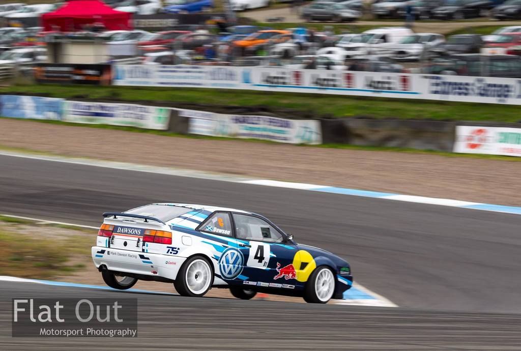

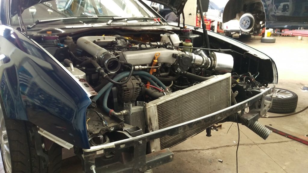

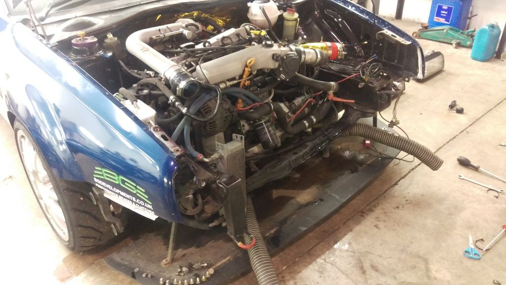

HummuH 10 Posted April 20, 2015 OK, massive post incoming..... Last week was quite interesting. After getting the car back on Tuesday, Thursday started at 9am with a dyno and weighing session for Super Lap Scotland. Russ @ Performance HQ asked if I wanted a smoke test done on the engine before the dyno so we did it. Smoke pishing out of the MAP sensor and also the intercooler. So, two fairly significant boost leaks, not good. Car should have registered peak flywheel power of 350bhp to 360bhp (dyno variance), we peaked at 300bhp, well down. I've clearly been running like this for some time, hard to figure out how I didn't notice such a large drop in power, I knew I was down, but not by that much. So, within an hour and after a huge favour from AF Noble Subaru in Penicuik, front end was stripped off to reveal a massive tear in the end tank of the intercooler where the oil cooler was mounted, the result of movement over time. Over to Andrew Turner Blacksmiths in Penicuik and they kindly welded up the intercooler and replaced some other vulnerable welds too. MAP sensor was simply a worn O-Ring so easy enough to replace. So by Thursday night all was well in the world again thanks to a host of people who love and understand motorsport, I'd be stuck without them. Car was now ready for Sunday, my first shot at Super Lap Scotland. It's basically like Time Attack, but power to weight classes and run only at Knockhill, in both directions. Didn't really know what to expect from the car after fixing the issues so we got set-up and ready for practice. Practice went well, instantly set a new PB and the car felt quick. Went into qualifying which is 2 x 2 hot laps, preceded by a warm up lap and a cool down lap both times. I was able to get tyres up to temp and set a new PB of 56.8 secs, over 2 seconds ahead of the next car in Class. In the final, which is one flying lap, I had killed my tyres in Quali and was struggling to get them to temp. Had to correct the rear end in the first three corners which knocked a bit of time off but we posted a 57.8 to take the Class win and driver of the day trophy. Here's the vid and some more photo's from the day: [video=youtube;9IKaBu1-liY] Quote Share this post Link to post Share on other sites
easypops 8 Posted April 20, 2015 Very very nice 8) Quote Share this post Link to post Share on other sites
coullstar 0 Posted April 20, 2015 Side on shot is brilliant. They just look so hard when in track spec. Quote Share this post Link to post Share on other sites
Sean_Jaymo 0 Posted April 20, 2015 You could do with a boost gauge! Quote Share this post Link to post Share on other sites
VAG-hag 0 Posted April 20, 2015 Love the new livery mate! Very cool Quote Share this post Link to post Share on other sites
HummuH 10 Posted April 20, 2015 You could do with a boost gauge! Yeah. We had looked at the boost logs and we had noticed a 0.3bar drop, not huge. Regular smoke tests will get done now. Quote Share this post Link to post Share on other sites
paddy26 3 Posted April 20, 2015 I love finding a thread like this that i haven't read before. Great write-up and videos and some amazing work over the winter. Most disappointing bit about the thread was getting to the end but I'm sure you'll have some more exciting updates during the year. Best of luck with the rest of the season. \Paddy Quote Share this post Link to post Share on other sites
sexybourbon 0 Posted April 21, 2015 Ohh man that looks soo good i love that livery and it looks s great job Really makes me want a track car Quote Share this post Link to post Share on other sites

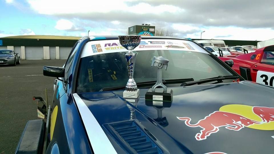

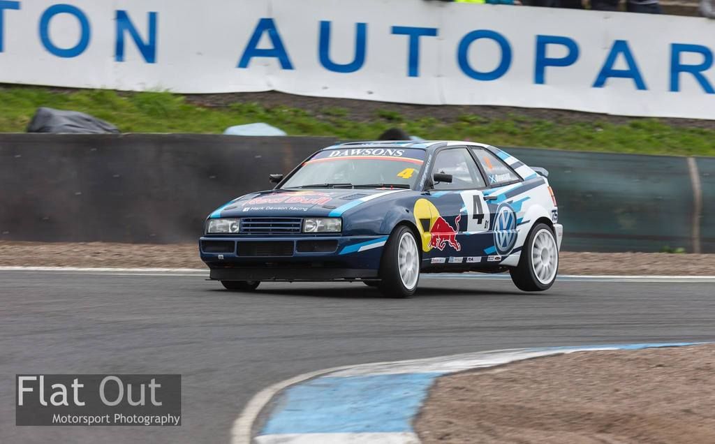

HummuH 10 Posted May 26, 2015 So, Super Lap Scotland (SLS) Rounds 2 & 3 were at the weekend. Great fun, good folk. For those who don't know SLS is a similar format to Time Attack with cars classed on Wheel HP / Tonne, but with a major difference; your whole day comes down to one flying lap in the final which sets the results. Weather forecast was good so we decided to try out a few things over the weekend. Ran the car for the first time with no front anti-roll bar all weekend, generally seemed an improvement. Ran with new rear toe (appx -0.15) and camber (-1 degree) settings, again seemed to work well. Finally, tried out soft compound tyres for the first time which delivered a consistent 4mph over Vmax on mediums and 3mph apex speed. I was braking at same points as on mediums though so you could see on the VBox that I was losing the time I was making up in the braking zones. Now I have used them and know how good they are I'll brake later next time out. On Saturday we were running the track in reverse direction which I've only driven twice before. It's very different to normal direction with the bumps and corners affecting the car differently to normal direction. Good news was we got quicker each time out on track which resulted in a new PB and 2nd place in the final behind Stuart Walker in a mighty 997 Turbo S. Video of Saturday's final lap: Sunday was back to normal direction and was determined to go one better. Again, kept going quicker and decided to put on some 205/40/17 Kumho V70 softs for the qualifying and final. End result was a new PB of 56.7 and 1st place in Class C. Good time with a couple of mistakes on the lap so hopefully more to come. Video from Sunday in post below. Finally, here's some pics from the weekend courtesy of John Stewart of Flat Out Photography: Quote Share this post Link to post Share on other sites
Jim Bowen 1 Posted May 26, 2015 Wow, it looks so good in the pics, rado porn! Quote Share this post Link to post Share on other sites
g0ldf1ng3r 16 Posted May 26, 2015 new livery looks awesome :D is any of it sponsor related? (sorry it that is a daft question as normally the livery is to show sponsors) i imagine you are very glad you did the smoke test even though it threw up problems congrats on the 2 trophies from knock hill will watch the super lap day stuff later :) Quote Share this post Link to post Share on other sites

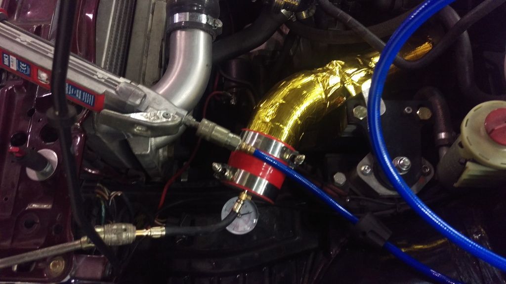

HummuH 10 Posted September 25, 2015 So, long overdue an update on this one. 2nd half of the season has been quite challenging. Quite a few wet races and I still don't have a solid wet set-up, really need to work on that. At our August race meeting it was clear something wasn't quite right. Cars I would normally keep pace with were getting away from me and the AFR's were looking a bit dodgy, very rich when on open loop. So, we started a diagnosis. Bought this neat wee kit off Ebay and hooked it up to the inlet to see what the pressure in the system was doing. Pressurising to 1 bar, the system couldn't hold any pressure. We could hear and feel two boost leaks, both coming from the inter-cooler. Damn, 30 mins later we had this: Also found a wee crack in the bottom of the radiator whilst we were at it. Both items are custom Pro Alloy Motorsport jobs so spoke to them the next day. It was clear I wasn't going to get new items in 7 days but they were incredibly helpful and agreed to do what they could. 4 days later a freshly welded radiator and inter-cooler arrived back allowing me to get to the end of the season and sort out new items after that. Got the car put back together on the Wednesday and headed out for a track session on Thursday to test. This allowed me to try a new camera angle on the splitter: So, September race meeting was the following sunday and rocked up delighted that we once again had BOOST! Then........ It was damp. Trying to get some heat into the tyres on the green flag lap I nailed it in 2nd to light them up. Some nasty noises began. I started race but quickly slowed as it was clear something wasn't right. After a long wait at the side of the track got back to the paddock and found that 2nd gear had gone taking the output shaft with it. Crap. This was not good as I had 6 days until the Superlap Scotland Final which I did not want to miss. So, no fecking about, got the box out of the car.... One of the advantages of having the engine mounts relocated is that we can get the box in and out without any clashes with sub-frame and the drive shafts can stay on too. 30 mins later we had it out. As you'll see, there was a nice chunk out of the casing where the "dog bone" mount attaches. Torque baby. No biggie, but another job I needed to get done. After a phone round the houses, finally found a really nice bunch of chaps at ASK Transmissions in Falkirk who were recommended by a racing buddy. They agreed to open the box and turn it round if they could. Now, earlier in the year I had bought a cheap CCM 02A box from a VR6. I had always wanted to try a longer 1st and 2nd gear so this was a good opportunity to try my gear swap. 48 hrs later, I had the box back in my possession, nicely welded and with my new 1st and 2nd gears in there. Total result and great service from ASK Transmissions. Box back in, wipe sweat from brow, prepare for the weekend. Sunday arrived, it was dry, WOOP WOOP! To celebrate, I stuck on the white wheels. Had some pretty stiff competition on the day. An Ultima GTR was running in my class and also a c. 470bhp Impreza and well as the Time Attack Astra and 997 Turbo. Ended up 2nd in Class for the final which gave me the overall Class C win and 3rd in the overall championship. Not bad for a 25 year old Beetle. Some pics from the day: Squeaky bum time at 130mph.... Final race meet is next Sunday, 4th October and than the winter plan will commence! Cheers for looking! Quote Share this post Link to post Share on other sites

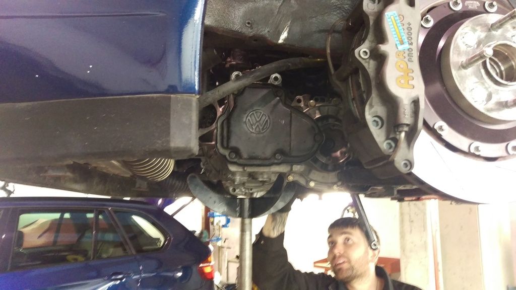

g0ldf1ng3r 16 Posted September 25, 2015 great update & cracking pics, thank you :) love your brake temperature tool by the way!!! very nice lol Quote Share this post Link to post Share on other sites
HummuH 10 Posted September 25, 2015 Cheers man! Yeah, hehe, they do come in quite handy! Those AP's keep really cool though. Quote Share this post Link to post Share on other sites
g0ldf1ng3r 16 Posted September 25, 2015 Cheers man! Yeah, hehe, they do come in quite handy! Those AP's keep really cool though. I bet they do, AP's are awesome kit you have no idea how much I would like some on my VR lol Quote Share this post Link to post Share on other sites
