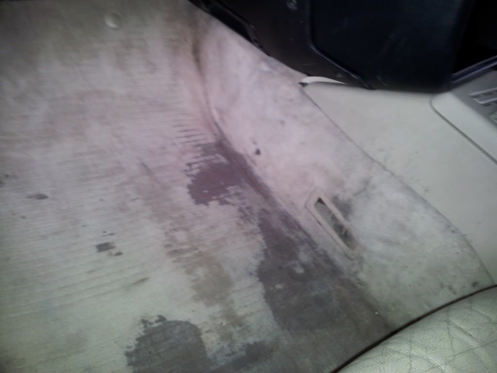

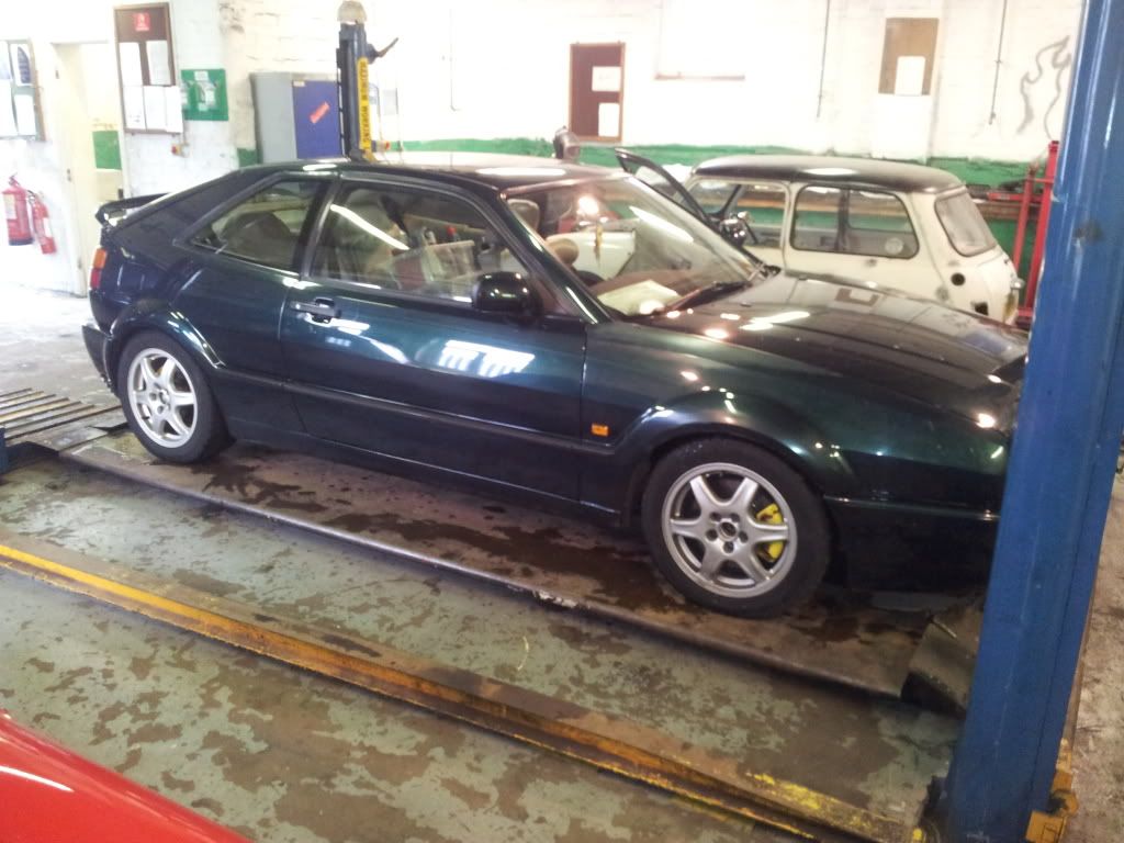

I took it into the car club where I'm working until May, and where there is a four post lift to have a good root around underneath today. Thankfully, apart from a fairly battered sump, its very solid under there. All bushes are in good order, so as far as MOT goes, I'm OK from that perspective. Just the other things to sort. (ABS, 2 front tyres near limit, HIDs removed and uprated loom fitted) and should be good when test time comes. Its gonna be off the road now for a few months anyway so I can sort all the issues with it. It's been raining since I went to look at it, so gave it a dry with the microfibre drying towel to see the actual state of the paintwork. Again, not good! Its seriously oxidised in a LOT of places, and although I'm pretty handy with a Rotary and have a fairly decent detailing product range, I think I'm only going to be able to "fix" a small amount of the paintwork.
I'm trying to look at this with a positive frame of mind though, and saying to myself, "at least that's another one saved from the scrap heap", as that was where it was surely headed! Its obviously been seriously mistreated by the last few/all previous owners, and needs a good lift.

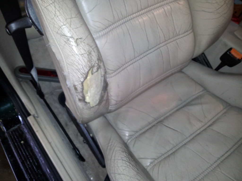

James, thanks for the offer mate! I've got some good products and a George wet n dry, so hopefully the carpets will come up ok. They don't look tooooooo bad tbh. The leather is actually all there on the bolster, so it may be able to be repaired. The rear cards may have to be supported from behind, filled in, then have a leather/suede type covering over the top to neaten them up, and the parcel shelves come up occasionally on here or ebay. Its not beyond saving by any means, but body and paint are going to take some sorting with will be the major expense.
No problem Sean the cream carpet i put in mine needed a good clean but came up really well i can see why you would want to keep the cream carpet as it goes so well with green bodywork and in my opinion brightens the interior you will get there mate :thumbleft:

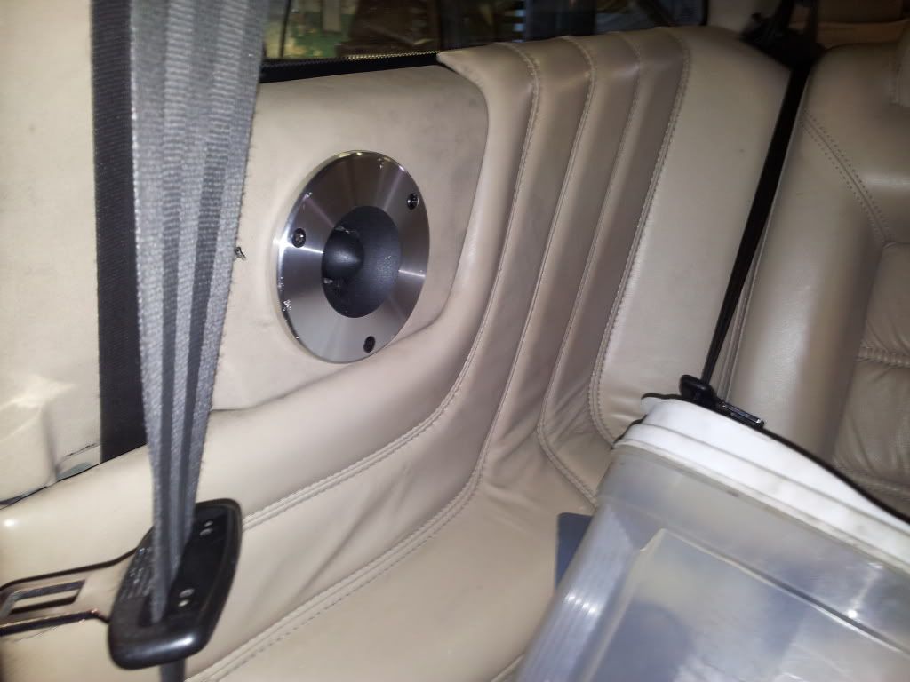

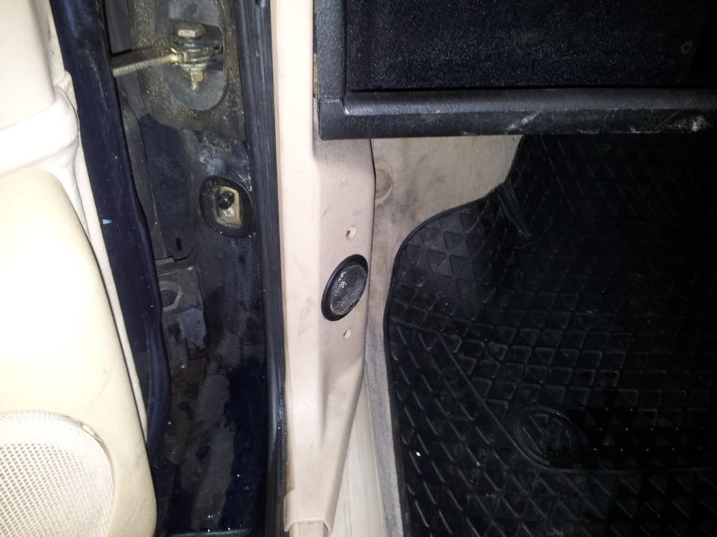

The image of the tweeter in the footwell panel might tell a tale on what's wrong with your ABS. That's where the controller sits and if it was still there, there wouldn't be space for that tweeter....

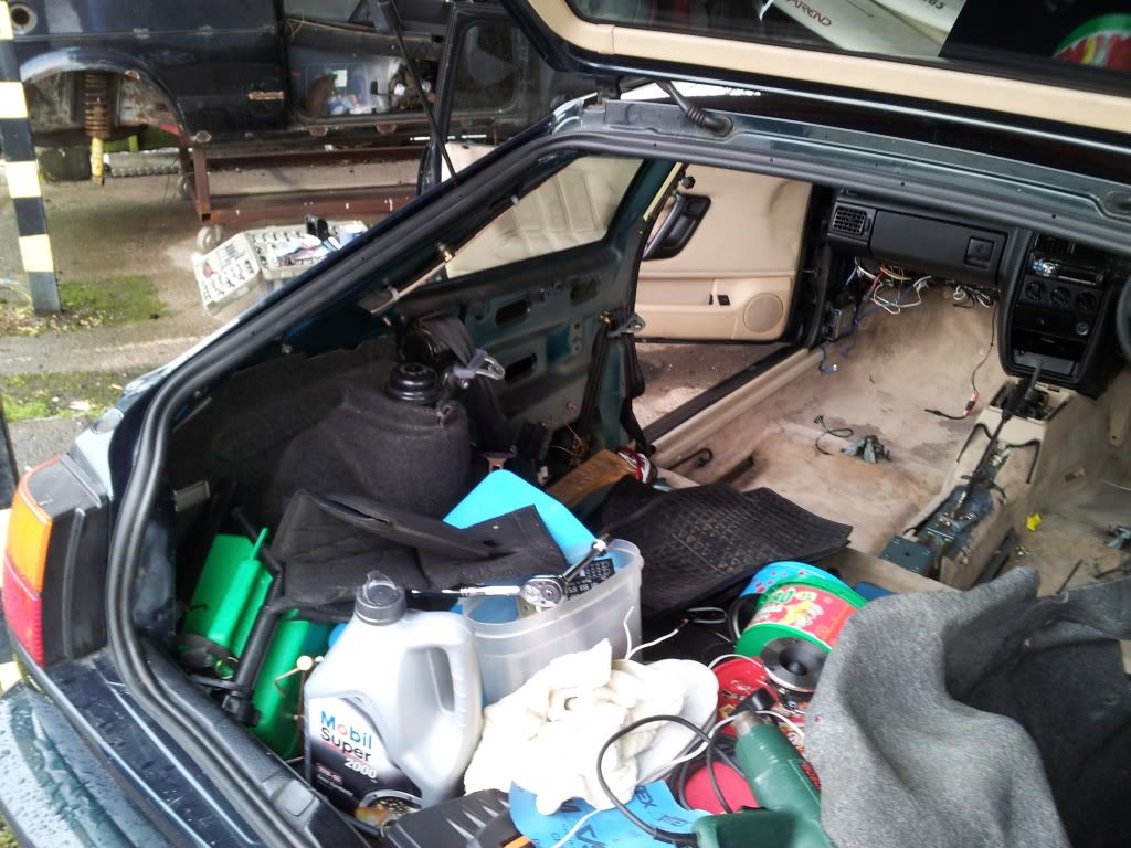

Yeah I'm gonna look into it, but need to give it a good detail first to get a true indication of where it is. Checking it out today and I think I wrote it off a bit early before. Stripped out some of the interior today. Can't wait to get started cleaning it all up! Again I think I may have written it off too early. I honestly think it can be bought up to a pretty good standard with a bit of effort. I think the rear card inserts/B pillar trim that has been hacked to death can be made as good as new. It's just leatherette at the end of the day. A bit of support and leveling of the main plastic, then a retrim in the leatherette and I'll think it'll come up really well. I'm gonna hunt out a supplier that can colour match the original so at least it'll look standard. Good new too is that the ABS controller is in place, so just need to get VCDS on it and see what it throws up..............now where did I put that lead?....................

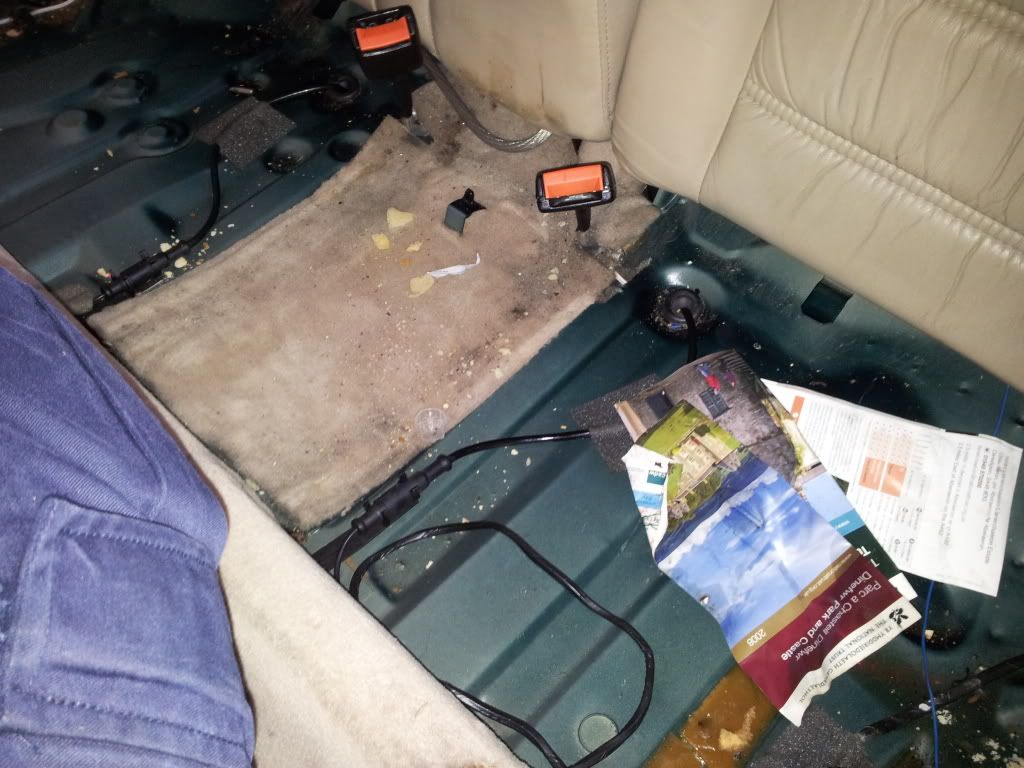

There are about half a dozen OE plugs that have been removed behind the lower glove panel, so need to find out where they're all from.
Anyway, some pics from today!

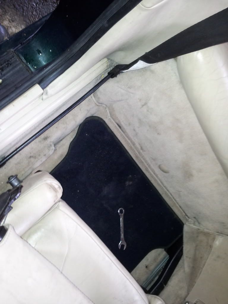

And under the rear seats from the owner before last I think! Goes to show how long its been (at least) since its had a good clean!

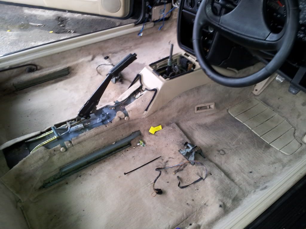

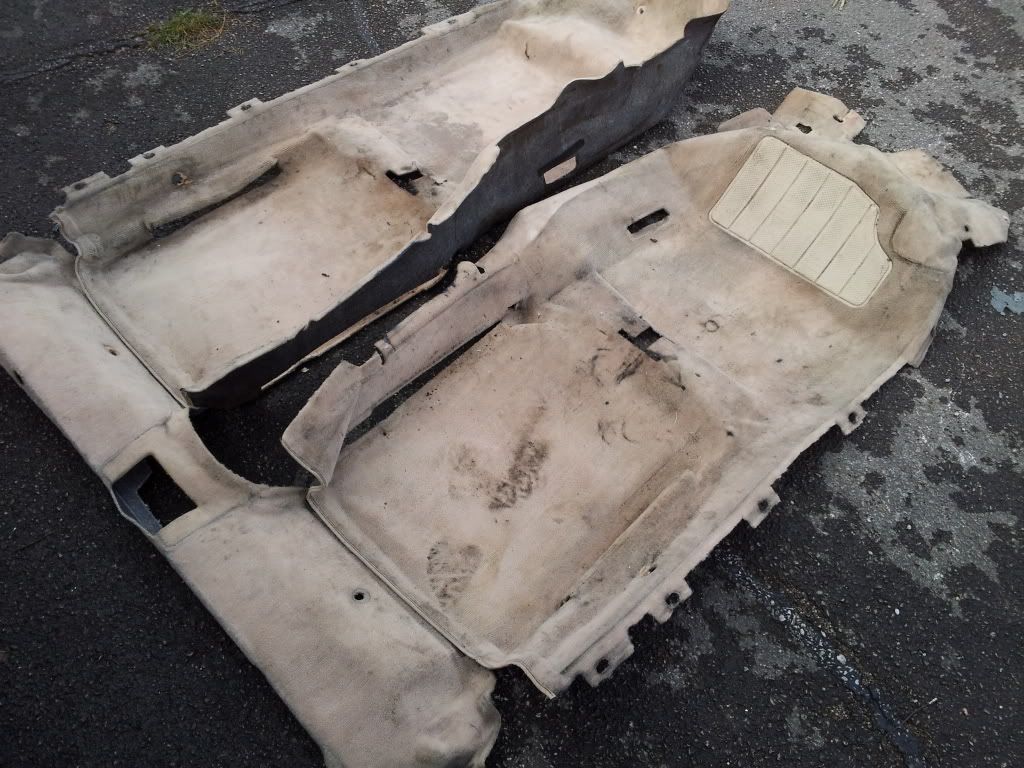

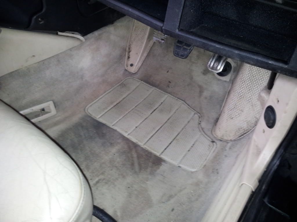

Anyway, this afternoon I got busy stripping out the rest of the interior, and started cleaning it up. I'm gonna give the carpet another go over with the wet n dry but I'm pretty happy with how its coming along! I noticed whilst pulling the carpet out though, that there are a load of weld splatter burns around the sides of the tunnel. You'll see in the pics, but some knob head has welded round the handbrake lever and cable, and obviously couldn't be arsed to cover things up! Anyway, I pre-soaked the carpet with Bilt Hamber Surfex (APC/Degreaser) at 3:1 through a spray bottle, then went round it with the spray bottle again and an interior upholstery brush scrubbing like mad! This removed the majority of major marks on its own! I was really pleased with how this worked, the Surfex is awsome stuff! It obviously didn't remove the dirt though, so after that I went round with a George Wet n Dry with just warm water sucking it all up.

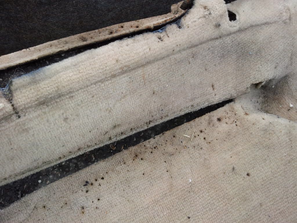

The weld splatter burn marks

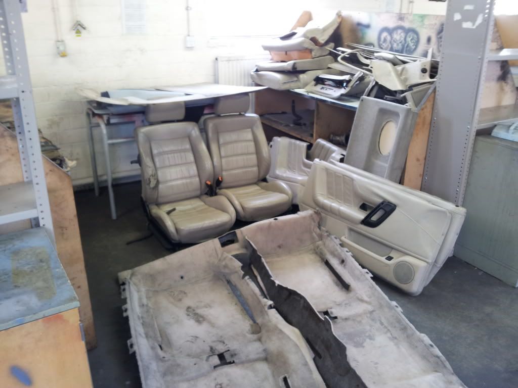

Everything together in the workshop

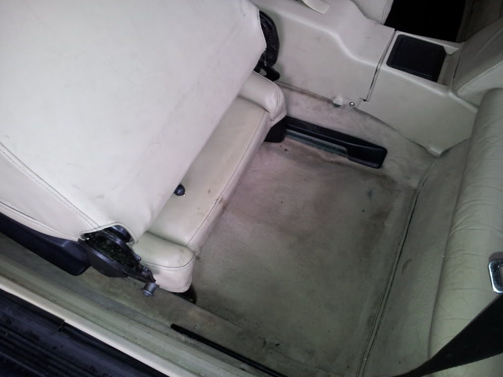

Carpets after the first go over
